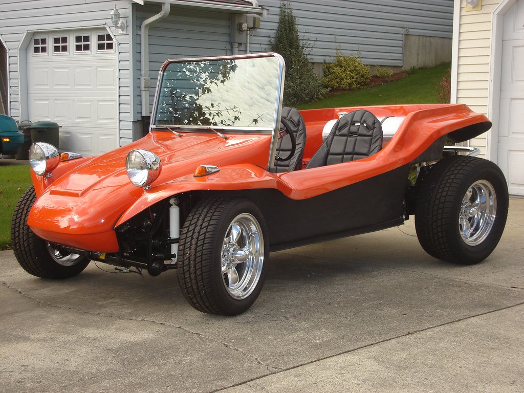

I was involved in the build of bearly legel buggy and thay built them as new cars not vw it was a big hasstle insuring them I am building a manx/rail car and have done alot of research on the whole street legal part and have got an inspection facility on board if you build it and regester as a bug you will get plates but when you get stopped by the cops thay will get you in trouble for tampering with tags the best way is to build a modified vehical outlind on ICBC websight it costs you 25.00 one form you must have a regi I used my doner bugs your inspecter will get new vin # that he will install do this when your buggy is ready to inspect make shure that you contact inspector befor you start and during your build he will let you know what is accepted all inspectors are different it took me two of them before I went with this guy after inspect just show buggy to insurance broker pay them for reg and insurance and you will not get hasstled by the cops just keep your cool when you get pulled over and dont be stupid on the road ex. no wheelies or jumpping stuff it just makes it that much harder for everyone else any other questions post them to manx build in this forum hope this helps
