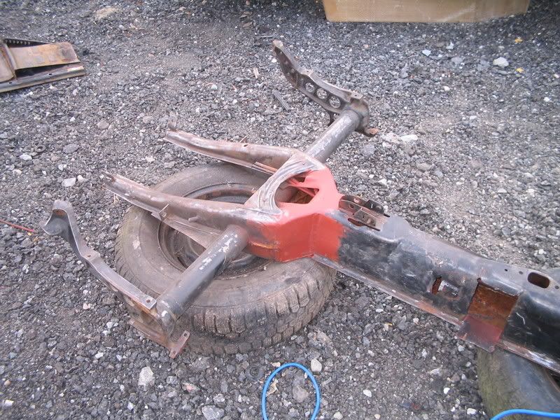

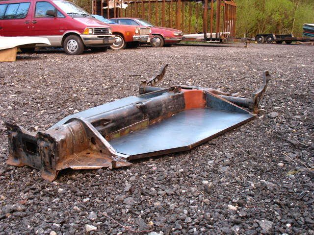

another buggy in the works. The pan has been shortened 21\" 1/4
tody dallas got the old floor pans out and wire wheeled the chassis.

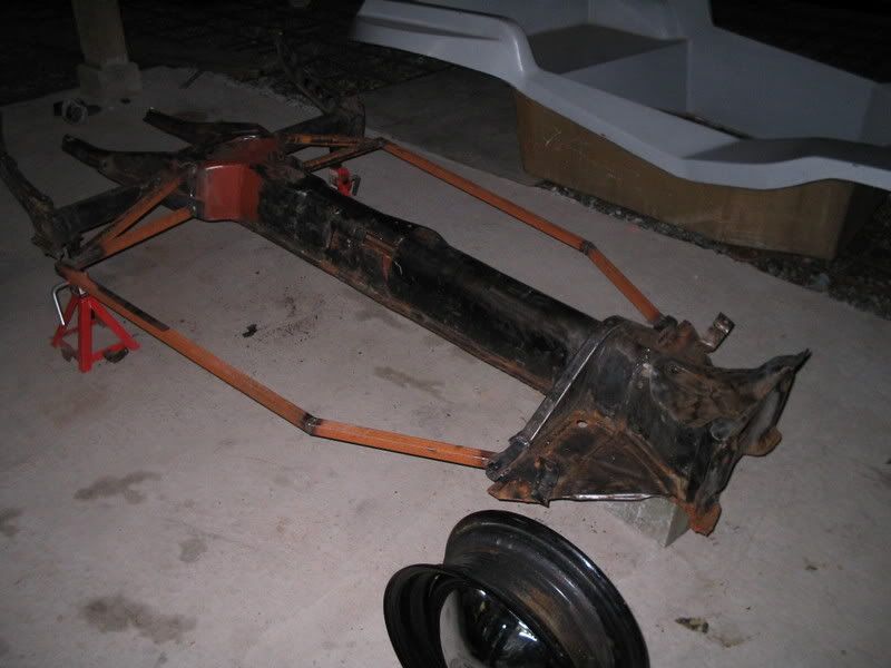

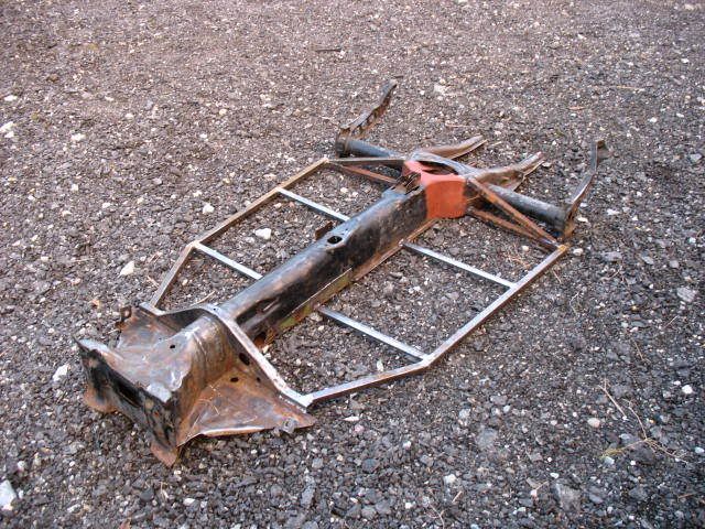

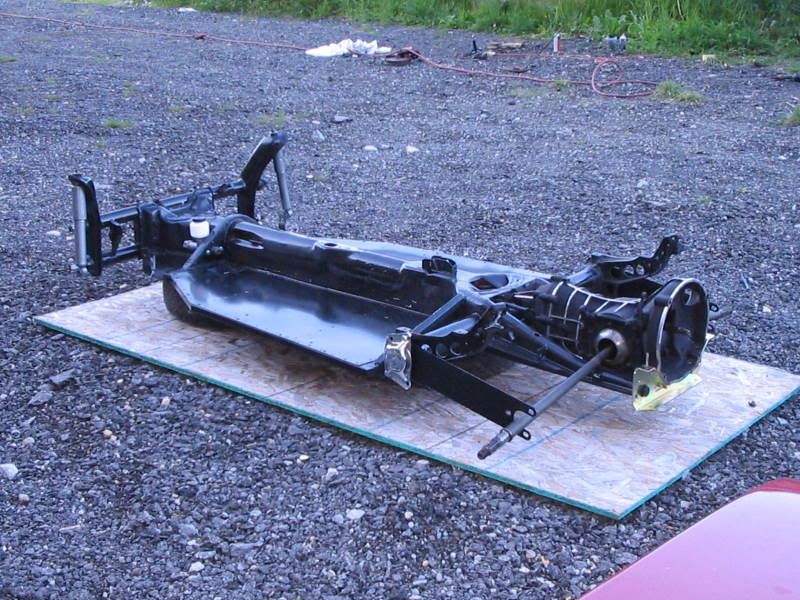

2 days later, started on new pan with 1x1 box tubing.

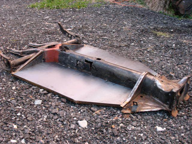

« Reply #10 on: April 17, 2007, 08:03:16 PM »
today we cut out the new floor pans and set them in place. still need to be fine tuned though.

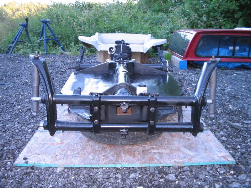

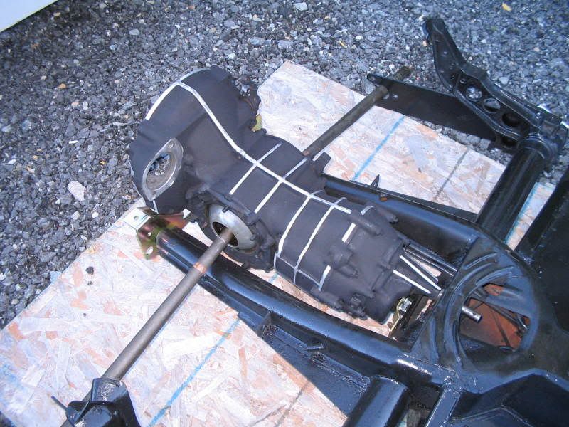

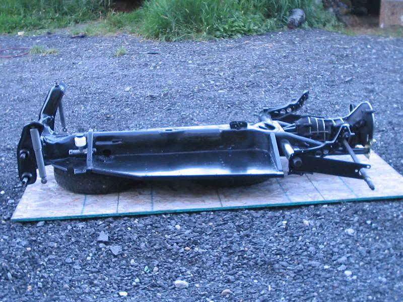

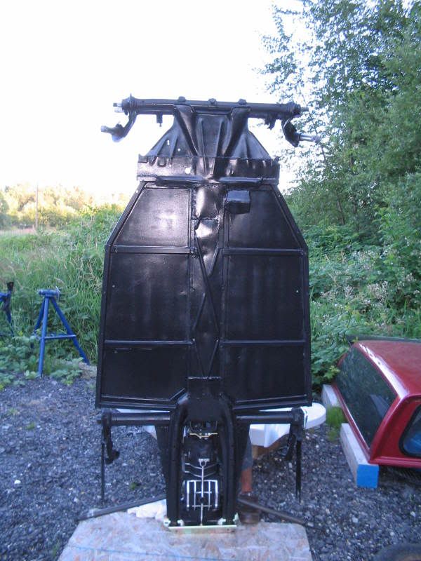

« Reply #12 on: July 08, 2007, 08:51:54 PM »
it seems like after 17 years two days and 3 hours were finally getting somewere...por 15 the pan cleaned up the beam and wire wheeled and painted the tranny
