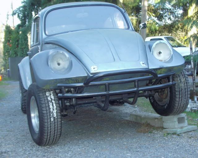

« Reply #11 on: March 16, 2005, 08:59:13 PM »
Been working on lots of stuff, lots of pictures to show, but this is my favorite:
