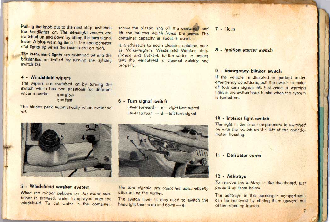

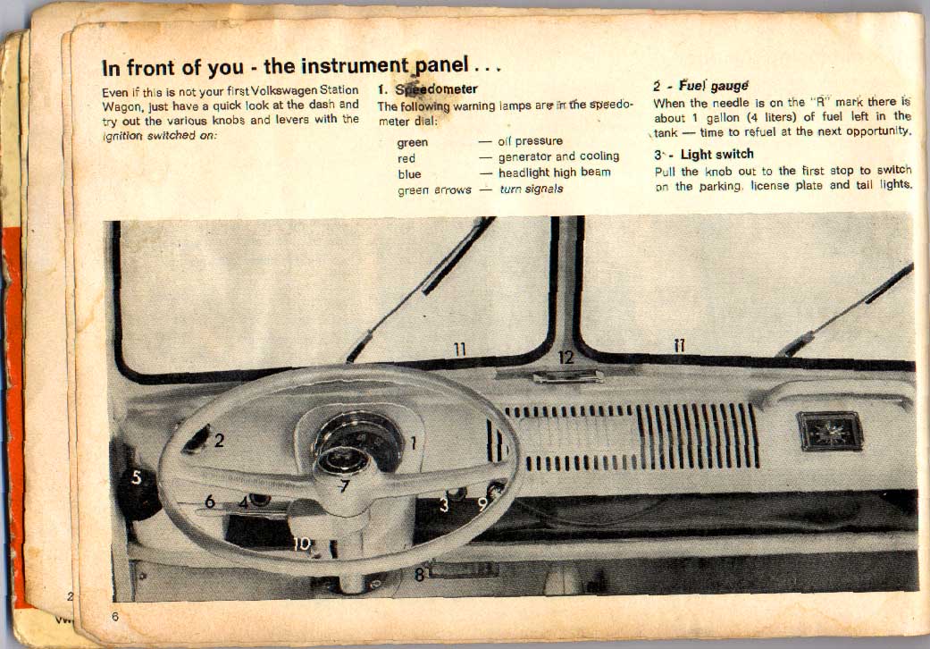

strange my wipers are over but the headlights on the other side maybe that put them in the wrong spot .so whats #3 then?
