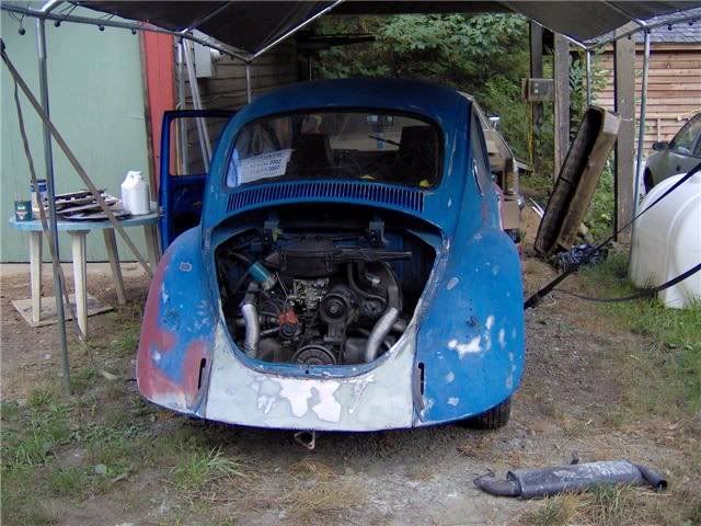

« Reply #4 on: November 23, 2008, 08:54:14 PM »
Here it is

Re: 1600 dual port 71-74
« Reply #5 on: November 23, 2008, 08:59:24 PM »
That's a start.  There are several different distributors and carbs.  It is possible your carb doesn't match the dist, or vice-versa.
Need a close-up pic of the engine, showing detail of the carb and dist.
« Reply #6 on: November 23, 2008, 10:23:40 PM »
That looks like a one vacume distributor (71?) the carb looks like a 34pict and i am not sure but, the carb would then have two ins for vacume.
