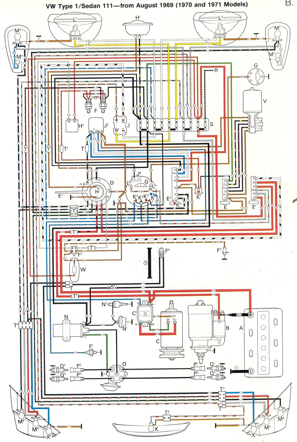

can we see a close up pic of the terminals on the buggy motor alt & the bosch reg?
i'm thinking this is close to the diagram you want to follow...

i hooked thjat motorola piece up to the reg and then ran the battery wire and it didnt charge.  Im thinking maybe that that motorola regulator might not work or either the alternator doesnt work, because i am fairly sure that i have hooked up the motorola right. ( i also did have that alternator taken apart at one time, so maybe i put it together wrong?)  I followed this wiring diagram. http://www.nls.net/mp/volks/schem/altreg.gif  After i get home from school ill take more pics of the other regulator.
