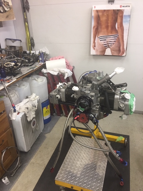

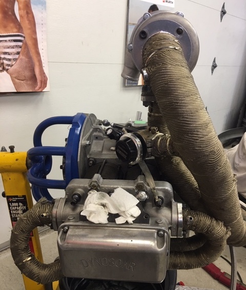

before i pulled the Boozer out i did do a quick leakage and compression test .
all cylinders less than 5% leakage and 130 psi 3 cranks , and that's with a cold motor .not bad .
im not a huge fan of the ring pack that’s in there but im not pulling heads for a re ring as it always leads
to more money being spent and sometimes i just dont want to know what my cylinder walls look like ,
not even going to look with the bore scope .

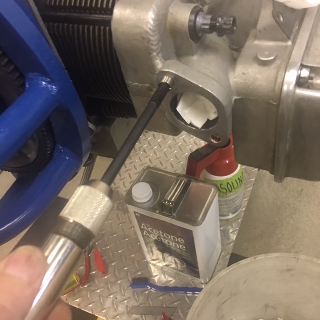

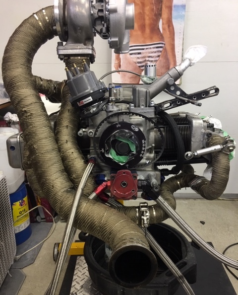

like i said the Boozers out and on the stand .why ?
not just for fun but for many upgrades and adjustments that can not be done in car.

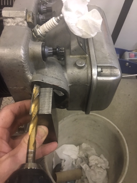

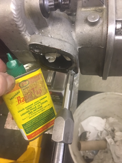

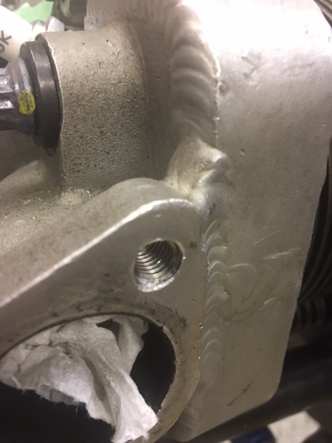

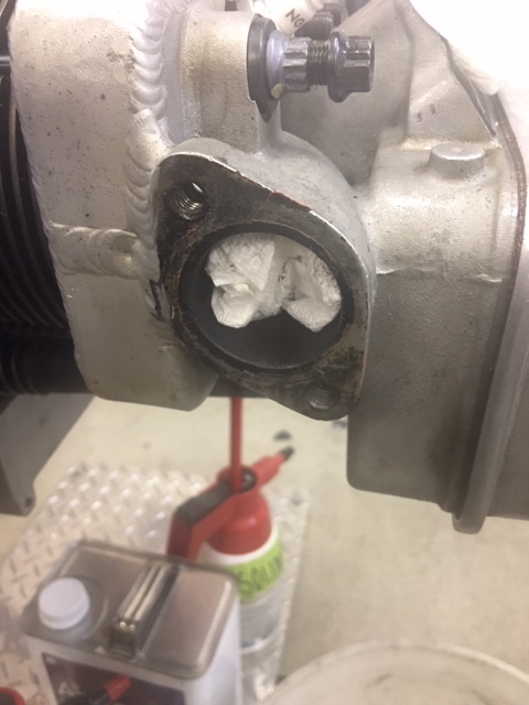

- heli coiling all the exhaust threads in the heads ,
yep threads were done and having poor exhaust flange sealing was not helping me.
drill it -but hey make sure your square ,doesnt need to be rocket science
tap it - and yes use cutting fluid it will make the threads crisp and will not allow the aluminum to gall up
clean those cut threads with some brake kleen and blow dry , a dab of red loctite will help as well
heli-coil will wind in nice plus 1 turn more when last thread just disappears
snap the tang off and give it a wipe with a bit of rolled up paper towel and good to go .
you'll see why this needed doing soon .
done and finnished.

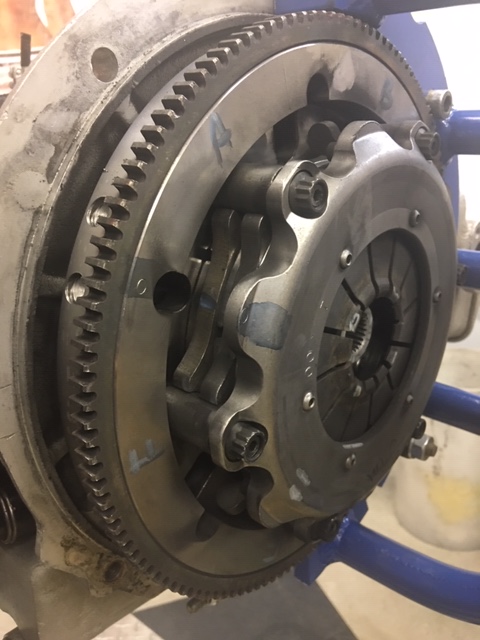

the MAIN reason the Boozer came out !
not sure if anyone has seen this but this is what the REV6 clutch looks like .
i started playing with this last year and yes its getting there .but need adjusting
more to come

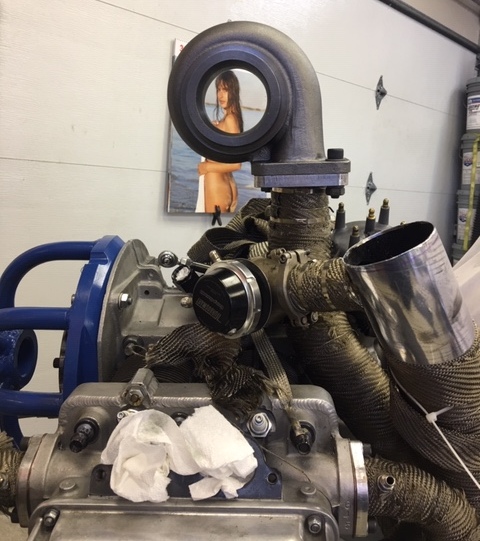

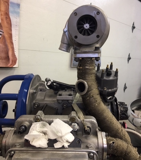

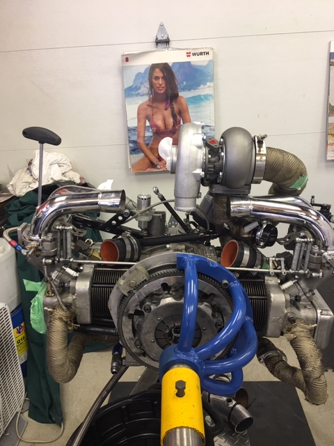

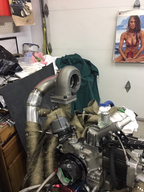

tested those freshly heli-coiled threads and remounted the exhaust system and proceeded with the next stage .

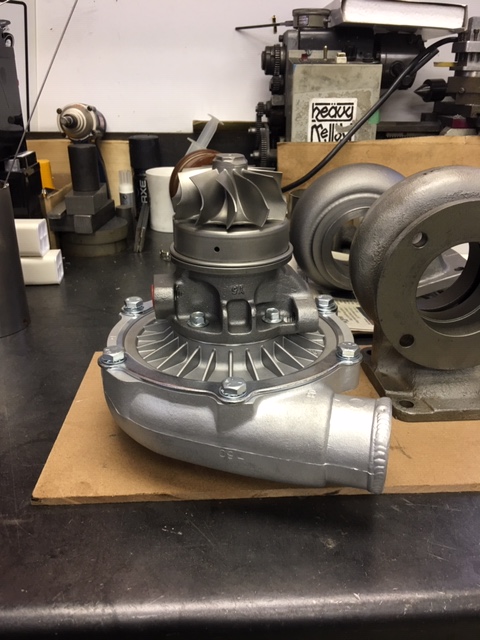

from the side you can see the turbo i've been running is a old school on center exhaust housing unit.
nothing wrong with it ,and does offer some options when mounting space becomes a issue ,but by design can limit exhaust flow
during higher rpm and possibly engine output which directly limits horsepower potential .
im always asked what kind of turbo this is and what size , so if your in the turbo know here's the scoop.
the turbo is a combination Air research and Garrett - T4 flange ,P exhaust wheel with a .96 a/r exhaust housing - cold side a/r .60 with a new 57 billet wheel .
time to mount the down pipe and wastegate ,need those on there for mock up
gota keep the downpipe exit in the same spot right? yah but if nothings changed who cares?
sometimes things gotta go
time to eliminate the potential on center restriction and unleash any free power i can .
new .96 tangential exhaust housing ,so now you can see why the mock up was so important
its all gotta work and yes it will fit in the car still ,moves fwd almost 3" and lower by 3/4".
Mike Merrel at Turbos Direct is the man and if you need help , please call him at 623 376 2562
http://www.turbosdirect.com/
so my old turbo which is the same turbo needed help and no one out here could help.
One call to Mike and it was done .this gave me a chance to discuss my turbo and what it all means .
he fixed the thrust and endplay that was over .011" and oil leakage issue ,installed the new billet inlet wheel and supplied the
exhaust housing .
numbers go like this , as per Mike with the turbo in its original form would run out of compressor side before exhaust ,
(made no sense to me but what do i know),
so after endplay and thrust were repaired, he replacing the inlet wheel with a new billet wheel , that alone will allow for a
 25h.p potential and swapping out the exhaust housing another 25 h.p
so before the turbo was maybe good for 400-425 ish now it'll push 475 plus ish and do it  very efficiently , which is the most important
.it will make the same out-put 3 psi lower than before and never hit a wall till the inlet cannot move any more air .

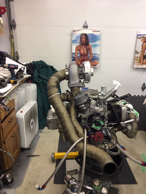

sounds good to me so lets weld up a new pipe next .off come some DEI titanium wrap and trim the top
of the old downtube off to make room for the new pipe conversion

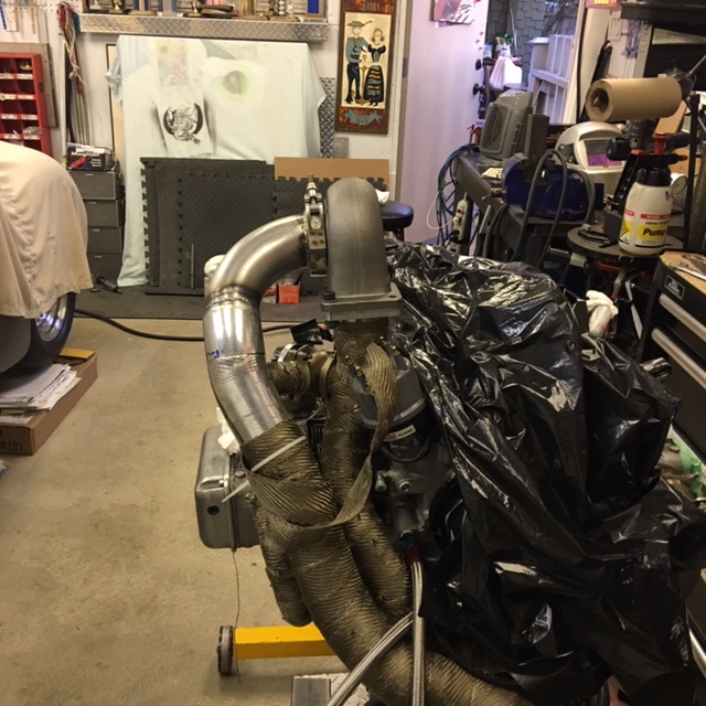

Finally got around to getting the exhaust mocked and  say 99% finished up.
   -used a bunch of bits old and new I had laying around and got it to finally fit .

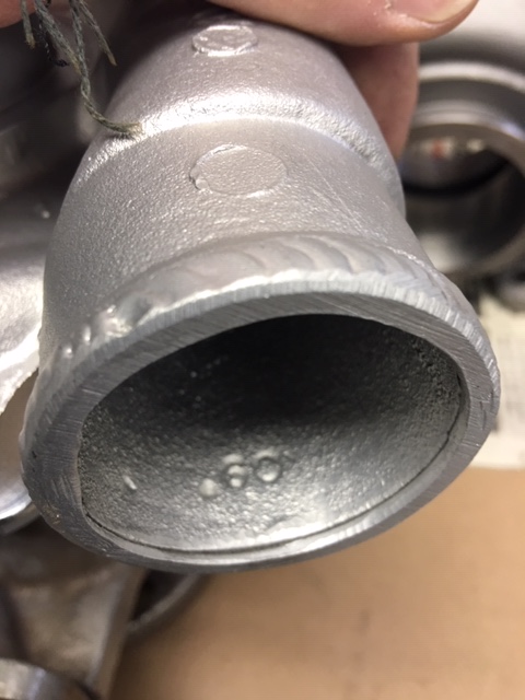

Started by Machining a recess into a flat sided v-band to index and fit the turbo cast in v-band ,
Seems like it would be a snap to make fit ,but when your trying to scab a section into a previous made
Section its not always easy, especially with some compound curves to deal with .
First section welded up and kept the v-band firmly clamped to prevent warping during welding.
Back on for yet another mock up
Mocked and welded

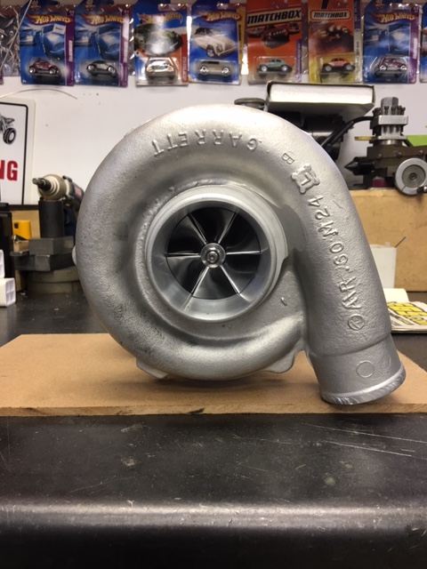

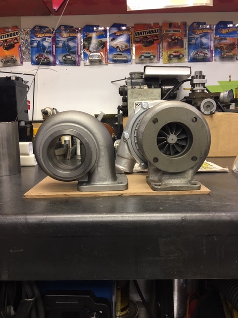

New billet wheel ,nice shiny
Numbers on the outside of turbo housings cold or hot side generally mean squat
Im told always marked on the inside .this housing is a .60 cold side
Time to pull the old on centre exhaust housing off, that’s a “P” wheel exhaust impeller

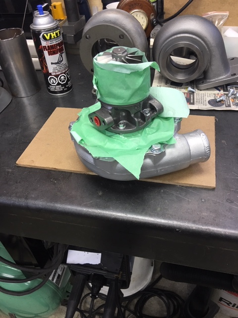

Here’s a good shot of both housings ,you can see the on centre is taller ,so with the
New housing im dropping down a inch and back about 3”
To prevent the cast centre section from rusting as well as the cast exhaust housing

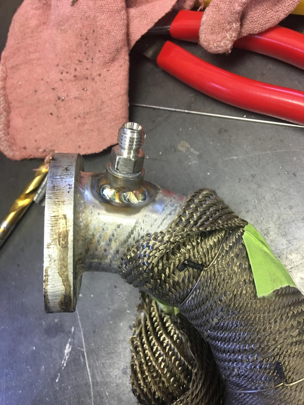

Hit them with some high heat header paint ,in this case clear
Wrap temp reinstalled and new exhaust downpipe fits great ,now I said 99% finished
I still need to weld the o2 bung on and strap the header wrap down after .
So Ill take the pipe off and over to the car for a hand fit and double check o2 location .
Spun around now time for a new intake ,all pieces cut .and working on mock up
Problem with turbo being lower it also has moved tighter to the 3@4 side of the motor
A little more testing and tig time very soon then shes going back in .

not to many pictures but started from the tightest side, orders my 2 1/2" mandrel bend in mild steel and started to realizing now this was going to be a bit more work than I originally thought.
compound curves , offset centreline adding new location for blow off valve ,AN fittings and just not much space.pain.
I ended up trimming the intake ends about 1" per side to get me some needed width or it wasn't going to go well .
no photos in between this and final product but ill tell you I walked away multiple times .
end result turned out very well and there is allot crammed onto it as well as fit the blow off valve offset and angled to get needed engine space.
yep desperate times and tigged it up with 0.23 mig wire .gotta stop being so lazy and get some 0.42 rod next time
hey look the motors in for this shot ,ok since this is not going in the exact order some pictures may be outa sequence but hey doesn't really matter.
now you can see why the blow off valve needed to move from the old centred position for the old intake .it sits about 1-2" lower and would not clear fuel
distribution lines, tucking it in behind the alternator stand worked very well ,at this point is where I tested where the AN fittings needed to go and would more
importantly clear everything .marked out locations for the 2xAN-4 and 1xAN-6 .out she comes for a drilling and welding again and a final ceramic high heat spray.

now that the INTAKE is taking shape it was time to finish of the new fabbed EXHAUST turbo outlet pipe .
so once again motor needed to be in , so again will just jump back a bit then fwd again .
previously the motor was out and gone through with some good internal upgrades and new clutch system.
and while it was out I added the 4 EGT probes into my new data logging system .
location was marked 1.5 " from flanged, drilled and welded the EGT bungs
rewrapped the pipes and made a jig that sat inside the header so I could index the probes at the middle of each pipe .
once there are snugged up once the ferrule grips the probe so the depth will never change even when removed and installed .
testing those help coiled heads now ,no more leaks and loose hardware
last thing was to mount the turbo onto the header and fit the new EXHAUST turbo outlet pipe to get the o2 sensor bung best position .
make sure its between the 10 and 2 o'clock position to keep water or fuel from collecting in the probe .is there a good spot from a turbo .
ya but in my case farther down would of been better but hey its only for some ruff overall info and will depend on my plugs and EGT temps for
real state of tune
here we go a shot of the final result COMPLETED/ checked of the list INTAKE and EXHAUST pipe .
hey tested fitted the new exhaust turbo blanket and also lines are fully attached to intake ,
lots more needed doing at this point and much was done before ,will decide which direction later

- repair damaged turbo and discuss options
- perform options to turbo and upgrade inlet to billet wheel and eplace exhaust housing

well starting from the top of the list you see it all stems from taking the gearbox out .
- the gear box I'm sure has been discussed a bit a few pages back but this was my findings in moving fwd.
it was starting to shift and feel a bit notchy , no grinding ,and yes I was running a stock shifter to keep my shift rate
as smooth as possible but I was quite aggressive still  .but I was running a Kennedy dual disc which is alot of mass for the synchros to control .
also all the ship point seammed evenly spaced but when shifted into 4th there was a big rpm drop .
I just had the feeling it was pulling me way out of my torque window of 5200 rpm.
so THE PLAN ,increase shift speed to Lessing time not accelerating, gearbox out and inspect, replace all seals and synchros and exchange 0.93 for a 1.00 4th gear
- again thanks as always Terry Hoogstens for his time . I was completely thrilled that Terry only found Synchros slightly bent
no ring damage and 4th gear exchange a snap .while I cleaned Terry reassembled and performed the needed adjustments .

motor . here is some pict's I haven't seen in a while .
there are 2 ways to go , don't even look and hope for the best or pull it apart and inspected know ,this is what was found last time .

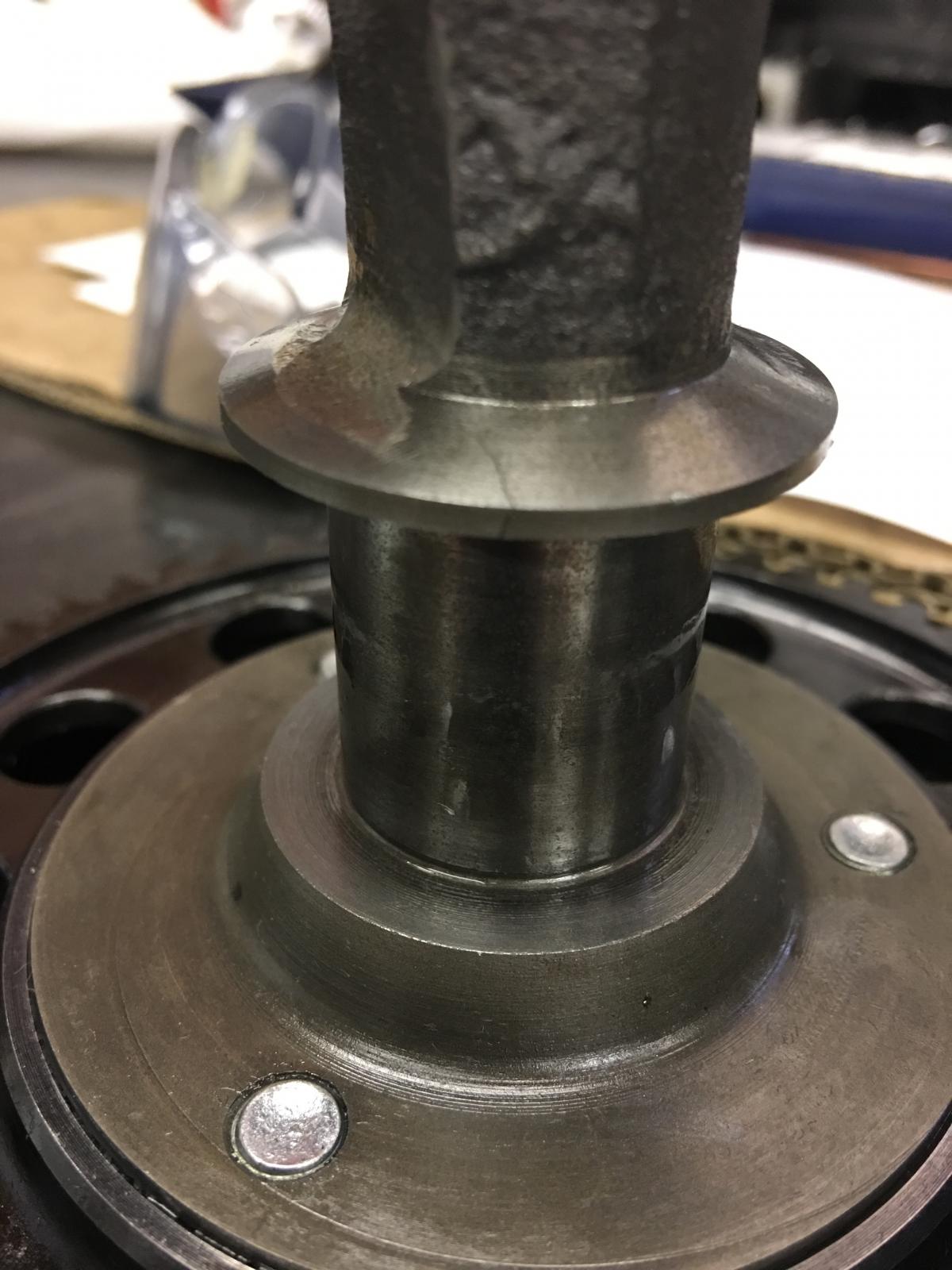

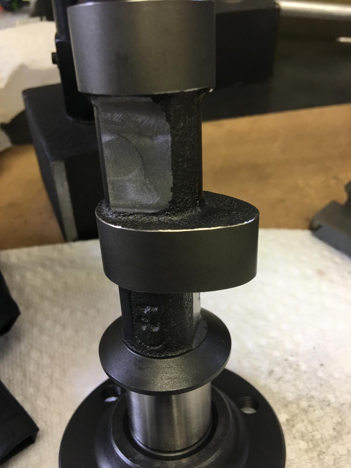

camshaft cracked on the thrust ,crap

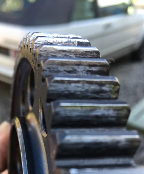

magnum timing gears done ,double crap
on a brite note all main bearings ok , rod bearings not bad
so clean up the case and start to slowly reassemble, this is where the time goes.
case is old school ARPM solid aluminum  , you can see i always calico coat all my main bearings , all type 4 steel backed
as well as sleeved lifter bores and center thrust conversion ,6 studded as well .

nice new cam HMMMM specs super secret , pre clearanced with a bit of extra in 2 spots ,more to come

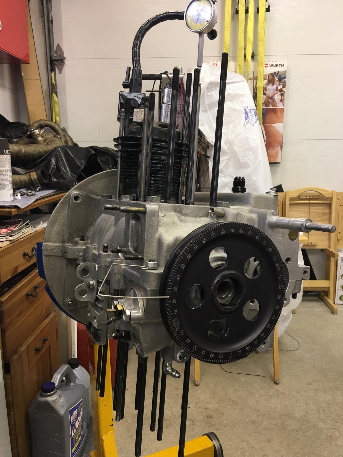

at this point all camshaft bearing work has been performed -- case has been assembled and disassembled multiple times .
testing both the crank and camshaft for ease of rotation when case torqued , again covered earlier in engine build topic .
for the first time cam and crank are in , #1 pointing up ready to slip on the connecting rod ,followed by the case half , #1 cam int and exhaust lifters and a few case nuts to clamp it together .
why , so I can install a piston , cylinder and a pushrod  to check and adjust cam timing .
this is a long topic , cam selection, rpm and torque , setting cam opening and closing events .
if you want me to get into it let me know , but for now lets see what I set my VWP #160 super secret fast cam to .
hey looks like I decided on 25 deg BTDC for the intake
and for the important closing 65 deg ABDC for intake closing

jumping ahead here to engine in and ready to fire .HERE is a good tip /what I do : yes grease the lobes and lifter face with the camshaft break in paste LUCAS grease but only lightly oil the lifters before dropping into the case
as well as oil the pushrod cup at both ends and fill the pushrods with oil . in my case as well I remove inner springs and run .006 -.008 lash .
reason is you want those lifters to rotate as soon as it cranks and assembly lube may prevent that .

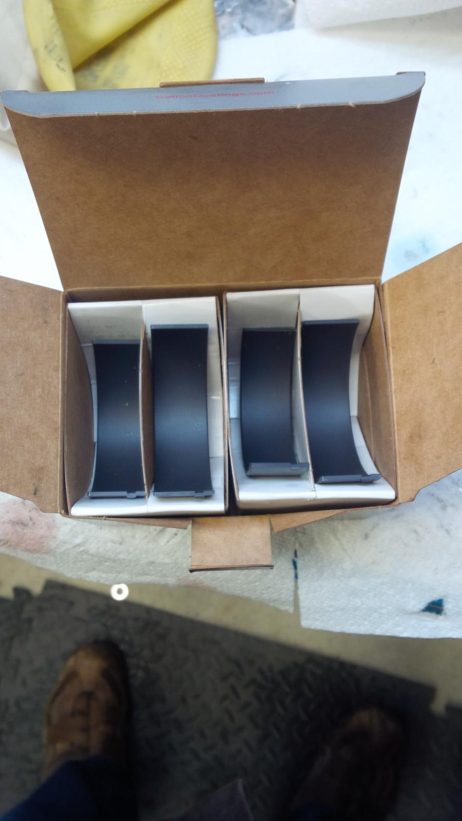

picture of the calico coated rod bearings

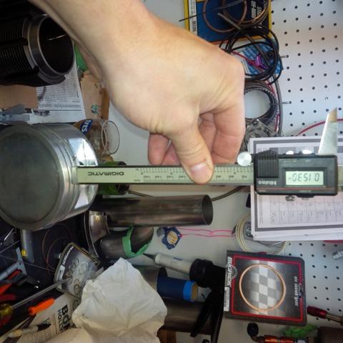

 CE custom copper head-gaskets , in order to get the correct size/fit you need some info:
bore in head - cylinder wall thickness and O.D of cylinder , measure it all up and supply CE / Dan Larson with the details .
wall thickness is larger on a pauter cylinder -- even thicker than auto-craft and way thicker than cima ,
that helps in keeping things from shifting as well as deforming under high load/ cylinder pressure .
-- jim add cylinder wall data here --
found a good picture of the bottom of the Pauter cylinders i was talking about , when ordering custom length not only can you now
eliminate those crappy barrel base shims and have your cylinders sit nice on deck of your block but can also order the cylinder skirt in the
length you want . mine are level with the very bottom bored edge in my block , this is a huge plus as it allows for full piston support during piston at
BDC . so instead of the piston pulling out past the short cylinder skirt its now fully supported , no rock there !!
now if you measure it all correct the end result is a nice tight fit ,also fyi: the copper gaskets will not measure .1445" in my case but will in fact

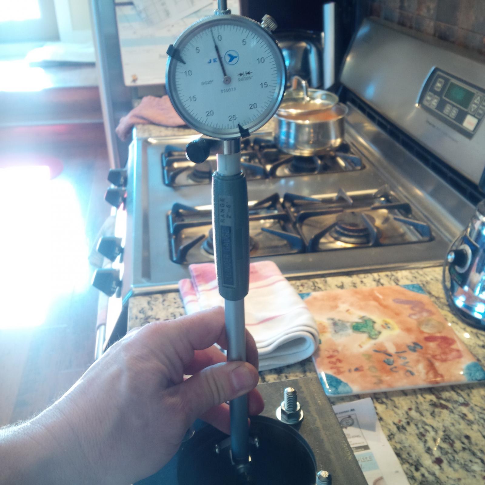

with my new Pauter cylinders it was time to test .
yep waited for Sherri to be outta the house and even went a bit farther by warming the cylinders in the oven to 100 deg
then into the torque plate .i measured in 3 heights - top middle and near bottom as well as 3 angles ,  2 at 90 deg apart then at 45 deg .
-- THIS IS WHAT I FOUND---
torqued the plate just as in the motor 4 mains at 32 LBS first and then the two 6th studs at 18 lbs .
yep this is no good cylinders no longer round .it was all over the map
you need to understand the needle is set at zero and anything to the left is smaller and anything to the right is larger than set cylinder bore diameter.
i played around for hours and tried different torque sequence and torque values even different cylinders ,this was a disaster i would have a avg of
-.0015 to+ .0015 when measuring the cylinder at different positions and heights .
--FOUND THE PROBLEM WITH RING SEAL AND HIGH CRANKCASE PRESSURES---
the fix ::
Started by torquing the 4 main studs to 15 then 25 lbs  and measure --still 100% round in every spot
-- torque to 30 then up to 35lbs on the 4 main studs -- dead on at zero
torqued 6th studs to 10lbs -- AND Bang CLOVER SHAPED by over .001" in spots,wtf.
so at least problem has been diagnosed . so from this day fwd have not torqued /used the 6th studs
basically a lightly dab of loctite and finger tight only .

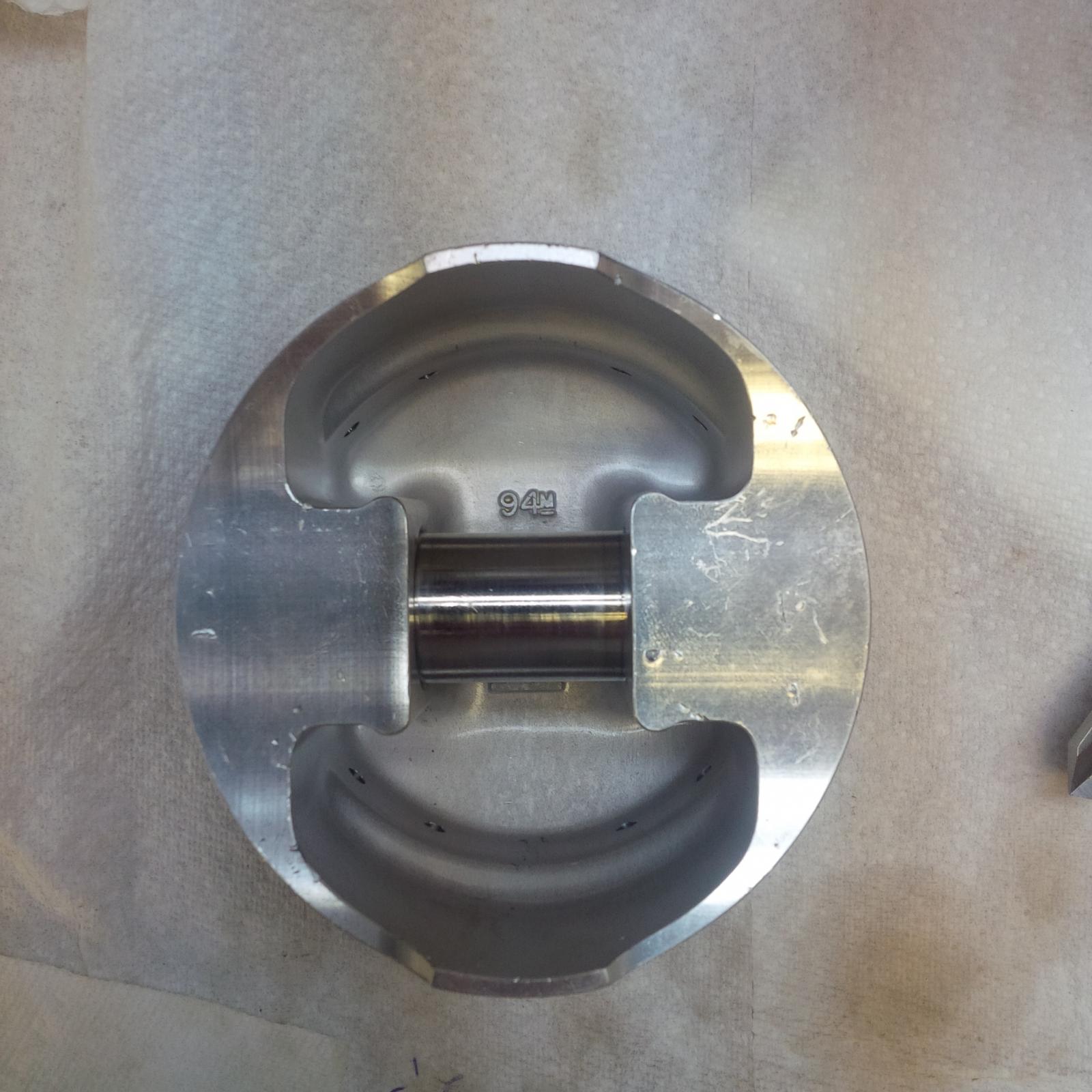

ok what pistons to use to take the abuse .
how about a set of old school JE pistons build for turbo use .
that usually means thicker area under the piston crown and good wrist pin support
yep there old and taking a beating have some love scuffs but not dead yet
nice thick crown above the top ring helps keep the piston alive by taking the shock and heat energy

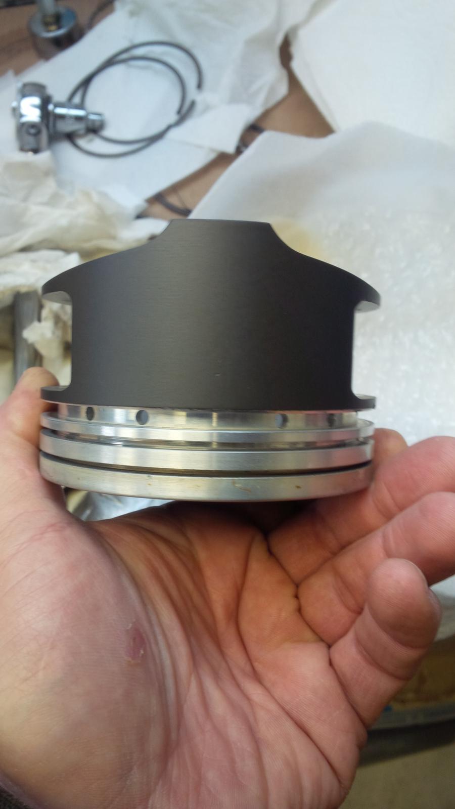

also this piston is what we call a full skirt which means the whole lower section of the piston is fully supported = very strong and less rock
ring pack is a nice 4mm oil , 2 mm 2nd ring and a 1.5mm top with a 5mm crown , ringback area of piston recessed to allow for heat expansion
replace the wrist pins with a much stronger pin , better be safe .there is a lot of force on those .not a place to skimp.
pins are held in with spiroloc type retainers from JE .
pistons also receive the calico treatment ,this really helps by adding a tuff layer between the cylinder wall and piston
in time of low or poor lubrication as well as taking up any excessive wall clearance you may have.i think it can be applied in 3 thicknesses.
light med and heavy . range from .001-.004"
b better make sure you cc the piston relief as well .
need that for that important compression calculation. mine are 4cc

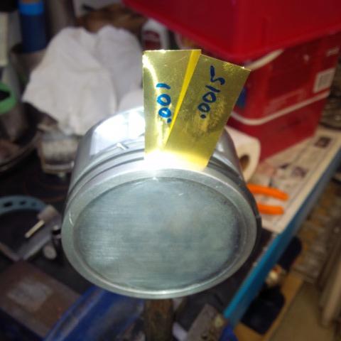

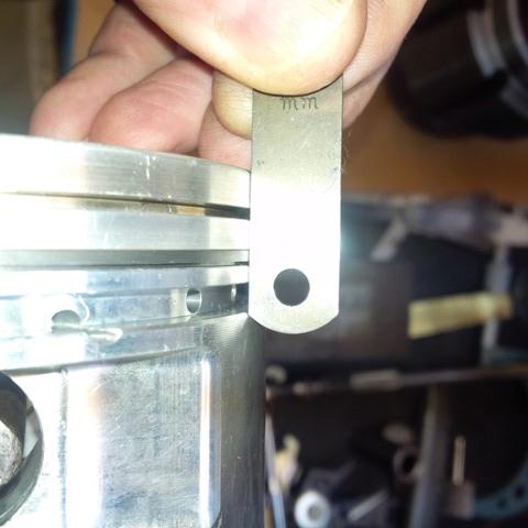

found some other shots ,almostly always overlooked is ring groove depth and side clearance.
looks like im measuring my ring depth .fyi: on my pistons all ring groove depths are different .both the top ring and 2nd ring require custom back cut rings.
always make sure your rings fit fully into and below ring grooves in pistons.hey that's a Childs and Albert Z gap in there
I use various thin pieces of brass shim stock for checking ring side clearance .
well rings must check out as looks like its end gap time .
-- jim add piston ring info here--

    Cylinder Heads ,everyone make such a big deal ,well there are a big deal because in the end they will be the last component you install that
will gauge you engine performance.there is of course a whole science behind head selection which comes down to strength needed ,valve size and port flow.
so not my area but I understand it .bigger is not always better and you be surprised on how well a small valved head will work .
    My poor beat up Frankenstein heads are on their last legs .and without the skills of Darren K they would be door stops.
but sometimes and in this case its not so easy just to bore and toss another set of heads on as the engine is already built around there dimensions
and its just plain to much work ,but maybe next engine overhaul ill tackle it and swap them out to a set of comp eliminators I have .
  These are the WOK's heads ,they are a set of very old original heavily modified ARPM heads, later they became super flow and then copied by CB performance as comp eliminators.
These ARPM style heads have a very well known issue of being very week in the top corners , so as you can see in order to stiffen them up and give extra support a casing was welded around the
fins as well as bosses welded on for the 6th studs all attempting to give more strength to a weak design.
  Some time ago I had talked with dominic lupino , [sorry for sure wrong spelling] .about a single replacement head stud .
At that time I think he was still owner of Bugpack .I also asked him about the original ARPM heads and he says Jim that's why that version of the ARPM head was scrapped and later replaced with the new super flow stronger version ,as eventually the ARPM heads will flex ,give or something and burn through at the top outer stud ,HMMMM seams I have had this .
Dominic advised me to replace head studs and increase torque so this time went to Racewear custom head studs ,and yes I bought spares !!! just in case .

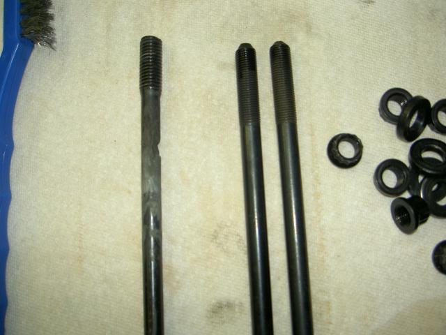

   well ,why the second time ? head stud failure or in my case loss of clamping pressure due to
poor maintenance practices or Chinese steel head studs , doesn't matter will not allow this to happen again .
when I pulled the motor and checked , torque on all head studs were all low .
Yep Darren fixed me up yet again ,Thanks Bud !!!
   how about some failure shots
heads studs seam a bit hurt
 yep that's a melt through #2 on #2
Darrens handywork , or in my case miracle dept .
  well like I said it was Quest for the 9's  ,all lessons learned ,major repairs done now time for final upgrades and assembly.
plugs have been in and out so many times time to timesert  the 14mm spark plug threads before its too late  .thanks Dave at high performance engines
once installed just double check to make sure the timeserts are not hanging into combustion chamber , if so break out the Dremel
