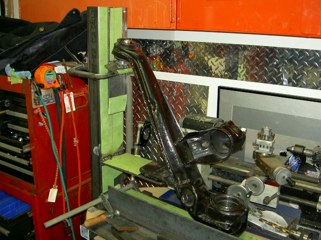

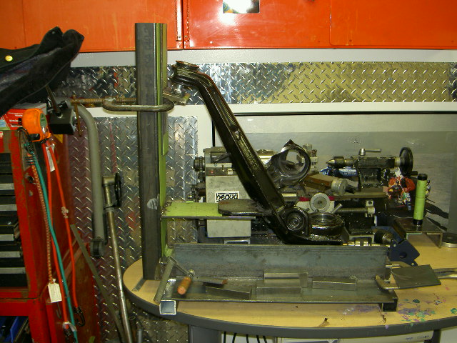

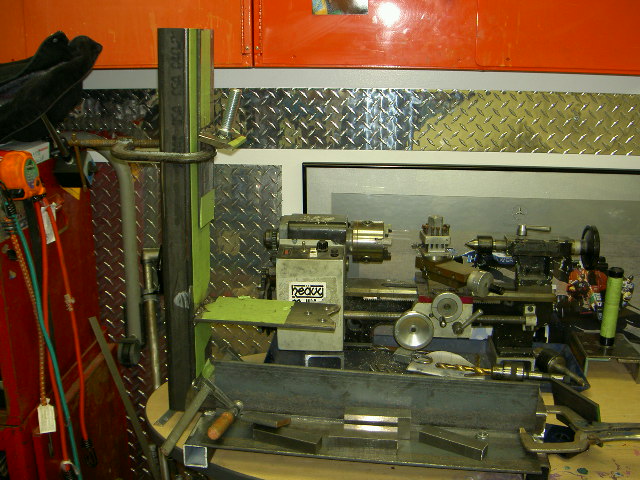

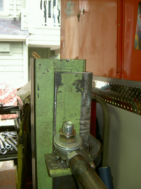

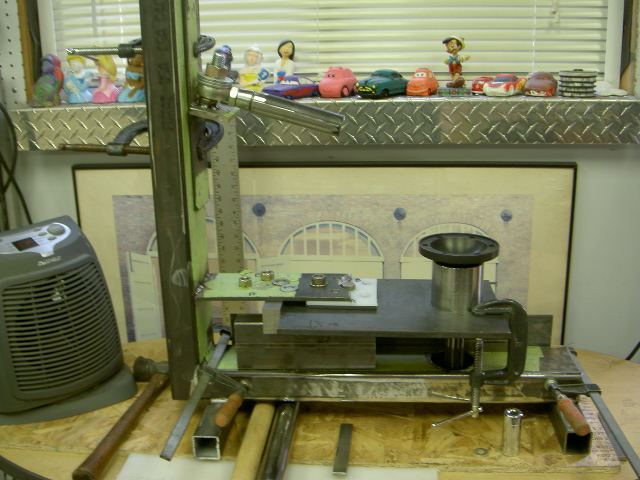

so i started by making a JIG based on a stock rear control arm .pretty simple, 2 sections of heavy wall rectangular tube welded at a 90 deg .lower support tubing welded on as legs to keep it stable and a removable fence to square the lower bearing support up .
this shows the right rear stock trailing arm sitting in place on the JIG to give you a idea .
in the above photo the JIG has been modified multiple times and is now a universal left or right JIG with the ability to allow for change in position of the upper pivot, raising or lowering the bearing housing point as well as allowing to narrow as much as needed.
when the JIG was first made i based it on a complete stock arm as i was going to use the weld in stock IRS pivots .
i was happy with the JIG until i decided to bolt in the left control arm ,that's when i found out that stock arms are made with the spring plate and the bearing support not parallel but designed with a few degrees of negative camber .this just killed the universal JIG idea and with the decision to now make my own inner pivot based on a heim joint the JIG was modified to allow for the above listed 3 changes .
yes i love green tape but it sure allows you to make some good pen marks .
this is it the last version of the jig .
the inner pivot point moves up and down and is centered in relation to the centre bolt of the spring plate and you can see the pen line that is the reference for the bottom and top sections of the jig .the spring plate mount is also welded at 90 deg to the rear support of the JIG .also a large hole was cut after to allow for the stub axle to hang through a little later on .
now you can see how it works .
stock arm and first version of test arm
you can see how the fence allows the bearing housing to be squared up for either left or right sides .it is spaced with a 1/4" plate off the plate to the mounting edge of the bearing housing and to make a narrower rear control arm i needed to add spacers below the bearing housing .very simple .
this is a picture of the test control arm during some point.you can see its been hacked a few times ,the heim joint is now in and how i allowed for in and out adjustment of the rear wheel while the arm was mounted in the car . it was needed as fender and spring plate clearance was very tight and i could slide it in and out as needed.

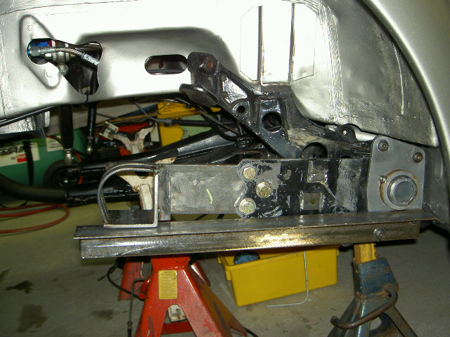

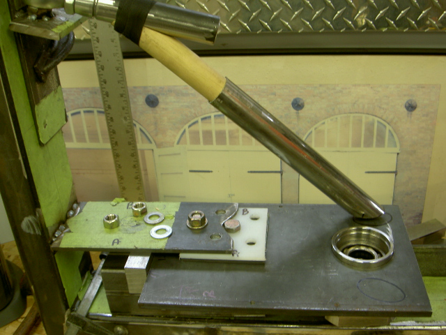

next step was to locate a set of IRS spring plates , Bruce T was nice enough to lend me one and from that a template was made and transferred to my adjustable swing axle spring plates . and with a bit of trimming and drilling had a set of homemade IRS spring plates .if anyone is drilling spring plates use a speed of around 650 rpm and correct cutting fluid and it is no problem .
test arm fitted to the modified spring plate .what you cannot see is the temporary adjustable inner pivot tacked to the torsion tube .this allowed me to move the pivot position up or down which in turn allowed for camber adjustments  based on the tire position .at this point i had set my new ride height and set the camber of the wheel to 0 deg as a starting point . its not pretty but its a start .

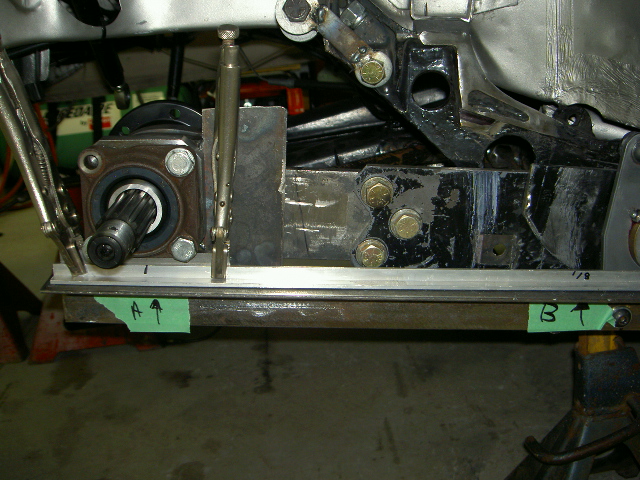

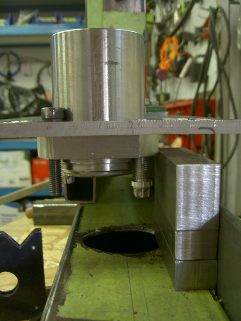

with the bearing housing slid into place and using a piece of angle iron bolted squarely to the spring plate the test control arm was set 90 deg to the torsion tube .
best to start square by measuring from the points 'a' and 'b' to the outer edge of the angle iron .
tire on and for the first time was able to see if this was really going to work , i had no idea if i was on the correct path .
the new ride height which is allot lower than before , i like it when the line around the outer edge of the tire just lines up with the lower edge of the fender
jacked it up to the end of travel , not bad

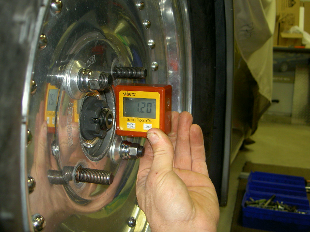

and at full compression the camber was great at -1.20 DEG
as anyone would be i was pretty stoked as it looked great but now it was time to start checking for clearance .

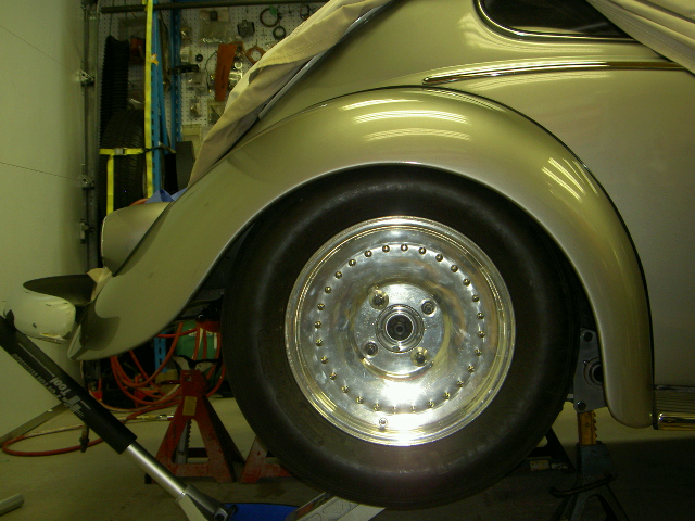

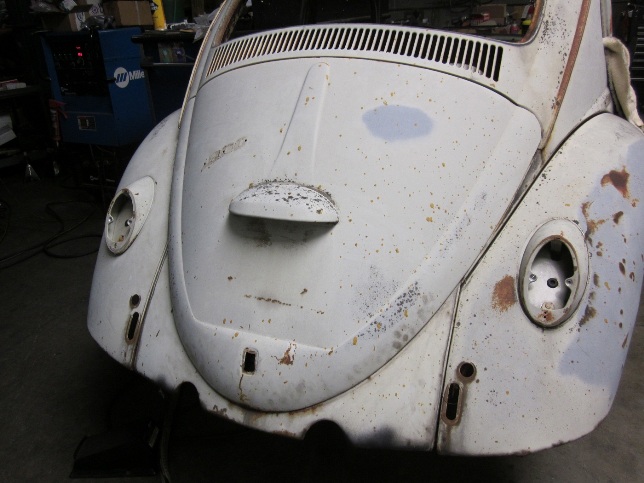

anyone putting a wider rear tire under a vw rear fender knows fender clearance and in my case adjustable spring plate clearance is always a concern .
i would need to address these before continuing .with a swing axle setup .fender clearance is not to bad because as the wheel compresses it also tilts in allot which pulls the tire away from the fender but gives huge negative camber . because my wheel is staying fairly flat i dont have that natural pull away to give needed clearance .
brain storm , called john at M and H and asked the questions based on 130 mph
 what he says is he would like to see 1" clearance at all points but he knows its not always possible .
i have 2 sets of M and H tires one is the DOT 215/65/15 and the other is the straight 26/6/15 slick .
what he says is the side wall is stiffer in the DOT and will limit growth and sidewall flex when turning or getting squirrely a bit more than the straight slick.
from his experience he sees about a 1/2" growth total height so that would be 1/4 per side if you think in that terms .also because of this the sidewall gets narrower with speed this does add sidewall clearance .he has seen cars with side clearance with 1/4 " rub or not rub so it depends on the vehicle .
his recommendation is to put the DOT tires on and make some none balls out runs and check for issues , then increase speed and check for clearance issues ,then proceed with the slicks . good advice .so he figures i'm safe but i need to check and proceed with caution .
 i have made my own fender bead roller which worked fantastic as well as modified the spring plates which will be brought up later , these 2 mods allows for a pinky finger of clearance at both the fender and springplate.
so with the fender and spring plate clearance issue dealt with it was now time to start playing with how far i could push the wheel up .

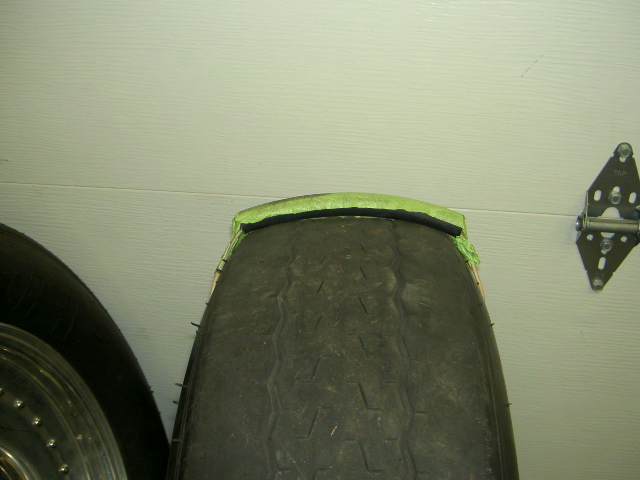

wrapped a 3/4" OD water hose onto the slick and started spinning it until it just rubbed ,you can see the contact point on the green tape.
it actually rubs on the inner wheel well on the body .wanting to not have to limit the compression height i would need to increase that tire to inner wheel well clearance .
easy solution is to pull the tire back to the rear .started working on making the test arm longer and it was abandon in favor of raising the complete bearing housing 3/4" up from its current centered position ,poor test arm hacked up again .this allowed the tire to rise up but because the spring plate does not need to move as far up anymore it also did not pull the wheel as far foreword .problem solved .
again same photo but notice the bearing housing is centered with the middle bolt on the spring plate and in the second photo the bearing housing is well above that middle bolt
there were a few more modifications required to the inner structure and a few not done yet that still need doing  .but trying to get this thread caught up quick and up to date .
note : the inner pivot point is not that big of a mystery , but actually is a great spot to allow you to change or adjust your camber settings .anyone welding in there stock IRS pockets could use this point to adjust and make camber changes before welding them in .

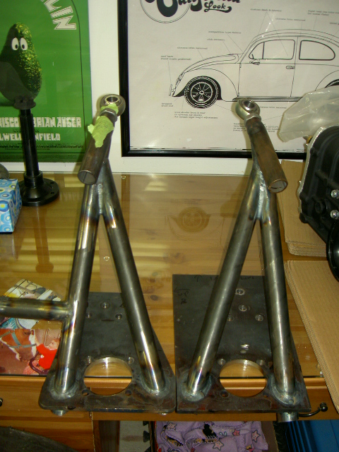

  Well time to start building my own control arms now that all the calculating and testing is done .my control arms will end up being. raised,narrowed ,lighter,stronger ,simpler,and allow for easy camber, toe  and depth changes .tall order but should all be doable .
time to gather material .
« Last Edit: April 26, 2011, 06:16:19 AM by jim martin »
Re: Jim Martin
« Reply #222 on: April 26, 2011, 12:14:16 PM »
When I was building my trailing arms, I had much less clearance than that.  However, I was using a much stiffer tire that didn't squirm around as much as your DOTs or slicks.  I had 1/8" clearance to the tab on the TA that connected to the spring plate, and slightly less at the 12 O'Clock position to the fender arch.  From that, I learned you need more clearance the lower you move down the tire.  During cornering, the contact patch at 6 O'Clock is where the tire is getting pulled.  So max deflection happens there, and the minimum is at the top.
Billyisgr8
Re: Jim Martin
« Reply #223 on: April 26, 2011, 12:53:57 PM »
I wonder at launch how true the tire stays to being round.  Dragster tires become severly distorted from the turning rim  which pulls the backside into being almost flat which gives the top more of an arch.  This is very extreme example, but maybe Darren has some slow mo launches that show his tire moving around some.  Our 26" tire wouldn't move anything like on a dragster, but you really don't know what the movement is until you are trying it out in a drag race start with some 1.5's 60's.
Nice write ups so far on the step by step Jim.
Kevin
Offline jim martin
  • Posts: 1406
Re: Jim Martin
« Reply #224 on: April 26, 2011, 10:26:12 PM »

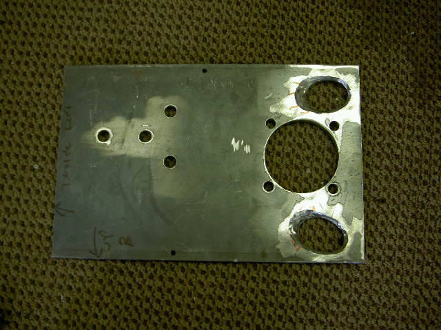

  again sorry for a non super detailed write up as this year i dont have the time and there is just so much info in the starting stages that was acquired i could never type it all up .but hopefully this shows a to the point approach so far.

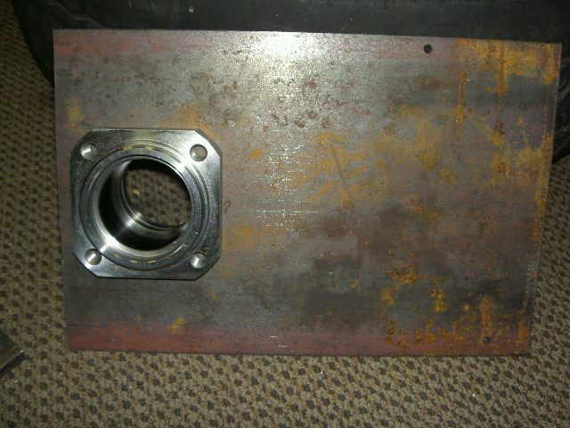

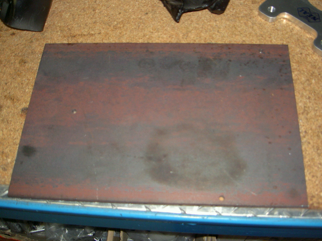

the bearing plates are made of 3/8 " steel plate over 1/4" plate .because the way the arms are being built .weight over flex wins .
reference : a  8" by 12" piece of 1/4" plate was 7.5 lbs and the 3/8" plate was 10 lbs . with 2 pieces of plate on hand the DOM 1 1/4" OD tubing was also purchased from metal supermarket .
  the 3/4" high strength heim joints and weld in threaded collars were picked up from John at Chief Chassis .and yes there is a difference in quality and strength  ,please dont assume just because its a 3/4" heim joint its strong .you better check the strength as you will find out many cheaper or off shore heim joints are no way near the strength of high quality units.
   the bearing housings are a weld in stock type available from any vw parts supplier as are the bearings , seals and 930 cv joint size stub axles .the rear Neal disc brakes were purchased from Fun runners.
you can imagine all the checking and test fitting leading up to this point that has taken place, and even after all that i still came across one last change before i started on the jig assembly .i will save that photo for last as it shows the whole concept that allowed for a unique design i'm quite proud of .we'll see if anyone picks it out .

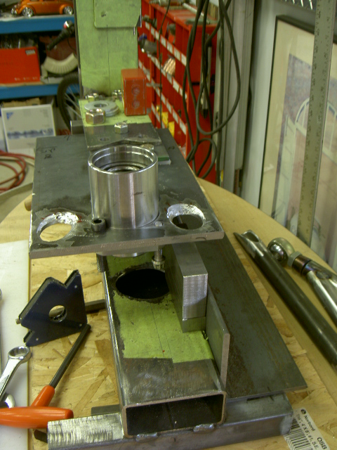

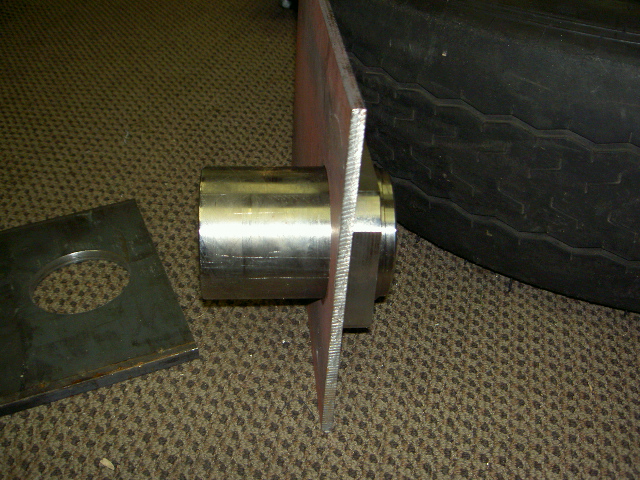

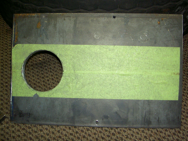

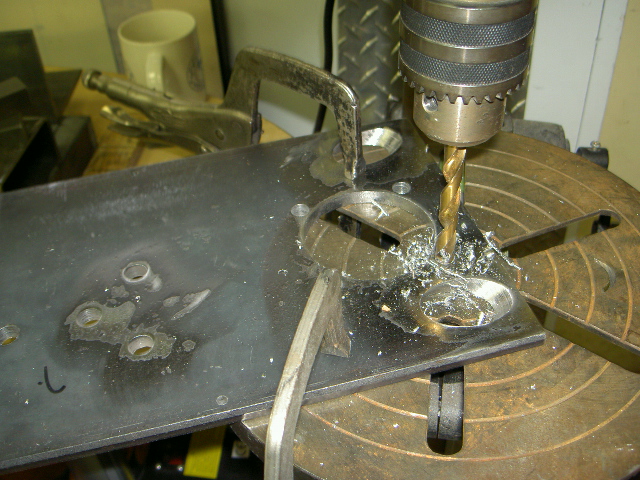

like i said as i made each piece a duplicate was cut at the same time .starting with the 3/8" bearing plates .
both plates were pinned together with 2 small roll pins so both pieces could be cut and drilled at the same time making sure they were exact duplicates
the plates were marked in half and 1" from the end a 2 7/8" hole was drilled .

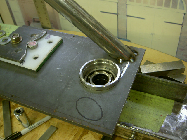

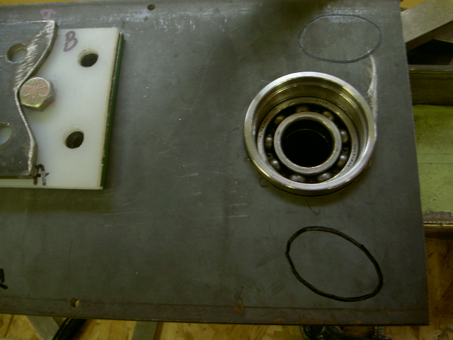

here we go , with just a little around the world sanding of the 2 7/8" hole the bearing housing slid in perfectly .
nice and flush , these bearing housings are designed to be welded in , but i will go another route just in case something goes sour and it needs replacement
or modification down the road

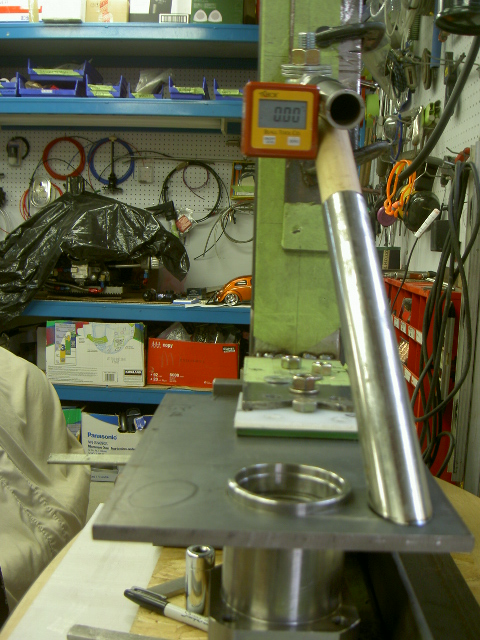

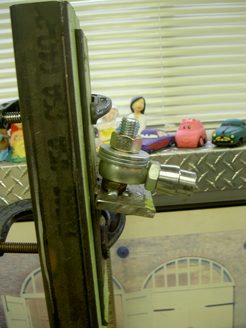

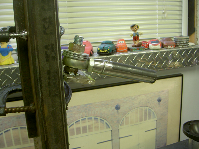

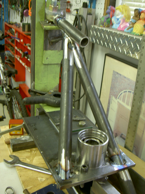

the inner pivot point has been lowered 1 1/2" but the 3/4" bolt retains the stock pivot point angle .the heim joint sits on the bolt and the 3 washers are stacked on top .the first washer has the ID bored to allow the inner ball of the heim joint to sit inside it and the other 2 washers when tightened down square the complete assembly and stop all movement .
   added the 4" piece of tubing up onto the threaded tube collar ,break out the tig and tack the tube to the collar .the threaded collar allows the heim joint to adjust in and out as well as gives a good solid welded connection
   now a picture i do not have is of the master bearing plate template , when i pinned the two 3/8" bearing plates together to bore the 2 7/8" hole i also decided to pin 1 more piece of 1/4" plate to them .now i had a master plate to work from .and as i worked on the first control arm , any hole that was drilled was also copied to the 1/4" master so it was just a matter of pinning the 1/4" master to the new 3/8 " bearing plate and use it as a guide for boring the needed fwd 1/2" mounting holes , worked fantastic.also i kept a thin cardboard template that i laid over the 3/8 plate and marked the location of the diagonal tubes .it will make sense as the pictures come up .
  with the new bearing plate fwd holes drilled and diagonal arm holes marked time to mount up the new bearing plate to the jig.

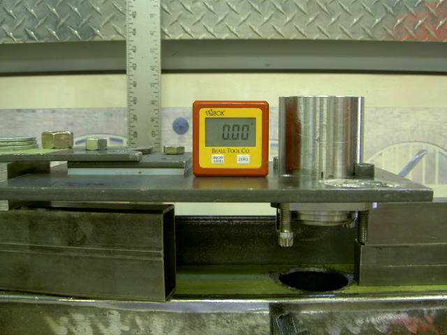

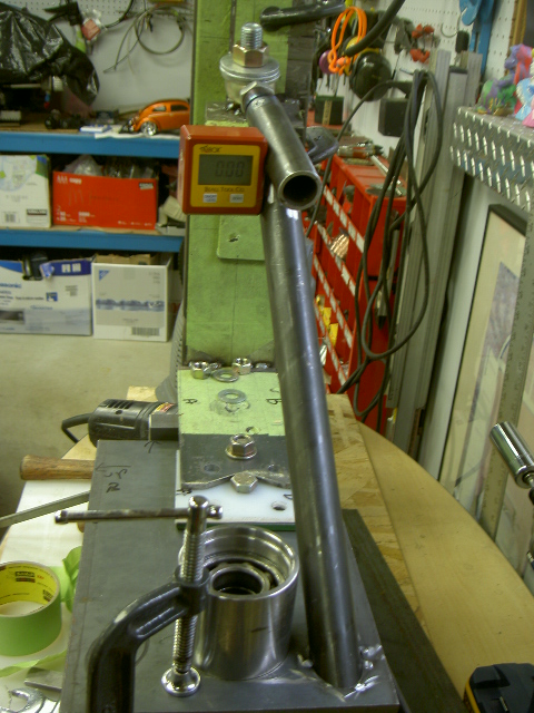

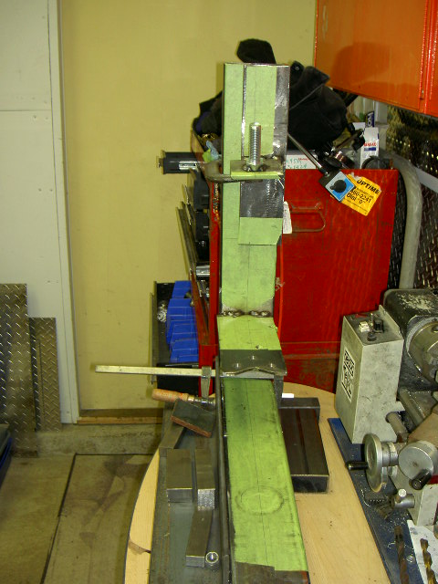

  i had mentioned before how the jig is made universal, and it does not matter whether you are making a left or right arm they will turn out the same  .this is how the bearing plate and bearing housing mount and get squared/centered to the jig or in this case raised 3/4" up .
 on the right side of the jig is a fairly heavy piece of angle iron clamped to the lower side of the jig used as a guide , and for reference if a 1/4" shim was laid vertically against it. then the outer edge of the bearing housing was slid over to touch it the stub axle would be 100% dead centre to the complete assembly , look at the pen mark on the green tape it shows the centre of the lower part of the jig. what has happened now is there are 3 blocks all 1" thick .i needed to stack them to get the height .so take out the 1/4" shim and add back 1" of shims between the bearing housing and the heavy angle iron guide and when the bearing housing is slid over and just touches the 1" shims, the assembly has just been raised 3/4" above the centre line .at this point the 1 fwd bolt was tightened very well  to keep it all in place .

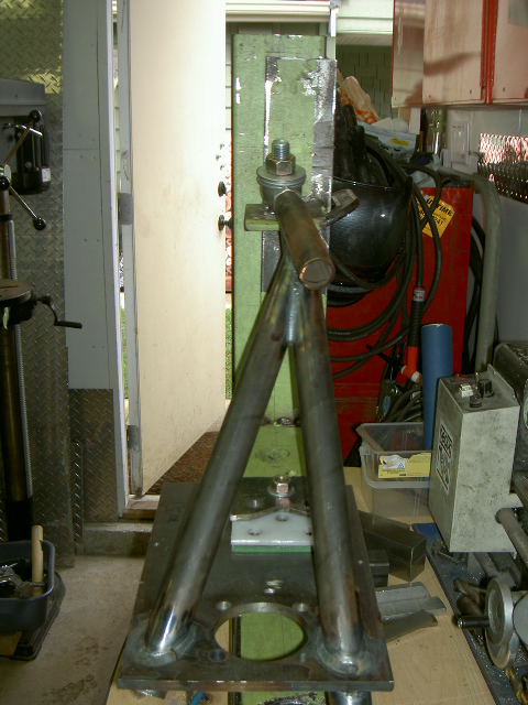

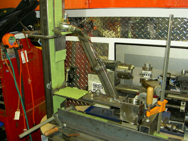

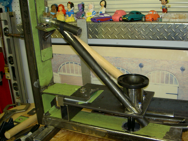

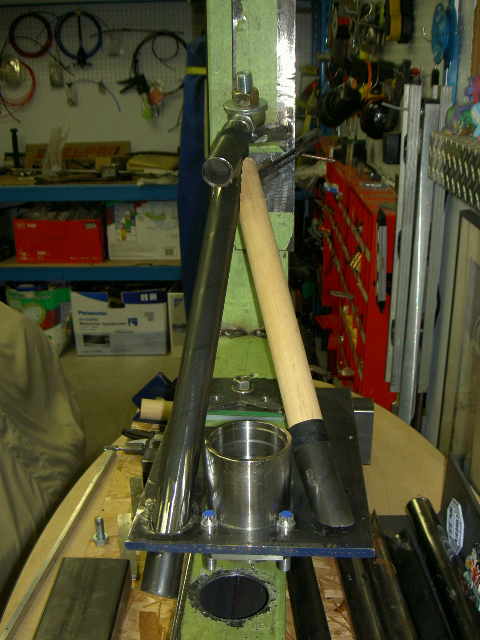

 time to get the diagonal arms in , sorry i do not have a picture of the tube notching jig in use , i will see if i have one and post it .but like i said i made duplicates of all pieces when the first arm was made .now something i did was use 1 1/4" wooden dowels to test all my angles .way easier to keep trimming wooden dowels than steel tube .once i was happy with the fit and angle i would just replace the wooden dowel in the jig with the 1 1/4" dom tubing and cut the same notch . in this photo i have taped the first diagonal test dowel to the 4 " stub piece from the heim joint and with a thin wall 1 1/4" ID tube slide over top of it with the end cut at the correct angle .
slide the tube down the dowel and line it up onto the marked holes.you can see something is odd here .there are white shims between the 3/8" bearing plate and the mounting arm welded to the vertical arm of the jig.the mounting arm is welded to the vertical arm of the jig at 90 deg and its centre mounting hole is again centered to the jig .if you remember in the earlier photo with the stock test arm it does represent the length of a stock spring plate .that's all can say for now.

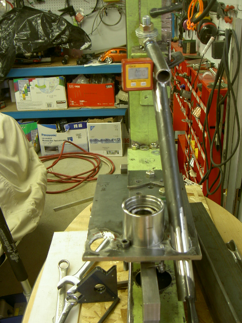

 if you dont own one go buy one of these level boxes , they are magnetic and are fantastic to work with .i think i paid under $ 25 up the road at lee valley for it .the complete jig is level in both directions and keeping things equal and square are a must when trying to duplicate left and right parts .here the 4" stub tube and the first diagnal tube are squared up .you can see the inner pivot and mounting plate centre hole lining up centered as well
tack the lower thin wall tube to the bearing plate

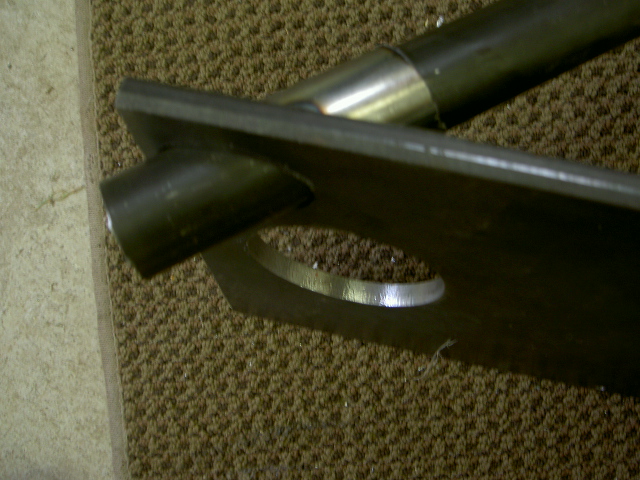

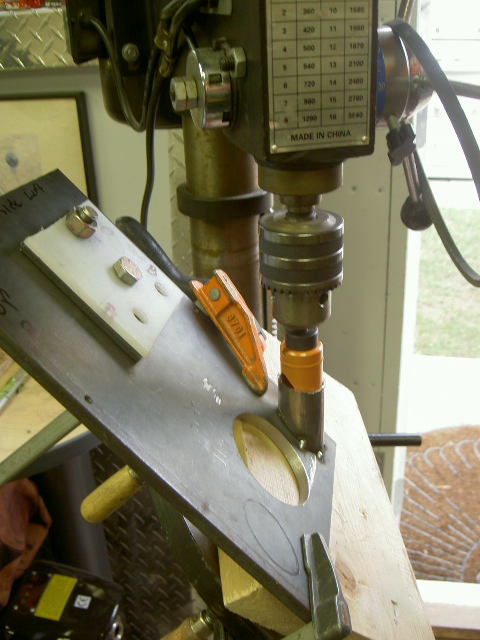

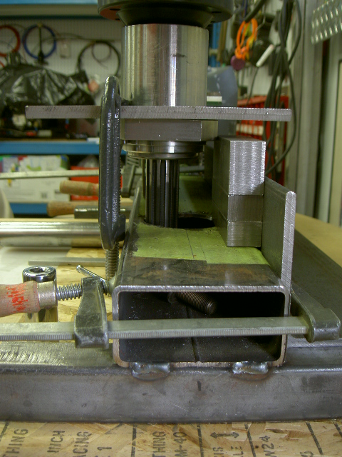

the lower bearing plate is again removed from the jig and the thin wall tube is cut leaving about 1 1/2" on the short side .simple now loosen the drill press bed .and wind it up against the 1 1/4" hole saw .it almost adjusts itself , well almost .snug up the height and bed angle pinch bolts and clamp the assembly to the drill press .test the setup by raising and lowering the hole saw into the tube , it should go with no binding .
drill away as the thin wall tubing is now the perfect hole saw guide .
test fitting a piece of the 1 1/4" dom tubing and it passes through no problem . it was decided to do this instead of welding to one side of the 3/8' bearing plate as welding from both sides as well as the tube passing through the plate would be allot stronger .
back to the jig and mount it all up again , square up the lower bearing plate as before , slide the new first diagonal arm into place and using the level box square it up .
sorry had to use a photo from the first arm , but i think you get it , same thing again using the wooden dowel for test fit and the thin wall tubing as a welded in guide .
remove again and mount back to the drill press as before and bore the 2nd 1 1/4" hole through the plate
something i have not mentioned is how difficult it was to design the arm and actually get room for the shock and 930 flange to clear and work together . i lot of sleep was lost over it but it all worked out .this shows the holes in the bearing plate drilled and the bearing housing bolted to the plate with the stub axle in place .just making sure it clears as it is tight.
the complete assemble was again removed, the 4 bolt holes for the bearing housing were marked and drilled . you can now see the fwd 4 bolt  holes , i will tell you the most fwd stock location one will go.
here it is the completed lower plate , wow that's a bit of drilling .its in the process of getting all the scale cleaned and prepped for welding .where the red marks are points i would bevel out more to allow for better welding penetration .
quick view, time to get it done . bearing housing bolted to bearing housing plate and shim blocks back in place
slide assembly over just till it touches the 1" shims and snug up that 1 centre bolt ,note the notched diagonal tubes prepped and ready to go
make sure its level
slip in the lower diagonal tube and 4" stub tube and square it up .tack it in place
install top diagonal tube and tack it in place
tig welded and left in the jig to cool
this is something i did not notice right away .the top pivot point was actually pulled down 3/16"
no problem its still all square and gives a bit more clearance to play with on the torsion tube

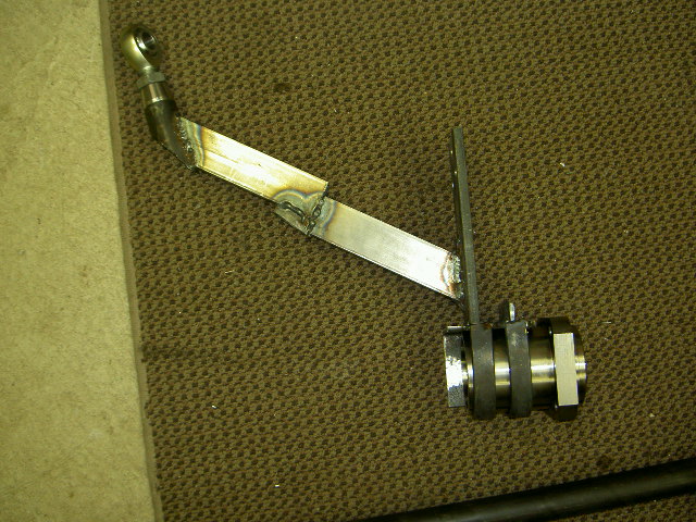

all done both arms .the finnished arm just needs to be trimmed and smoothed

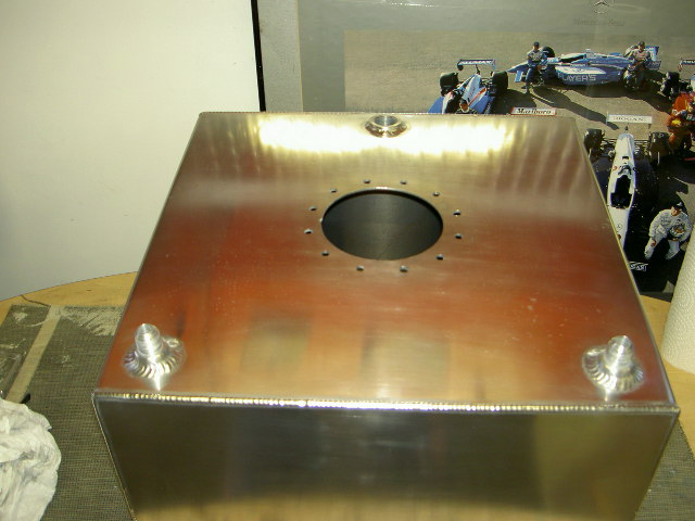

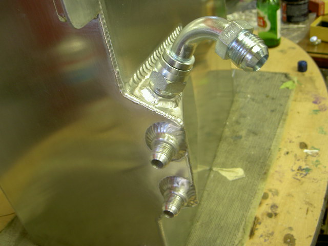

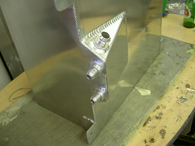

fuel cell was dirty so out it comes and since i needed some more tig practice i decided to weld on some fuel bungs
AN-12 in the sump and a 3/4"npt on top .
also i found a fuel leak and rewelded the bottom seam , good thing that c-16 has blue dye you can sure tell where leaks are .
suckered my youngest daughter into helping polish up the tank and mounting plate and now its off to the anodizers for military type 3 hardcoat .
