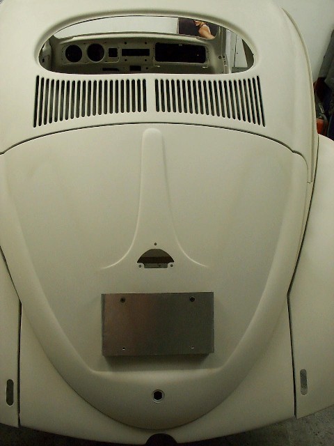

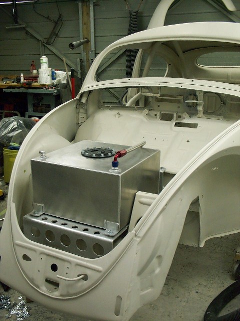

well after last sunday with TATE i had instruction too make sure everthing thats going on the shell is finished ,so i figured i would start at one end and finnish at the other,step one was drill out 2 broken bolts for the frt bumper mounts,then do the finnal fit of the fuel cell.
you can see the cell rest on a aluminum plate and is supported in 3 spots as well as the fuel guage area now has a spot for my autometer head temp guage.
well it sure stands out up there but it is in and is secure,  i never intended too reinstall a steel frt clip inplace of the original glass nose i had on ,i probably would have a stock modified tank up there ,but this works great with my fuel system anyways.

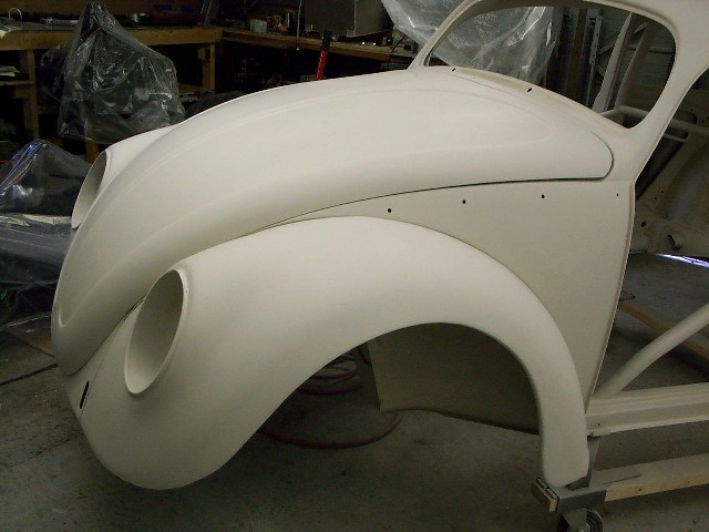

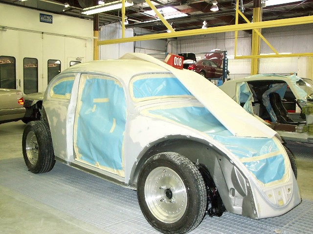

as per TATE'S wishes i remounted the frt fenders and hood.the left fender needed a bit of work but the right needed only light finnishing ,i figured this is a good shot for anyone running these fenders as they can see the area's that needed work as well as the hood on the middle left side.kind of has the empi inch pincher effect.
peek a boo ! looks good and everthing lines up great!great products and great body people are a must for any project.now i got too think if i want too run bullet turn signal or not ??
now you tell me ,is it a complete glass frt end? all steel frt end ? or a combo of both? can't tell? well thats the idea.looks good too me especially considering a few months back i was hacking what was left of the frt end off.end result deffentally worth replacing the frt clip . i  think i will offer a prize too anyone that can tell hom many modification are on the car as well as what's original.

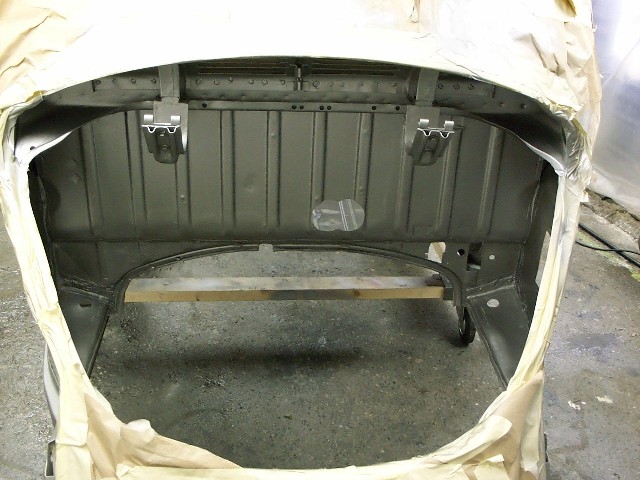

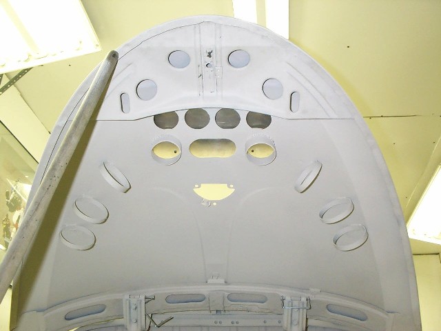

well i finnished the finnal bits of things that needed prefitting onto the car before paint,headlight assembleys too fenders have taken alot of time as you would expect in the mating of 2 aftermarket parts . as well as my one piece door glass moldings'no picture' have too keep some things hiden took a fair amount of time
as well as figuring were my tubes for RAM AIR are going to link up with no motor in takes a bit of patience.from the outside you will see nothing ,great!
sorry no shot of ducting behind aluminum tilt frame
but a shot from the inner and i think you can see were the tubes will hook up too the ducts behind the licence plate and join too the carbs.hope this will allow much wanted fresh air too the carbs ,as the 4 lower holes will allow acces air out.circulation thing.

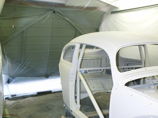

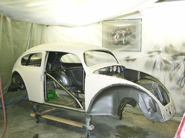

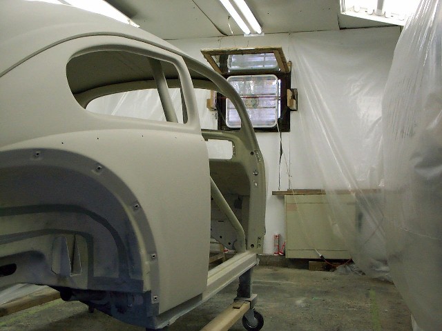

well its been awhile but alot has been going on at home/work and that means less in the garage,but i took some time off last week too get caught up somewhat.painting a car is a stinkin slow pain,there is so many steps .
but i needed too get some colour on this car in order too get the garage cleaned so i can get back too the mechanical end of things.
want too paint at your house ,easy first cover all walls with plastic and hose floor too catch any dust ,at one end -air intake add furnace filter,
add away too suck fumes out and you are set

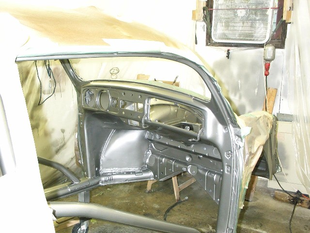

well i wish it was that easy ,as i had alot of things creap up and made my share of mistakes.hopefully tate can fix a few later when he returns from vacation.
---well good-bye 'WOK' and helo 'LED-ZEPPLIN'

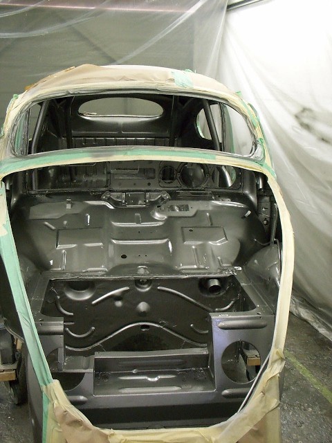

shot under the hood hope you like the colour
i snapped a few shots so you can get a idea how it looks.

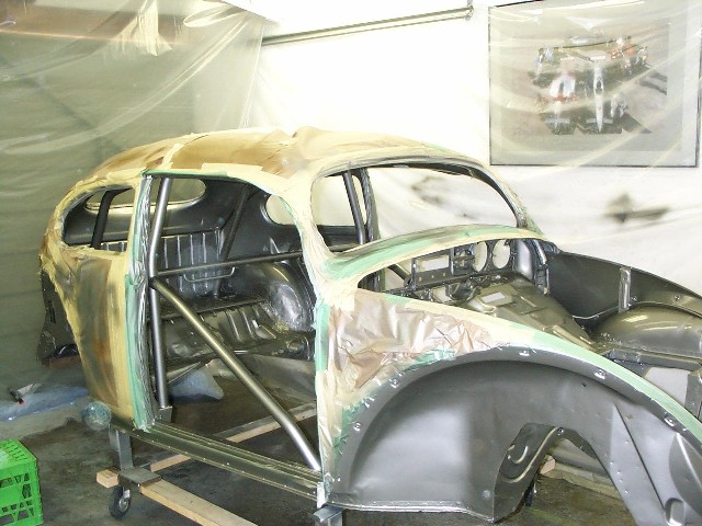

engine area is done with base and 10 % hardner for ease of repare in the futre -no clear here
dash looks good ,TATEneeds too fix one spot so only one coat of clear on there at this time,would have too have a oops there :wacko:
took it out for a walk ,see already doing wheelies
well time too stuff it back inside , you can see how the garage was set up -
worked very well.
NOW!i can get back too the pan and get it ready for the shell,garage is cleaned so this friday i'm spinning wrenches again.time too put hardware back in and fix a few thing left on the pan i never got done.once the shell is back home i will reassemble the car too driver stage minus doors and fenders and eng and trunk lid and take it in for the outer paint,then its street time,well getting there , can't wait

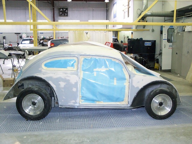

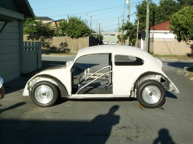

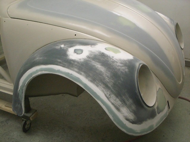

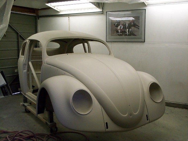

well last week i worried for nothing as this last weekend TATE, master bodyman came too fix my painting woes.well it wasn't that bad and because of it the interior has turned out even better,what i did was use a high pressure gun with low pressure which made for a heavy coat of clear.
so what was lucky was the aplication of base under it was even so we sanded down the clear with 600/800 grit untill under the hood and interior were baby bum smooth, just like when you colour sand the exterior with 1500 grit,same idea.this left a flat surface too lay down a very thin clear layer,WOW!!!i'm pleased.
here it is all unrapped and waiting too go back on the pan.will attempt this wensday night if i can get the boys from work too help.beer and pizza works.
you can really see where the application of the base / clear and the base/hardner area's are
SO ITS OVER NO MORE BODY WORK IN THE GARAGE !!!!!

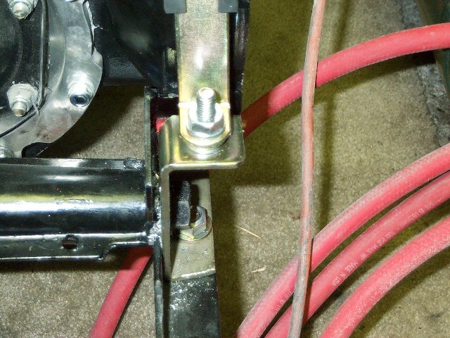

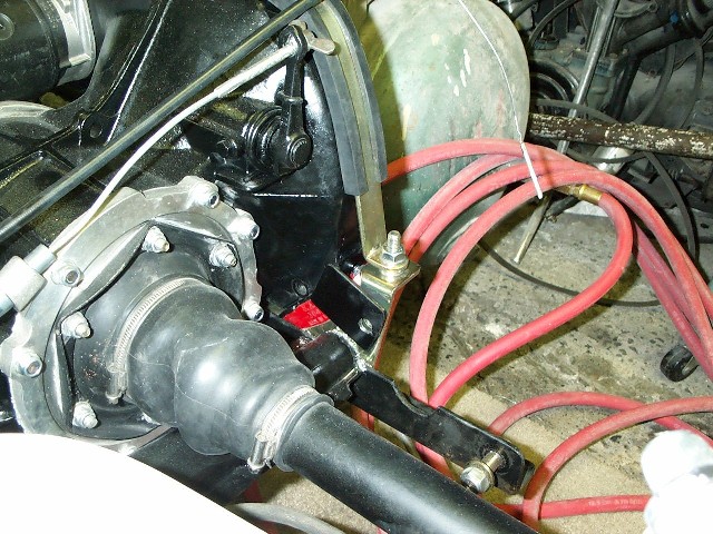

that leaves the mechanical !! so in order too ready the pan there was one spot that needed attension and i think it turned out great.my rear urethane mounts were in bad shape as well as the small colars were pulling into the trans housing .so i made a plate too sit against the trans between the mount and the trans housing ,this will keep the colars from pulling into the housing,as well as after looking at it a bit ,i thought why not make a
urathane/solid mount set up. so on the back of the plate i welded a tab that will bolt onto the rear trans carrier.
you can see the space between the tab/support and the carrier,just install the thick 1/4 inch washer add bolt and instant solid rear mount for racing.when done racing pull bolts and washers and vibration free cruising.
well lets hope it works??as you can see i love mechanical stuff.

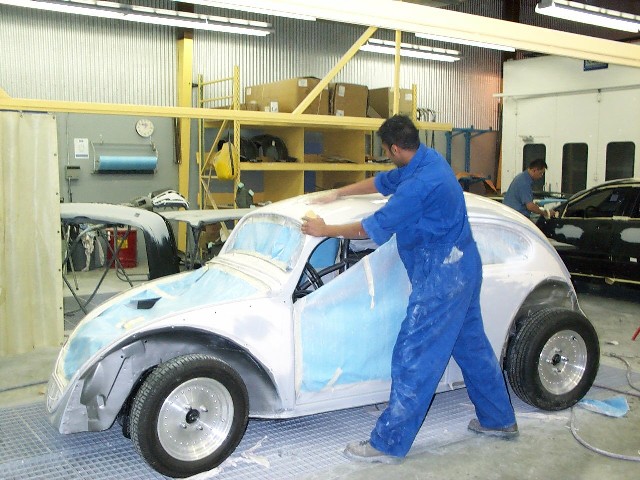

turns out the paint shop is a bit slow . so tuesday morning the car and its parts arrived.
today ,friday i have been at the body shop all day helping out. if you have never understood the prep procedure it goes like this.after car has been block sanded with 220 grit it is final primed,then it get guide coat sprayed on ,and is block sanded with 400 grit,any spots that need repare are fixed now and resanded and primed again,then the whole car is again resanded wet with 800 grit.my god what a deal and a mess,then it is washed down with a special solution and masked off for paint.sanding never ends ,this is HAMEN , who is one of the prepers at the mb body shop and is doing a above excellent job on my car.i can't thank him enough for all his time.
ready for paint on tuesday.

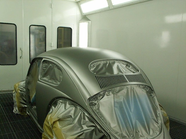

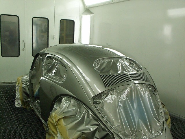

well i havent been this happy in a long time.    paint is on !!!!!!!!!!!!!!!!!!!!!
stopped by the body shop at 3.30 today and caught BING master mb painter after he had laid on the second coat of base,this is the time where you look for any last minute flaws and fix them before more coats applied,well 2 more of base to go for a grand total of 4 base coats.looks like powder grafite to me
stopped by at 6.15 too check out the finall results.saw BING and he says it turned out great,coming from him i new it was good.what a differance some clear makes.
man oh man i'm pleased,well will tow it home tomorrow and let it mellow out in the garage a while,got too love the smell of fresh paint.
doors and fenders will follow soon. the car will sit and cure awhile so i will put my motor back together in the evenings.
