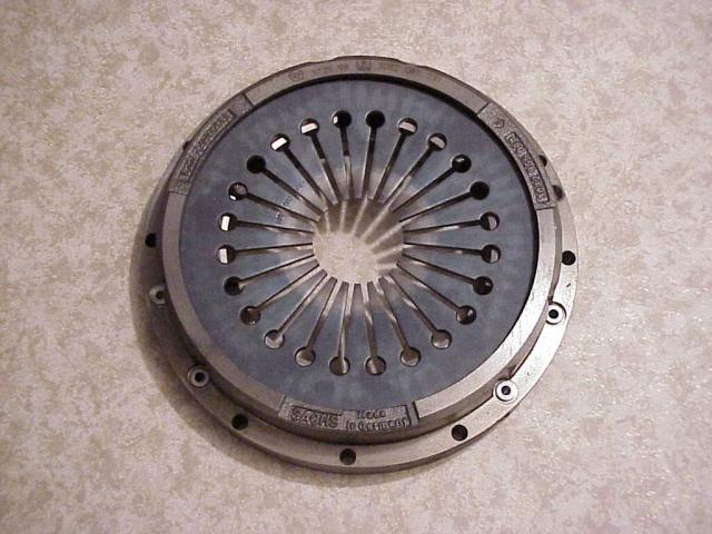

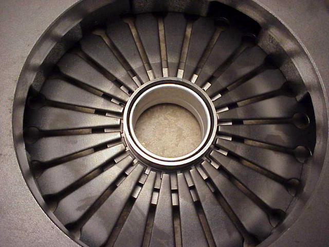

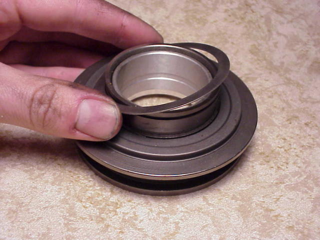

It's a little different than a beetle set up and this was my first time doing a Porsche clutch so I took the time to look on the web and see what info I could find. I had the manual but it turned out that the site I found had great step by step info and pics. The pics came in handy when it was time to instal the throw out bearing. Unlike the beetle the Porsche T/O bearing is attached to the preasure plate.
Here is the site, www.pelicanparts.com
These are some of the pic's from their clutch instal tech article.

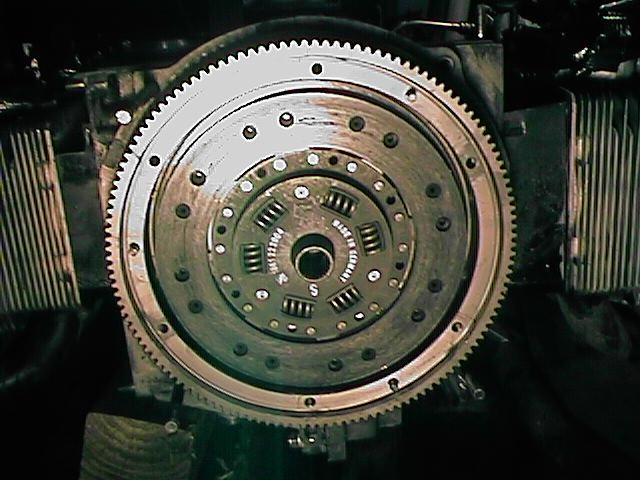

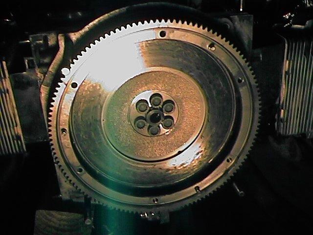

Next was the disc.
Then the instal of the T/O bearing..
Then a few more rings and a clip but I'll spare ya all the pics...

Once all this is done you now need to slip the ring gear over the PP and instal onto the flywheel with the allen bolts. Here is one more with it all instaled.
