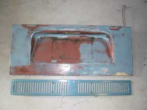

Next is the rear deck lid,  With the installation of the 2.7 911 motor i needed to have a source for fresh air to the fan. This was solved by using a set of factory louvers from a late 68-79 van. I cut a section of louvers aprox 11' in length that will be covered by the lic plate. The plate will have a stand off to allow air to be drawn in but keep apearance of a stock engine lid.
First pic shows the two before,

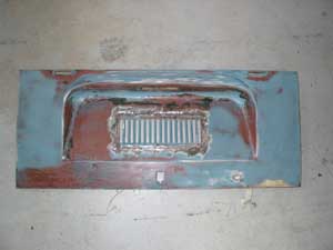

here the two have been cut and welded together

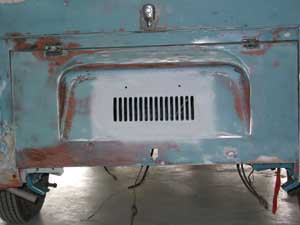

And the last shows the deck lid back on the bus with a small amount of filler added.
