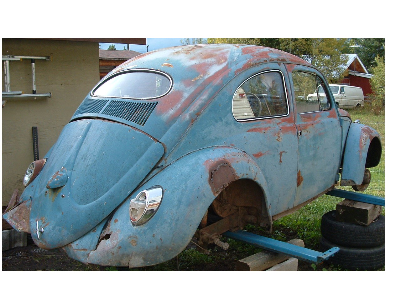

ok that pic didn't work either but I put up a rear pic on the samba under oval beetles

i did look at the pic but the bottom line is if you had a digital camera and posted specific pics i could tell for sure.i'll list a few things to look for
1 decklid lift it up underneath where the spring is does it form a "V" or is it straight?
2. gas tank completley square? or does it have a big hump in it?gas cap extremly large (100mm)
3. seats should be like i posted no adjusters knob on them.
4. front where the heat comes out roundish holes with mesh in them not slits.
5.ribbed doors (like silas mentioned)
6. batwing steering wheel
7. semaphores
if most of these are present and no semaphores mabey they were filled in?the rear apron to me almost looks like it had exust cutouts but it is banged up pretty good.

You can post the links to the pix on the samba by right clicking on the pic and selecting "properties".
Hi-lite the link and copy it to your clipboard > 'ctrl+c'. Then just paste it into your post here > 'ctrl+v'
http://www.thesamba.com/vw/gallery/pix/171828.jpg
That way peeps on dial-up don't have to download the whole 275K pic, when viewing the post.
-=Cheers=-
OOPs, just tried the link and it doesn't work. You have to copy the URL to your clipboard and paste it into your web browser URL bar.
Somehow the Samba blocks links from other web sites, but allows you to access the photos directly from your browser....

wow, the rear apron is extremely mangled, but i can see that it definately has exhaust cutouts.
the rear fenders have later tail lights on them, but they were probably added by a p/o.
take a pic of the inside of the doors and the gas tank.
i'm still thinking it's a 56.
