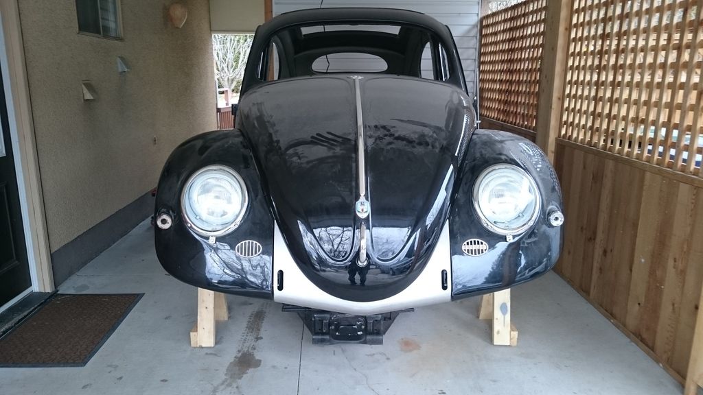

Offline 553fold
  • Posts: 30
http://i38.photobucket.com/albums/e116/Todd_Vollks/DSC_0680_zpscg7arymi.jpg
« Reply #21 on: March 10, 2017, 09:20:06 PM »
Got the new apron and spare tire well all welded in!
Here are some shots of the old pieces.
Prepped for new tire well.
New one welded in. Didn't go for the Wolf part as I didn't want to spend $350 on a part you don't see.
Will probably modify it for harness hold down clips in future.
New apron on and checked for fit.
Went with an Autocraft Engineering part, had to modify the side flanges a little, but overall very happy
with fit and detail. Will obviously need to drill holes for override bars.
All final welds done and primered!
Had to throw on the headlights and take a glamour shot!  :93:
Overall pretty happy with the hood gaps now as they are very even.  The hood does touch right at the bottom first so might have to do some tweeking there in future.
« Last Edit: July 05, 2017, 03:32:29 PM by 553fold »
Re: My new May 55 oval rag
« Reply #22 on: March 11, 2017, 11:37:55 AM »
your work is looking stellar man! On the hood I find you can stretch it out real easy when bolted on open it up about 2 feet and grab on either side of hood handle, plant your shins into the apron and give it a good couple yanks! Will flex most around where the 4 tabs rip around the prop rod but with a little love can manipulate it pretty good. Don't get too crazy with gaps yet as when you land it on the pan and tighten the beam bolts that is what will set your final gaps.
beauty, nice work! that autocraft apron is sweet!

I've finished the passenger side quarter now, inside and out!   ;D  Glad to be moving on as that was the most challenging part I will have to do.   Here are some pics of the lower quarter replacement.
Por 15 rust proofed the inside!
Rebuilt heater pipe.
Heater pipe welded in and primered!
