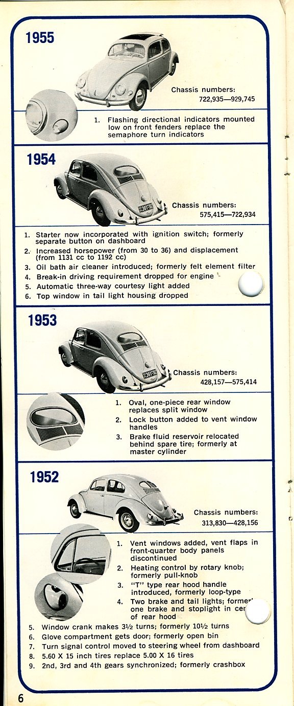

interesting/confusing time for tail lights & turn signals fo sho!
if it's all og, it looks like geoffs egg & semi oval could be either a us, canada or guam delivered car…
**All 1954-1955 European Beetles were outfited with "heart" taillights.
**All Oct'54 (chassis # 1-0722915) - Mar'55 U.S., Guam, and Canadian market cars used the red convex plastic lens taillights. All of these cars had semaphore directional indicators.
**April'55 - May 2, 1955 (chassis # 1-0871206) U.S., Guam, and Canadian market cars, there are two possibilities. Your car could have the red convex plastic lens taillights and semaphores,
or it could have the optional flashing turn signal package with the larger glass taillights and "bullet" style front flashing directional indicators.
**May 3, 1955 (chassis # 1-0871207) - July'55 (chassis # 1-0929746) U.S., Guam, and Canadian market cars were equipped with the flashing indicator package as standard equipment. So, this car would have the larger glass taillights and "bullet" style front directional indicators.
from…
http://www.wolfsburgwest.com/wired/wired_08_01/wired_08_01.htm

This pinkish oval I was made in Dec 54
I think your car is a 54. vw didn't change to the build date/model year thing until aug '55 (example...aug '55 built vw = '56 model year)(dec '54 built vw = '54 model year).
you've cross referenced your vin with the vin charts, correct? built before vin 1-0781 884 = '54!
http://www.thesamba.com/vw/archives/info/bugchassisdating.php
 :cool:
Re: My new scruffy 55
« Reply #19 on: April 18, 2014, 12:28:13 AM »
 :cool:
true story... which makes it even weirder with the over riders and eggs.....mines only a month older...a january 55

The vin is 1-0787 788 and I don't think the bumpers are original.

The vin is 1-0787 788...
built early january 1955 = 1955 model!
cool! I wonder how close your vin is to josh's vin?
