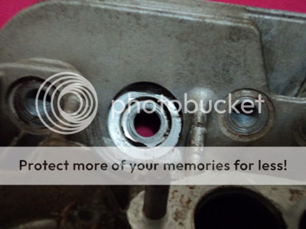

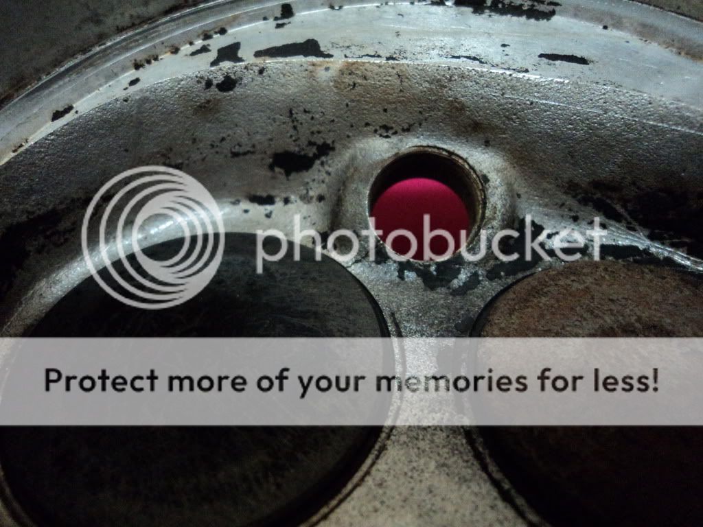

hey guys,
 a crack between intake valve and spark plug hole, repairable? im wanting to run around 10:1 compression, i have seen repairs done to valve to valve but never saw one in this location, whatchas think?

so i just trudged through the crap replys on the samba, and found out that its not looking good, one good point i saw though that jeff denham said that type3 heads are sometimes worth repairing if it can be, has anyone up here ever done such a repair? is it really worth it? i should prolly grab some photos and post em give me a few and ill get em up

« Reply #2 on: June 03, 2012, 11:51:08 AM »
hard to see but it does come through to the top side of it

« Reply #3 on: June 04, 2012, 01:45:00 AM »
You're done.  Look for new heads.
The new Mex 043 heads use 3/4" long plugs instead of 1/2" for this very reason.  More meat means less chance of cracks.  CB 044 heads also use long reach plugs, and they go with smaller M12 motorcycle plugs, again, to prevent this.
If you're thinking of 10:1 CR, you will need the benefits of long reach plugs.

« Reply #5 on: June 04, 2012, 06:21:15 PM »
geoff is correct the 311 heads are the only options on my engine build sheet, i do have a set of o44s for a 2332 back home, they are decent heads and and can totally see the difference and advantages to those heads, i will send darren a pm and see the other head is looking great! and im really excited about these!
