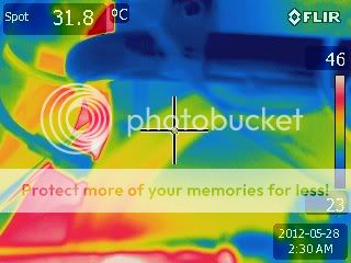

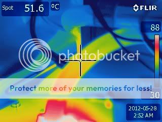

« Reply #3 on: May 27, 2012, 05:23:04 PM »
After putting it back together I adjusted the pea shooter in until I got the right flow (helps if you have a FLIR Camera you can use). Below are some thermo shot before and after.
Driver side
Pass side
Intake below carb
Driver side
Pass side
The position of the pea shooter in the muffler makes a big differance.
Those are good information shots, but if I can make a suggestion...
If you are doing before and after thermographs, it helps to maintain the same temperature scale throughout.  That way, you can compare apples to apples.

« Reply #8 on: May 28, 2012, 12:23:10 PM »
From what information I found on Samba it should overlap by 1/4" that is how far the tube should be inside the pea shooter. With the pea shooter off I measured to the end of the tube in the muffler and the calculated with the lenght of the pea shooter how much should be outside the muffler to give me the 1/4" overlap inside. I found that I put mine in a little more then the 1/4" overlap to get the final temps. It might be different depending on what type of pea shooter you have. As far as the settings on the gun I had the temp range on auto as I was just using it for the spot temp but that is a good idea for next time as the colour changes would show better.

I don't think you're done yet.
Is the left tail pipe the one you are adjusting?
In the second pic, the right heat riser is at 101º, but in the 5th pic it is only 56º.  I would expect them to be the same.
The right heat riser pic shows that more heat is being conducted up from the muffler than what is being delivered by the exhaust flow from the right side.
