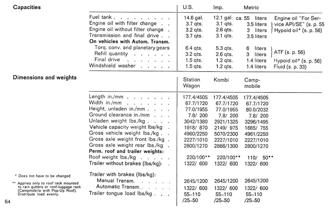

If you look at your test report, it says your Bus is 2000kg.  I have a hard time believing it weighs 4400lbs.  There must be some other Bus guys on here that can tell you what their weights are on their aircare reports. It should be on your ICBC papers.
Getting this corrected is very important.  It is because the cutoff numbers that determine if you pass or fail are based partly on the weight of the vehicle.  Heavier = lower cutoffs = hard to pass.  It's my guess you are overweight by at least 1000 lbs.  This will make a HUGE difference in the cutoffs.
Another change you need to make is the engine size.  Everyone knows it's a 2 liter engine, but in fact it's really 1971ccs.  Aircare allows you to truncate the engine size.  A smaller engine gets you higher cutoffs.  It's not much, but if you look at your reports, you have one failing reading of 2.51% CO.  I believe the cutoff for that is 2.50%.  Had you the smaller engine in their system, you would have passed.  Changing this is easy.  Just tell the guy at the test station that its really a 1.9 liter engine.  They can change it right there.

Empty weight is 1495 KG BTW.

Oh my, we've got the heavyweights involved.  Bruce, you should be down south.  BUSDADDY, the Samba will be missing you.
Is this vehicle a Campmobile?  If so, 1495kg. is correct for the curb weight.  If not, it could go as low as 1245kg. if it is a delivery van (according to my 79 owner's manual) and the lower curb weight number will affect the driving Aircare #'s.
You could always go by your local weigh scales and get it checked.  We have one here in Pitt Meadows at the garden supply place by the bridge.  No charge.  I used them to get a weight for my dune buggy when I registered it a couple of years ago.  ICBC took the slip, no questions.  Just remember to get out of the vehicle when they weight it!!
My 79 Deluxe is registered with a 1302kg. curb weight.  Don't know where ICBC got that but it does result in a slightly higher threshold for HC,CO and NOX when compared to the 1380kg. VW says it weighs.
My van spent most of its life in the San Jose, California area so perhaps something was incorrectly entered when it was registered in BC, 5 years ago.  I'll take the lower # but hopefully I won't need it.
Bottom line - the Aircare #'s are generous.  If you vehicle is set up and running properly, you shouldn't come close to their max. readings.
