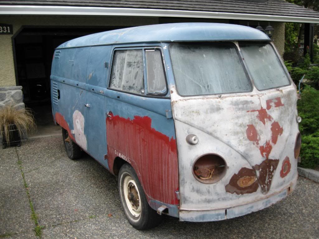

Just picked up my 1955 Panel this weekend, has a few rust issues but has some great potential it will take me a few years to get her Road worthy and i am having trouble getting regi but working on it and also working on the patina...enjoy!!! :D

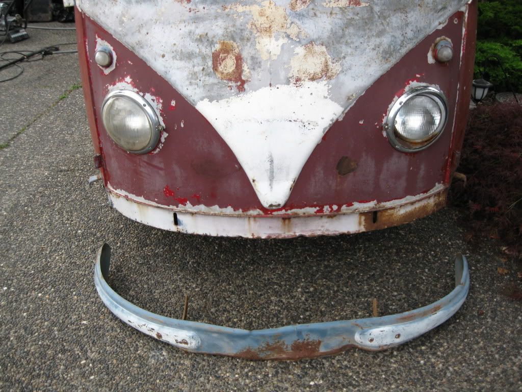

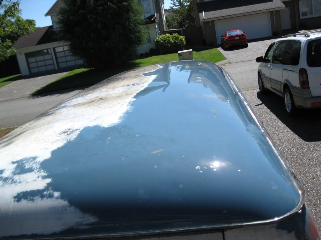

« Reply #4 on: August 26, 2010, 06:58:38 PM »

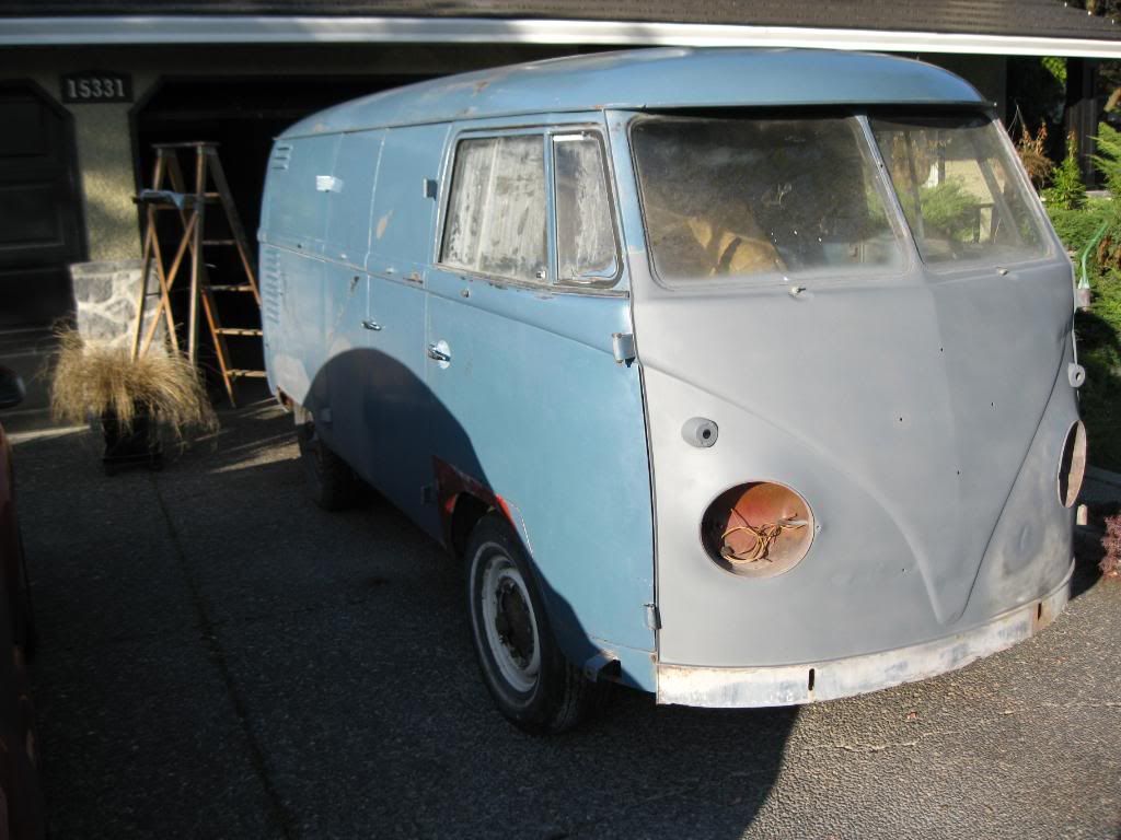

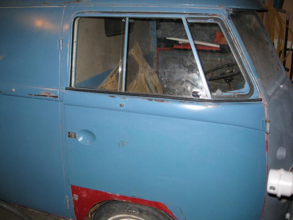

Couple of NEW Pictures...... :o
WEdnesday
Today... ;D   Mmmmm Patina

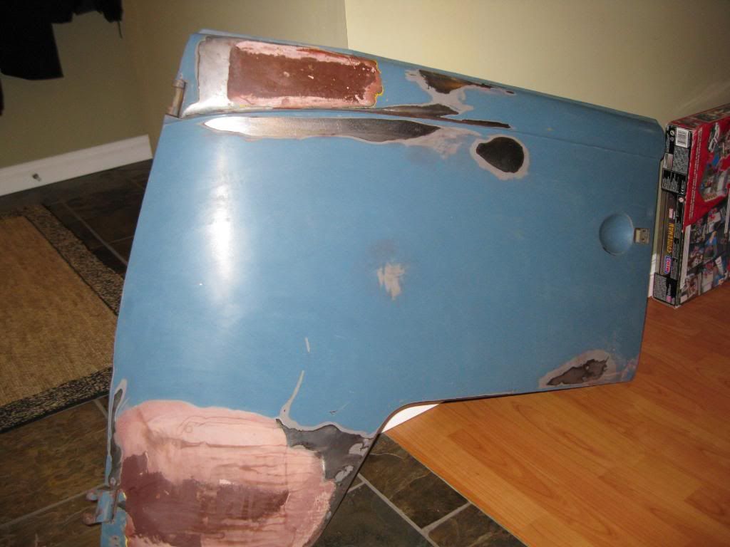

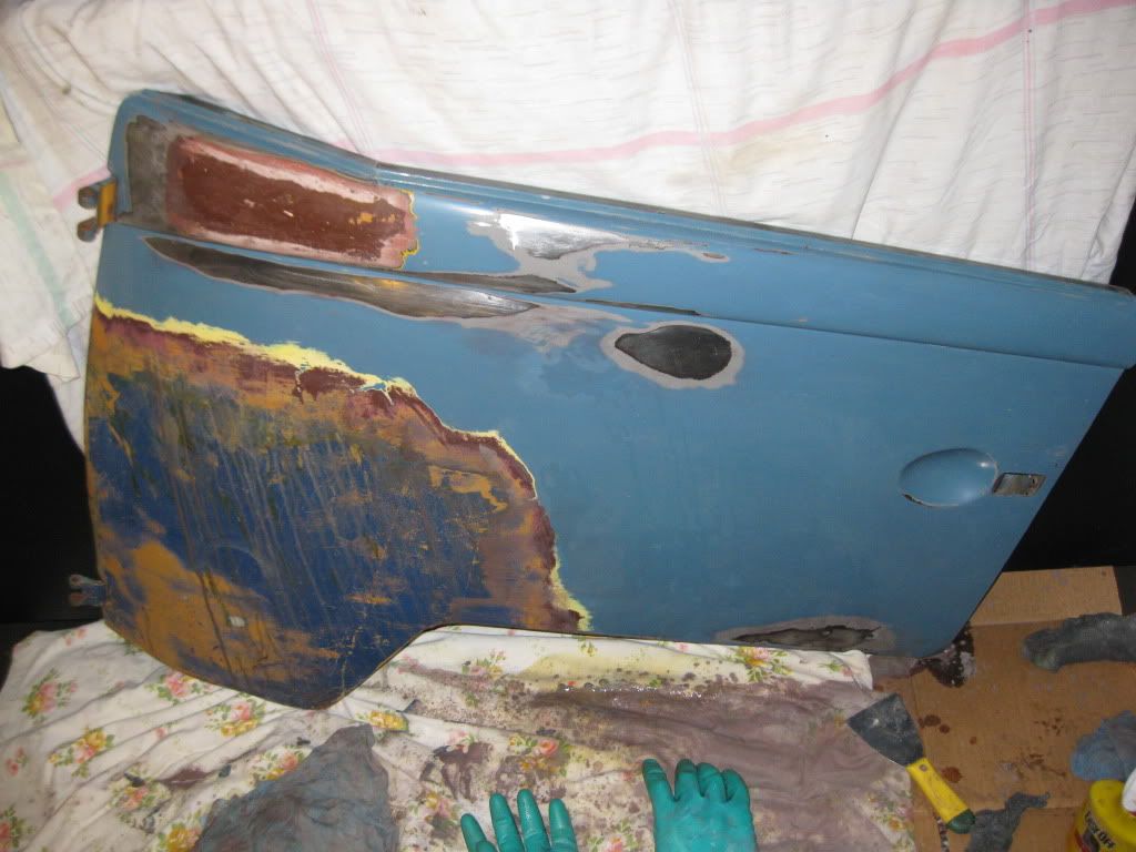

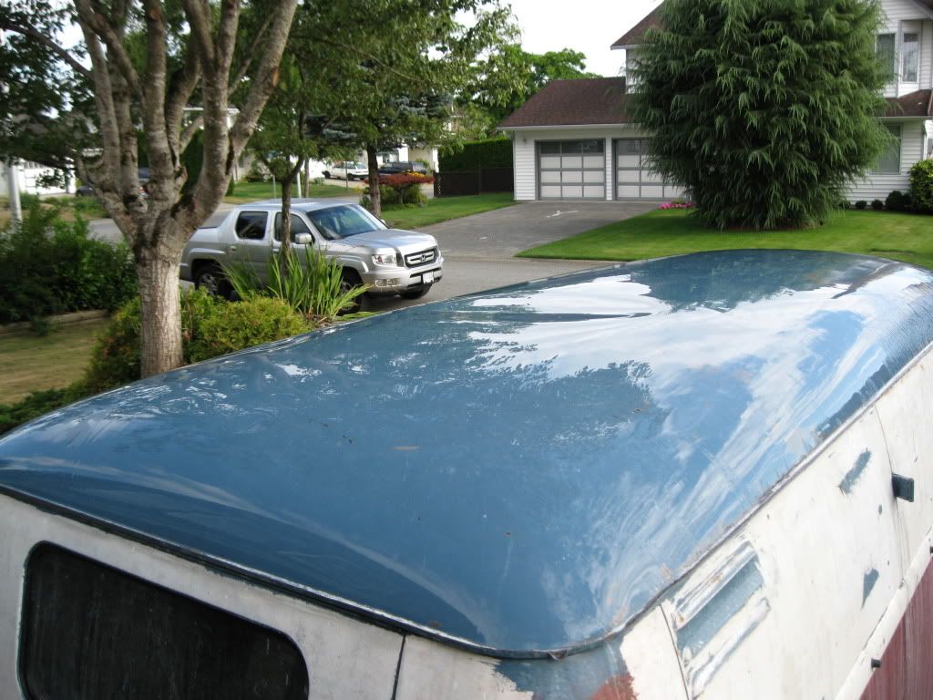

« Reply #9 on: November 30, 2010, 10:07:48 PM »

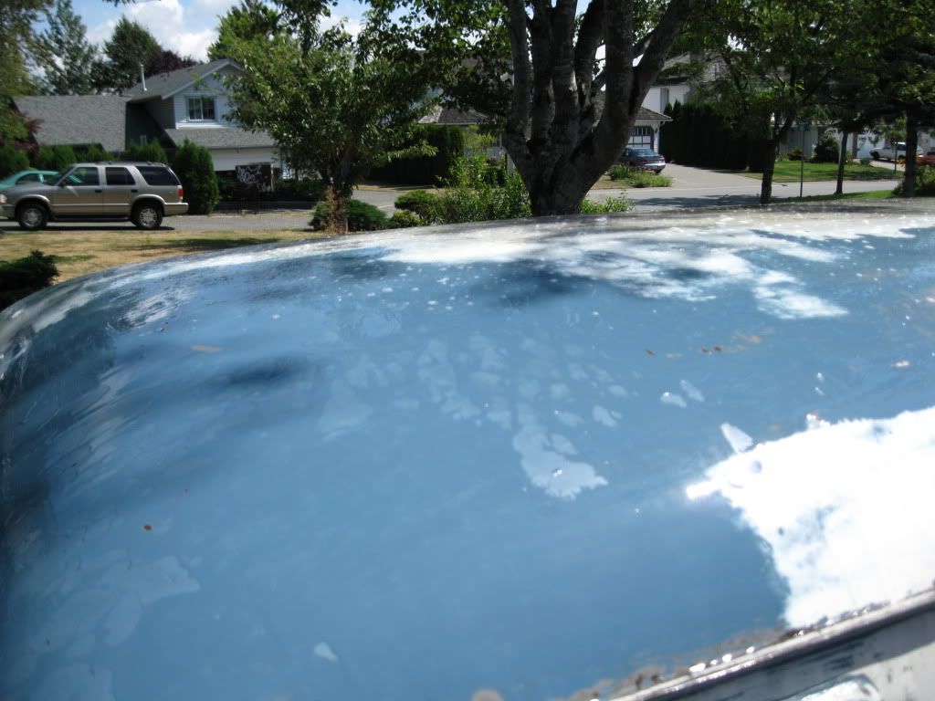

Well finished with Paint Removal i think it turned out pretty good...luvin the Bus..
this ones my favorite....

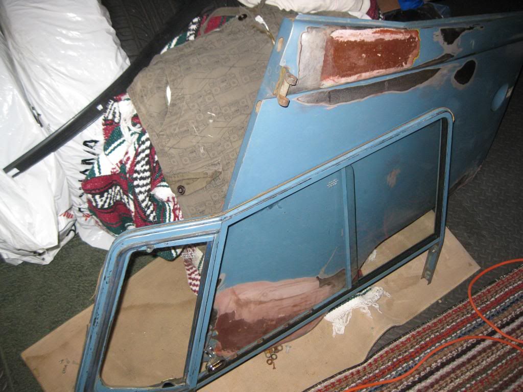

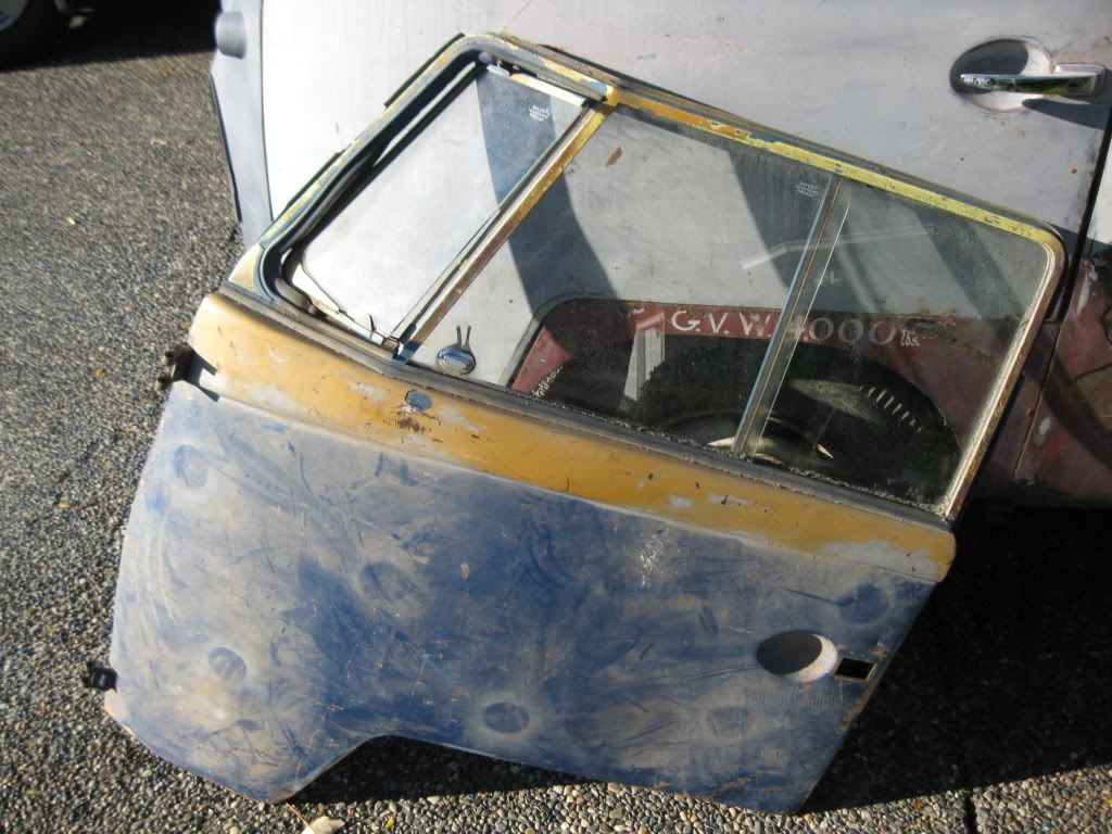

« Reply #12 on: December 01, 2010, 09:37:56 AM »

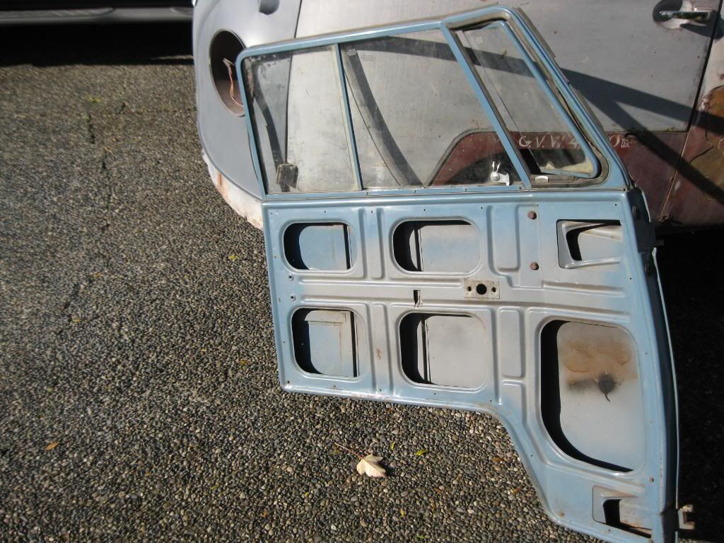

Came across a nice Rust free Door and Dove Blue as well(thanks Richard!)
It would have been wise to bring along a magnet but it still has more Dove Blue than my other Door and NO rust  :D

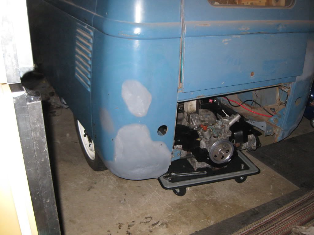

« Reply #16 on: October 27, 2011, 10:02:47 PM »

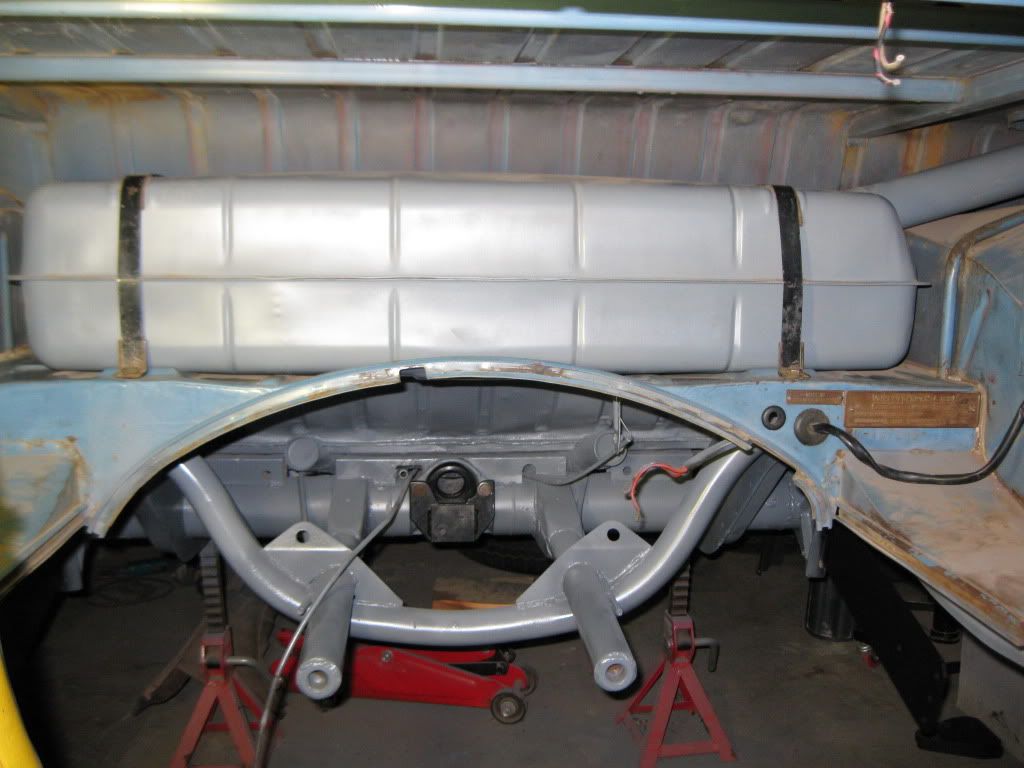

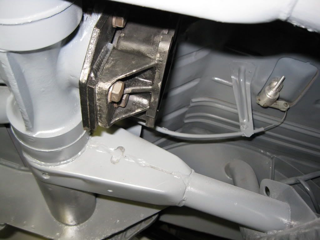

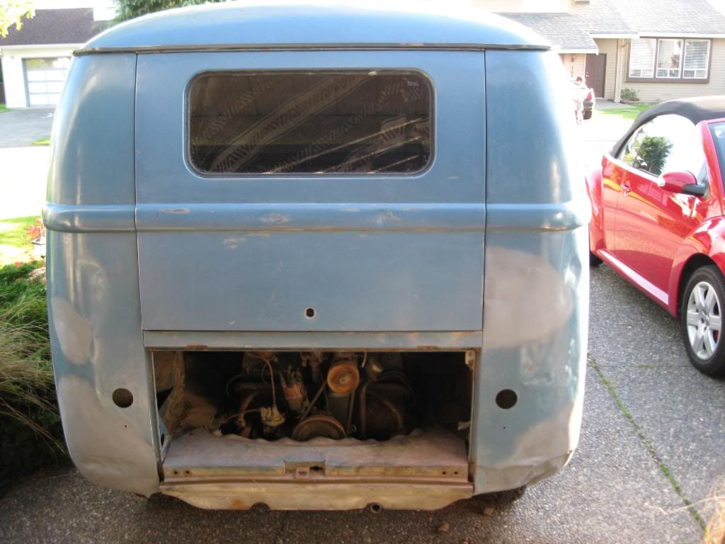

Have been just puttering along as it is a project, underside done and Beetle tranny installed with a SA conversion, also spindles sent to Wagenswest should be a month maybe. Gonna start on the Brakes soon.....but first some pics ;)

« Reply #17 on: October 27, 2011, 10:42:19 PM »
Wow, that is impossibly clean and tidy. You should see mine, I think you'd throwup!

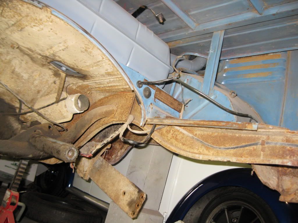

« Reply #29 on: December 24, 2011, 09:48:18 AM »
Did some more work to get the ass on the ground as Geoff said almost rollin......
super beetle Wheel cylinders added and e-brake cables cut down 1 inch..
Thing Drums added for more clearance so the 55 Bus Rims wont rub on the spring plate, but then the tires dont fit in
so the Old Speed adapters have to be unbolted and the tires shoved into the wheel wells...
Rear on the ground waiting for dropped spindles from Nate then she will be rolling again...:)
