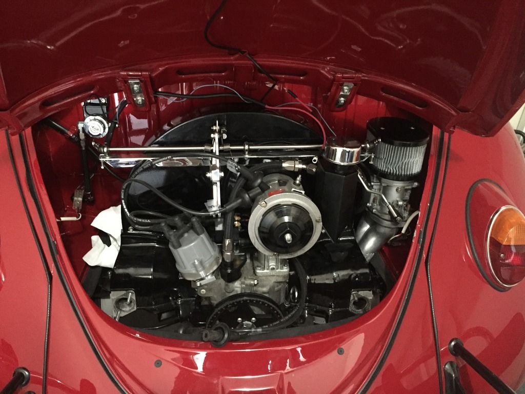

since headliner and carpet are being done I am doing a few things to the engine I bought
too many blue and red fittings and stainless lines.
first problem was the empi billet air cleaners, actually a nice piece but did not sit flat and hit the banjo fitting's
milled out a slot so they sit flat, also milled off the empi logo and had them polished.
countersunk the screw hole for allen head bolt and anodized them black.
what I ended up with is just a clean and simple air cleaner, all the stainless hose is being replaces with braided Kevlar.
as far as the screws holding the tops on, I know they have a tendency to vibrate loose I will try blue Loctite and hopefully they stay put

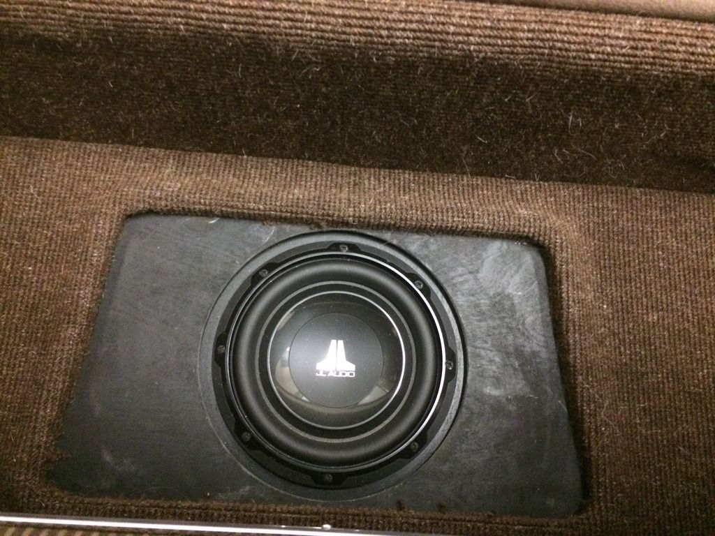

nothing better then a little music when cruising, adding the stereo

speaker design goes to my friend Brett who owns creationz, he has a way better eye for it.
I said I want them as slim as possible. the pic lightened it up everything is chocolate brown and blends in to the dark space
the sub is JL audio front speakers are alpine, no head unit just blue tooth through my phone for music.

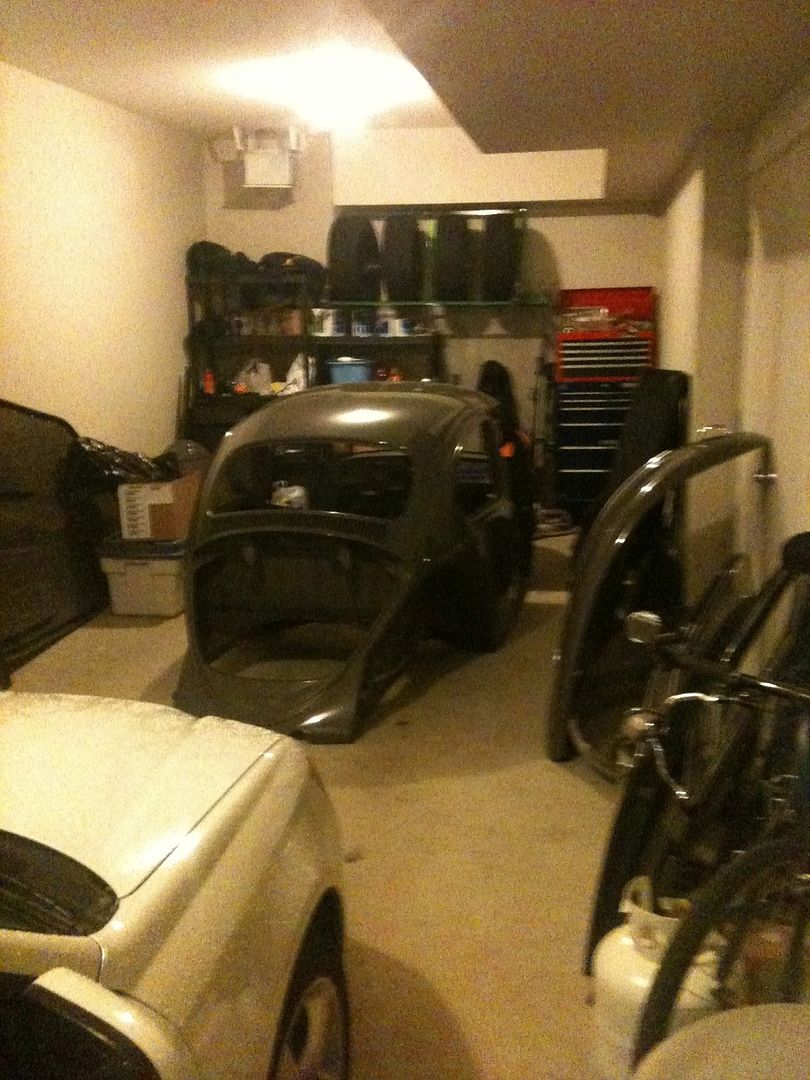

just a reminder of how it looked when I picked it up, missing two fenders,gas tank,front beam, tranny and engine

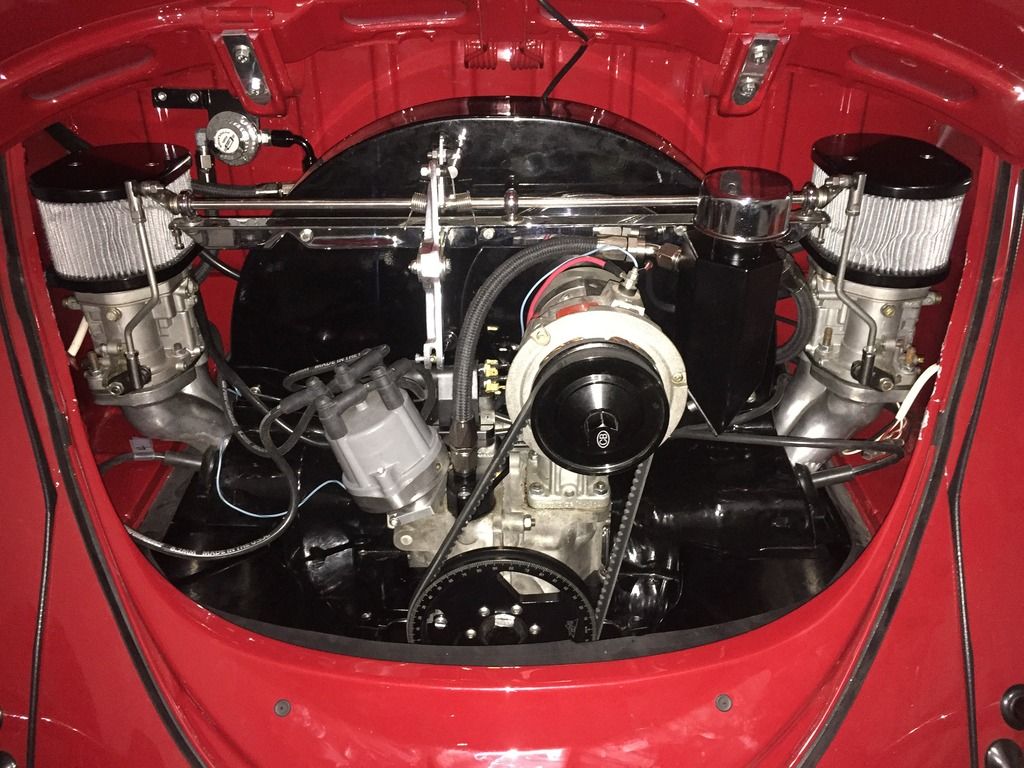

2275 going in
hit a snag with my fuel regulator in the way, i'll make a new bracket and get back at it

it's in and running I need to clean the wires up and a few touch ups in there
it's running but could use a bit of tweaking
I'm pretty happy at this point
