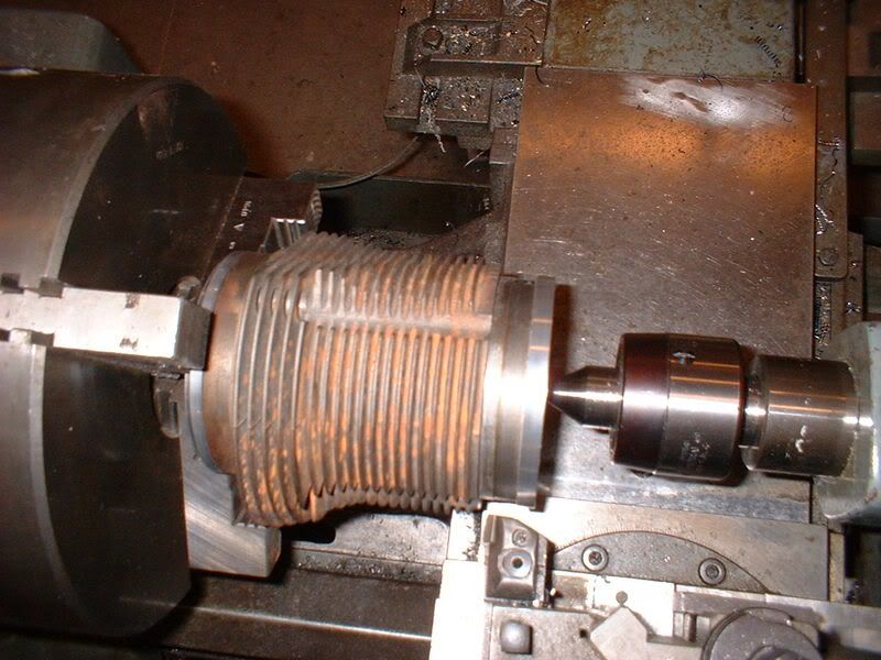

I do it too.
Edit: ont58! I don't know where you live. But Josh is correct. Shortening cylinders can be a straight forward job. It will save you lots of money in freight, if you can get your local shop to do a set up like the one in the picture. Simple plugs support the ends of the cylinder.
