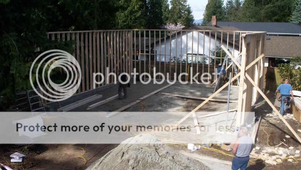

« Reply #125 on: March 18, 2010, 02:11:32 PM »
Found a crew of "little people" to help us frame. They make it look big :o!

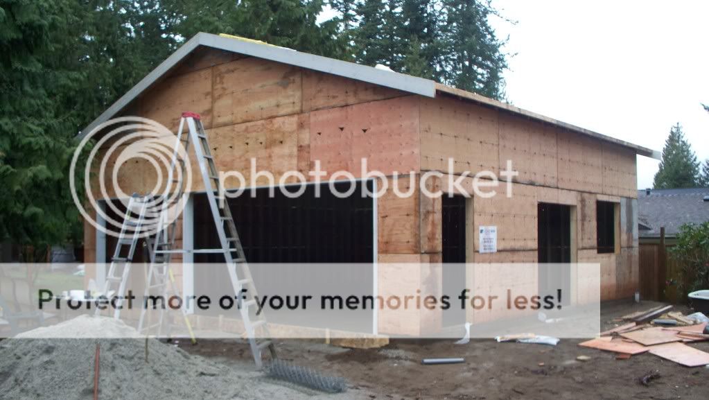

Don't bring up the M word until all the inspectors have left and the permits are signed off. I made that mistake and the result was structural assessments, engineered plans, a second building permit during construction of the shop and a jump in my insurance.  :o
It seems too many people have whipped up quickie lofts in home and strata warehouse shops and then either they or the next tenant overloads them and someone/something gets crushed, so now they get the crap regulated out of them.
The end result is my little Mezzanine is now capable of supporting a knee deep layer of flywheels, but it bumped the cost of the shop by 1/3.

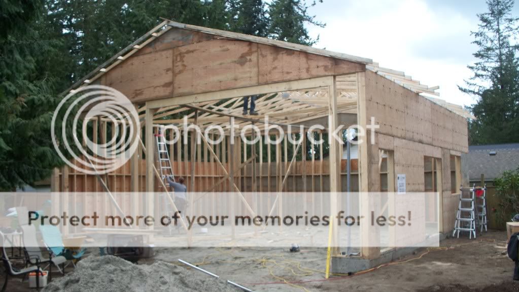

I know everyone is a critic, but is that header over the large doorway big enough? Looks only like 2x6's from a distance... just trying to help! :-[
Because its not a bearing wall 2- 2x12 will work well there.  It looks like some of what you see is hidden behind the plywood.  Yup definitly add the mezz after the final inspection with no words mentioned to the inspector.  Thats a very nice size shop.  Kevin
It's 2 ply 2x8, with only the weight of a roof to support (not another floor) that's lots.

« Reply #137 on: March 23, 2010, 01:28:24 PM »
Actually what looks like a large doorway is a wall that hasn't been framed yet. Doors are 9X8 and 16X8.

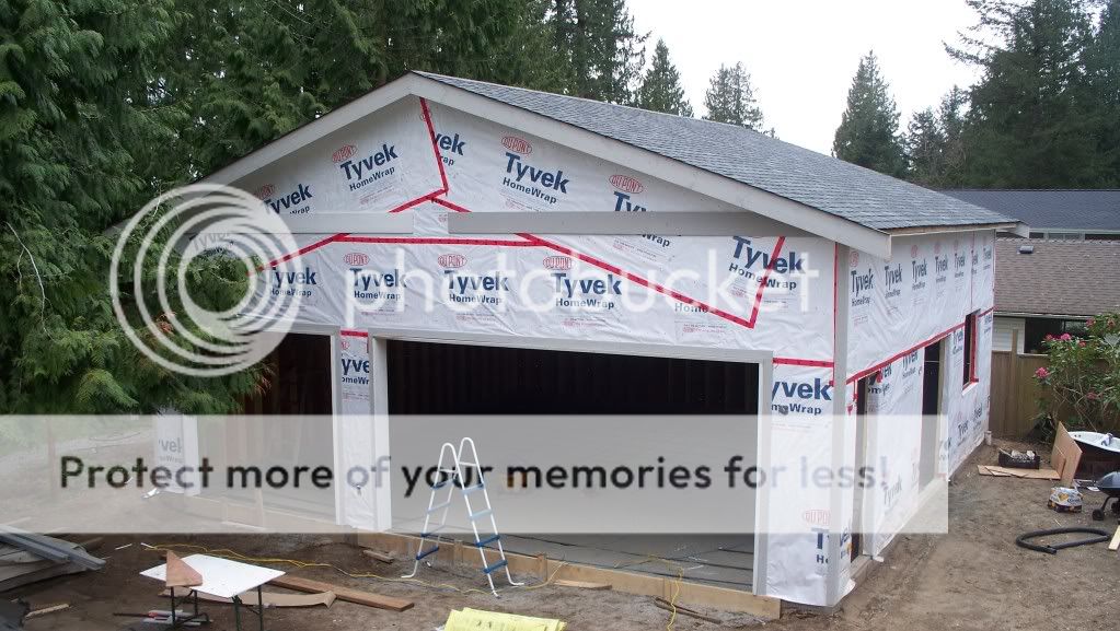

whats going on the outside .i worry when i see tyvek
James Hardie siding. What's with Tyvek?

« Reply #147 on: April 06, 2010, 07:22:47 AM »
Tyvek is very airtight, it doesn't let the walls breath too well.  I have seen where slits are put into the tyvec to let the walls get better air ( I know doesn't make sence).  Walls need to breath to let the moisture out from the cooling and sweating they do between hot inside and cold outside.  A garage is not so bad like a house is, atleast it will hold the heat with the hardy siding too.
