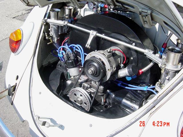

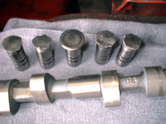

Hows this for a weak stomach and 20 minutes of cam/lifter breakin (torture). As I've said before use the Camshaft manufacturers  recommended lifters. 3 camshafts later  (2 web 86C cams, 1 CB/Eagle cam)  2 sets of lightened German reground lifters, 1 set of pat downs reground scat lifters,,  1 Shadek oil pump and due to the crud in the oil (chunks of lifters etc) my lifter bores worn severely I had the sleeves rebushed with brass/silicon sleeves. Oh the love of ACVW's.
Yes my 65 / 2332 is back on the road!!!
Check out the lifter on the far right. The head of the lifter is non existant.  :blink:
Those are OE german VW lightened lifters (2nd set of lifters and 86C - ES12 camblank)
Oops correction ]]] they were....
After all this crap happened and when I was down  I opened up my float bowls, added weber 3mm ball/seats and put Art Thraens CNC vents in. Yes gas mileage sucks.
