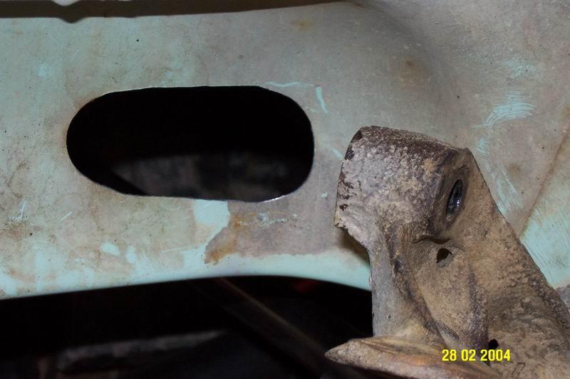

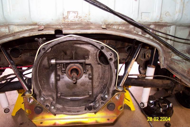

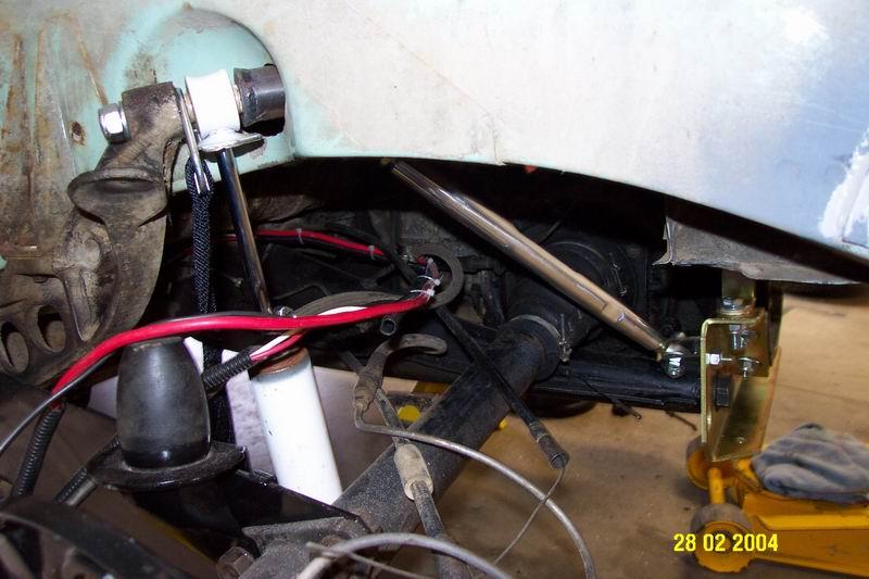

Pictures of the Airspeed Drag Bar installed in my 1966 Beetle
Area to be trimmed
Area after initial trim
Look at the actual area needed to be trimmed - I have a feeling my car may have been hit in the rear before...
Down Bar angle
Driver's side down bar angle
Rear view

Nice tranny mounting bolts  :D

Hey James,
While were on the topic. I was wondering the pros and cons of the hard tranny mount. Is it as simple as the hard tranny mount is stronger, but decreases driver comfort a little?
Installed Drag Bar Late Model
« Reply #4 on: February 29, 2004, 02:52:36 PM »
If anyone needs one of those solid rear trans mounts like in James' pic, I have one for $20.
James, you should put some safety lockwire on the throw out bearing clips.  Even though you have the Saab \"hi perf\" ones, they do come out.  I've had those come out on a totally stock car.  Tie your wire through the loop of the clip, then wrap it around the bottom of the TO bearing and through the loop of the other clip.
Man, the things you swing axle guys have to put up with!
« Reply #5 on: February 29, 2004, 03:48:05 PM »
What kind of wire should I use Bruce? As far as the hard mount, I wanted one to tie in the Drag Bar - the stock one felt kinda flimsy compared to it.
I've got a spool of .030\" stainless steel lockwire.  If you can come up with something similar it should be fine.

Thanks for the Info Bruce, I have access to the same wire.
