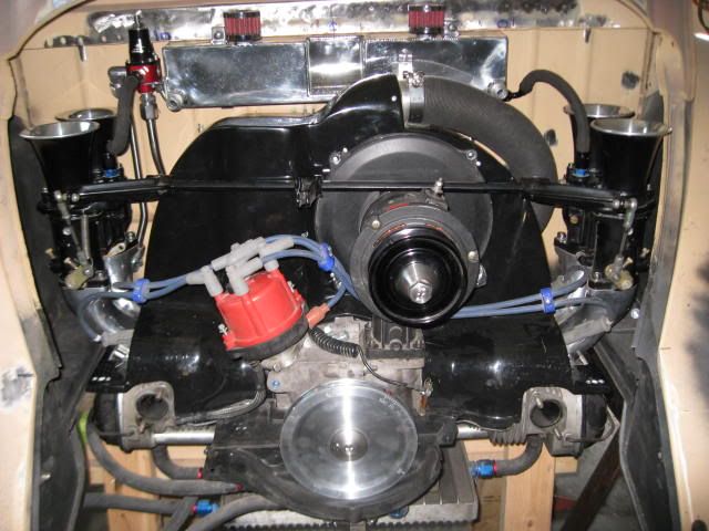

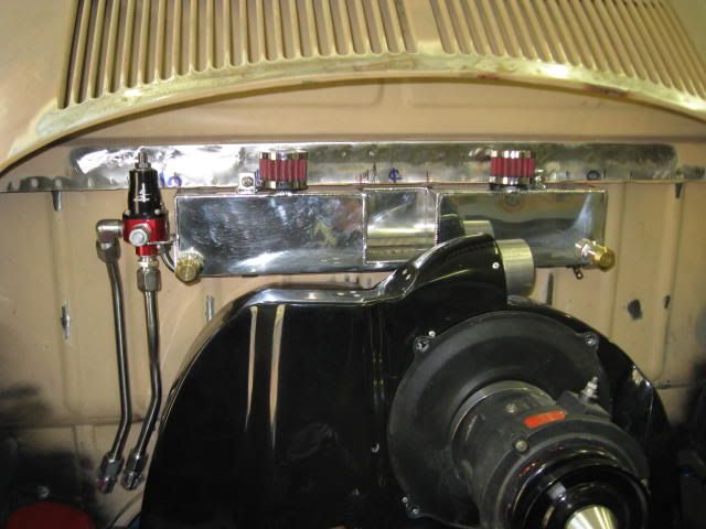

That regulator is trick. Is that 3/8" line from the tank/pump, 3/8" return line with a carb line from the front and another off the bottom?
Re: Project '54 Ragtop
« Reply #241 on: July 21, 2011, 06:13:46 AM »
Nope, went with 1/2" or -8 for both supply and return from front to rear....really only needed 3/8" but I didn't want to choke down the monster pump.
Plus this way if I get stupid enough and want to go turbo or add some giggle gas then I'm set-up on fuel :P
« Reply #242 on: July 21, 2011, 10:06:33 AM »
1/2" lines for 3psi!!! You could fuel a V8 back there if you wanted to. Good idea doing it now just in case....
Looks like you've mached up almost everything what's next, body work?
I see three return lines to your sump. Two from the heads, where's other one coming from?
« Reply #243 on: July 21, 2011, 12:28:49 PM »
Oh yeah, this pump supports 700 hp :o
The other returnto the sump is from a Jaycee bypass remote filter mount replacing the internal one in the case.
I'm just getting into fitting cooling tin and shortening tie rods and torsion leaves etc. After that body will be pulled again and blasted then body work ???

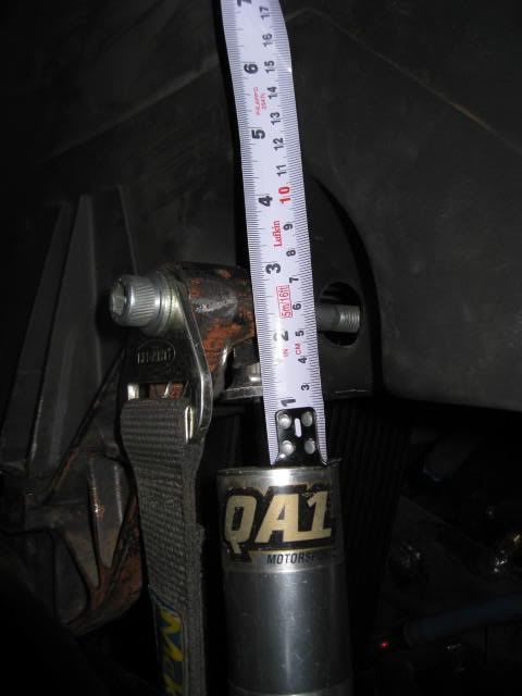

setting up my suspension....not sure if these shocks will work for the ride height i'm after.......

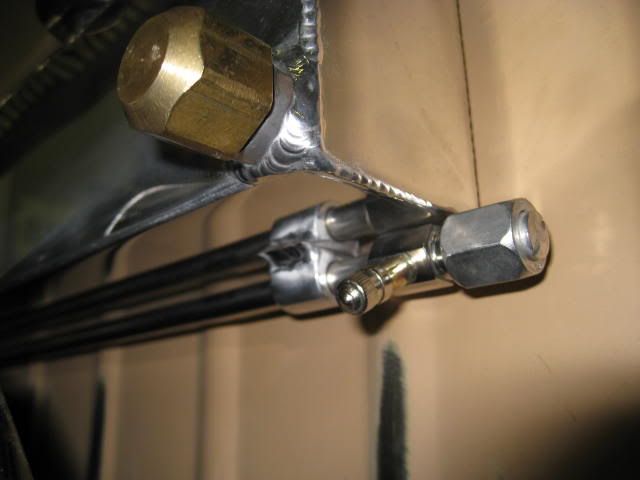

right side hard line terminated with schraeder fitting to check pressure

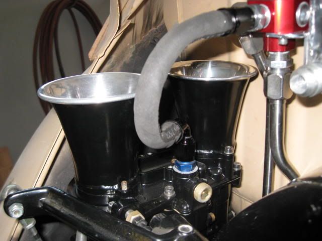

made up some soft lines for the carbs

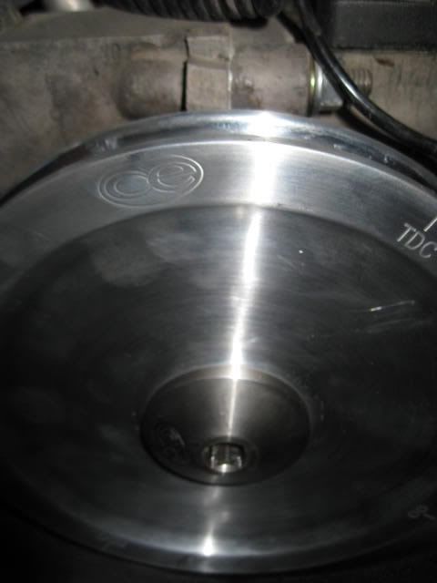

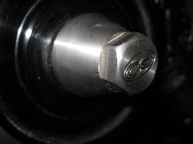

cool pulley nuts from CE.....nice product!

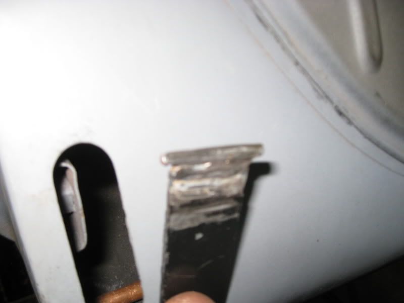

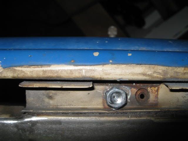

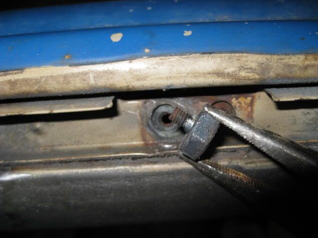

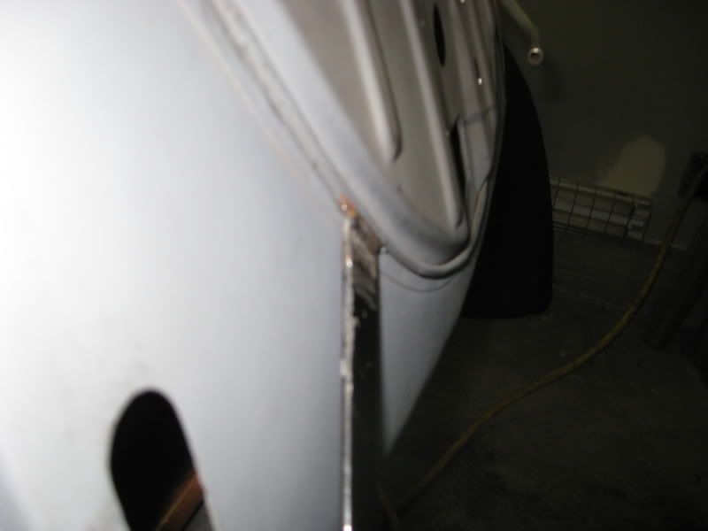

Knocking little stuff off the list.......finally happy with my door gaps now, 4mm all around. found a busted vent window screw that had to come out.
that trick is soooo awesome!

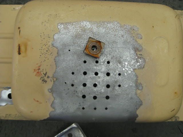

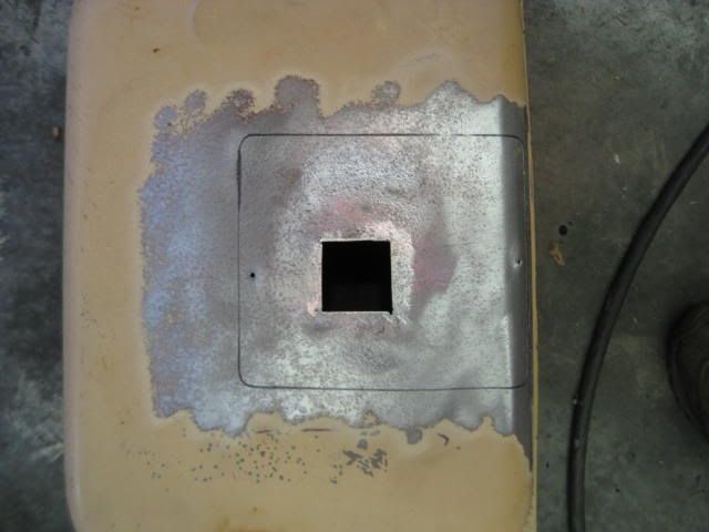

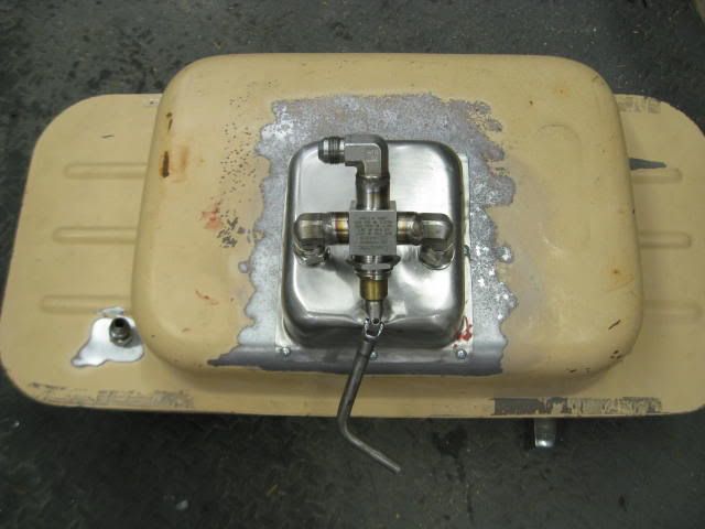

Onto the finishing the gas tank, first get rid of stock reserve bung....
Then make swiss cheese...
return line fitting
and the mini sump/reserve getting ready to weld up

The nut weld trick is def one of the coolest tricks you can do!!
Looks awsome josh.

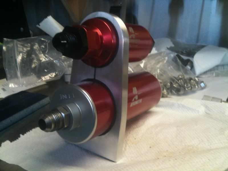

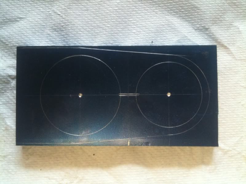

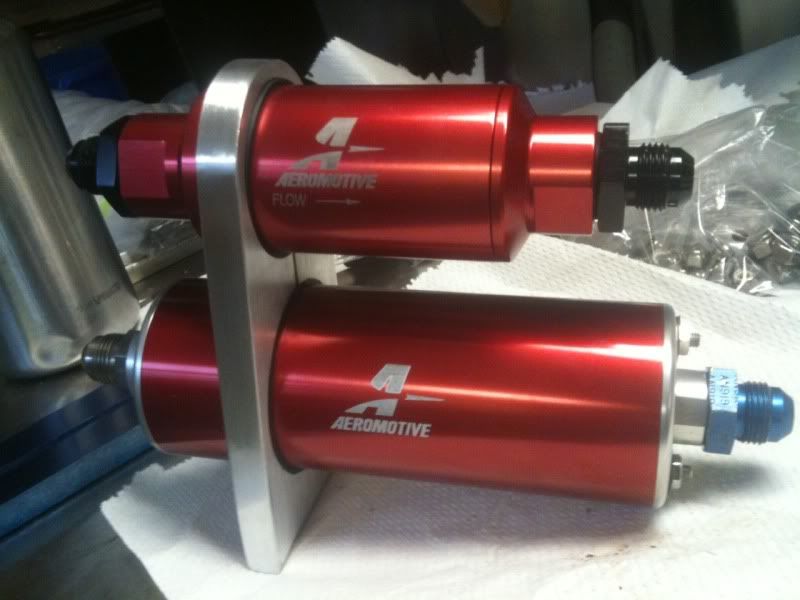

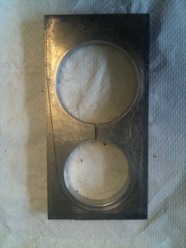

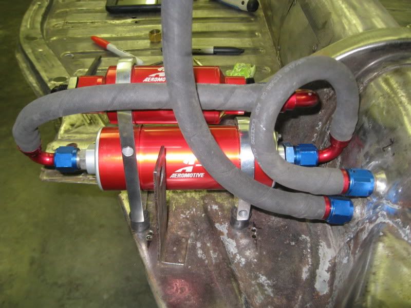

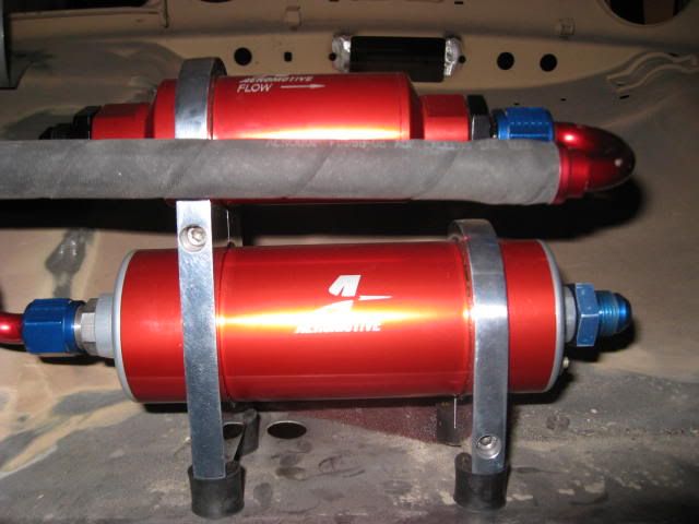

making "faux" billet clamps for fuel pump and filters out of some 1/2" aluminum plate
laid out....
a little hole saw action followed with a little red neck milling on the drill press (carbide bit and flapper wheel)
after some band saw/belt sander love this was the result....
guess I didn't take a pic of the other side but it has a 5mm allen cap screw running through the slot between 2 holes to pinch down......worked out good.  gonna start on the second one tonight then a 3rd for the 10 micron filter that will mount to the truss bar out back
« Reply #255 on: October 18, 2011, 12:18:43 AM »
Nice bit of engineering!
How about a few speed holes?

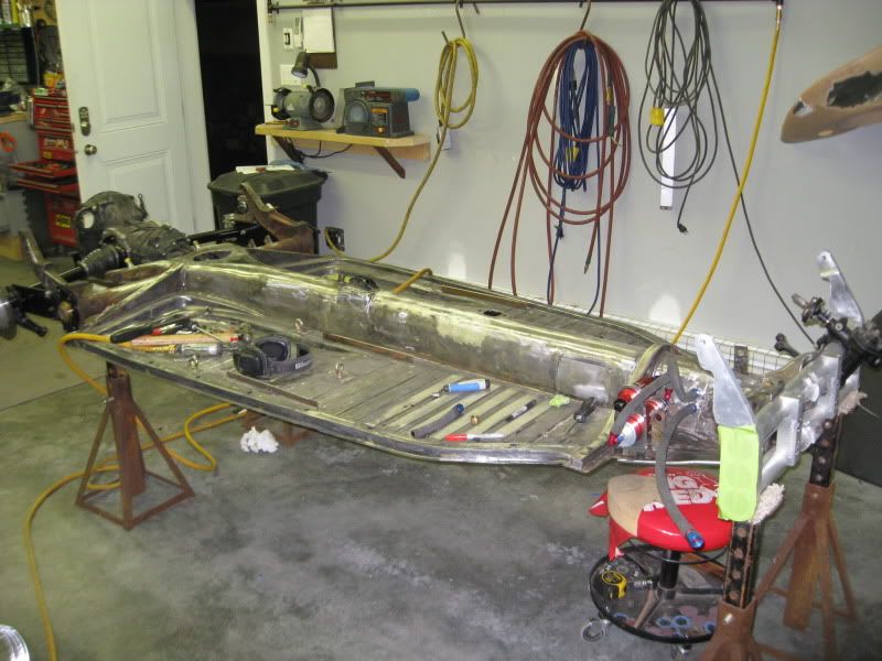

been super busy lateley put sill picking away

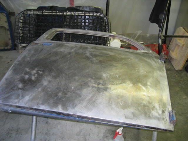

spent 4 hours today metalworking a doorskin  wee_hee
was chasing oil can dents, super fun!

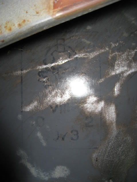

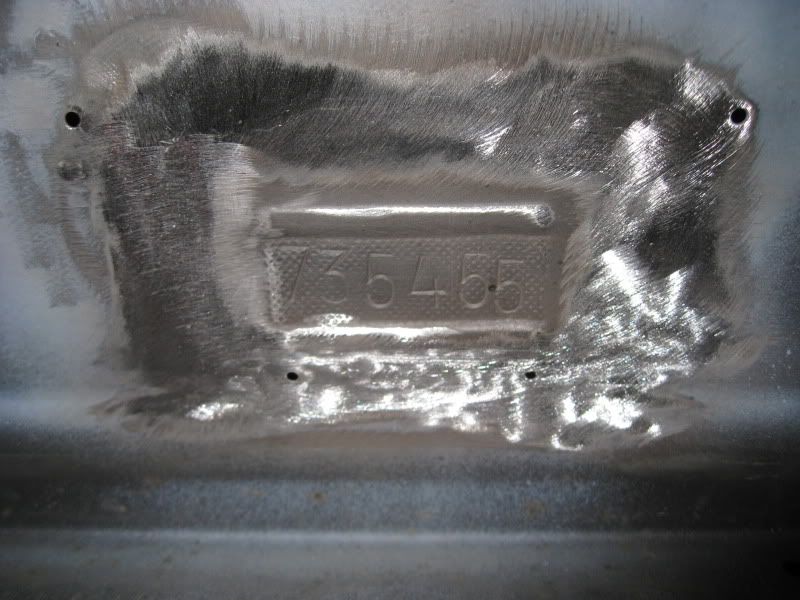

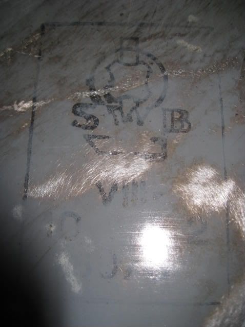

cool stamp found inside one of the doors..... was under the beige but over primer
also finished the fuel pump clamps....
plumbing soft lines is going to be fun   :banghead:

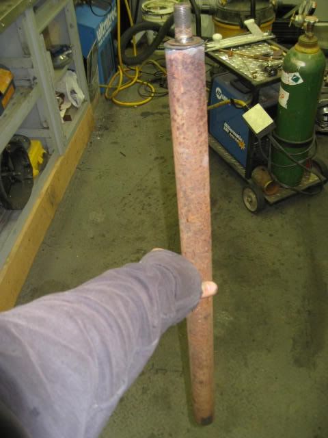

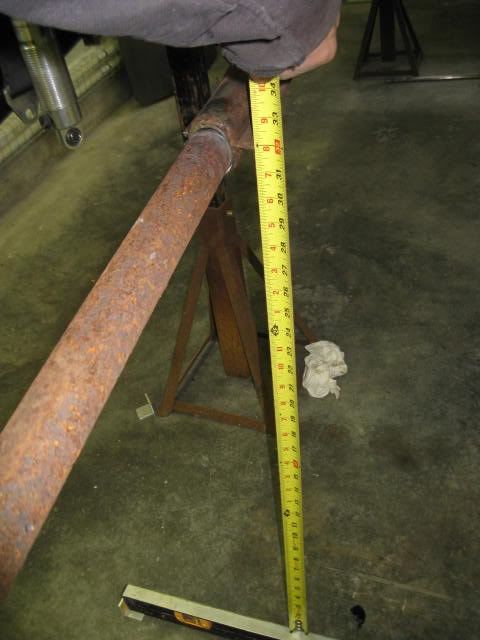

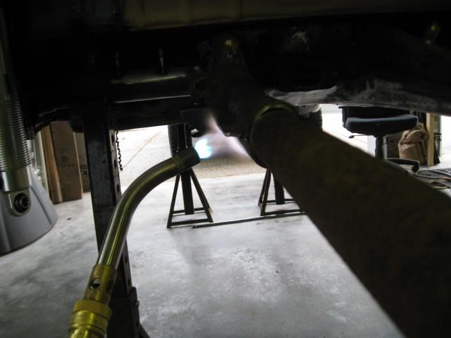

welded the shit out of an old frame horn bolt to a hunk of pipe (yes it had been outide for a while )

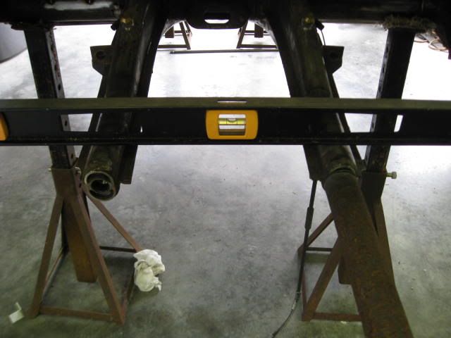

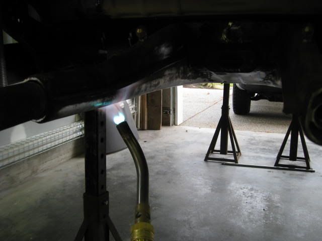

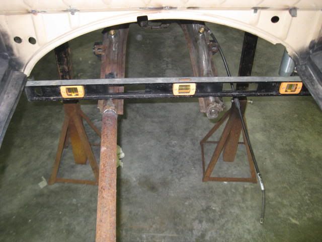

took a while to square the car up 100% level, got my #'s and had at it....
big ass rosebud on my turbo torch and sit my 215 lbs on the end of the pipe.......
worked out nice...

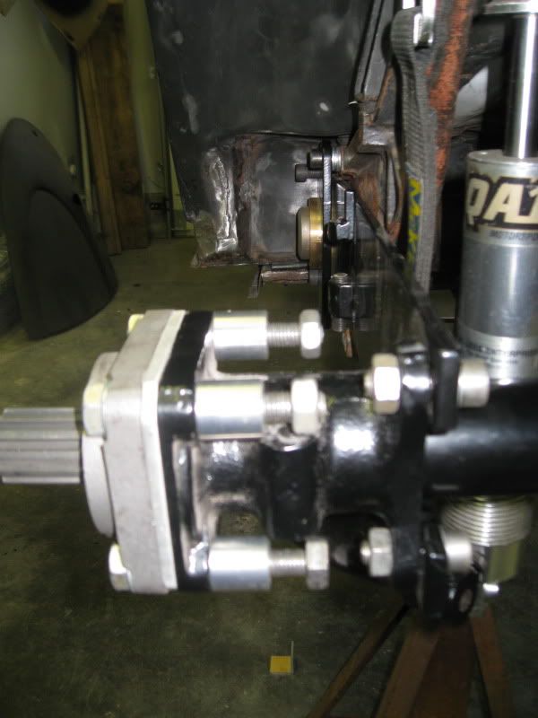

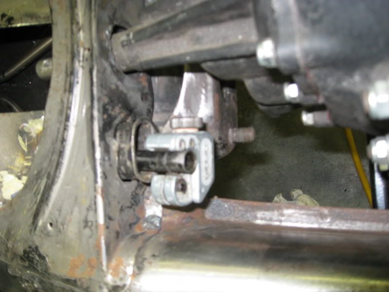

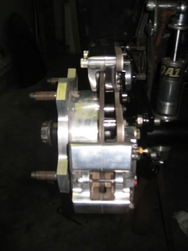

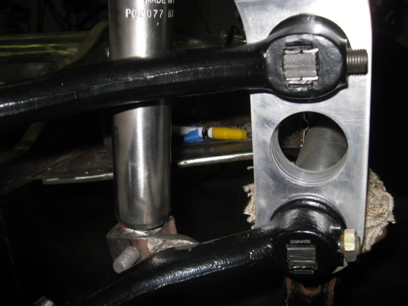

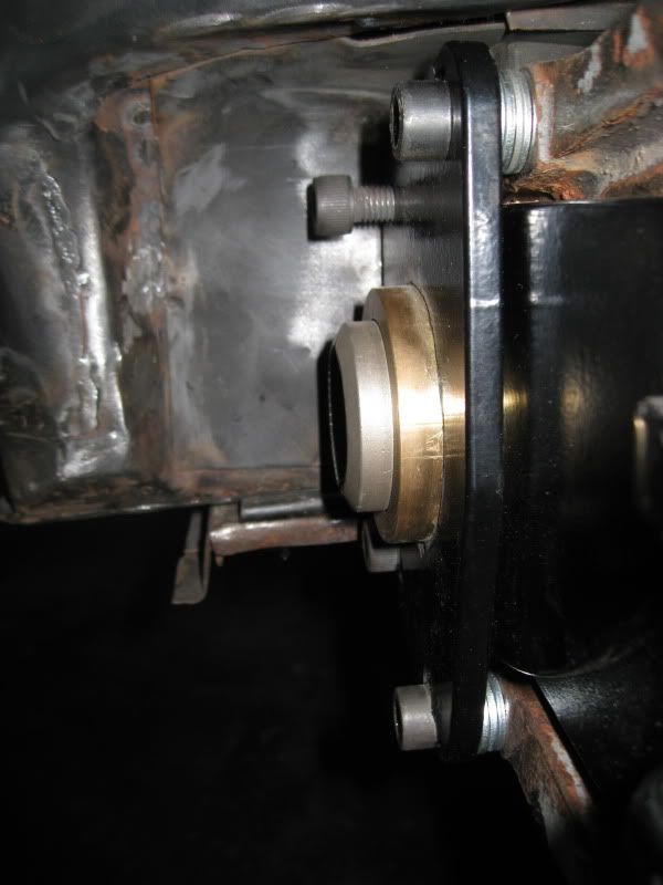

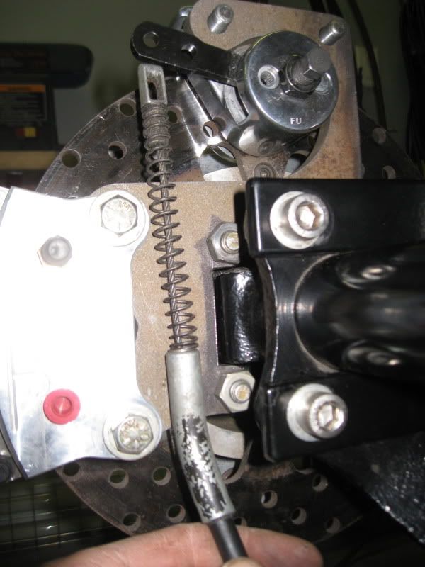

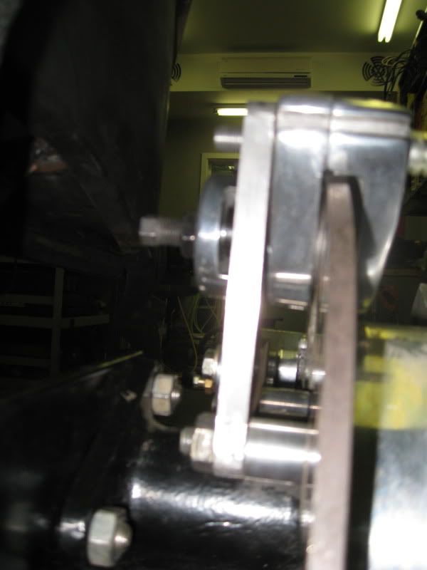

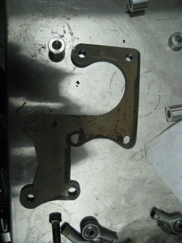

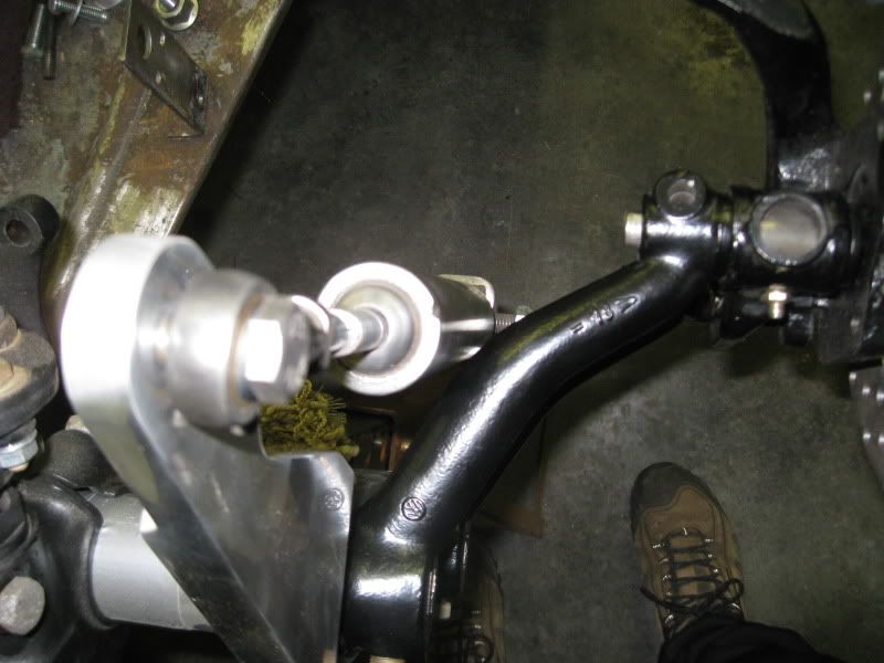

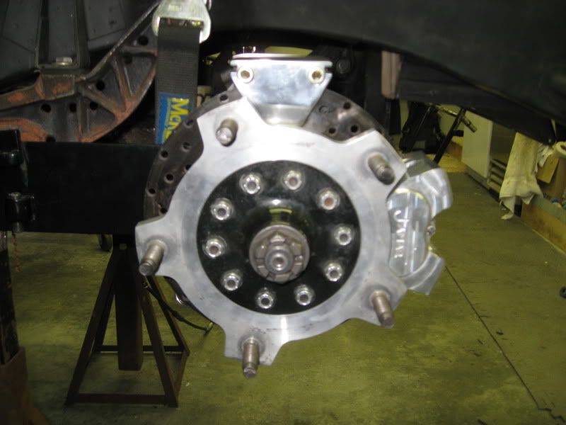

Next set of pics are of the final product on the dual caliper brackets......much thought went into getting the math to line up between mounting tab height to centerline for rotor between the 2 piston and mechanical spot caliper!!!!!
aluminum standoffs to get it in the sweet spot (trial and error first with washers stacked to figure out)

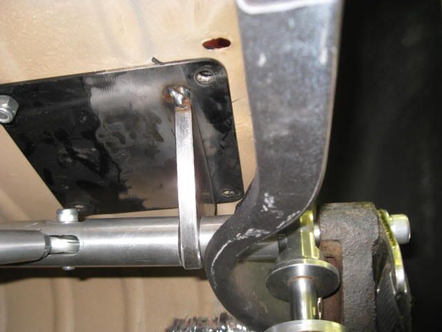

E-brake cable will need a sleeve welded to the back....
finally one more box ticked off!!!
Lastly dialing in adjustable spring plates and bronze retainers.....
they travel nicely thought the full range with no tight spots.
I didn't take any pics of the eurothane inner bushings I turned down to work with these....most guys will tell you you don't need them with the solid caps but what the hell. washers will be removed and alum slugs made up instead

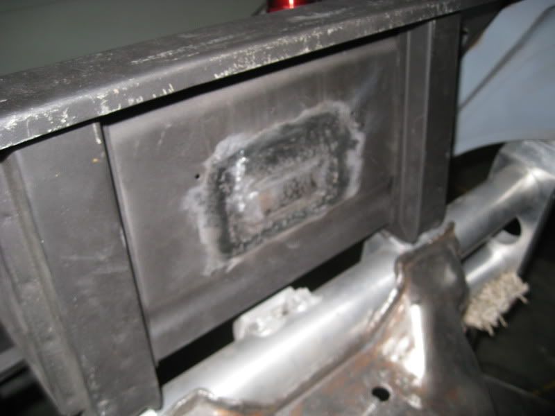

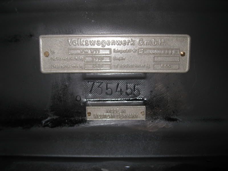

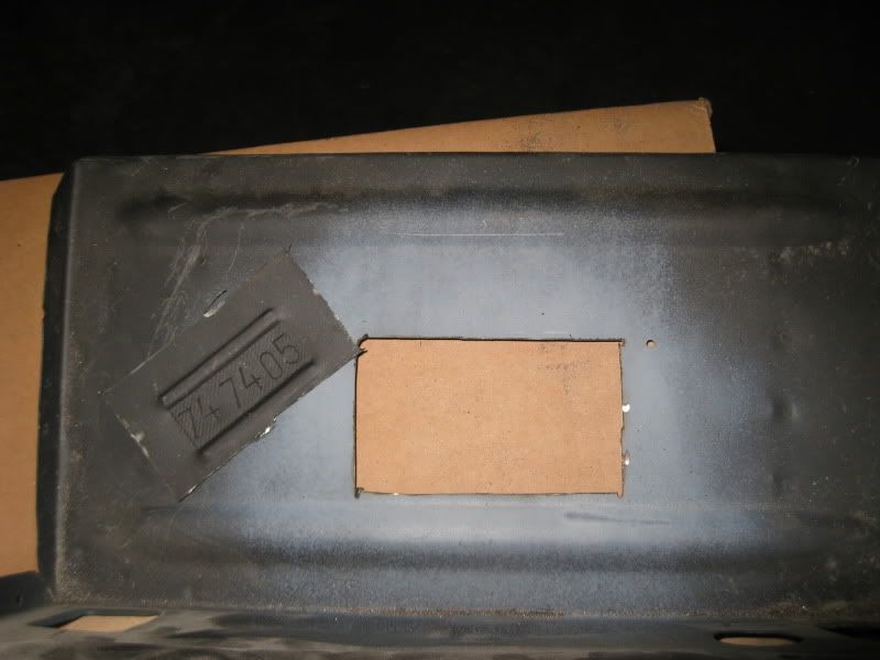

first off was splice the cars original body # back in.....probably my best invisible weld yet!!!

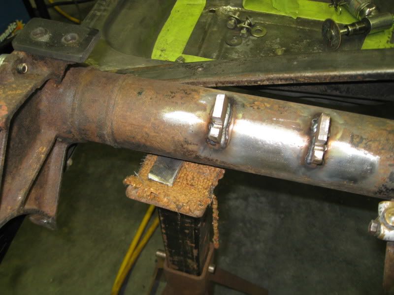

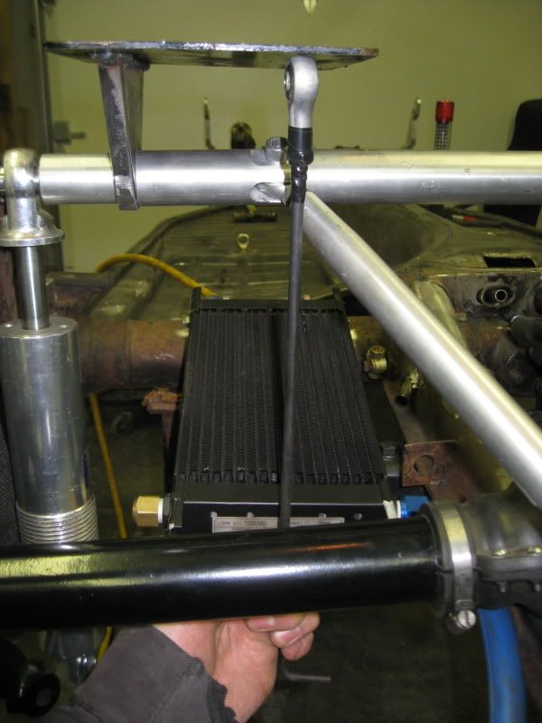

tabs for oil cooler
rear will hang off some 1/4" himes joints off of cage plate and over to frame horn (steel and electrical tape to get rod length...will make up some 3/8" alum threaded bars soon)

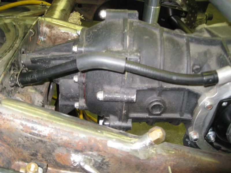

with body out of way got pump/filter attached to frame head and soft lines all sorted.....tight ass fit in there!! still need one more 180 for filter inlet but everything is nice and snugg away from tie rod interferance

tabs for oil cooler
See that weld that goes all around the torsion tube about 4" to the left of your tab?  The OCD in me couldn't leave that alone when I did my Mexican Beetle's pan swap.  I ground it all the way flush before painting.
« Reply #261 on: November 24, 2011, 08:38:35 PM »
Yeah pass side is already done .....

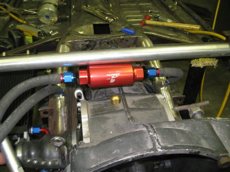

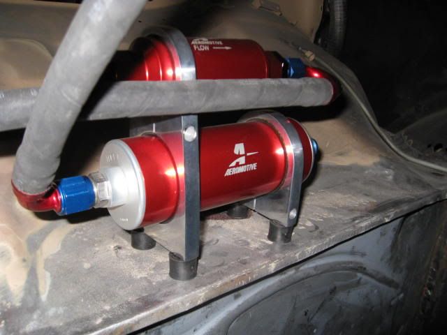

Pre carb 10 micron filter will mount here...

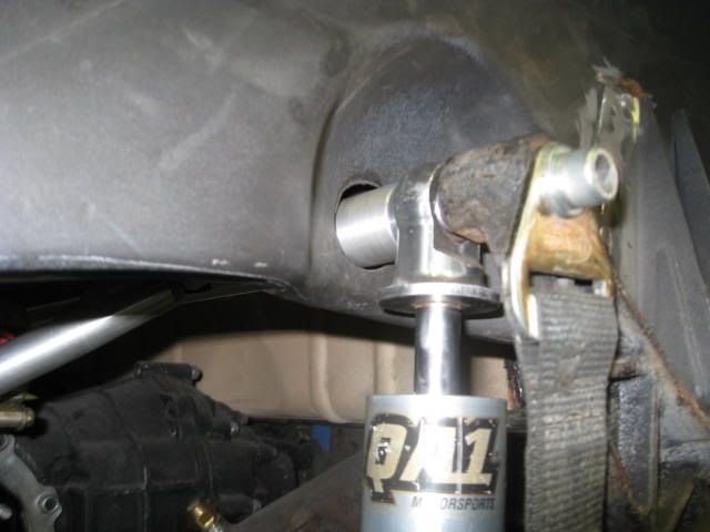

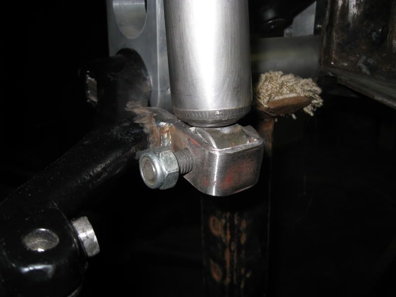

also got lower shock mounts done....my first attempt of just removing stud, drilling and putting in a thread cert failed  .... shock hit upper torsion arm. stood off a little box section and welded up (still needs a little smoothing out....
laid out....
Nothing faux about those. Thats real billet right there. Ie a chunk of aluminium (excuse my English English) and not a casting.
This car is looking sweet.
« Reply #267 on: March 04, 2012, 05:12:48 PM »
Thanks! Those have way too much hand carving to call them real billet...no CNC or fancy cad time :victory:

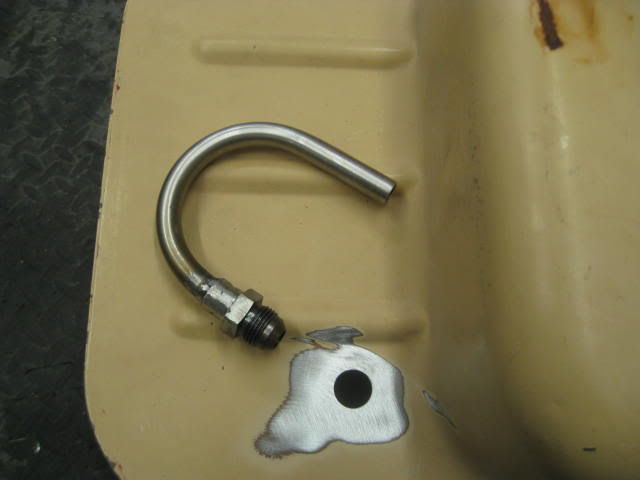

Original plan was to weld an external pick-up hanging off the bottom for the super flow reserve valve to weld to, after much nut scratching I scrapped that idea mainly due to the fear of all the weight bouncing off tank bottom cracking a weld and well bursting into a fiery inferno  =;
Plan B internal baffle type "top hat" thingamobobber cut into tank and mount 3 way valve with a tang welded to pan tunnel connected with soft lines.
Tank all TIG'ed up (forgot to snap a pic o baffle before welded) basically one port has a 3" stub up of 1/2" SS to act as regular running port then other is flush with bottom of tank for reserve. There are a dozen 1/8" holes around perimeter of hat to let fuel in but it won't be able to slosh out and lose suction under hard launches and such..... Well that's my theory anyway
And what it looks like dangling iPhone in though 100mm filler neck.
SS hard line bent in 180 seen is the return line from bypass reg. (aimed it back at bottom of tank so it wasn't firing up top like a fire hose!!!)
Where valve will be mounted....
