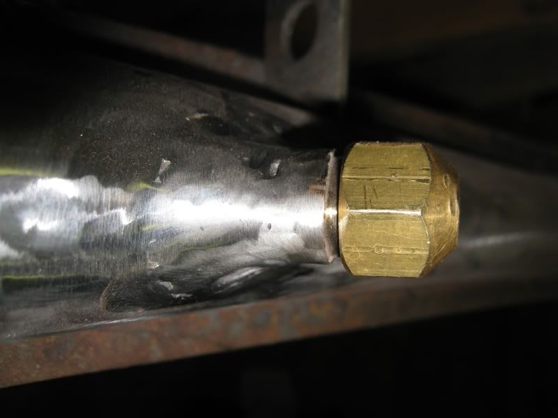

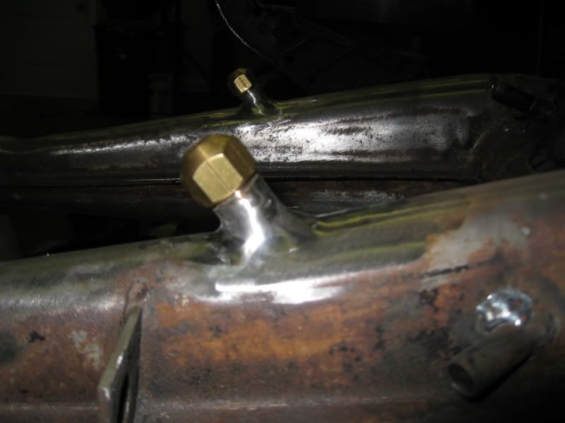

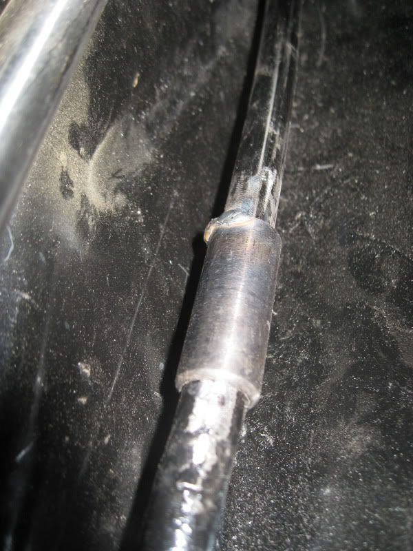

splicing in part of the clutch tube to fix my fuck up, had to make this coupling on the lathe cause I didn't have a full length

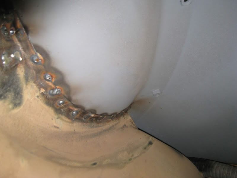

welded in the fuel lines, got a little carried away and built up a shoulder then blended it in to the framehorn

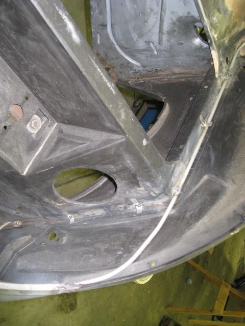

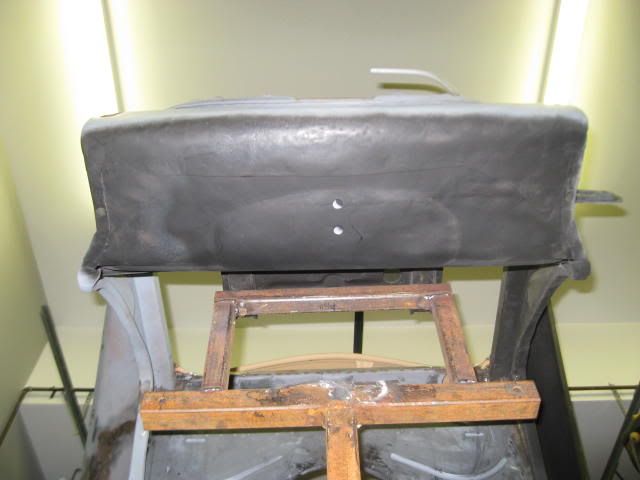

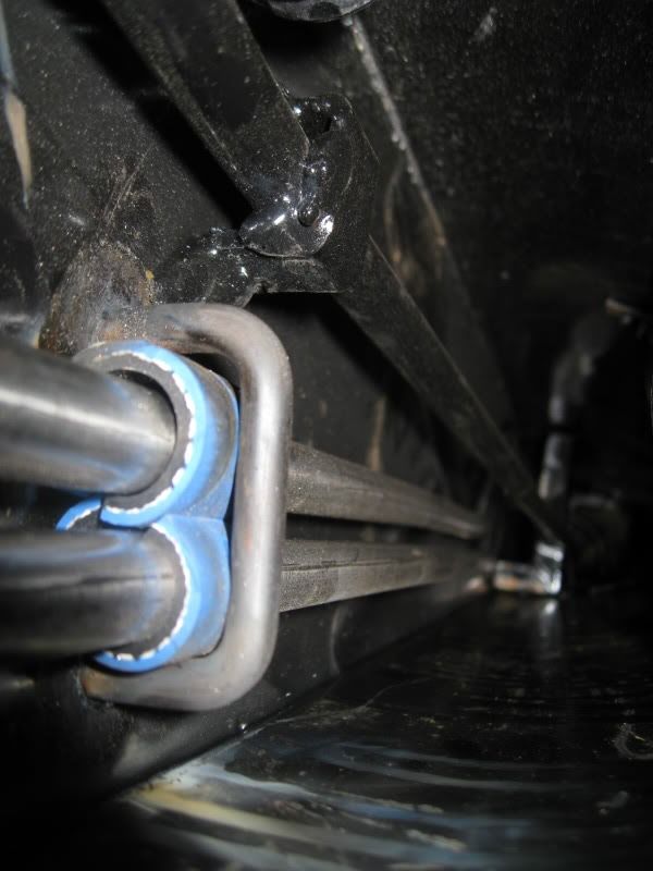

will be running all "non stock" wiring for extra goodies though tunnel to keep it clean, mocking up line lock button on berg shifter here

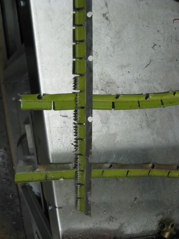

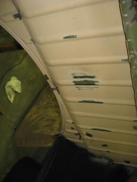

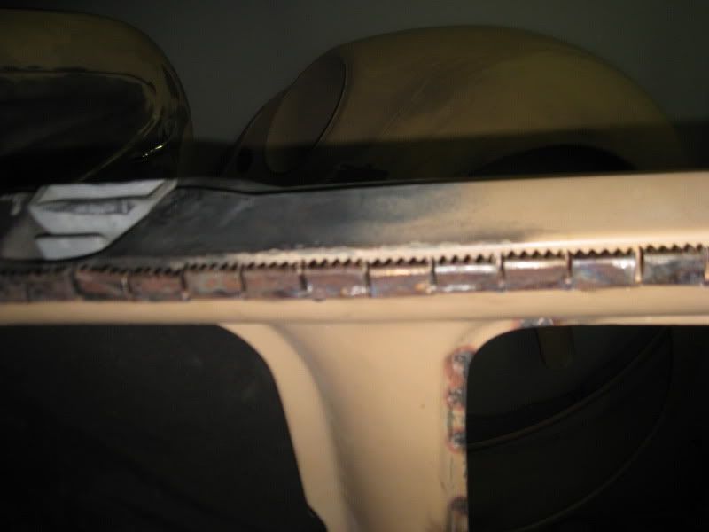

dumb shits before me descided to grind off all headliner teeth on B pillars so having to replace strips

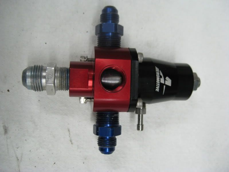

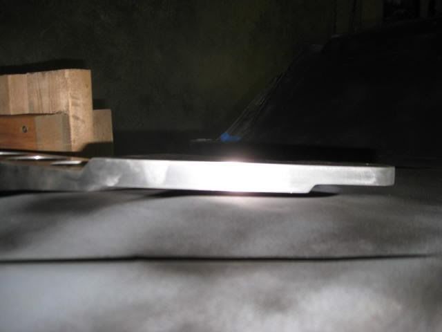

Here's the Aeromotive fuel reg I will be using, got lots of stuff to strip anodizing off and change up colors, -6 to the carbs -8 in and out :o

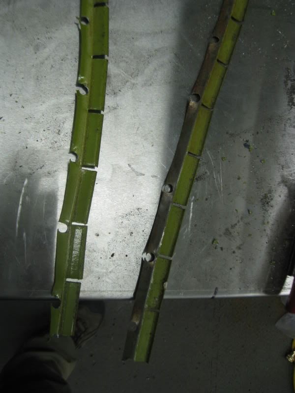

started out with a trip up to a local VW repair guy who has a couple parts cars. I was after a bit more of the B pillar headliner teeth.... it turns out on later bugs the crimp strip is part of the stamping and not a spot welded part, luckily bay windows have something similar!
got them home and me being anal had to modify to match what I had already.... cutting the serrated teeth is fun with tin snips

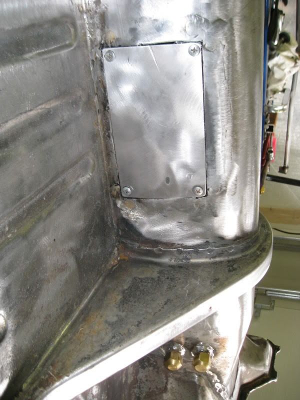

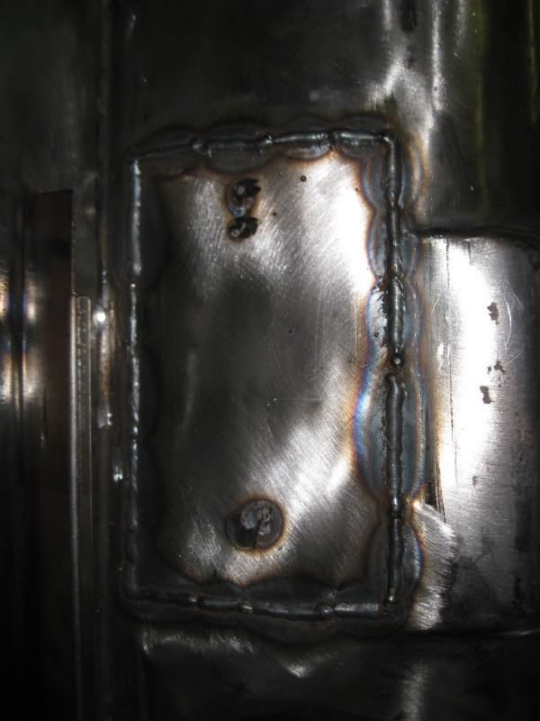

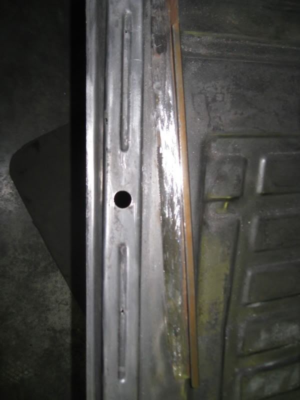

Was done with the access hole in pan by e-brake...
Drilled and tapped for some 5x.8mm counter sink screws for the other

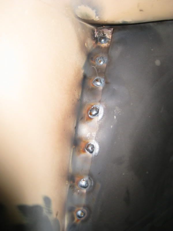

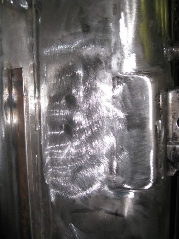

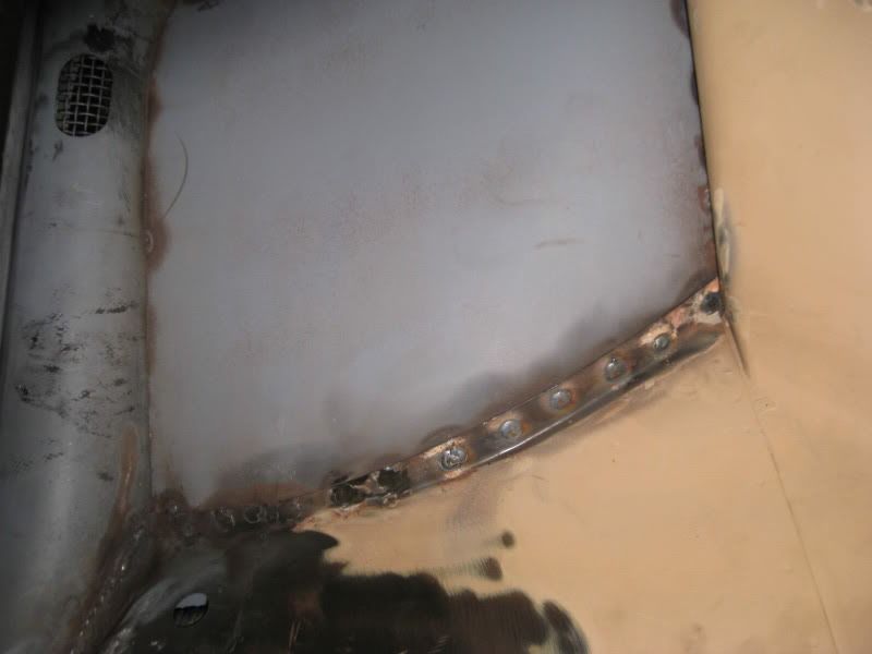

Started looking around at all the welds I had done and not ground down yet...... early seat tracks done....

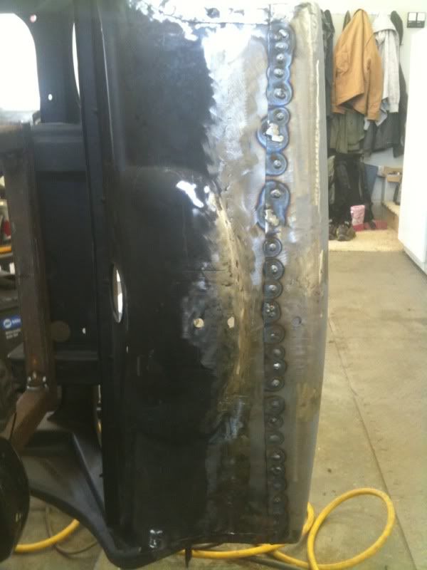

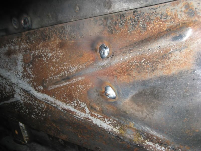

On to more plug welds.....damn I don't know whats worse, drilling them all out initially or welding up and grinding down
Got them all knocked down with the zip wheel just need a little more with the mini sander

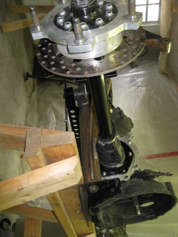

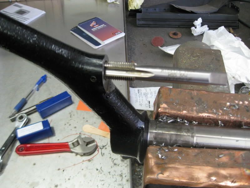

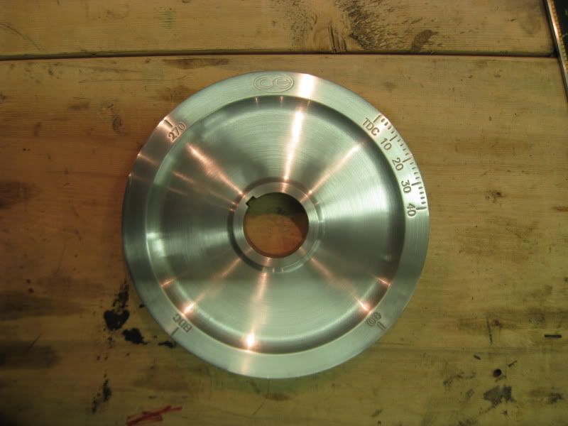

got a pulley off of Rob last a couple swaps ago that had some damage to the blue anodizing so I striped it with easy-off oven cleaner.....

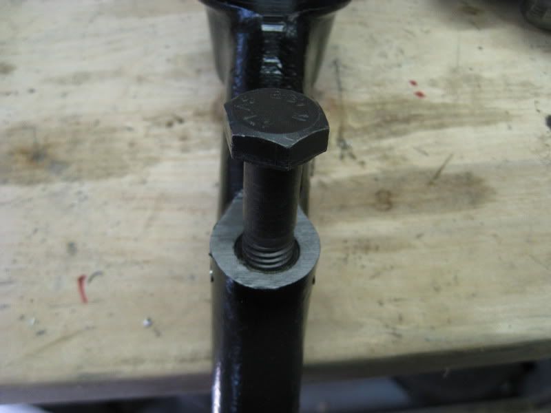

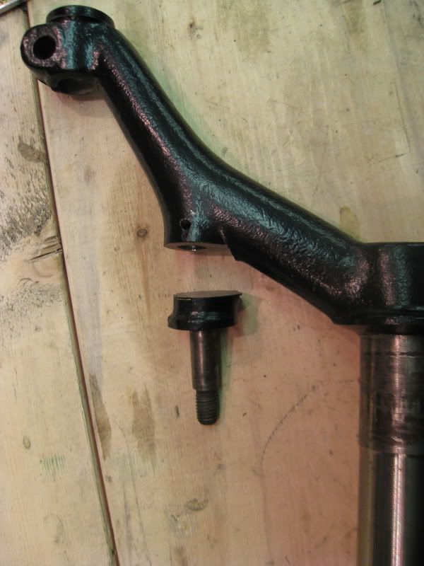

Hacked the studs off torsion arms and drilled out remainder....bit of a prick!

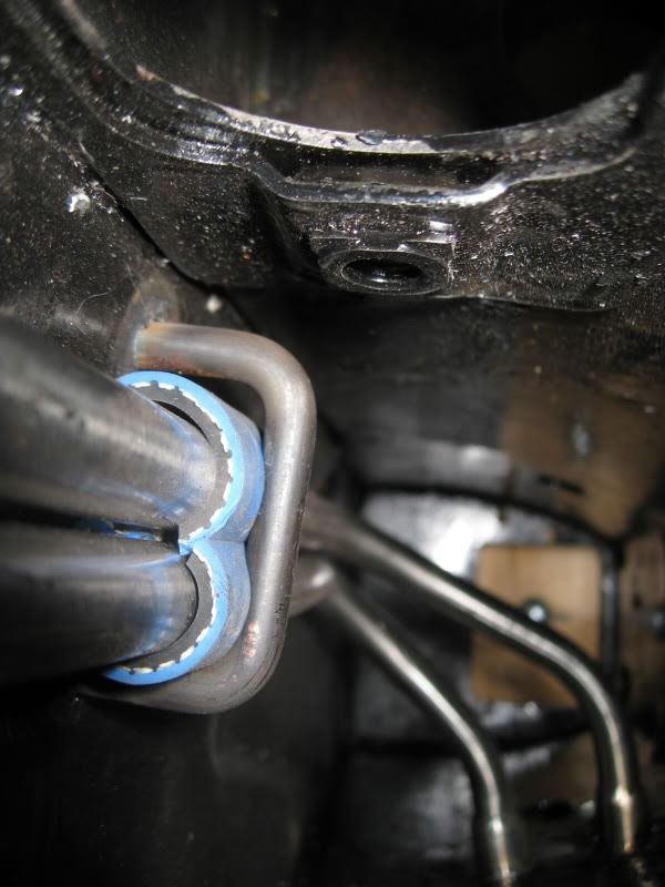

fuel lines finally done...

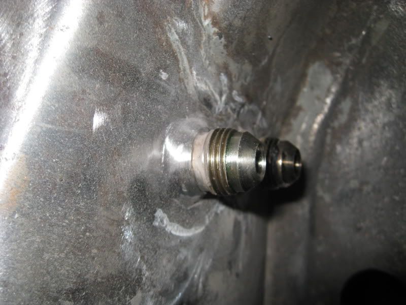

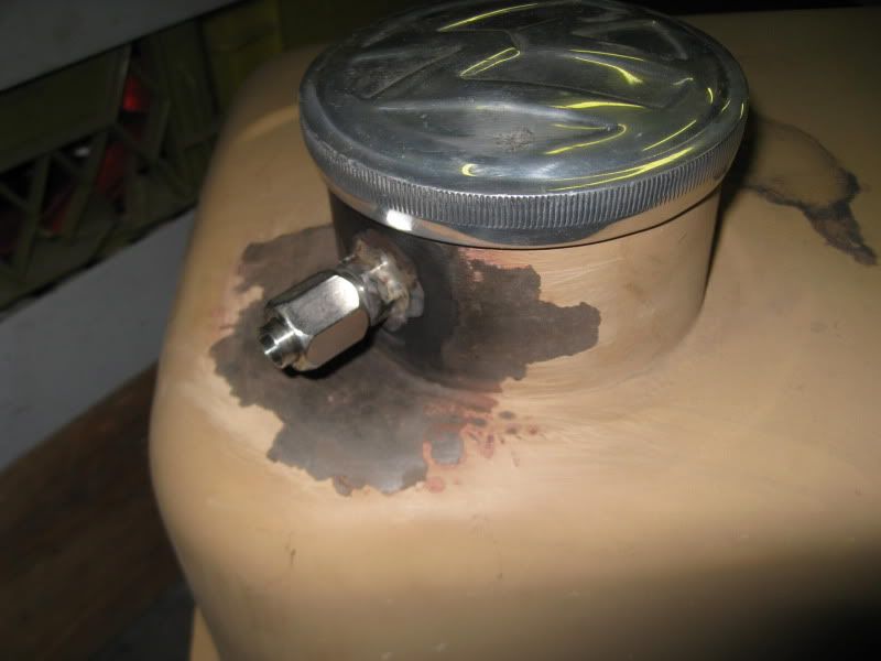

started on my gas tank with a -6 AN vent fitting....
Just wait till ya see what I have in the bag for the reserve valve set-up

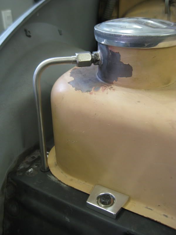

My little one helped out with the tank vent today, she learned how to use a tubing bender, and flare blocks and here she is cutting the 3/8" SS for me =D>
She does nice work.....

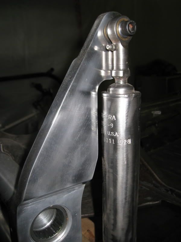

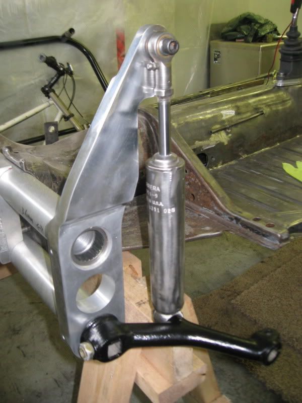

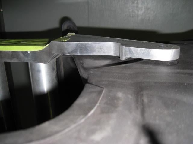

Also got the front shock  mounts sorted....
You can see why I notched the towers like I did.....to give the shock clearance when coming down from a wheelstand Smile

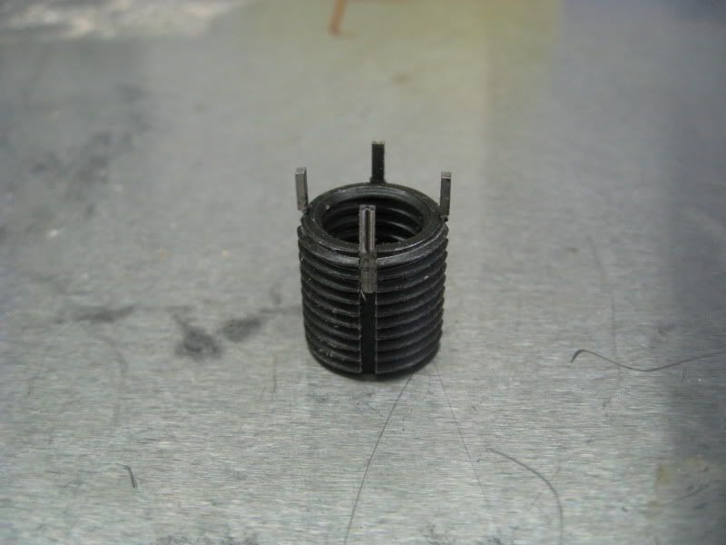

I used some "keen-serts" (way better than a helicoil) in a 12mm course.....
Think I may put some in the upper mount of the aluminum for some extra strength (don't really trust alum threads)

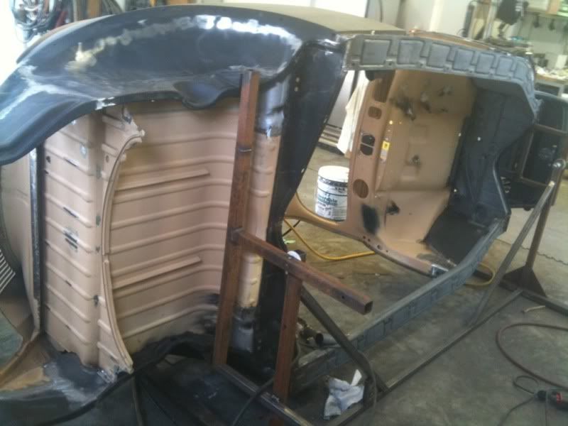

Wicked couple days on little shit that has been put off. For some reason my SD card for my camera crapped out! it's just a small one that I will take 15-20 pics on at a time then upload and erase/ start over.....says it's full with nothing on it!! So sorry for the shitty iPhone quality  on some of these

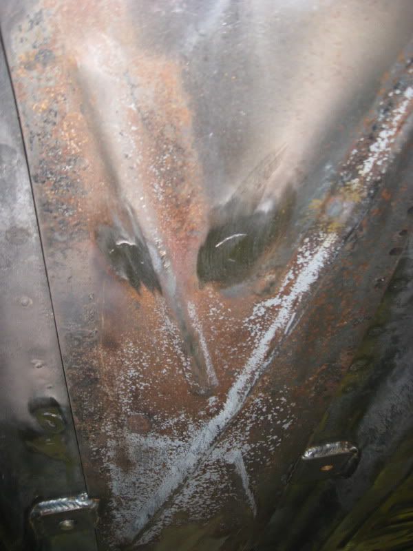

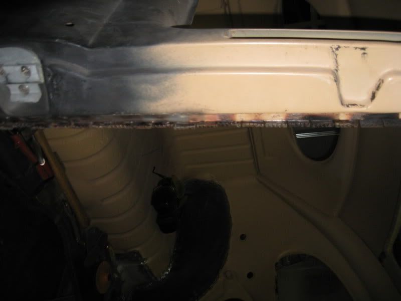

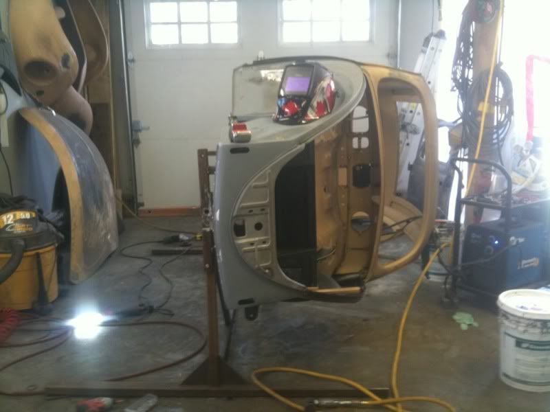

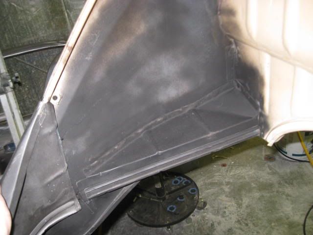

Was welding upside down getting sparks down every piece of clothing and a light bulb came on.....I built a rotisery and haven't flipped the car over yet
Made finishing the bottom side of the apron waaaaaaay easier!!

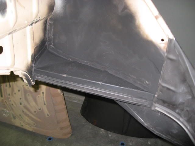

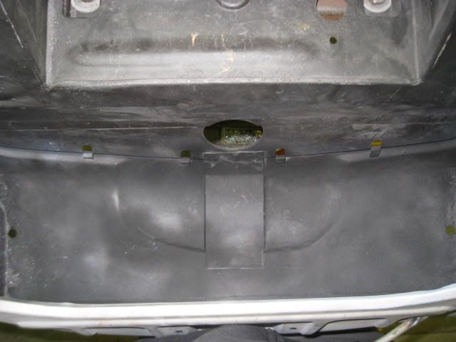

when I started this I didn't know how the bottom of the spare tire well was  shaped
Before...
after....
one side of the narrowed engine bay shelves in

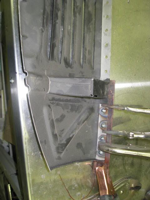

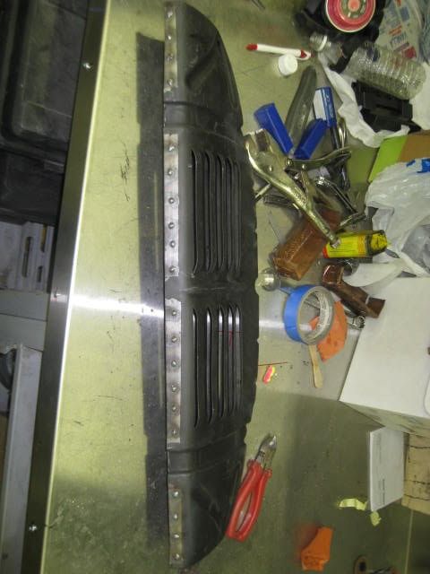

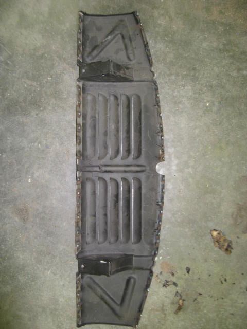

rear vent/louver panel that I removed to blast/paint behind spot weld holes filled (will get glued back on after everything is painted)
tabs made up and welded into fire wall and front tire well for wiring harness
engine bay shelves done

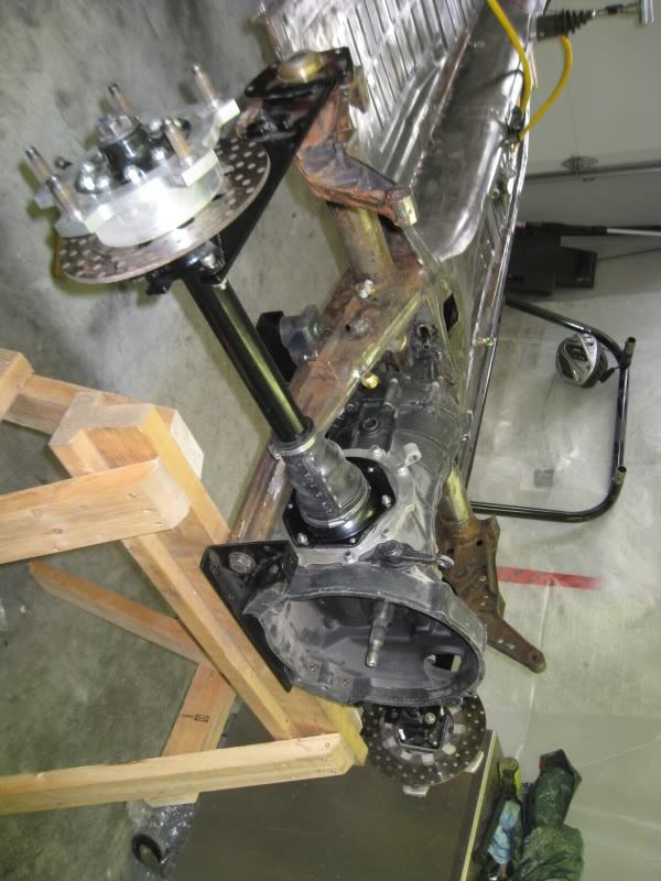

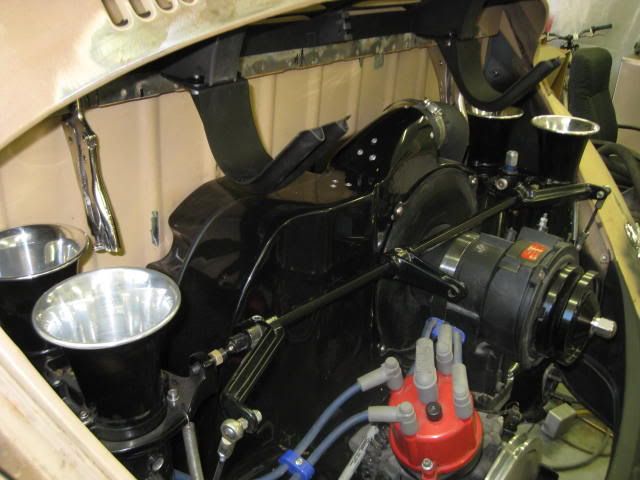

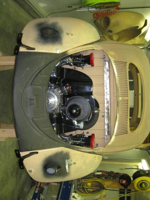

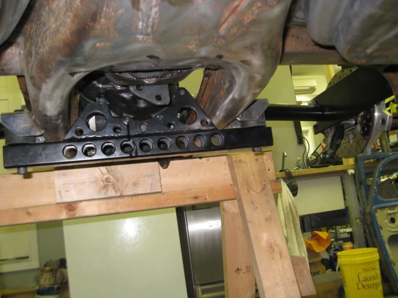

Had a buddy over so used the extra hand and mated the body and pan again. the last notch I did on shock towers did the trick....
while he was still here, we stuffed the motor in (first time this thing has had one in it since I got it ;D)

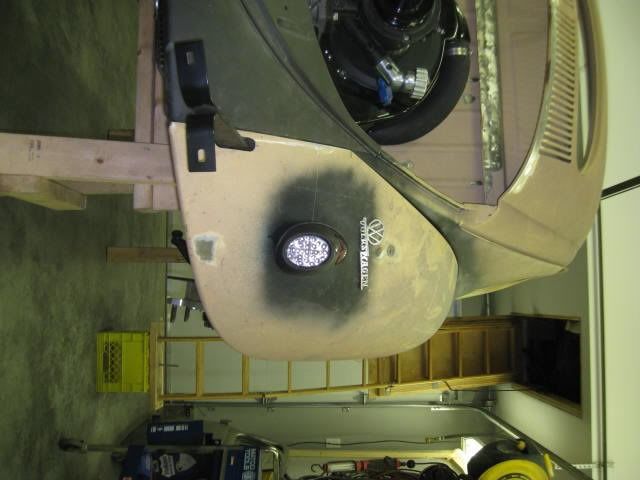

Started laying out heart tail lights and wile I was at it mounted the OE Canadian dealer badge

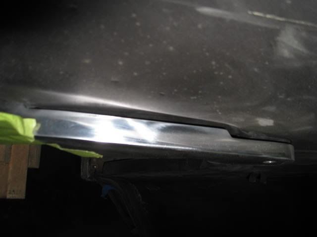

Was gonna mount up the rear bumper but between the NOS bumper brackets and the Wolfsburg west bumper the holes didn't line up  wtf will have to dive in to see what is going on there........but at least my mounts ended up level ;)

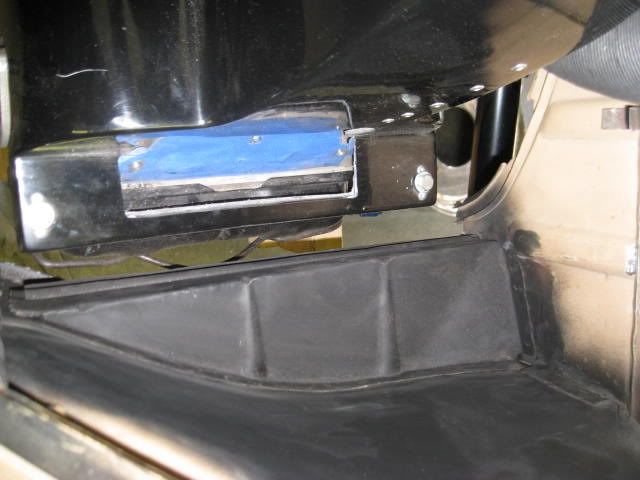

Now that the motor is in I can start designing my breather box and mount the fuel reg

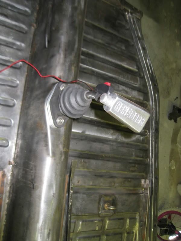

working on gas tank now
the stock reserve lever doesn't support squat for horsepower with its 5mm pipe so here's what I have come up with for a super flow one...
It started as a 3/8" NPT 3 way SS ball valve but to make it more compact and to be able to remove it from tank I drilled out pipe threads and then took some swivel 90 1/2" AN fittings and turned threads off male fittings. took it over to the father in laws last night and practiced my TIG welding skillz. plastic handle was removed and brass insert retained but turned down. Silver soldered a 1/4" universal/swivel socket adapter on (to correct angle) then shortened and swedged stock lever to poke though firewall. will be building a "swirl pot" sort of thing to weld to the bottom of the tank so it has a good solid supply of fuel rather than fuel sloshing around and the pump losing suction.
Will hang out somewhere around here.....

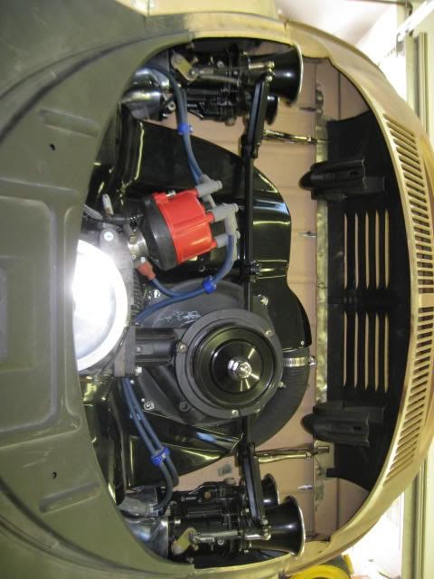

more mock up lately, here's the room I gained on the engine bay shelves...

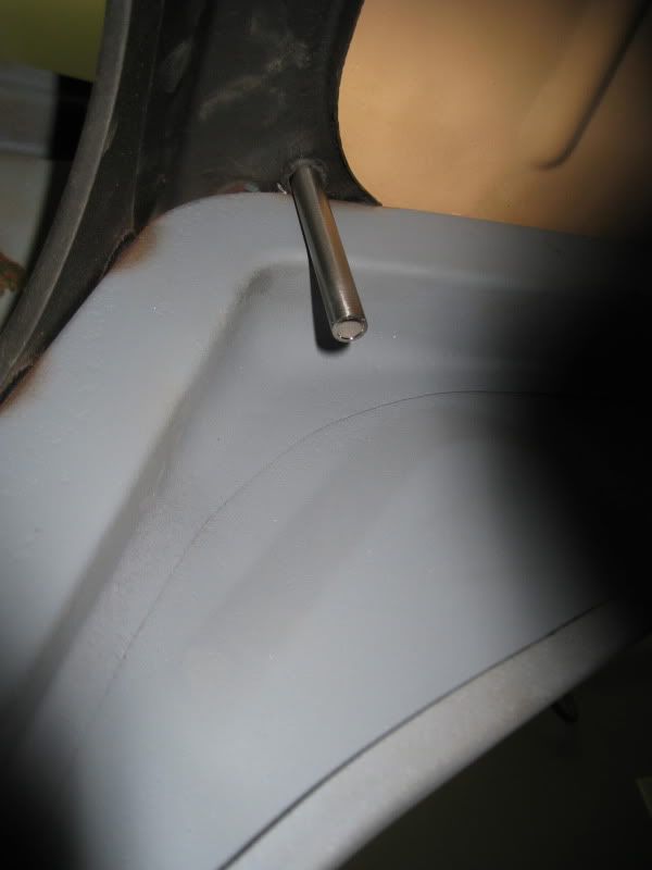

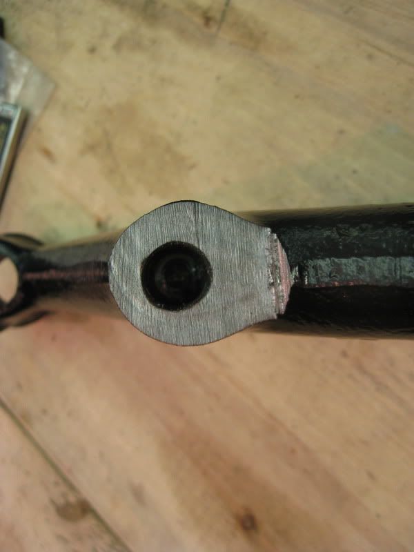

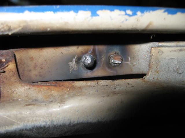

working on the bottom of my doors....vent window upper pivot screws snapped off on one side. used the old blob-o-weld trick and they spun out like butter with some needle nose

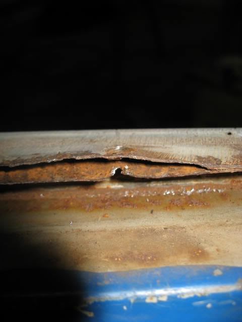

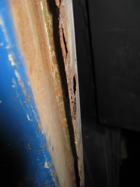

bottom flange was a little rusty between the inner and outer skin and I couldn't just leave it alone, so drilled out all the spot welds and buffed them up, used some picklex and welded back up will probably slop some POR15 inside and let bleed into the flange.

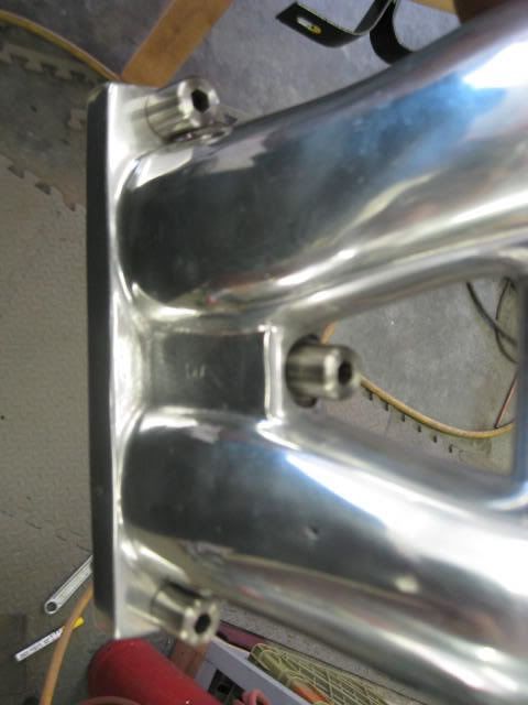

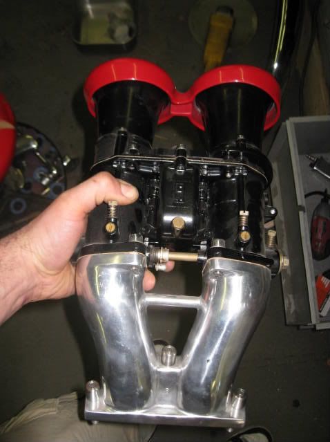

forgot I had these little allen head barrel nuts for the intake and exhaust... rather than the standard 11mm hex ones 8-[
when I was fitting the deck lid I forgot my 57 had stand-offs to clear the velocity stacks....may have to snag some of these shorties...
