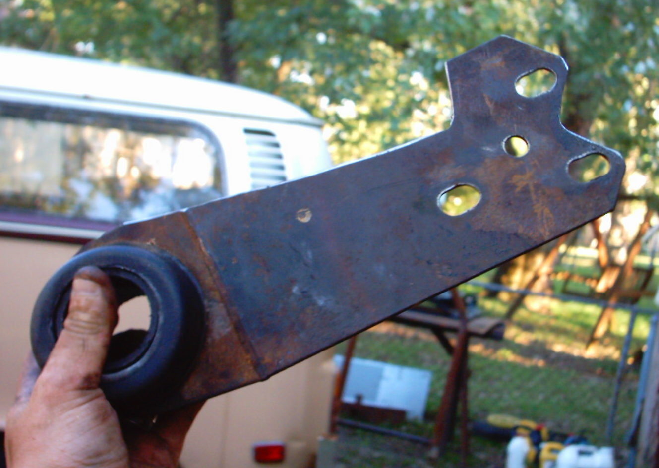

You would still have to cut/notch the spring plate otherwise you will have about this much ][ travel.
I agree, much cheaper to do it yourself.
PS Here's how your at home notch/cut job should look like.

hey, bruce the axle tubes are actually the same length inside, its just the bearing housings are different lengths.... at least the ones i measured were...

that day we were measuring the axle tubes it sure made sense, but i looked into it further and we were wrong....
