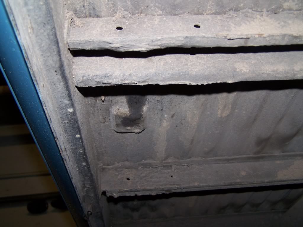

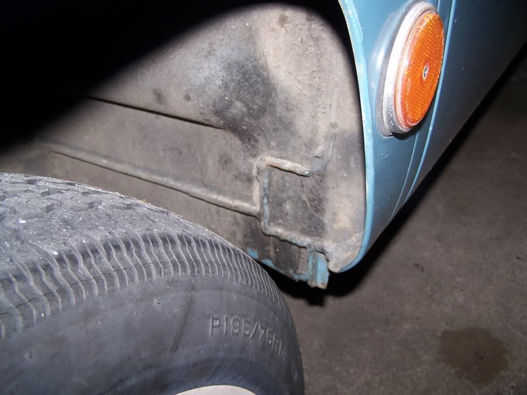

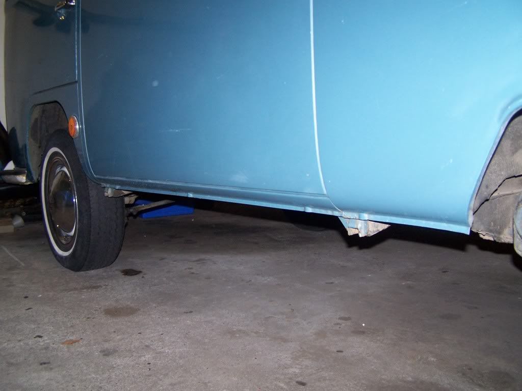

I decided to take a bunch of pictures of the underside of the Bus to show what I'm trying to preserve. Most of undercoating is still there with a few spots of paint showing where the coating peeled off. The only real rust on it is some of the window lip sections (but not windshield) and battery tray corner.
A lot more there:
http://s141.photobucket.com/albums/r48/BadzakAutoDesign/Bus%20Body%20Metal/?albumview=slideshow

The undercoating is your biggest problem.  In many places, it has become unattached to the paint. Water gets in behind it, then never dries out.

Well, I can't do too much about that.

Sure there is.  You can get under there with a screwdriver and chip away the loose undercoating.

LOL, duh. Yes, I could do that...  lol_hitting
