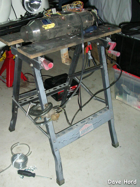

Re: Bench testing late BN2 eberspacher heater
« Reply #3 on: March 13, 2015, 03:21:19 PM »
Not sure what your confusion is?
If you have the pump, the switch, the heater and the wiring harness...it's pretty obvious. I think there is only one or two free connections to be made, one to the power (fusebox in the car normally) and one to the ground. The rest is self-contained within the harness and heater...
My bench test:

thanks for the help folks.  I appreciate it.  I am now all wired up fine and the pump pumps fine ( I think) when I throw the switch.  I got it going once for a minute or so and then it quit.  Can't seem to get it to go again.  I have changed the glow plug and even tried a different heater but only that one short start up.  I will continue to fool with it.  Hopefully if I can get it to go and can run it for a while it would would be good but my problem now is getting it go.  Going to check the voltage at the glow plug to make sure it is getting enough power

Update:  Got it going on the bench similar to Dave Hords setup.  Ran great and the pump continued to pump so everything seemed to work fine.  Ran it for 20 minutes.  Wouldn't start on its own until I jumped a wire directly from the battery to the glow plugs then it started up right away.  Measured the voltage at the relay and it was 9 volts and at the glow plug it had dropped to 6.  Not sure why it dropped so much but obviously not enough power to heat the glow plug enough to start the furnace ( I am assuming).  Now I have it in the car and it will still will not start.  going to get back at it tomorrow and see if I can jump it from the battery and see if it will ignite.  Lots of fun and I am not giving up on this  [
Any ideas why that glow plug won't ingnite the fuel until I jump it:
-12 volts at the red wire going into the plug and trough it
-9 at the relay heavy yellow wire
-6 volts at glow plug heavy yellow wire
