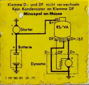

Here it is
Re: Generator question
« Reply #9 on: December 28, 2013, 02:43:09 PM »
When I accidentally touched the ground to the gen housing the generator started to turn.
Then it's now polarized, maybe you've got a wire in the wrong spot?
