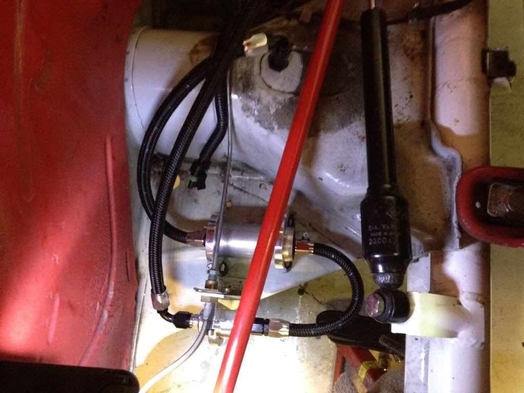

« Reply #9 on: April 24, 2012, 10:20:36 PM »
I got mine from CB Performance and finally got it installed and running. So far so good. A lot quieter that the facet pump I had in there.

Very nice installation!
A couple questions, as I'm proceeding with the same Carter fuel pump install.  Did you wire to the fuse box (for power) to work with the key?  What relay, or other safety system, did you use to stop the pump in case of an accident, etc?  I see a Rabbit relay mentioned above, but I'm not sure of part# or alternatives.
This would be for a 12V '68 Beetle.

Russ, those arent AN fittings on the ends of the pump itself, just hose clamped on the line and a wanna be AN cover to make it look purddy. The pump has its ends built in so nothing unsrews. I thought about cutting off the flare on the end of the pump lines and using compression fittings to be able to use ANs but got lazy and decided not to.
Ive been driving the car all this week and it is sure nice not to have to listen to the rrraaaatttt of the old Facet electric pump I had in it before. Definately an upgrade.

I finally installed my Carter fuel pump yesterday and went racing at Castrol Raceway in Edmonton last night.  The Beetle ran 3/10th's  of a second faster, as I was able to get some 13.1 and 13.0 ET's.  I still have the stock fuel lines for now...one change at a time.
Jordan: thank you for the photographs...I ended up copying your setup for the most part, except I put the fuel filter inside the brake line bracket, but used the same U-turn fuel line.
