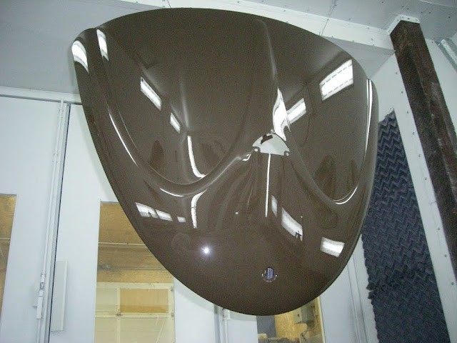

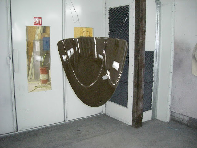

any picture of what it look like finished?
other suggestion?
Offline Jerome
  • Posts: 313
Re: best single stage paint in canada?
« Reply #3 on: November 23, 2011, 10:26:30 PM »
Just have my engine lid painted so far.
Sucks to your assmar.
Offline louis
  • Posts: 37
« Reply #4 on: November 24, 2011, 10:25:30 AM »
wow nice work!
thanks!
