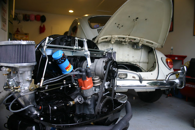

I'm about to mock up the plumbing on my engine and am looking for ideas. About two years ago someone posted pics of their fuel line plumbing for dual carbs. Anyone recall it?
It was a similar shot to this one but using hard lines and black tin.
Any other pics welcome too.
By the way thanks for this pic Dave, with the blue tin you can see the details real well.
Thanks, Randy

here's a pic that our buddy chris w posted awhile ago of his set-up...
not sure but he might have more detail pics too if you need them!
Re: Dual carb plumbing pics
« Reply #2 on: February 13, 2011, 12:58:35 PM »
When I used a stock pump, I had my lines on the forward side of the shroud like that. Now that I use an electric pump, all the lines and Tee are on the body.

Front shot.
« Reply #4 on: February 13, 2011, 09:09:32 PM »
Thanks all, exactly what I was looking for. You_Rock_Emoticon
