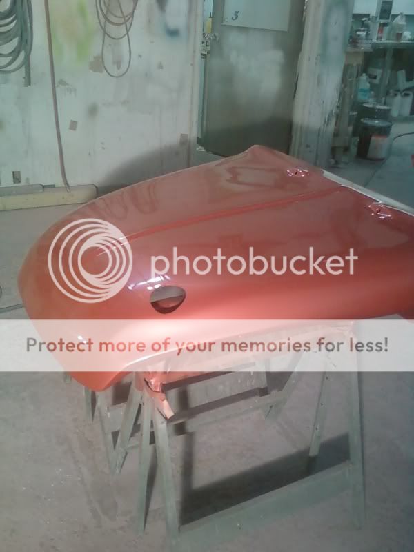

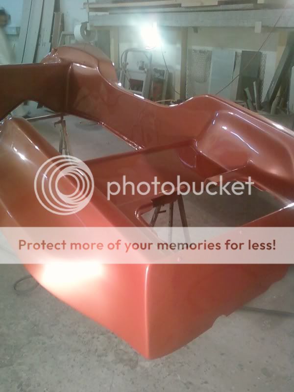

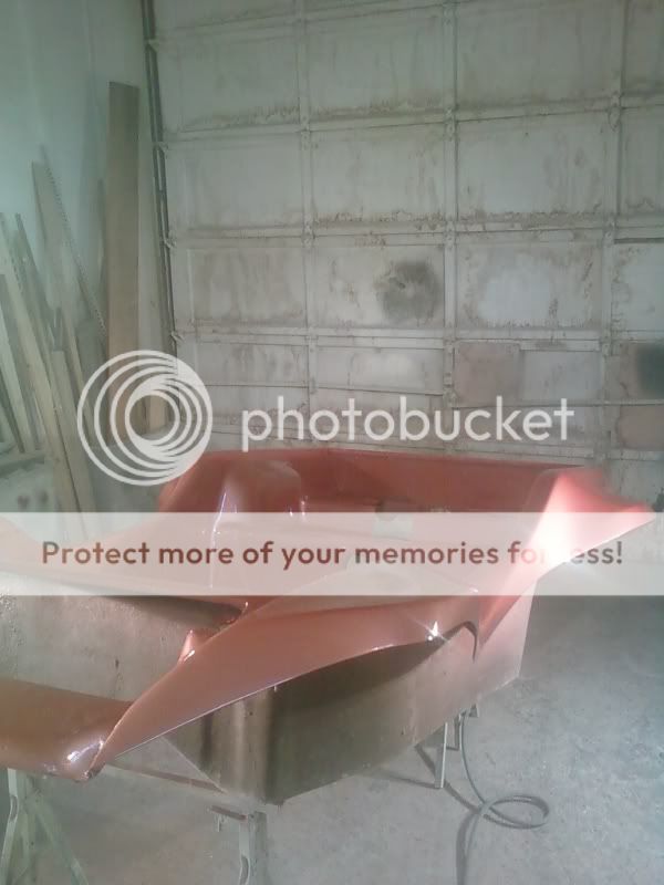

Got the body painted after a loooong day yesterday and it turned out pretty good can't wait to see it out in the sun! Picking up the body Saturday I'm going to try and have it on the road for the show we'll see how things go...

Picked up the body today and the paint looks great, got a few weird fish eye like things on the front fenders to polish out (they're not fish eye's but kinda...?), might need to re-shoot clear we'll see...can't see it in the sun though. Other than that turned out great, it was my first time doing bodywork so my bodywork's not perfect and I rushed it a bit but I am still really happy with it. Gotta pull the engine and redo transmission mounts then it's time to re-assemble and wire it hopefully in time for the show

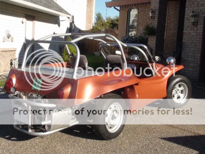

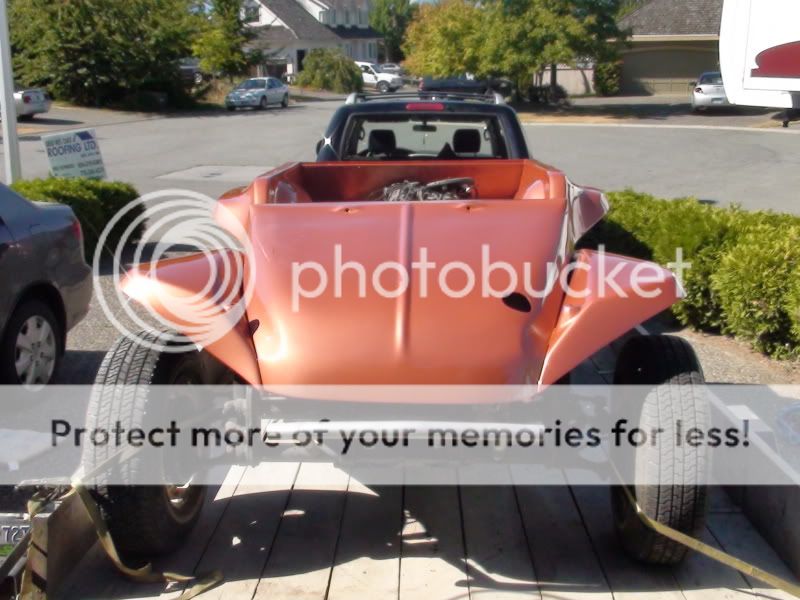

So the buggy's been on the road for the last week or so I was so close to making it to the show but even if I would've had it done I had some cooling problems after...anyways for now it's all worked out engine's still running a bit hot (210) but I still have a few things to do to improve cooling.
Anyways so today the plan was to go on a mini cruise with Stu to White rock, as we pulled out on to the street my buggy started to bog down and stalled. Fired it back up, went 40feet and same thing again so we pulled up at to the gas station. Figured it was a fuel problem so I pulled off the fuel filter and it was clear, just as Stu was about to head out and grab me another one I realized there's barely any fuel coming out of the tank. Checked to see if I have fuel..check, add another 10bucks still nothing. Got under and blew into the line and finally fuel flow! There's a small rust patch inside the tank so it looks like that's what clogged the line. So what was supposed to be a cruise to White Rock ended up being a trip to the Tim Hortons around the corner  lol_hitting
Still had a great time!

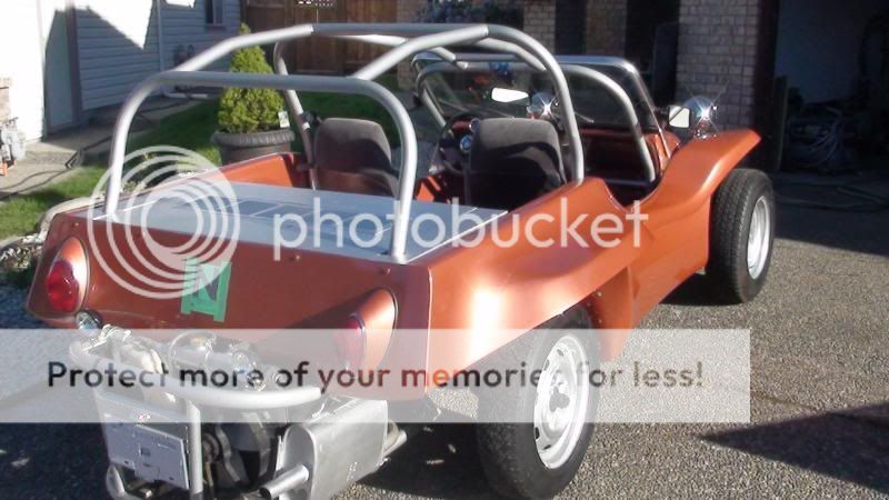

I`m just glad to have it on the road! It`s not quite ready for a close up, there`s still lots of details to take care plus it never really ends  :D . Let me know if there`s a buggy cruise or something coming up and I`ll try and make it otherwise you might see me around or at the show next year!

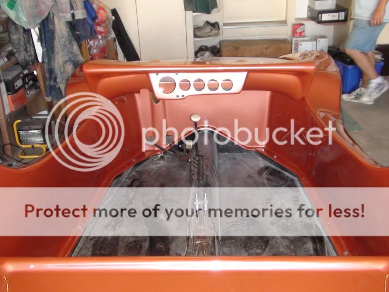

More pics:

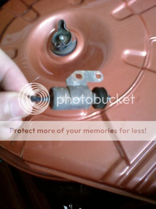

Took a day to pull the gas tank out and get rid of that clog, turns out that the valve on the bottom only had a 1/8" opening so the smallest spec of dirt clogged it. Replaced it with 1/4" spout and put one of those cone like screen on the inside to make sure it doesn't clog again...100miles and no problem so far!

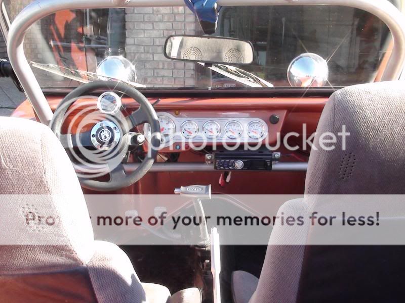

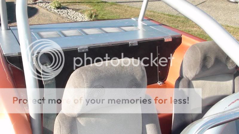

The engine cover does make it look a little cleaner but I still want to wrap it in vinyl like you suggested and close up some gaps and I got a back seat in since it always seems that I have two people with me and I'd rather drive the buggy than the corolla.... Also switched the tail lights around like you suggested and looks much better, not so cross eyed (I'll get a pic sometime...), got some floor mats and wired up the stereo to the speakers in the headrest, they work!

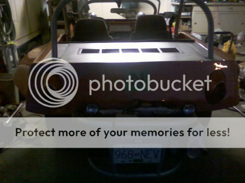

Tail lights switched, I still need to do something to clean up the back end, different location for reverse lights and reserve bottle, put license plate where N is to help airflow, some sort of cover over the rad and maybe paint the shrouds orange to tie in with the rest of the buggy...anyway sumertime
I was hoping this pic would show the new floormats but it was too dark, anyways here's everything all lit up
