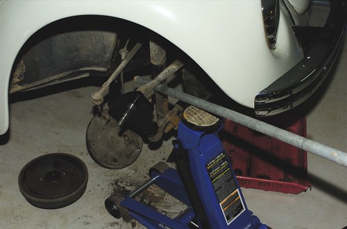

VW has a unique ball-joint tool to remove the bottom ball joint from the spindle, and you'll need to do this ball joint first. I positioned my floor jack under the spindle assembly so that I could just catch the edge of the spindle (keeping the lower torsion arm and ball-joint free). Lift the jack until the suspension _just_ starts to compress. Pull out your big hammer, tap or hit the lower torsion arm which should pop the ball joint free. You won't pop it all the way out of the spindle, you're just looking to 'break the bond' between the spindle and the ball joint.
VW's second tool is a system that lifts the upper torsion arm, by spreading the space between the two arms. I positioned my jack near the assembly, grabbed a long piece of pipe and used it to leverage the upper torsion arm up. You'll need to lift the upper arm enough that that spindle clears the lower ball joint, and may need two people. One to use the lever, the other to catch the spindle.
To pop the new spindle in, first slide the upper ball-joint through the spindle and snug up the castle-nut finger tight. This hold the spindle to the upper torsion arm, and now you'll need to use your pipe-lever to raise the upper torsion arm. Again, you're lifting the upper arm enough to clear the lower ball joint. Lower the spindle onto the lower ball joint. Having two people makes this job a lot easier.
