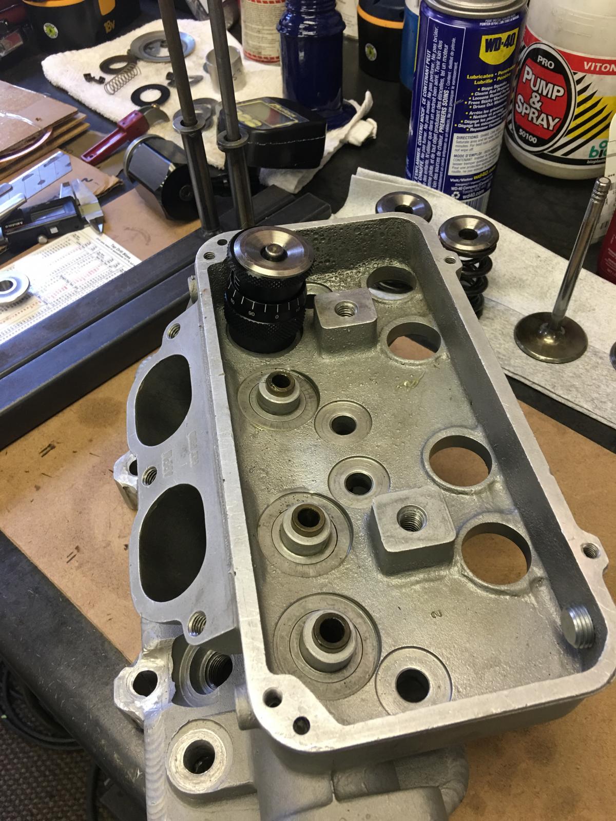

   Here is something you may of never seen before ,
Need to freshen up your heads at the track , just slide the complete
Aluminum boss and guide out and replace it , pretty trick
Sorry real crapy it’s not that trick but actually a old school way still done
If needed to repair heads that no longer can support overaized valve guides.
Like I said these Frankenstein heads have all the tricks .

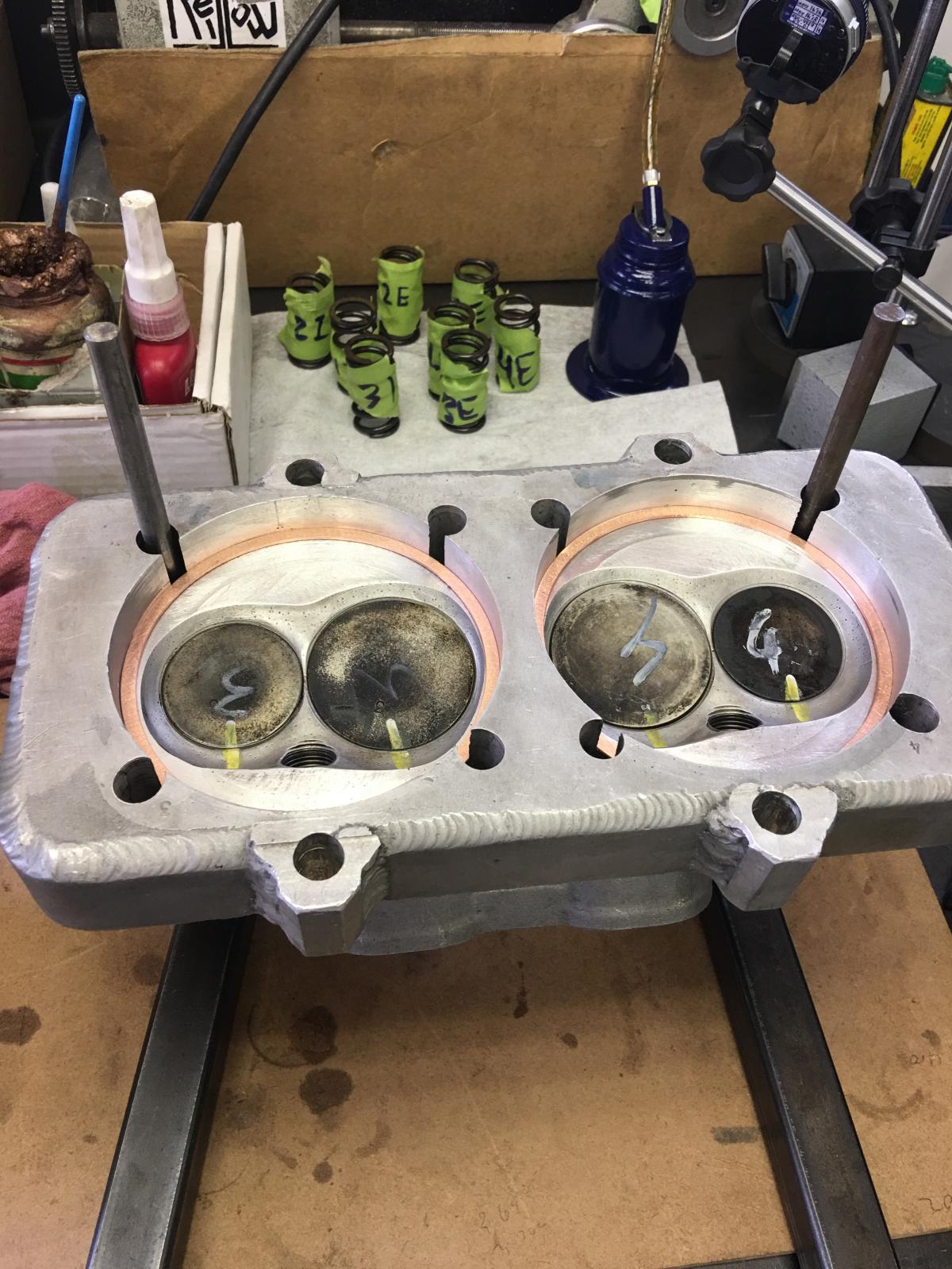

   So heads at this point are welded and repaired, spark plug threads repaired.
And valves are all inspected lapped in and tested for position and sealing ,what?
There is no valve rotation anymore . The clamping pressure of the valve keepers
Against the spring retainer and on the valve is so great there is never any real chance of rotation.
Now you know in this picture the valve to valve seat position has been marked .
This is the real way to check for valve sealing , this is a shot of my comp eliminators
At Darrens after a quick repair, you can see it’s built up vacuum over 25 inches and
Seals so well you can lift the head off the bench no problem , I do The same at work using my
A/C machines vacuum pump , as well tested and found best position on my heads this way.
  Recap , all head repairs performed . Valves guides measured and ok , valve position marked and tested
Spark plug threads and welding and machine work done , time for valve spring upgrade next

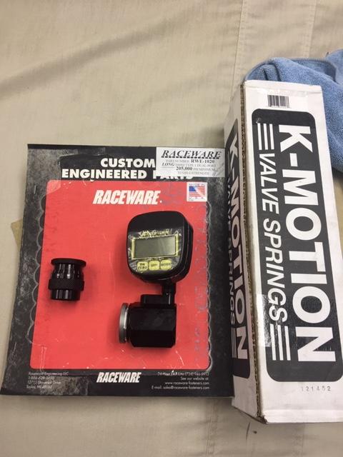

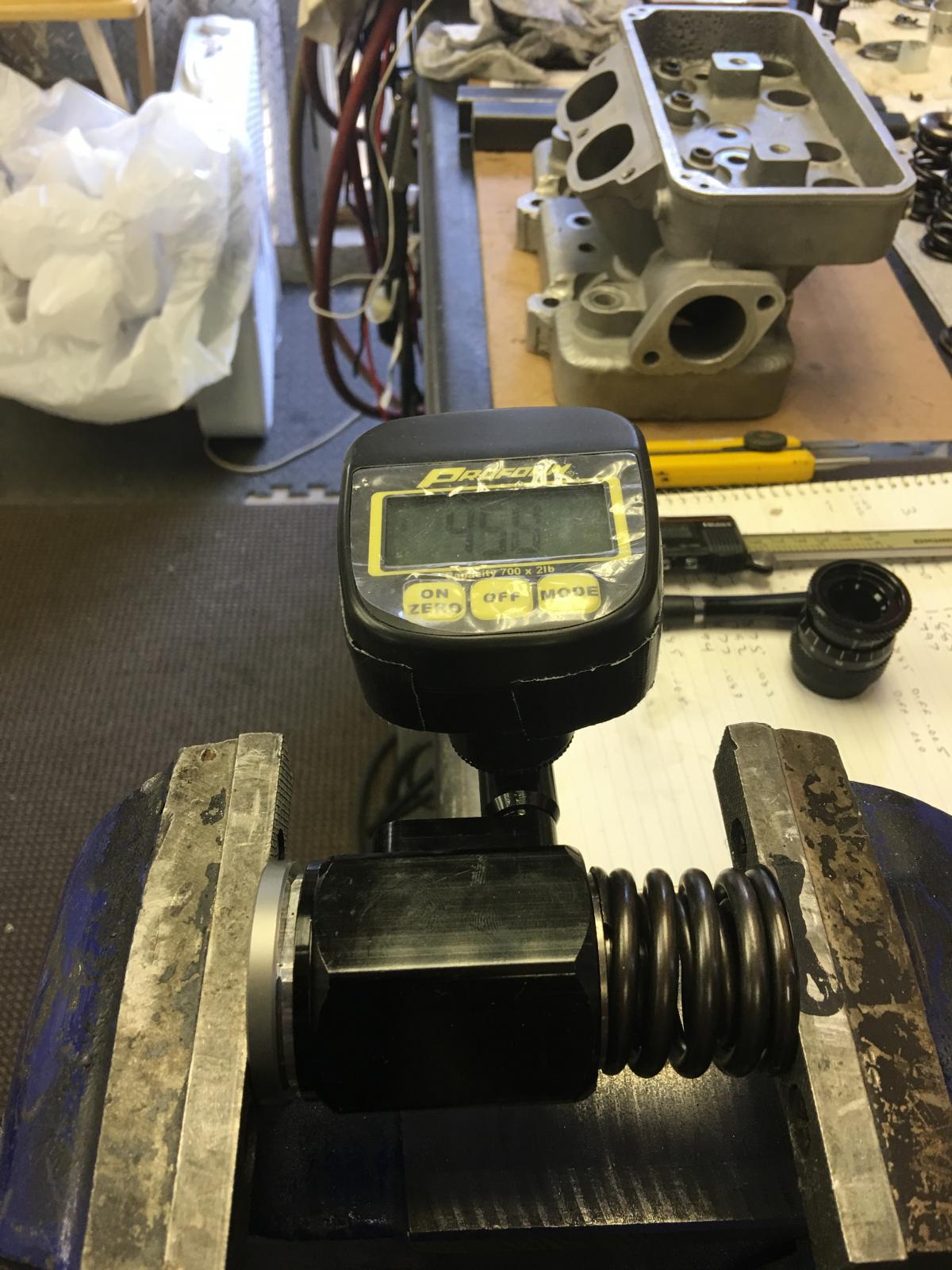

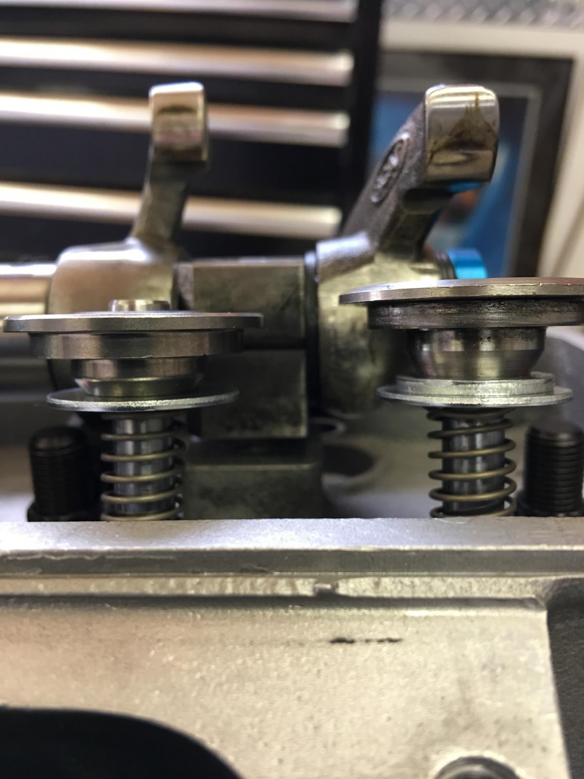

   here we go ,Kmotion k800 valve springs ,Raceware head studs valve spring pressure tester and installed spring height micrometer
the next step was part need to know spring installed height and old spring pressure test
as well as test new spring pressures and adjust spring height .and test possible new spring retainers.
my old spring retainers are getting pretty beat up so I wanted to replace as precaution.
not so easy as like we know my heads are old and so are the valves which are still the 3 groove vw style and not the new
single groove v8 style that everyone uses now.the difference is also the angle of the keeper 7 deg for 3 groove and 10deg for single sure grip style.
well I did find a pair of 8mm /7 deg retainers made for my k800 valve springs made by comp cams , so brought a set in to check.hey never know ?
compcams on the left and my retainers on the right ,crap as you can see big difference on possible installed height but gotta check.

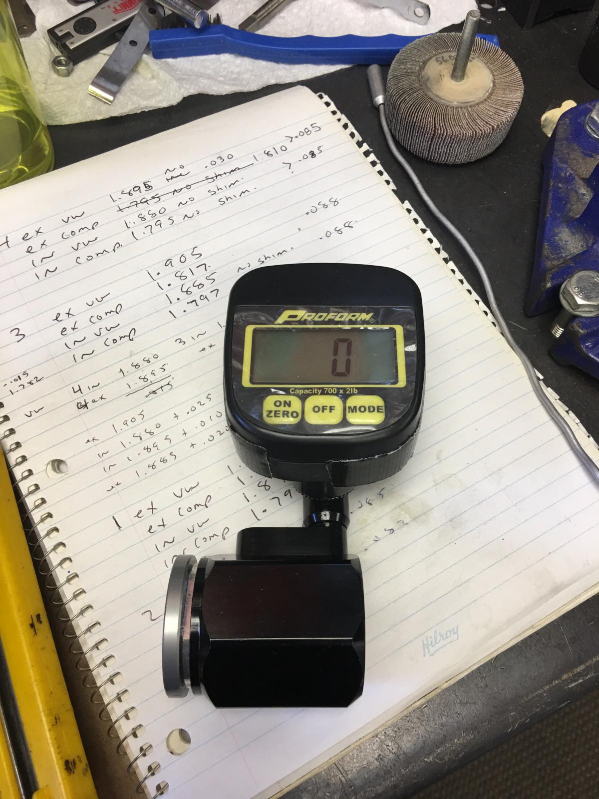

   So the data begins ,yep takes time but need to know -measure every installed spring height for all 8 valves to start
   this is where you need to be organized as its easy to screw up .
looks like original installed height on #1 exhaust measure 1.875"
once I had check all original spring heights time to check with the compcam retainers.
data done installed height for both retainers completed
Offline jim martin
  • Posts: 1406
Re: Jim Martin
« Reply #332 on: January 08, 2020, 08:00:55 PM »
— So what does it all mean and why?
In the past always felt as motor seemed to roll over a bit and flat line power wise in the top end back of the track ,could be many many things and hey valve float could be 1 of them .
So that’s why collecting the old valve spring data was very important .
    Now data from Kmotion goes like this ,they do not give you a installed height but a coil bind number ,in my case k800 springs are good for max compression
Of 1.080”and from that add a safety cushion of 0.060” plus your lift say 0.560” add them up and that give me a min installed spring height of 1.700” so I have lots of room
From my old installed height of 1.860” , 0.160” is allot.
     Next I started measuring all my original springs pressures using my spring tester ,into the vice they go , not shown is 2 machine blocks I made
to keep things identical .1 block for original set height of 1.860” and the other block for 1.310” representing my old lift height .so when you tighten the vise pinching the spring against the
spring pressure measuring tool the machined blocks stop the Vise at the same point every time .
  Found some old data I had written down looks like this ,ill say im checking 2 things when I look back at it .
what were the original installed pressures and how bad are the springs worn at installed height and various lifts.
   I see for example my original installed spring height of 1.860” the old springs were 160 lbs and the new spring was 14 lbs stronger at 174lbs
                 OLD                     NEW
1.860"    160 lbs           174 lbs + 14
1.820"    178 lbs           200 lbs + 22
1.320"    394 lbs           439 lbs.+ 45
    Since I new my original valve lift and installed height I could use the chart on the Kmotion site and then compare at my end .
 1.860" right about 160 lbs, ok .minus my old valve lift say .536”= 1.324" so about 410 lbs, a bit weak but with out knowing how old these springs are not bad .
what I changed was this .
  valve spring installed height shimmed to 1.820"  exhaust  (38mm SS valves )
and 1.800” spring installed height for the intakes (46mm SS valves )
so 1.820" - .550” = about 1.270” = 200lbs installed height and 450lbs  over the nose .
  And for the intakes 1.800” -.550 = about 1.250” = 210lbs installed height and 460lbs over the nose
Yep pressures are up ! Not huge but 40-50lbs is allot ,

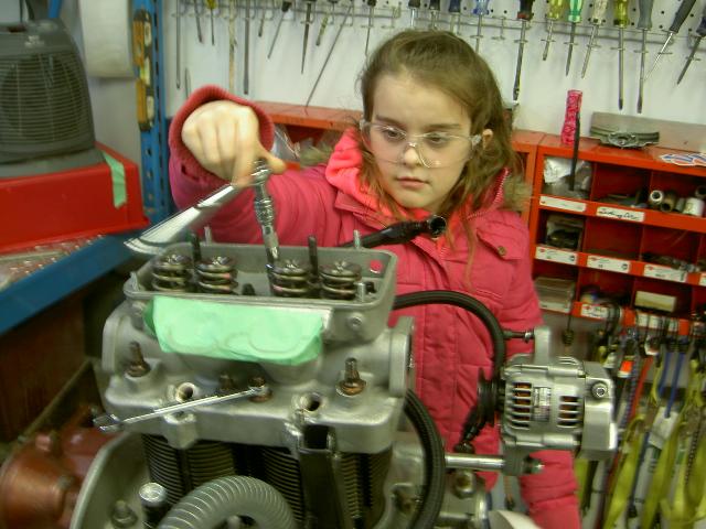

I was asked about torque wrenches ,yes I have both digital and clicker style ,both Snap-on and for engine work
I will always use clicker style ,I found it to be more consistant as you use the same speed and motion resulting with a release click .
Where as with the digital it doesn’t click just beep and I find as you approach the torque your pull speed varies to much resulting ion uneven torque .
Great for checking torque and certain things but not head studs

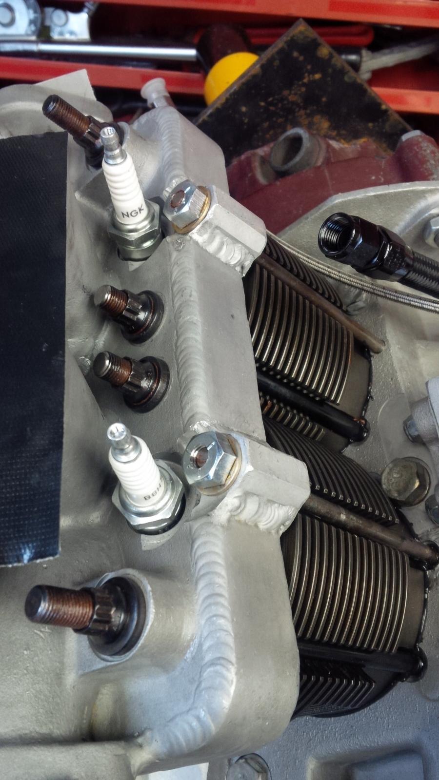

great shot , heads fully torqued and you can see the trick 6th stud nuts , they recess into the heads and centre the 8mm head studs  ,
 again there just pretend now , but they still  look cool .
head studs are left long , great place to attach things ? in the future
« Last Edit: January 08, 2020, 11:14:37 PM by jim martin »

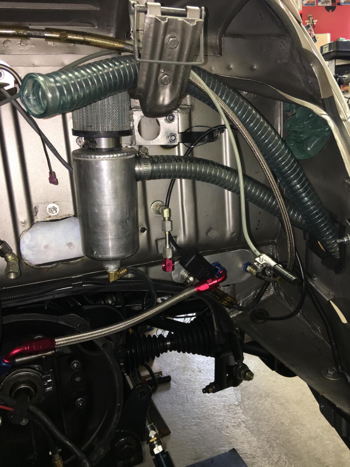

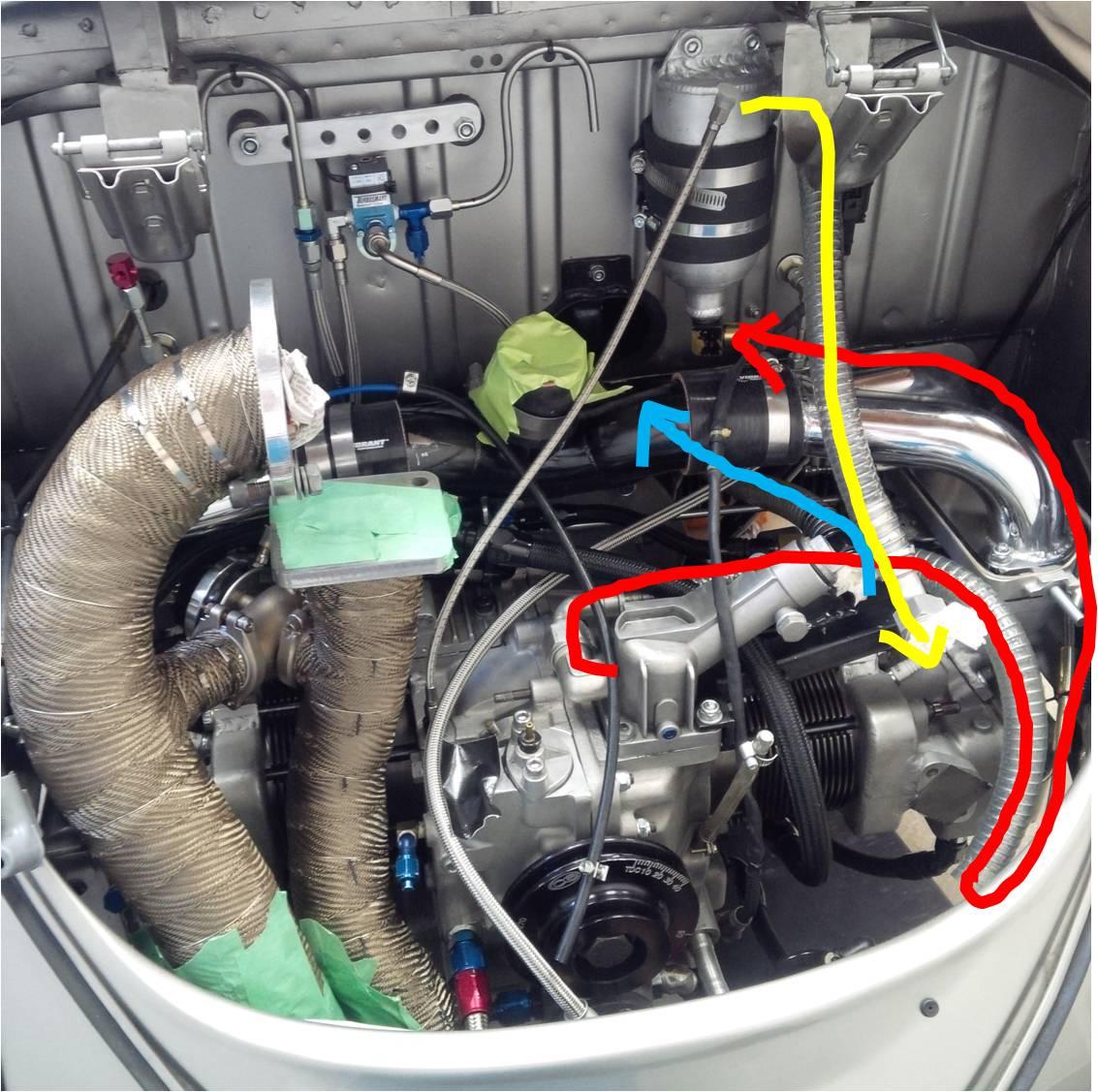

Dry-Sump oiling .
who says can't be done ,not me.
  the main issue in running dry sump oiling in a VW bug is SPACE.
Tube chassis race car , no issue .Steel bodied vw big trouble .
many that try give up and put the Oil tank inside the car ,totally dangerous as having
6-8 litres of 200 deg flammable oil inside a car during a accident could be bad .
  So where to put it ?

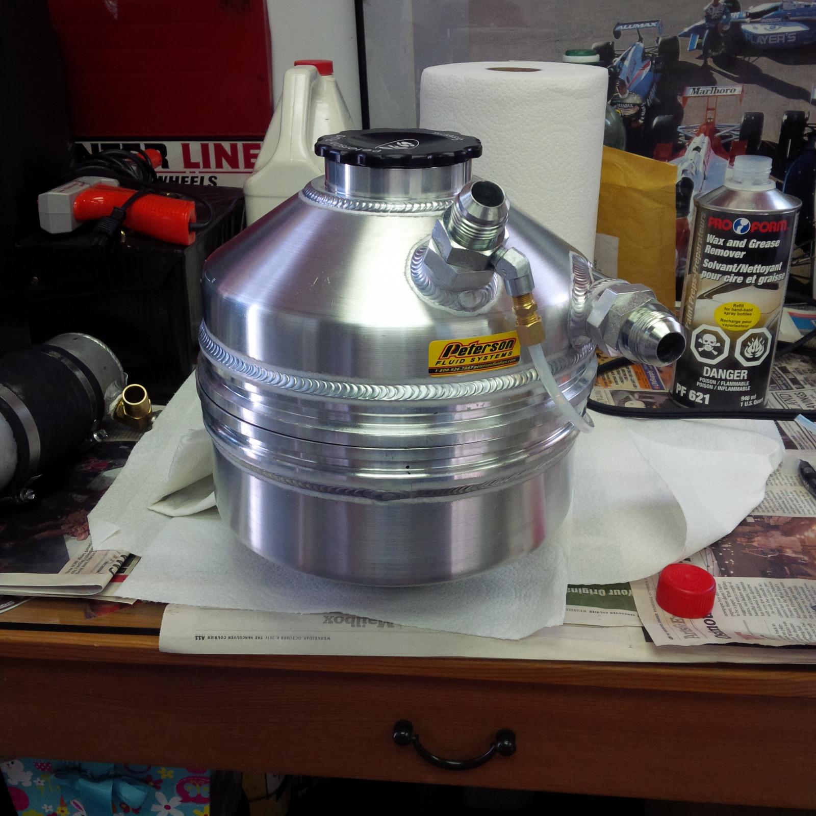

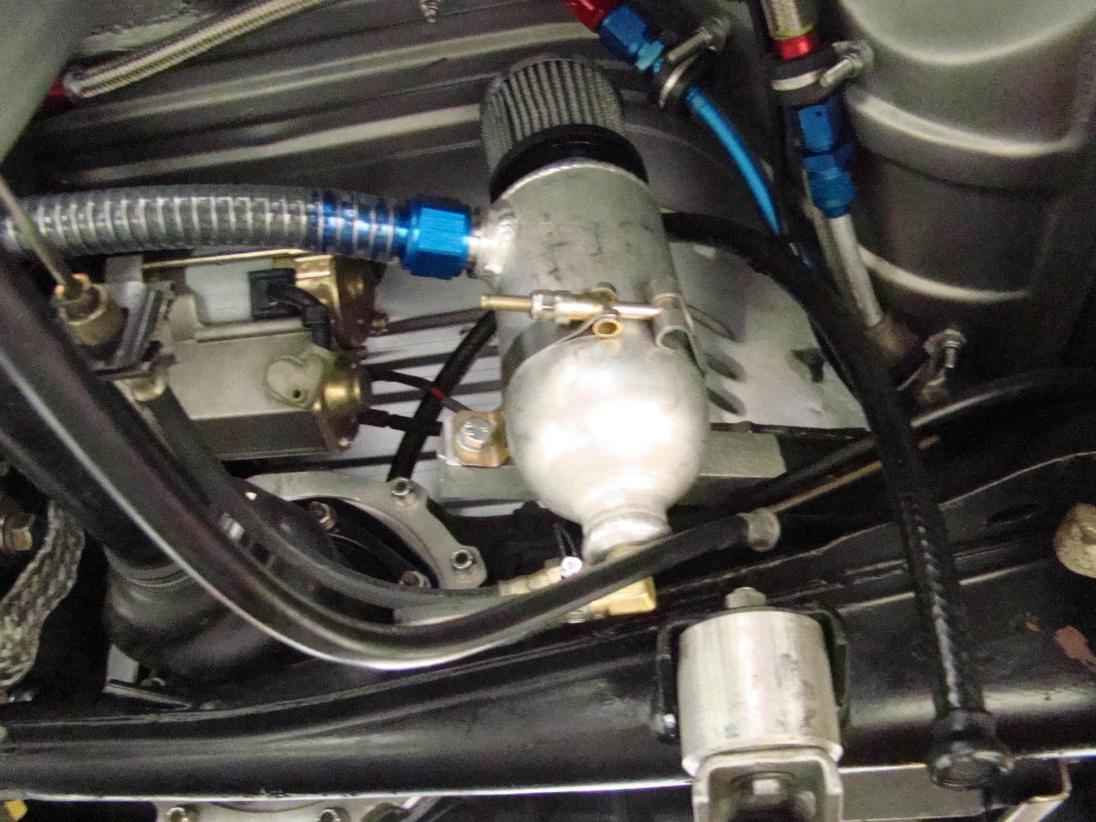

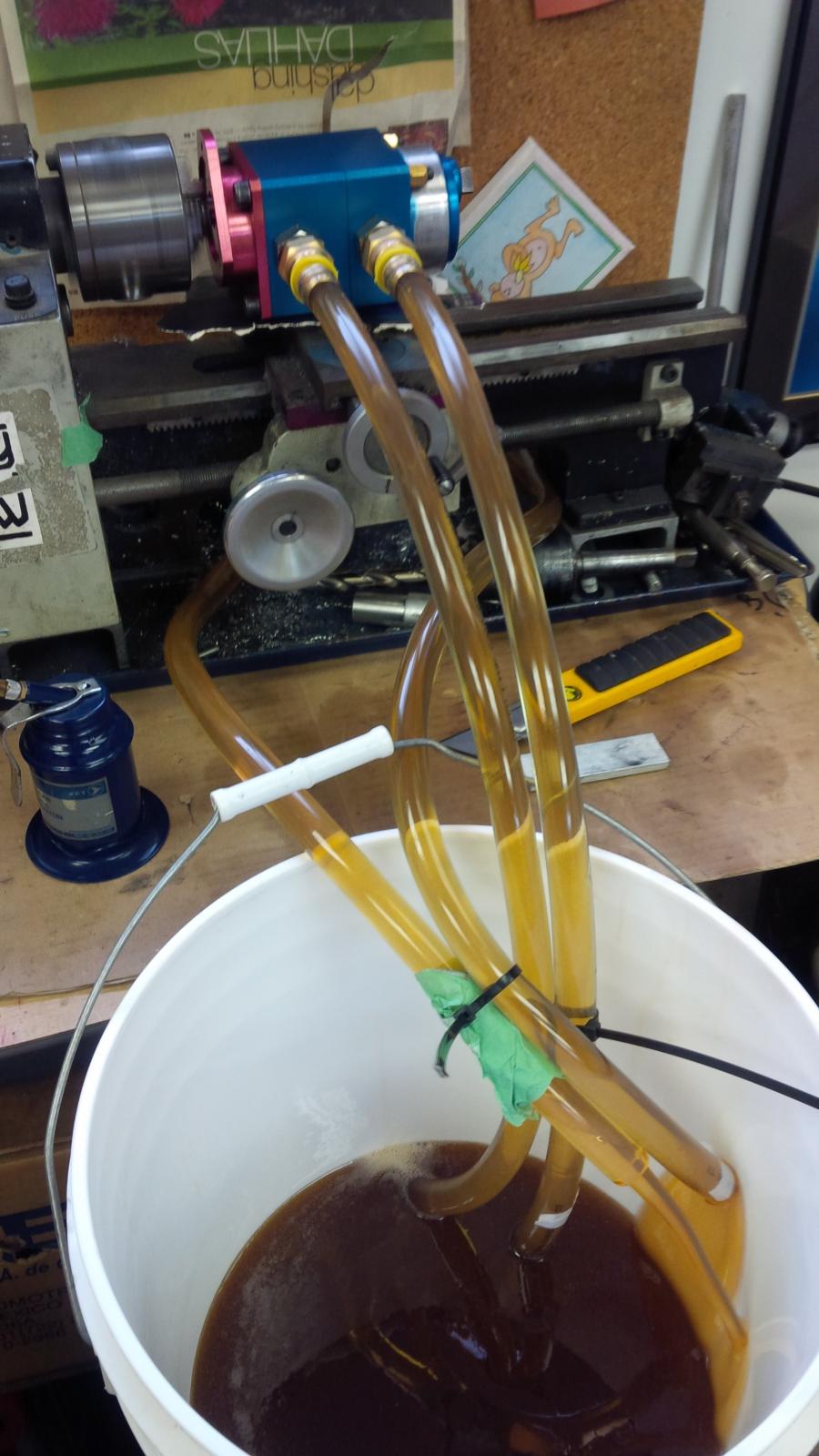

2 things need to happen . First find a pump and second find or make a tank .
I also needed a pump that has a fuel pump drive on it .
Ok these are rare now as old school mechanical drive fuel pumps are not used to much anymore .
   I was looking for a Auto-Craft 2 stage pump with drive ,took some time but finally lucked out and found a brand new one from Roger Crawford .!!!!
wow that was like hitting the jackpot .N.O.S.
mounted it on my old mini lathe and broke in the pump for about 1 hour .that sucker moves oil !!!
   It was original very hard to turn , tight ! excellent ,and did loosen up after run in time .wanted to get any debris out of pump.
I did premeasure and had room for the extended length of the pump as well was lucky the drive cleared as well, just needed to
change direction of my hilborn MFI pump and add some new mounting holes .
oil lines well a issue
« Last Edit: January 12, 2020, 10:46:34 AM by jim martin »
Offline jim martin
  • Posts: 1406
Re: Jim Martin
« Reply #336 on: January 12, 2020, 05:20:32 PM »
  Pump , check.

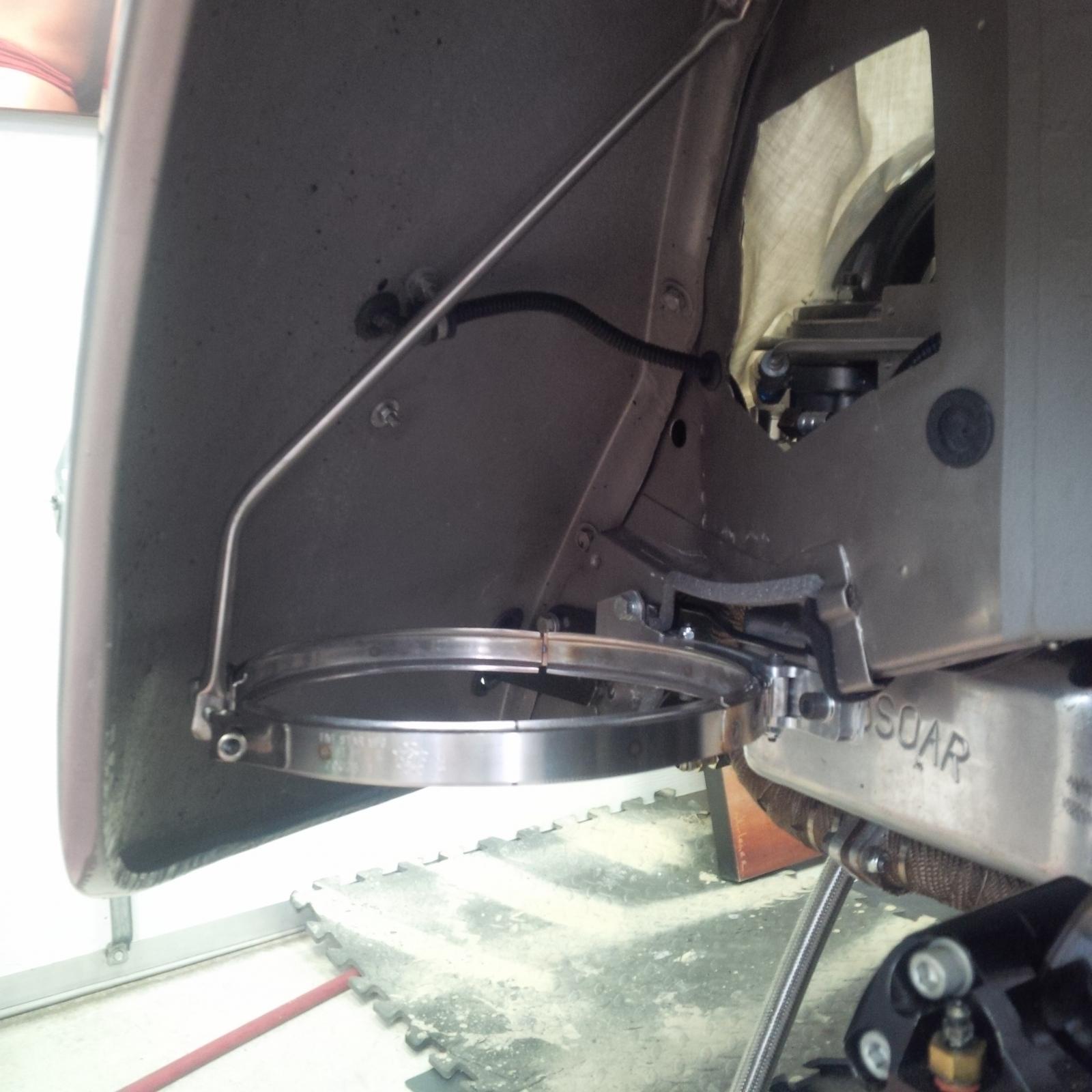

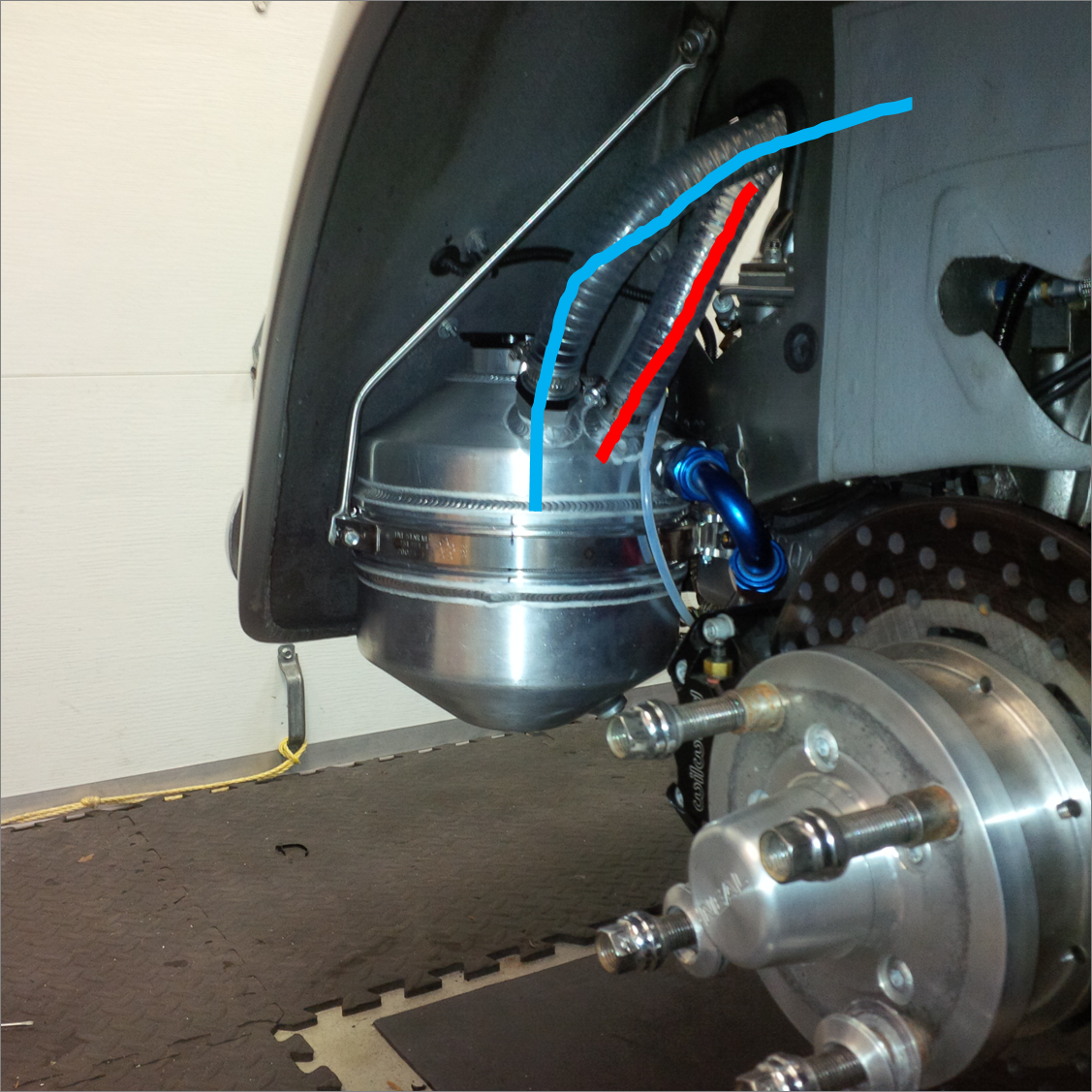

now that I had it in my hands it was time for the tank .

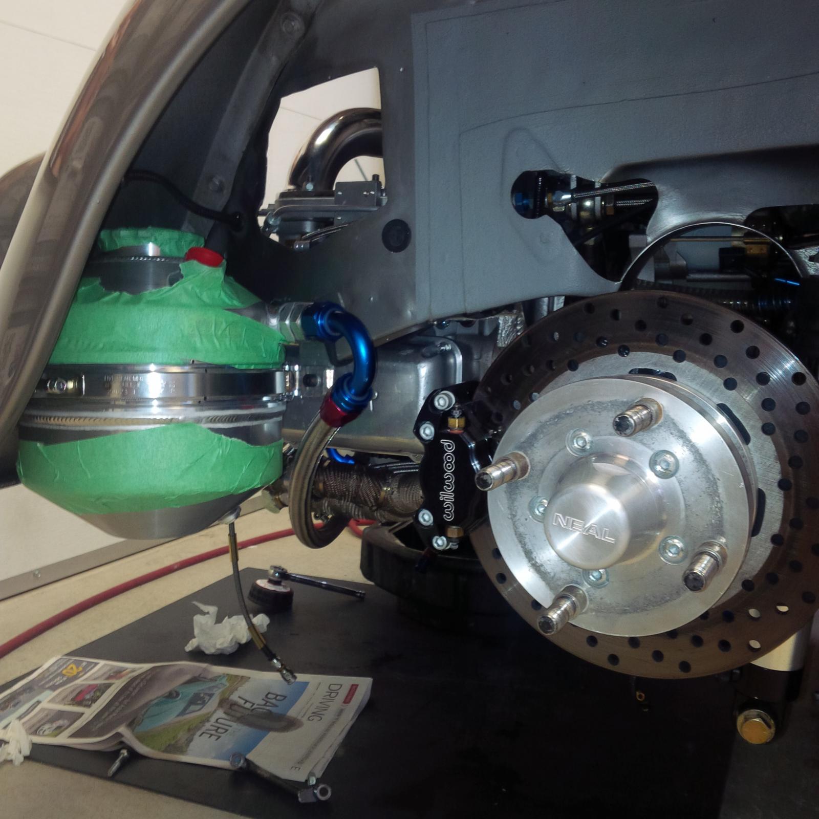

I managed to find a small dragster tank from Peterson fluids .
after a phone call I received the PDF of the tank and made a cardboard mock up .
well looks like it might fit ,its tight but with a bit of thinking should work out.
  ordered tank with heater and got my fitting installed ,also made a poor boys site glass from some teflon tube ,works very well for watching the oil level
mounting brackets installed
and tank in no problem
  Space was very tight and I used a combo of special AN fittings , since AN-!2 line is not the most flexible it take a bit more outa the box thinking.
But it all worked out .
  now since this photos the tank again has been modified with some additional fittings .
bungs for additional temp sensors ,better location for site glass tube ,magnet holder and most important inlet from vacuum pump - oil in and out are
an-12 , breathers are an-16 ,oil pump prelude an-8
now that I don't have this massive 4" deep sump hanging from the bottom of the engine I also got from Roger a brand new
Auto-craft drysump pick up ,found this pic on the net .
uses a AN-10 to the suction side of the 2 stage pump
out of the pump same setup AN-8 oil lines .
I was asked why dry sump ?well its real cool ,na more than that , like I had mentioned im all about crankcase pressure/blowby control .
over the years I have blown my share of oil onto the track surface and finally never wanted to be that guy again .
    pretty easy .no oil in the motor , no oil to leak as well as less crankcase pressure as you just free'd up space in the motor that
was taken up by engine oil and never have to worry about a consistant oil supply under the hardest acceleration .
no brainer.
also combine it with a vacuum pump and its unmatchable .this combo is with out a doubt the best thing I have done .

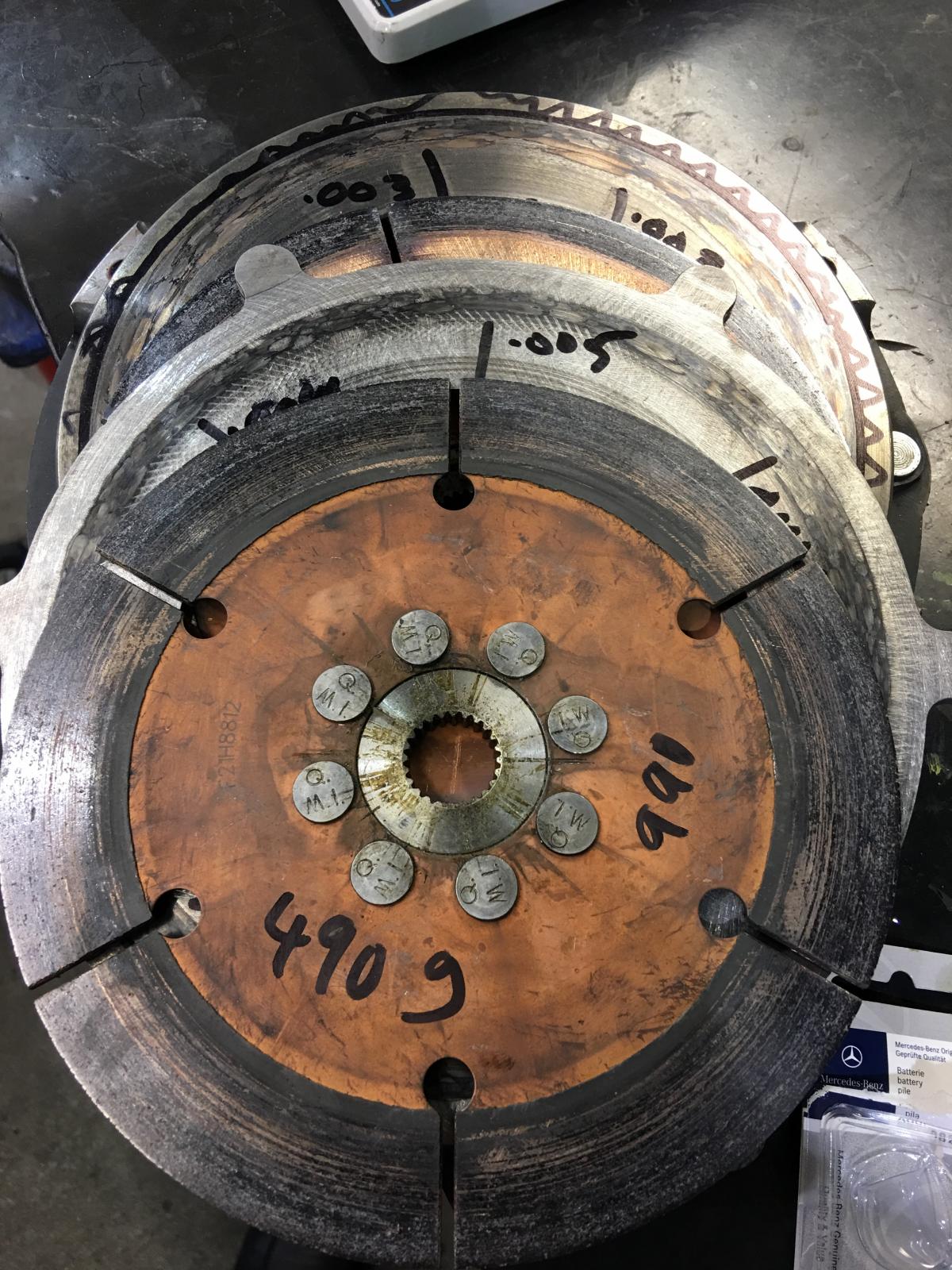

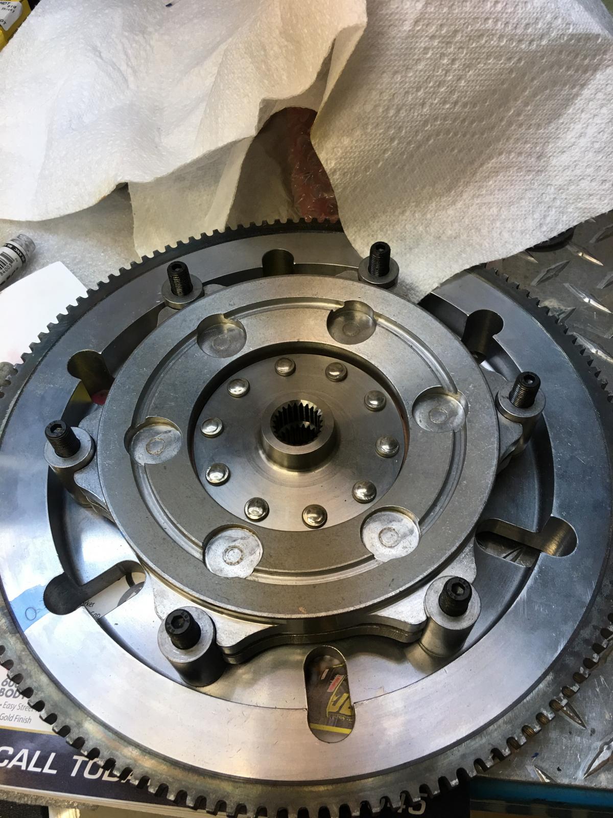

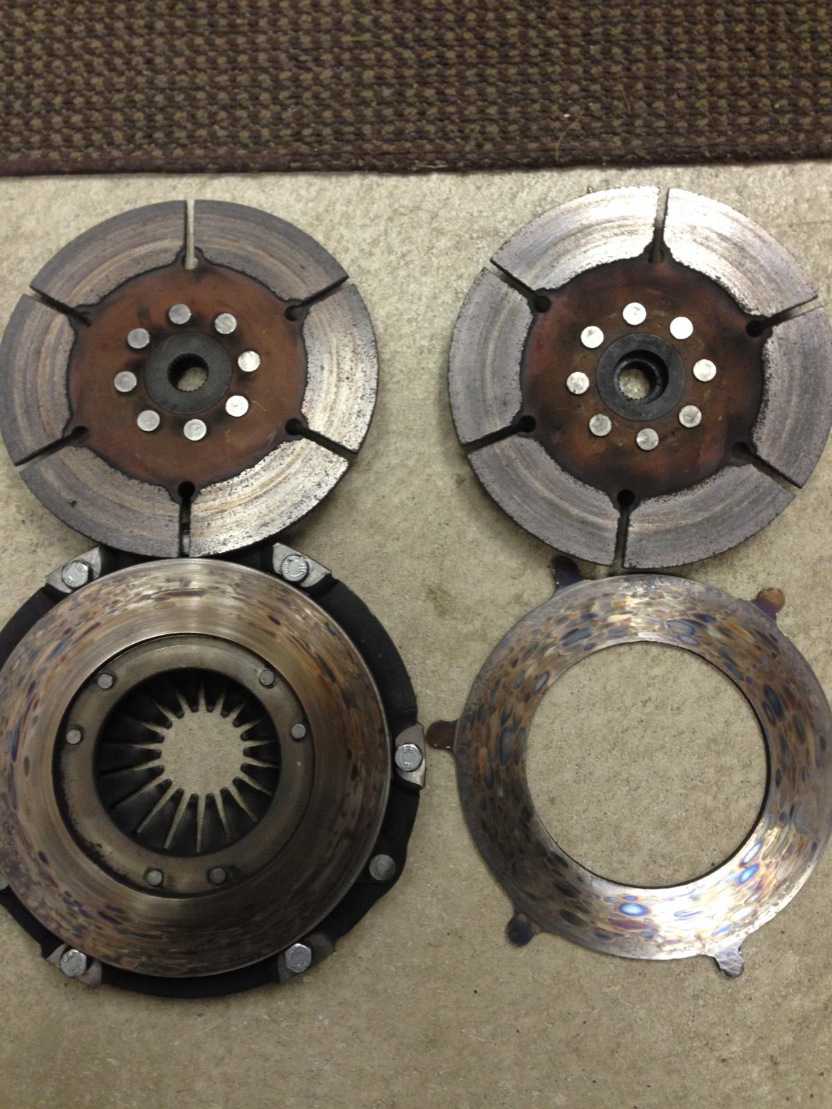

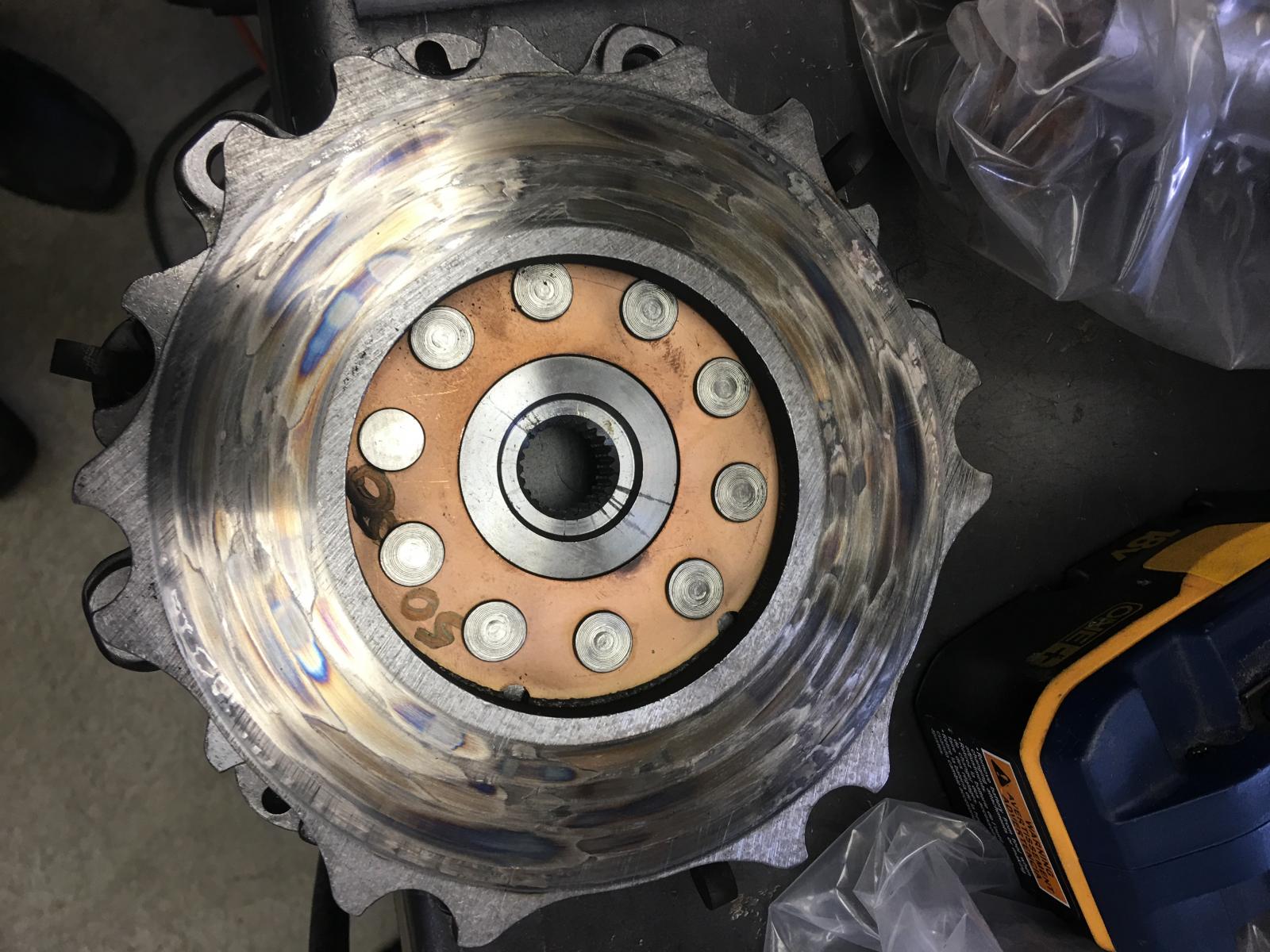

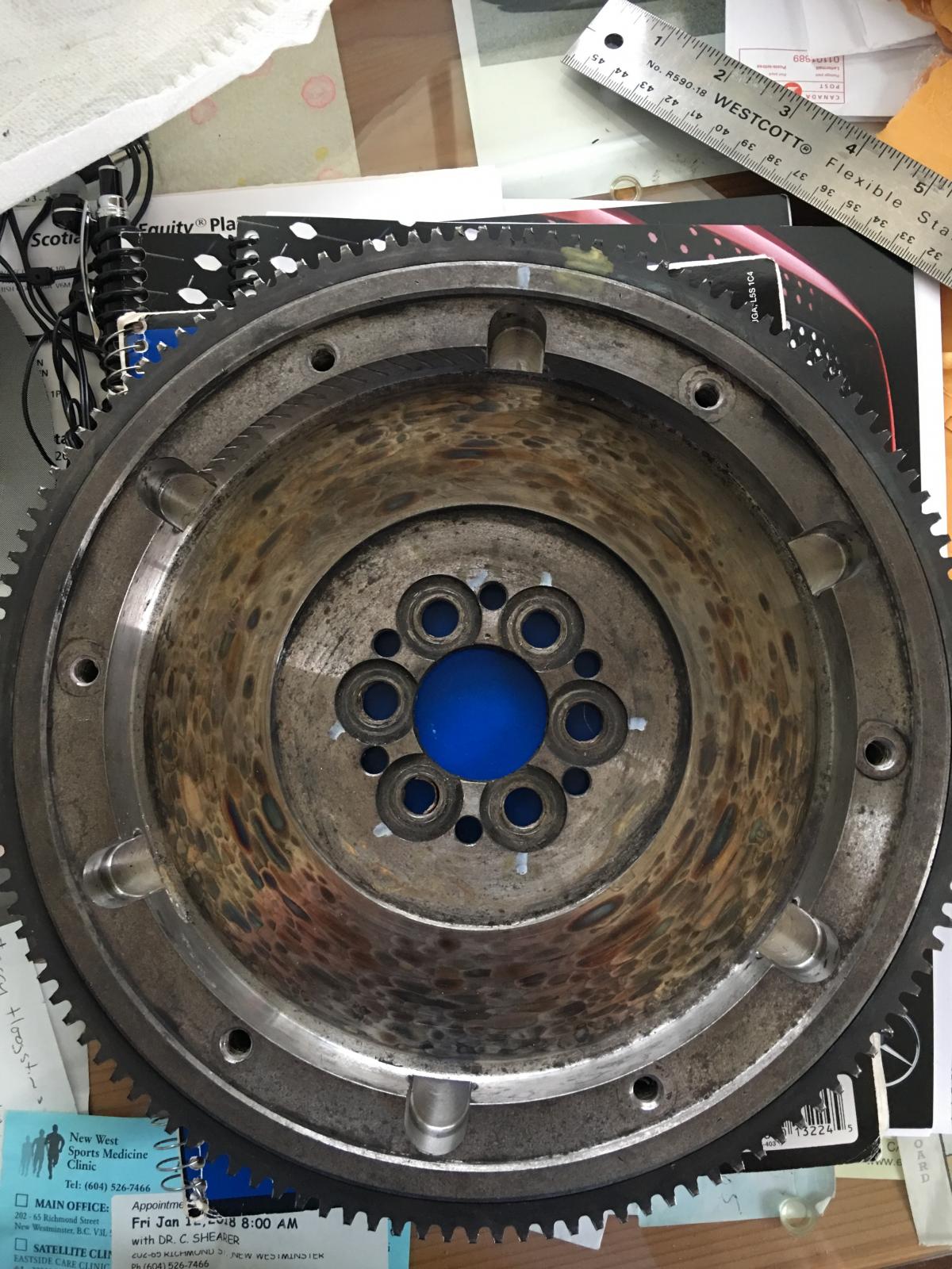

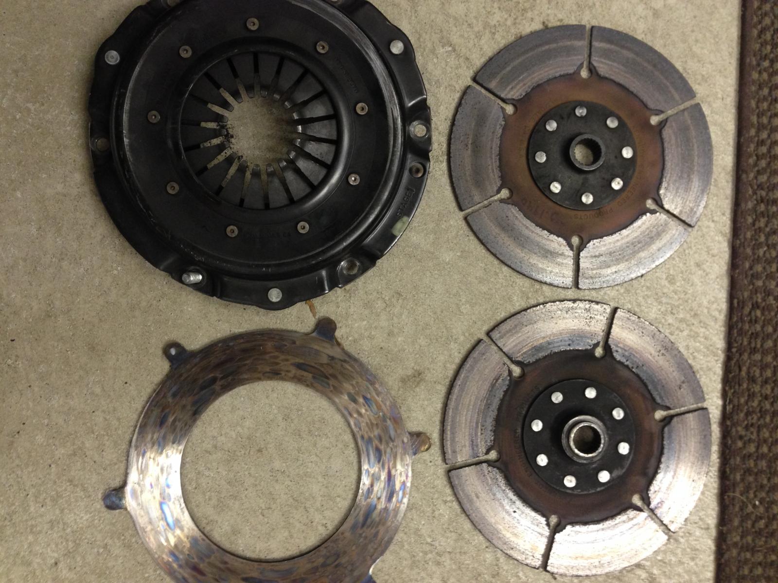

   This is the first Dual clutch i used , ya did not survive , and did not like to slip and was very noisy
Its a Tilton dual disc setup and you can see in this picture ( from flywheel looking up to pressure plate )
the amount of warp and areas of no contact , would i recommend this clutch , Yes but not for a slipping application but maybe a on/off race application , not slip and drag  .
the weight of both tilton discs is less than most single discs , so shift speed can be very fast , due to the syncros ability to slow or accelerate the discs quickly between shifts .
Offline jim martin
  • Posts: 1406
Re: Jim Martin
« Reply #340 on: January 14, 2020, 03:18:43 PM »

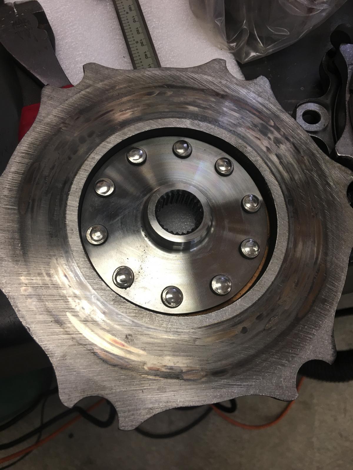

  Now here is a absolute work horse of a dual clutch !!!
this is the Kennedy dual disc clutch , plus used only a stage#1 pressure plate , yep who says you need a stage #2 all the time .
its all about matching components and adjusting clamping pressures , if i remember i shimmed the pressure plate with 0.030" washers
to gain another few lbs face pressure . smooth as butter , easy pedal pressure and holds like a vise grip when needed . if i was going to use it again
only and only because i was upping potential motor output i would of replaced the pressure plate with a stage #2 .
i have put 100's of passes on this clutch , 100's of hard launches and quite a few street miles on it .
from the flywheel looking up to pressure plate .
and from the pressure plate looking down to the flywheel

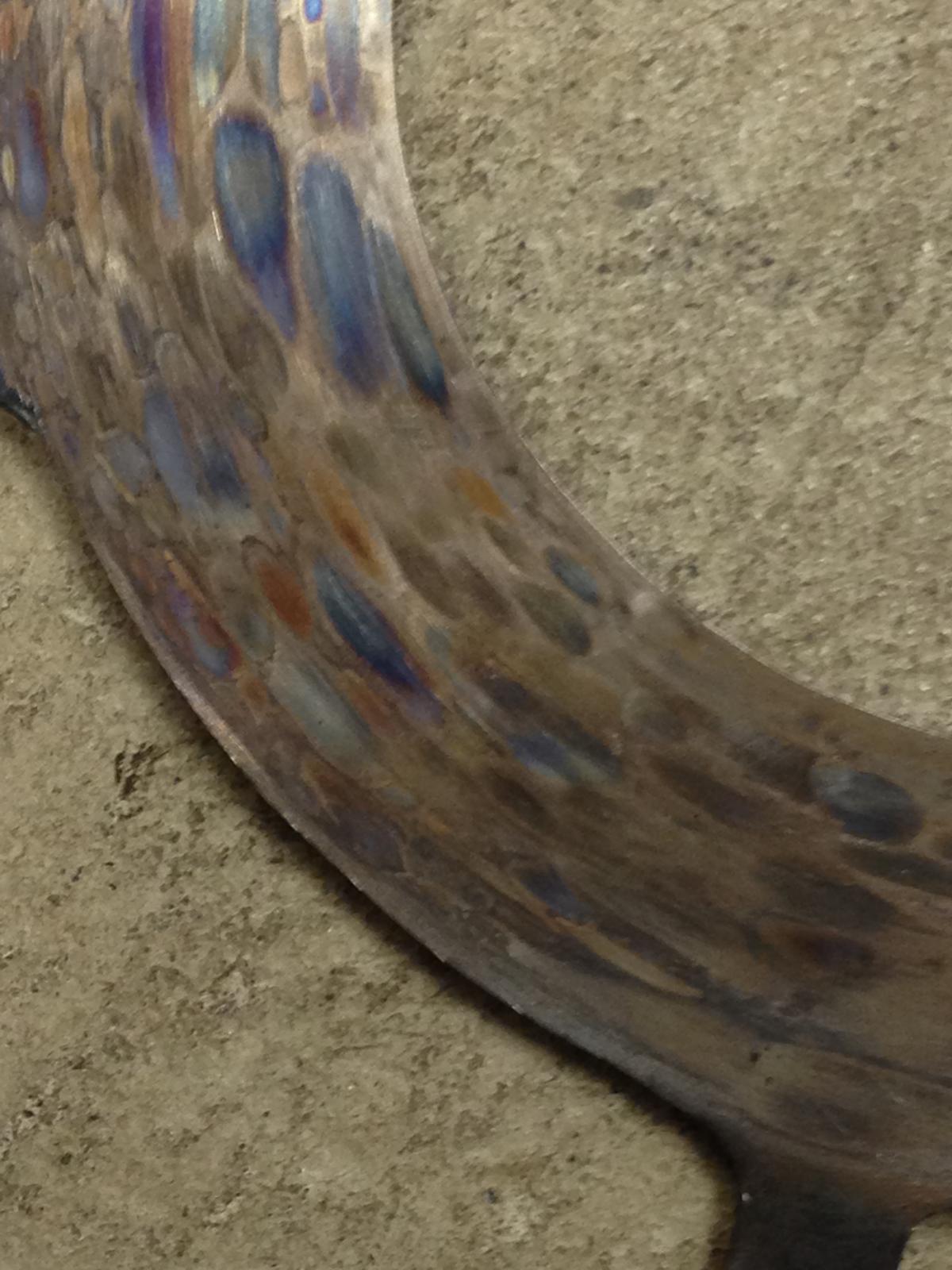

check out the floater still flat , nice colors but you can see the slip marks .
these are not a issue and even thoe the motors been in and out and apart multyple times i never touched the clutch at all .
if its flat dont mess with it !!! if its holding dont mess with it !!!
the notches machined into the flywheel are to support and lock the floater plate between the discs .
again still flat and lots slip heat check markes , also this is a 6 bolt , 6 dowel flandged flywheel .

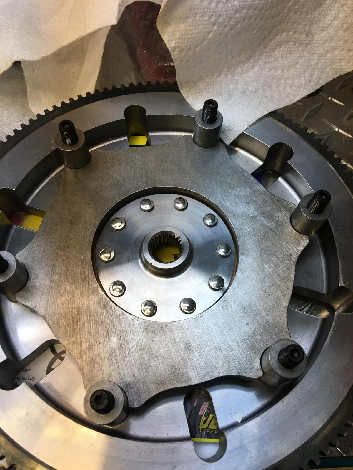

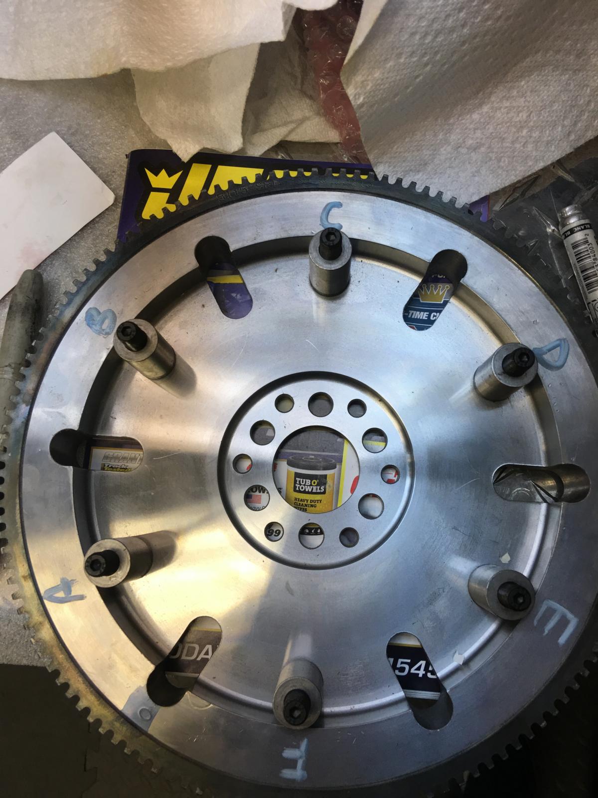

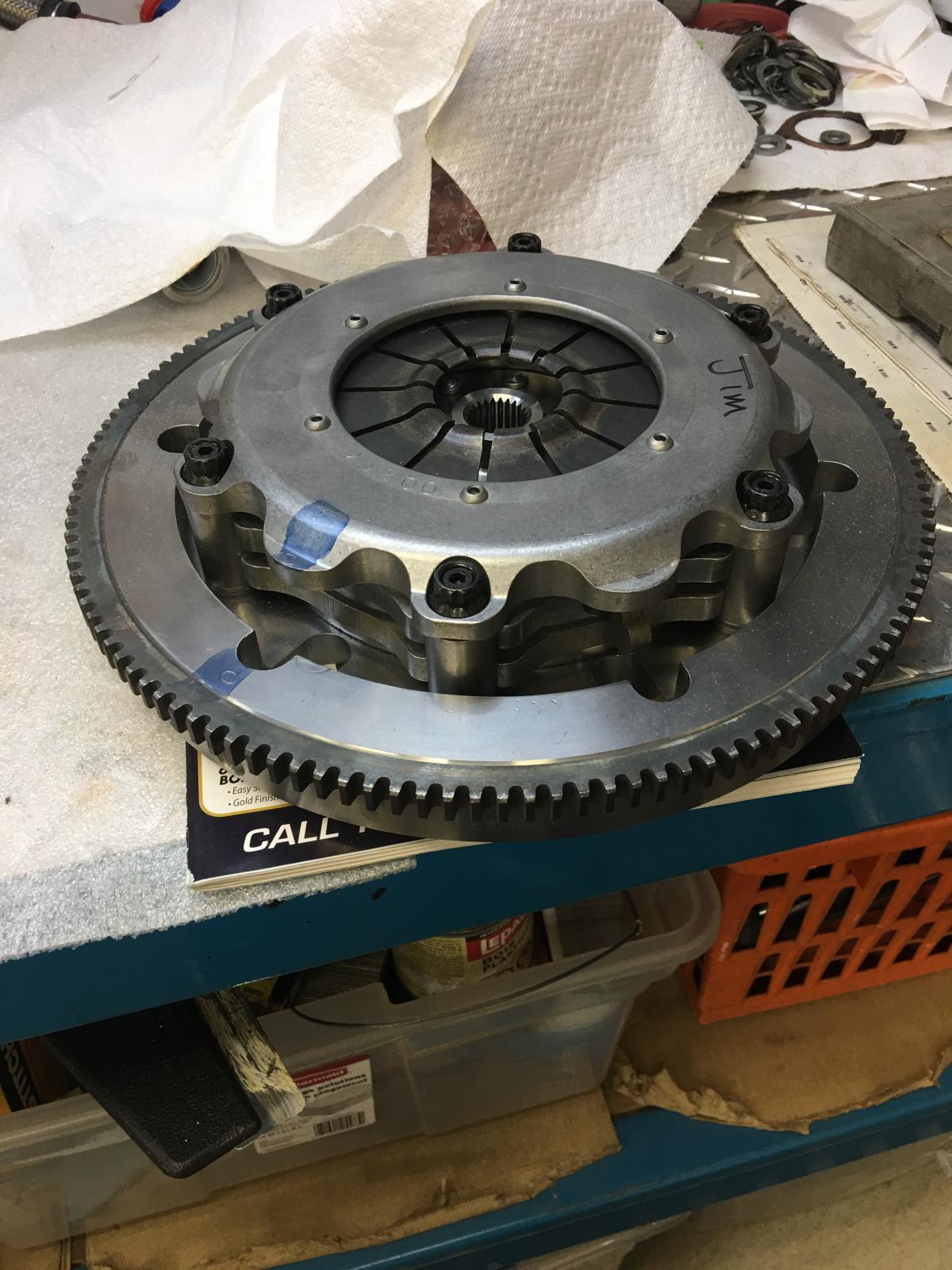

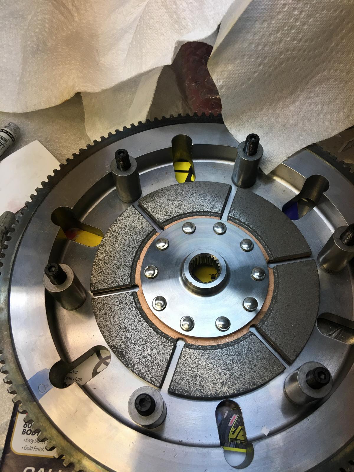

LETS TAKE A LOOK , as arrived and after track/street abuse .

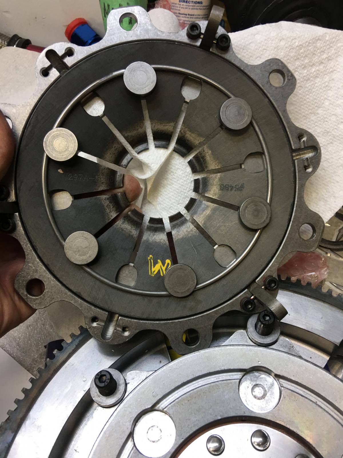

above picture is as arrived , now pulling it apart to inspect
   12 point arp nuts removed and pulled the clutch cover off, this is what holds 1 of the 3 available pressure plate springs , mines a Medium.
mine has 3 centrifugal weights
pressure plate , this is what the pressure plate spring pushes against on 1 side and the other against the top disc  , basically a special top floater
its held from rotating by the 6 indexing lugs in the pressure plate spring

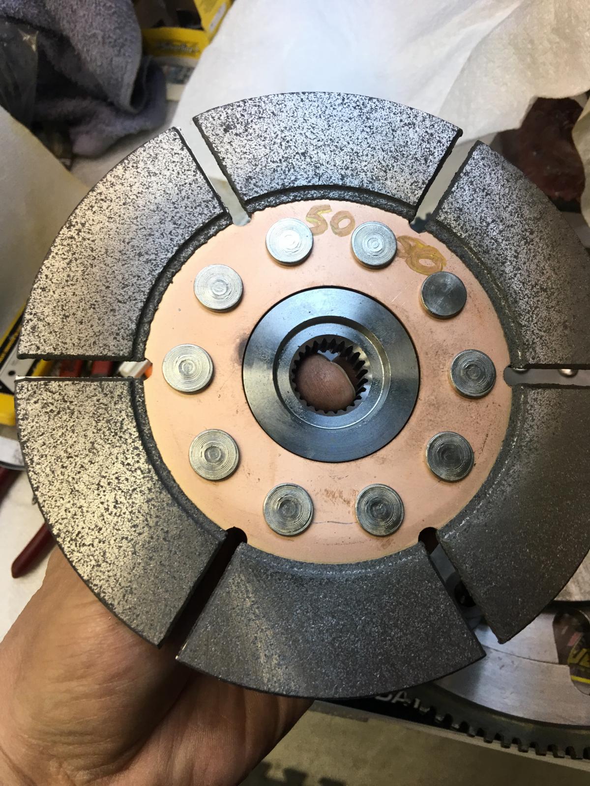

top disc is a 50/50 combo . half aggressive and half slippy
under the top disc is the centre floater ,held from spinning by the 6 aluminum posts
bottom disc , see how small that unit is compared to a standard  almost 8" vw clutch disc
my bottom disc is a aggressive
and finally my 6 bolt , 6 at  8mm dowel flywheel , not lightened and weighs the same as a standard vw flywheel
also now you can see the 6 aluminum post very well and the shimming washers to set pull down height are bellow those , i had 13 shims at 10 thou each

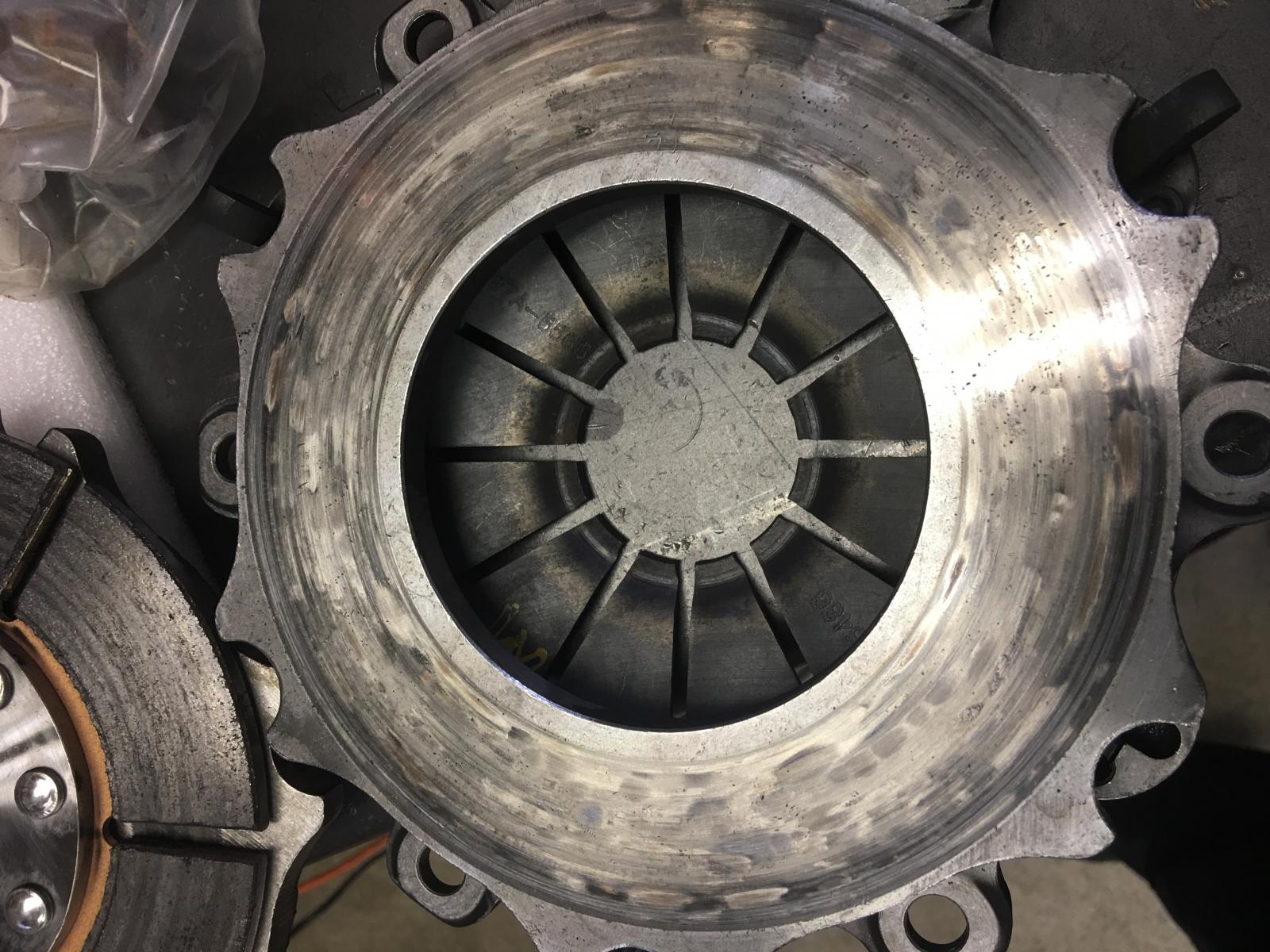

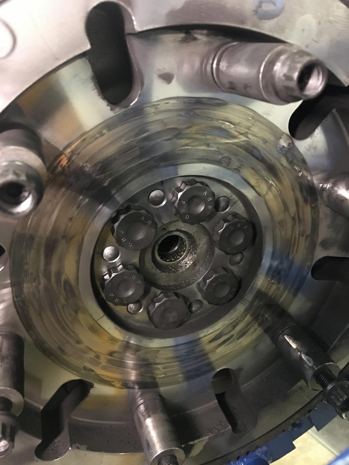

  Flywheel , you can see the shims under the aluminum stands , lots of clutch dust in the slots and lots of heat slip check marks .
shows the clutch is working hard and there is some slip ,and good contact
  backside of the  floater , again good contact .,slip and check marks, sucker is taking heat .
between the flywheel and the backside of first floater is the aggressive disc .
top side of floater , big difference this is where the 50/50 disc is sandwiched ,wow big difference ,longer slip marks as well
backside of pressure plate , again long slip marks but less heat generated
  Very interesting to see the difference between the 2 disc and the contact surfaces . the thing works !

But until i test final version with a few more bells and whistles it'll have to wait but, will get info up soon with data and video of both with and without controller.
   but does it work , Yep here is the proof
this is the 3rd pass testing at mission with the ECMS set-up with REV 6 clutch , night-stick select ,16 psi in tires , 14-15 lbs boost
 1.404_ 60'

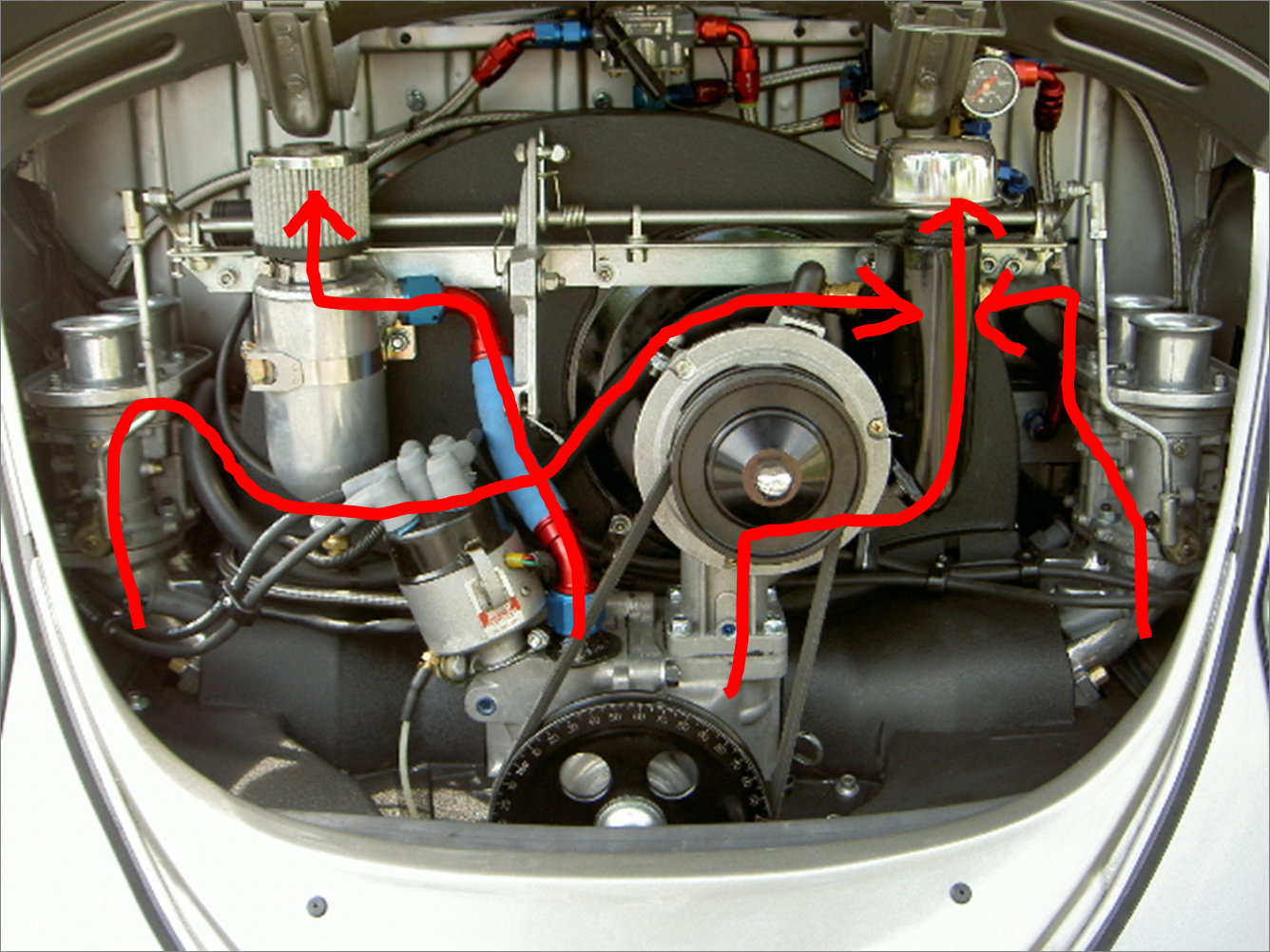

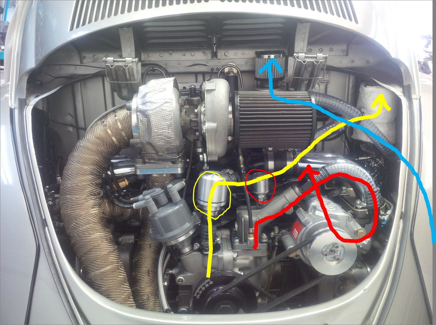

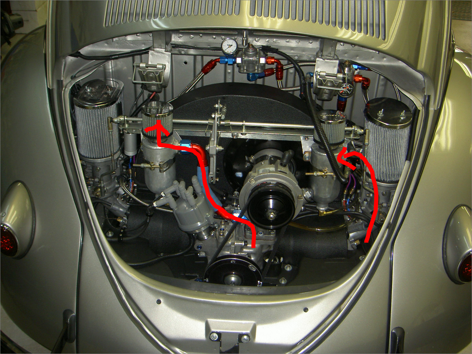

      here is the typical or close to typical set-up .#1
cheapo breather box and vent lines from both valve covers ,fuel pump port as well as a small k@n on the generator stand .
does it work ? yes and no .
  What did i learn from this ,oil will take the path of least resistance .and more vents is not always better.
This is where i really started to learn about crankcase breathing issues and actually making it worse .
!! using too small I.D lines is a big no no .more vents don't mean success.
  oil would push up the valve cover hoses and fuel pump port and i see now i have one more line which is a
oil drain from the vent box to the alternator stand ,you can see that fitting bellow the k@n on the alt stand .
and overflow it . basically the system caused hi and low pressure spots causing oil to move and push everywhere ,BAD

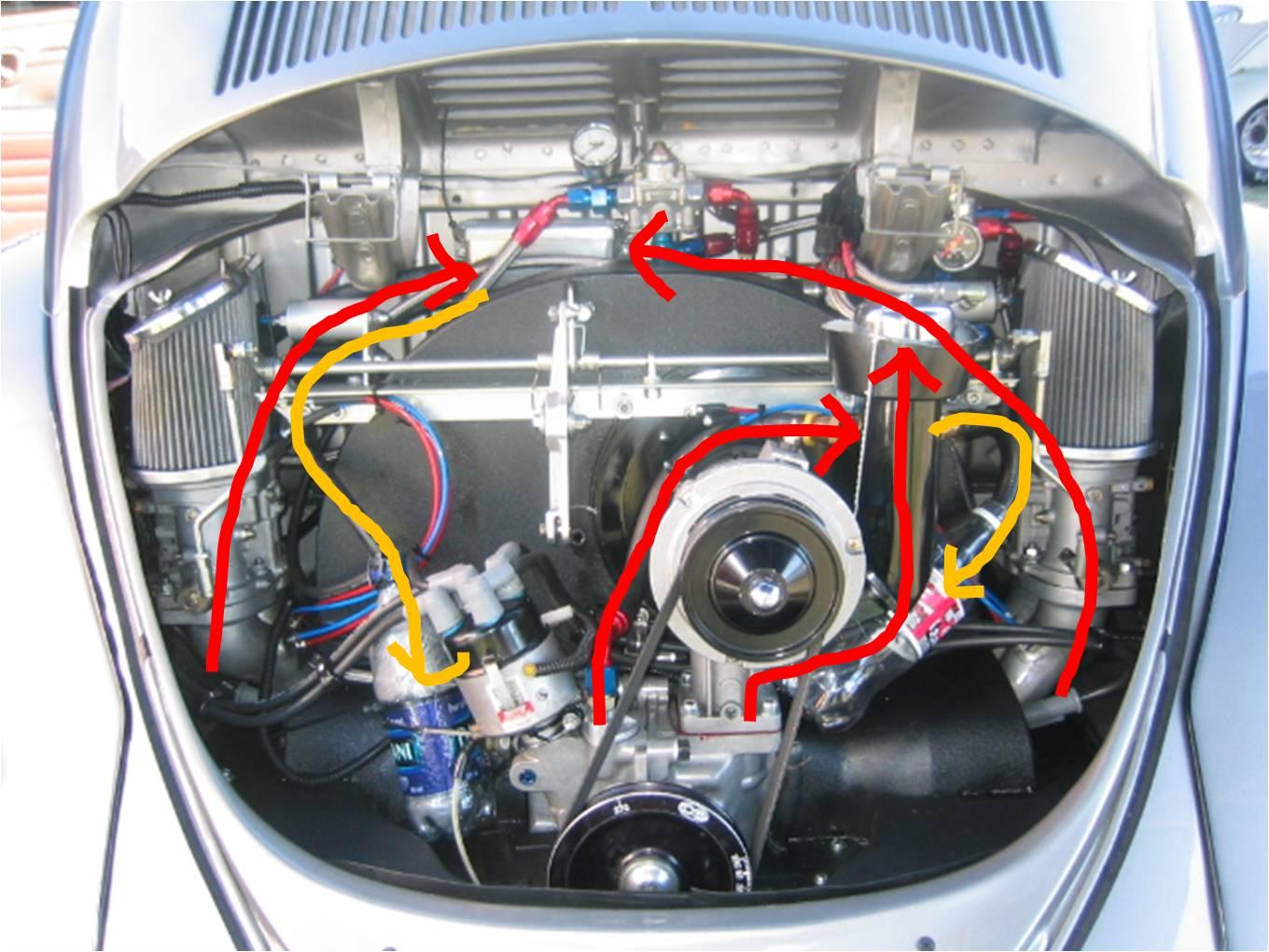

  Progression time #2
  Looks like i decided to separate the oil from the crankcase pressure and added a Berg breather system .
still venting valve covers but this time eliminated the fuel pump inlet to the breather box and put the drain tube from
the breather box into a water bottle .
 the Berg breather has 2 ports which are to be used for valve cover vents but looks like a used one for the fuel pump port and the other into a bottle .
Why into clear bottles ? that was to measure the amount of oil that was being moved .

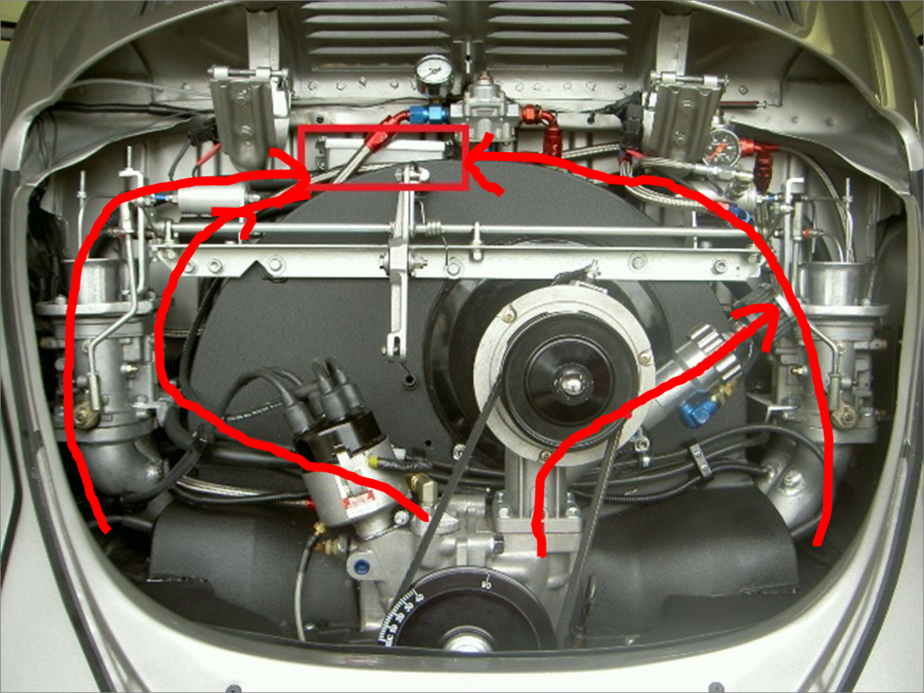

progression#3
  looks like im finally learning something ,but not that smart yet
Crankcase venting is the KEY so dedicated AN-12 vent to a dedicated breather tank ,used the Berg system still to vent the valve covers and i installed a restriction
on the alternator stand to Berg breather so basically 90% of the crankcase pressure goes through the fuel pump port leaving the Berg unit to vent the valve covers  .
but still moving oil ? why .not quite there yet
progression #4
   I did so much testing between every system i cant even begin to tell you .i was still amazed at how much oil would move up and through the fuel pump port .i had

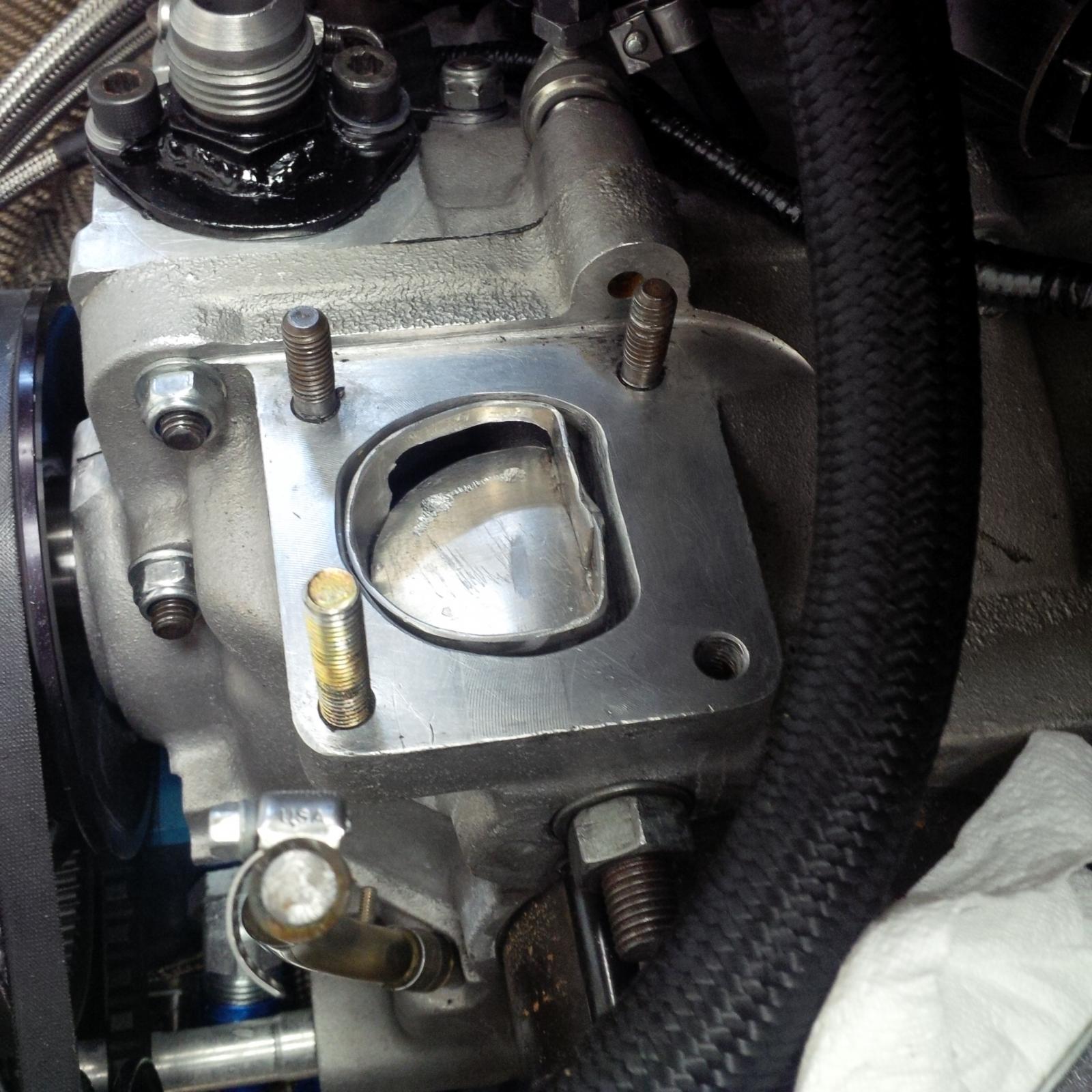

installed a long clear hose onto the port and ran the motor ,bingo !! at like 3500 rpm oil would just fill and flow up the clear line .made no sense at the time but eventually figure it out .
  Now i was learning about oil movement ,  without the fuel pump guide plate installed in the engine case , that port ends up getting flung with full oil coming whipping off the crank/cam gear. So add high air movement up the tube and bingo major issue .so looks like i finally figure it out .take the venting crankcase fumes from the other side of the cam gear and hey looks like VW figured that out with a oil deflector plate and internal webbing .ditched the Berg breather and plugged the oil filler port as well as added another vent off the #1@2 valve cover only .
 the #3@4 fills with oil very quickly from oil flung from rotating crankshaft , so i added drains from the bottom of both heads to my oil sump to help .
did this system work . yes if i remember it did but was not exactly what i wanted .much more testing ,baffling,testing lines and positions and i had it beat .
now i dont have a photo but i had connected 1" hose only to the alternator stand outlet and into a large container .bottom line was the larger line allowed the crankcase fumes to slow down and allowed the oil to drop out of suspension HMMMM no we have it
  SO what to do and not do , thats next

So what and what not to do ,this is what i recommend .
#1~ ring seal ring seal ring seal - get the cylinders round .
#2 ~vent only from the alternator stand with a min 1" hose with a large box mounted as high as possible.
#3~ run a vacuum pump ,will always run one to many advantages not to run one.
not looking for a pissing match and yes i know there are many ways but this is what i know works without issue.
  FYI: i have run my car with and without a vacuum pump .also i log crankcase vacuum/pressure ,and yes there is no crankcase
pressure when run without the vacuum pump , why good ring seal and the case is well ported ,has no oil in it and most important
is able to breathe freely without restriction .
  SO why change it if it works so good , well because you can always make things better . i started experimenting with elimination of breathers
and only running a vacuum pump ,and yes i had issues but instantly fixed my major issues .
  my biggest issues were blowing oil on decel , oil leaks and overflowing breather tanks .

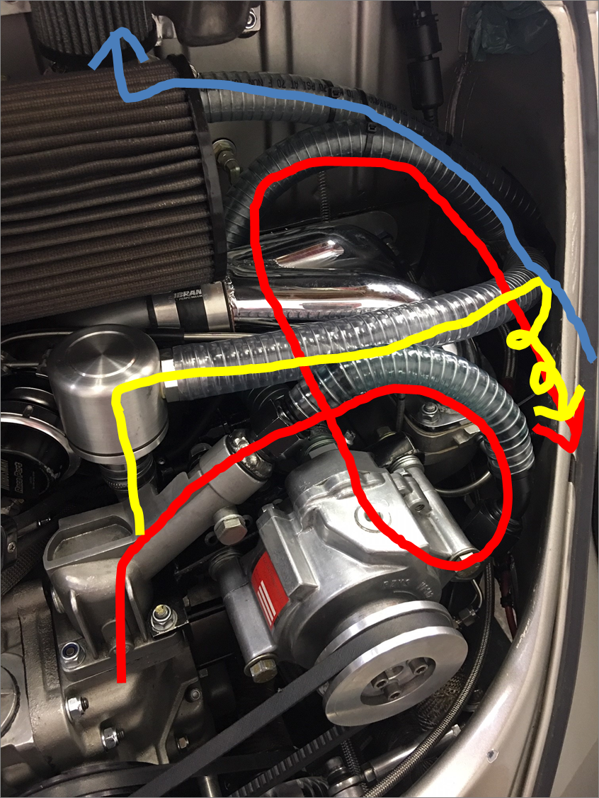

focus here on the oil separation tank . this is what was talking about and added to the above nitrous engine .
red line out from engine and to bottom of tank ,yellow line out from tank and into vacuum pump and blue outa vacuum pump and into breather tank.

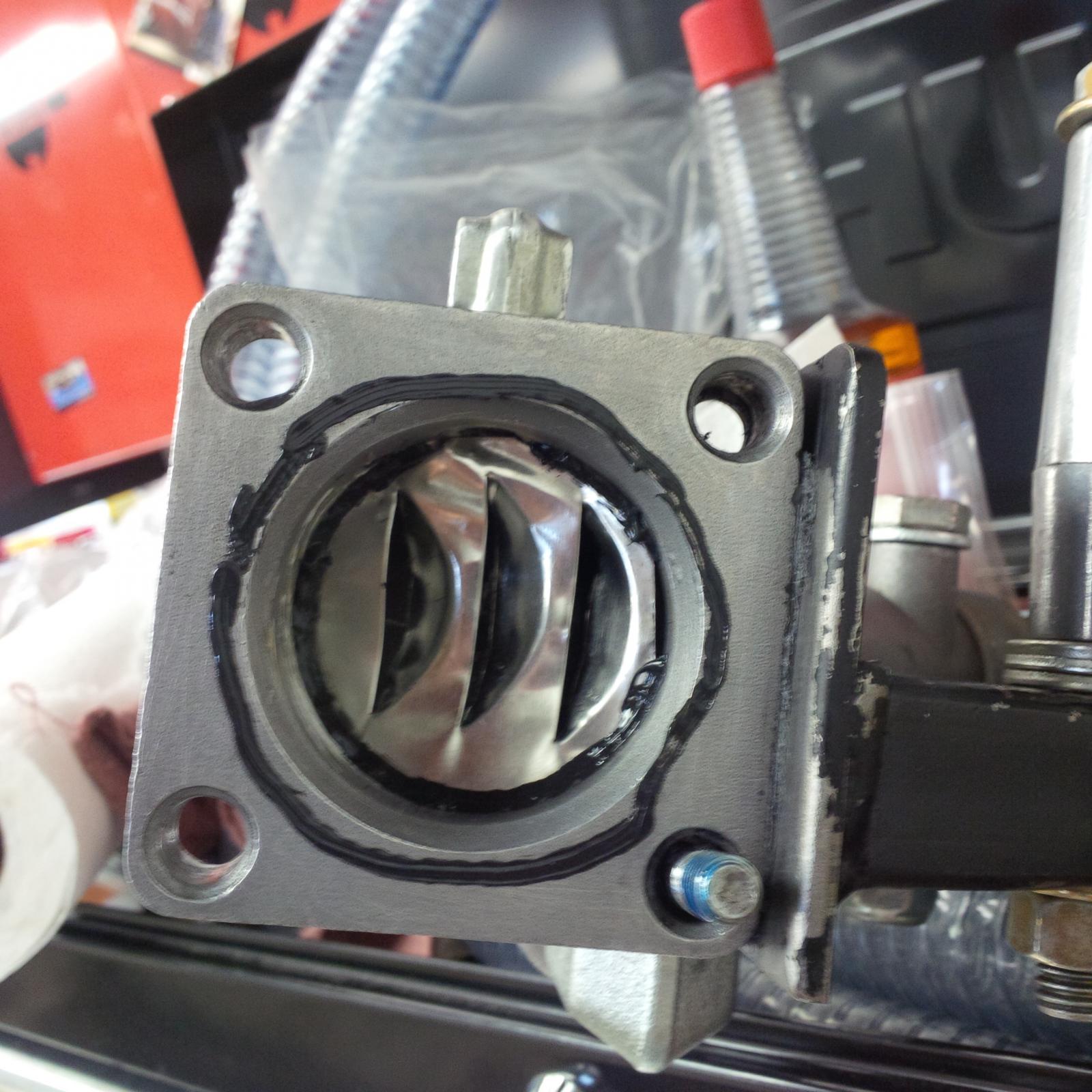

 double vw baffle in the alt stand
and a additional oil deflector in the case
  This help allot so what have i learned .

 So what next , Easy dont want to move oil in the system .DRY SUMP IT .
now that was covered a bit earlier but know i was able to get rid of the 4" sump below the engine and gain some clearance
as well as get rid of close to 6 litres of oil in the motor , that frees up case internal volume ,with the addition of the DRY sump system i was seeing light at the end of the tunnel .

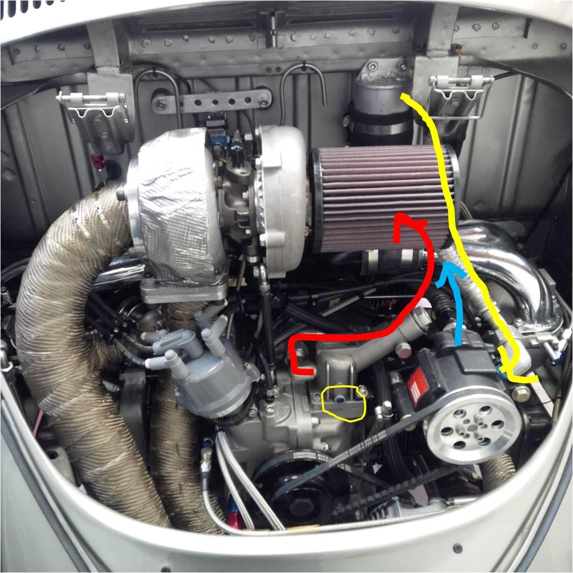

      OK , Dry-Sump tank is in ,time for the ultimate set-up .now that i can see the light at the end of the crankcase/oil combo tunnel !!!
  I did ended up running 3 set-ups, each 1 progressing after the next due to a small issue ,lets look .
  First step was to modify the Dry-Sump tank,
With the tank out a vacuum inlet pipe (RED line) was added to mirror the existing AN-12 line oil inlet pipe  (blue fitting).
  The air inlet is 1" ID of course and twins the oil inlet from the scavenge section of the Dry-Sump pump.
This works great as the oil entering the tank and the crankcase fumes and oil mist from the vacuum pump mix and swirl in the top of the tank together in the same direction .
  Tank breathing  ( blue line ) goes and up to my repositioned remote breather tank .
   From the breather tank i have a small clear 3/8 line that runs down and connects to a petcock ahead of the right rear wheel so i can drain off anything collected in the breather tank and monitor both oil or methanol collection .
  Some info - all my breather lines are 1" I.D!! As well as fittings are modified AN-16 fittings with the I.D bored out to min 1" I.D.
- all lines run uphill when needed to promote oil separation as well as downhill as needed to not allow oil or methanol to puddle !!
you can see the big advantage now , i completely separate and remove all the methanol raw or fumes from my oil leaving it in clean condition !! Nice no oil milking.
 -Does the Dry-Sump tank with Vacuum pump setup work YES i was pleased as hell , well almost all issues solved ,but I’m never really that happy as it can always be better .
FYI: my Dry-Sump tank incorporates these standard items - oil inlet and outlet- tank breather outlet 1500w tank oil heater.
- MY added items are: oil level site tube, 1" I.D vacuum pump inlet, AN-8 oil pre-lube pump outlet, cow magnet holder, modified oil drain outlet, oil temp bung.

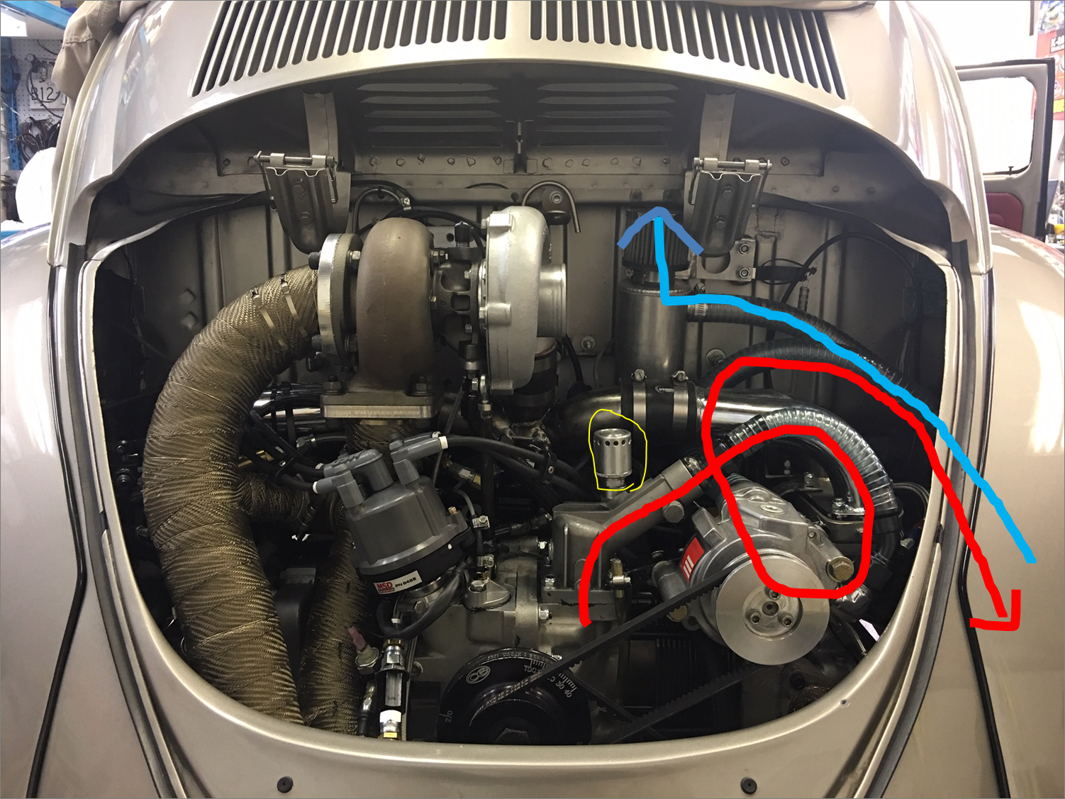

 - First setup went like this, Vacuum pump to Dry-Sump tank, Dry sump tank venting to remote breather, regulated with a GZ vacuum regulator valve.
Super basic (nice pulley Cameron!) and yes it worked very well, But i started having engine oil spitting out of the
Crankcase vacuum regulator valve (circle in yellow)
   - Time for data review, what i found was under high boost i would actually start losing crankcase vacuum and start going into positive pressure.
Oh know what to do.?

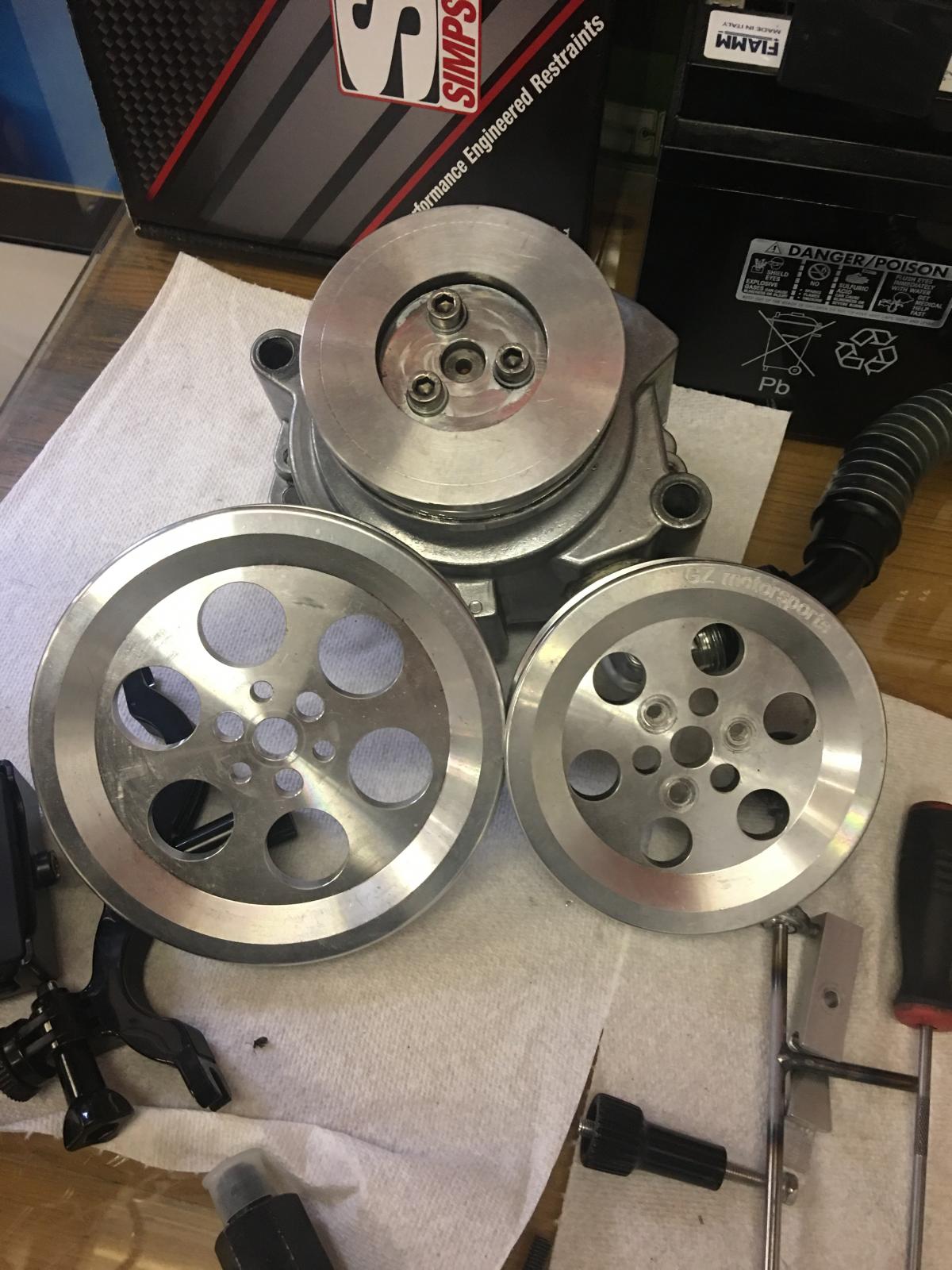

Step#1, change pulley sizes to start:
  You will probably notice there has been different pulley‘s in past photos, so it kind of goes like this, I started by switching to a higher volume GZ vacuum pump .which means it has the ability to pulley more volume sooner as well as longer .
Now the good Guys at GZ motorsports, super great to deal with. recommend a max pump RPM of  say 6000 rpm  but can spin higher for short times if needed.
So my CE lower pulley has a diameter of 3.25" so this is how it looks
3.25 with 5.5" pump pulley at 6500 rpm =3850 rpm
3.25 with 4.5" pump pulley at 6500 rpm =4700 rpm
So you can see i was not at the time getting anywhere close to the 6000 pump RPM .and max pump pull.
  Yep Cameron to the rescue and machined me a sweet 3.5" custom pulley .
3.25 with 3.5" pump pulley at 6500 rpm =6035 rpm
This made a massive change, spinning the GZ pump faster at engine idle around 900 rpm  would pull about 10 inches and in 4th gear ,6500 rpm , 16 lbs boost still be around 5 inches crankcase vacuum .

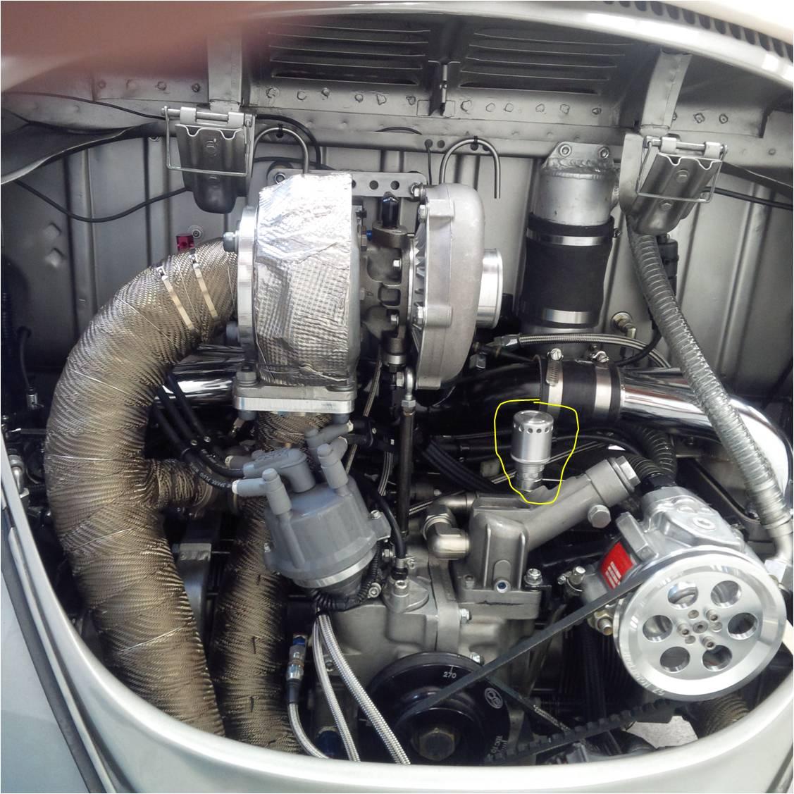

Version#2 – exactly the same as version#1  , Except  with the addition of a GZ motorsports crankcase pressure blow-off valve. Now this unit was originally designed to be used as a backup for engine failure, meaning say on a boosted motor you blow a piston you could then potentially pressurize the crankcase and in turn that would push all your engine oil up and out your valve cover breather, so this unit will hold 2 psi and if the pressure passes 2 psi opens and dumps into a tank with the min capacity of your engine total oil quantity, smart and nhra required in some classes .
  I purchased the Blow off valve and modified the spring to allow it to pop off the seat a hair over ½ psi and plumbed that to a larger 3 quart tank tucked up in the right side of the engine bay.
Now if at any time my motor see’s positive pressure the blow off valve will open releasing the pressure, into the tank .just have to test it.
Bingo at the Track and after every pass I would check my data ,there was ZERO positive crankcase pressure shown -- ,problem fixed and worked like a charm , time for the last and final modification .
Version #3 – what did I learn – no need for the vacuum control valve , the engine and vacuum system work perfect together so in the end the valve was only really controlling idle and light partial load so gone . Removed  the Blow off valve from the not best spot  fuel pump location and install it in better baffled location in place of the vacuum control valve. And made a nice little adapter that allowed me to “ T ” the blow off valve into the output line from the vacuum pump going into the Dry-Sump tank .
SO now you have it one last thing to add. I have tested and ran the car down the track WITHOUT the vacuum pump and just connected the vacuum pump oulet hose goin to the Dry-Sump tank directly to the alternator stand outlet and no problem , works just as good and Zero crankcase pressure ,the vacuum pump just is the icing on the cake

.Trans inspected and new synchros and 1.00 4th gear
.Turbo repaired and upgraded with a billet inlet wheel and new exhaust housing ,header pipe fabricated
.New camshaft ,shorter duration more lift
.Engine inspected and overhauled
.k800 valve spring inspected and installed and readjusted
.EGT probes installed
.New REV6 clutch in ,tested and adjusted

- test new ECMS ,clutch management system focus on consistent low 60 foot times.

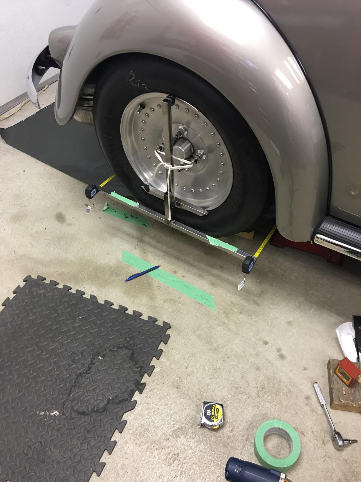

- replace frt and rear shocks

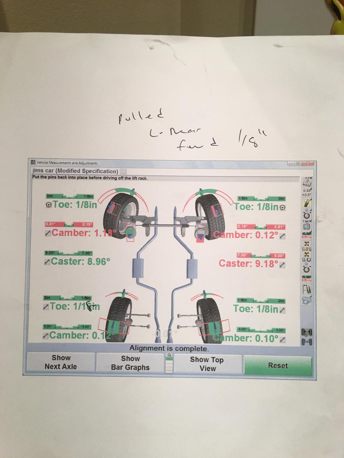

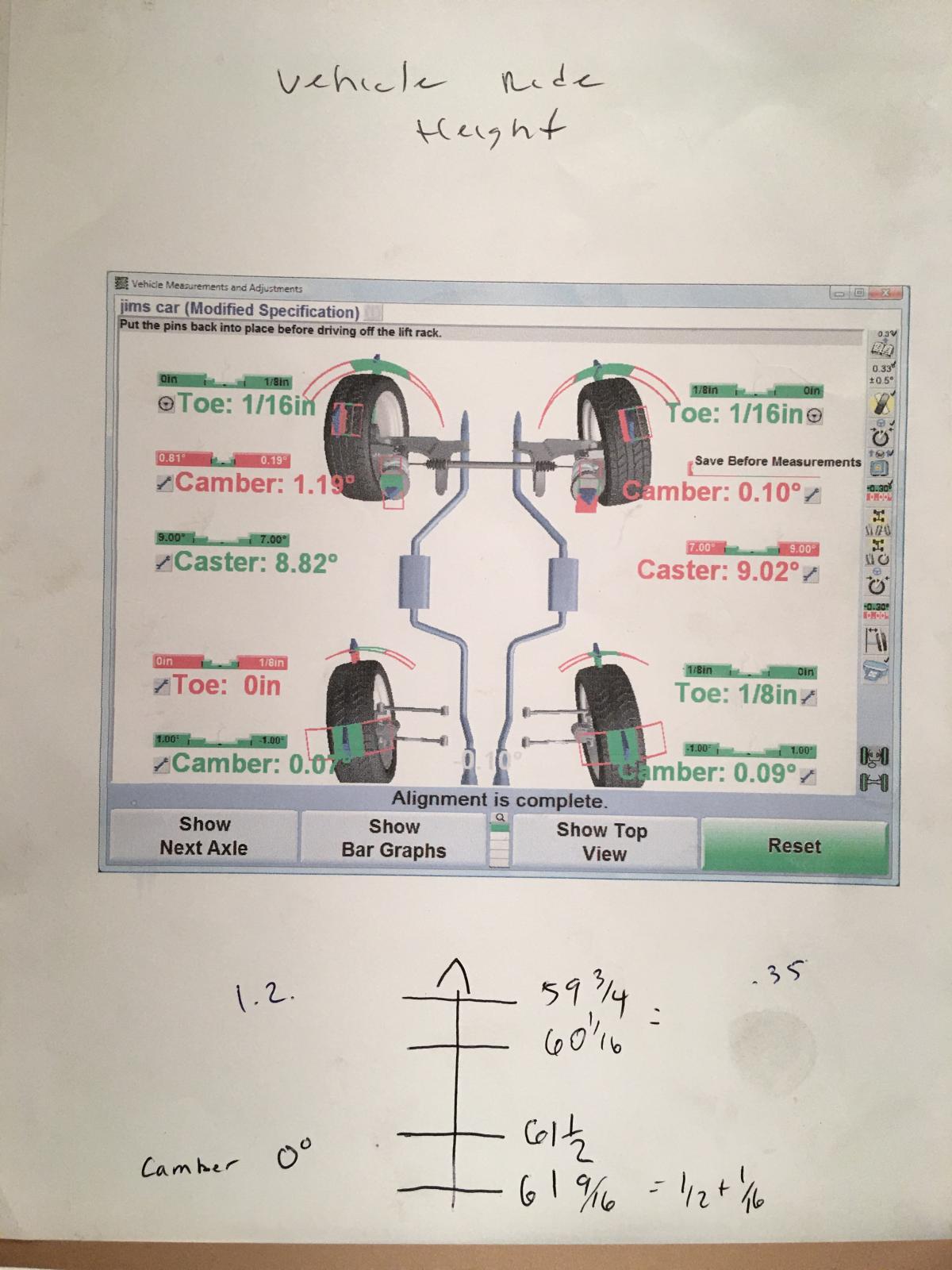

 lets make it stable : stock ,slightly modified or really pushing it there are lessons for all here.
  There were many time at higher speed the WOK would wander usually to the right and sometimes quite abruptly.
I assumed I was just getting out of the groove and most of the time I could catch it slowly easy it back over .
 Remember Im traveling way over 130mph and accelerating quite fast at that point so an easy touch was required .
Sometimes it would work out ok and other times just not ,regardless it could be a tad hairy and or plain scary.
 So stability was defiantly high on my list of things to get handled .
 I don’t know exactly at what point things seamed to get a bit to loose for comfort but must admit it was starting to worry me as rate of acceleration was increasing fast .
  There is a lot to be said for seat of the pants , and this is what i would feel at times -launch rough bouncy ,- slipping sideways feeling, -pulling right while accelerating ,-

First was replacement of the clutch from the Kennedy dual disc to the Ron Lummus REV6 dual disc ,why?
    The Kennedy was so smooth on take off and took more abuse than I could throw at it as well as held all the power I was putting at it But, because of disc weight I needed to shift way slower to
Allow the synchros to work smoothly but, even with that they eventually required replacement due to warping .
    So I was kind of thinking that I would be able to accomplish a lot more with the Clutch swap to the REV6 .
I was figuring I would still have a very smooth launch with the REV6 , shift speed could now increase due to the small diameter of the discs which would help by not allowing vehicle to unload and reload so much between gears, and this should also
Help with high speed stability as the faster shifts again will not allow the suspension to fully unload in the higher gears as well hopefully resulting in stability .
   Yes made total sense to me but ya ,NO.
2 steps fwd 1 step back .yes the design of the clutch allowed for way faster shifting ,and yes did help settle the car in-between shifts and then accelerating ,and very important held the power ,so on the right track there !!
But as we seen earlier , the launch went from smooth to very aggressive.
   All data sent to Ron Lummus for review . Ron and myself discussed many options and agreed 1 step at a time approach also my ECMS was disconnected as requested earlier  .next step will be to allow more initial clutch slip and monitor holding power and stiffen back of car to take the shock of launch and better control weight of car .
Engine pulled out for clutch adjustment and reset for more initial slip on launch and at the same time swap the 28mm torsion bars for 30mm torsion bars .
  Now after resetting ride height and engine with adjusted clutch back in it was time to retest .clutch was smoother and I did raise RPM as well which added some more needed clutch and tire spin .the 30mm bars made a big difference
As the car just did not bottom so quickly ,the 30mm bars took more of the load than I thought .BUT something else became even worse .even with my QA1 shocks set to max 32 clicks on compression and rebound they could
Not control the weight of the car as well as control the new 30mm bars .Ron sent me to his shock expert in SoCal for advice and looks like I was at the limit , YEP QA1 Shocks are not revalvable and I needed 25% min more .So swapped out the
Shocks to a set of Rons purpose builds dual adjustable Strange engineering shocks ,and yes these are 100% revalvable to what ever you want ,but Ron has already put the work into them so they are dam close for a VW.
 8 clicks each compression and rebound and I’m at 6 clicks , each click is quite allot firmer .
Now one other thing I had forgotten to mention is I did replace the frt shocks earlier in the year to a set of QA1 dual adjustable in the frt .these are great and work excellent, more on those later .
  SO ! Now we are back to this video , 3rd pass out at mission .Clutch readjusted , RPM up 500 , new shocks installed and adjust firmer to 6 clicks , tire pressures at 16 psi , Night stick shifter installed and vola that all it took .
Easy huh , now when you watch the video you can see the suspension /WOK is calmer between shifts and down the track , Rons shock really helped out Huge !!
WOK 1.404 REVIEWED[/
time for some pictures , shocks , bars , clutch already done and alignment jigs etc

So where do you start , best thing to do is get your alignment specs , can you do this at home ,Yes 100% it can be done at home . or 100% at a shop but ,you still need to know what’s going on instead of taking someones word for it .

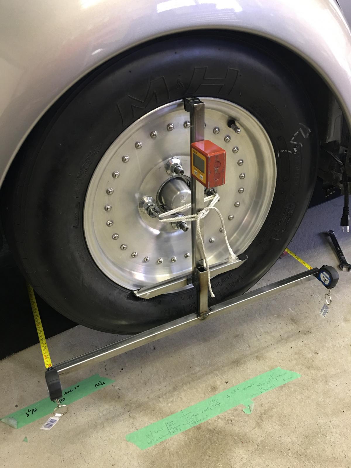

   I started with making some new equipment for home alignment adjustment ,the tools work better than I thought and I can set it up and get camber and toe readings at either the front or rear wheels in under 5 min tops .
now the only thing is it only gives total toe but we can look at how to split that between sides later .
   Now as I said earlier I replaced the rear torsion bars from 28mm up to 30 mm ( 28mm bars for sale !!!)  which meant I had to semi pull my rear suspension apart .its garage time so pull out the measuring tape now .
Before the car was put on 4 jack stands I measured from the bottom rear bolt of the spring plate retainer to the floor on both sides  , then with the car up on the 4 jack stands and the jack under the rear hub of each rear wheel I jacked up until the car just started to lift
Off the jack stand , that was the point the 28mm bar was supporting the vehicle weight ,measure from ,in this case lower shock mount to floor and note that measurement down ,now replace the torsion bars and you now have
Your 2 measurements to put things back too , the support weight point and the ride height .very simple . 30mm bars in and done !

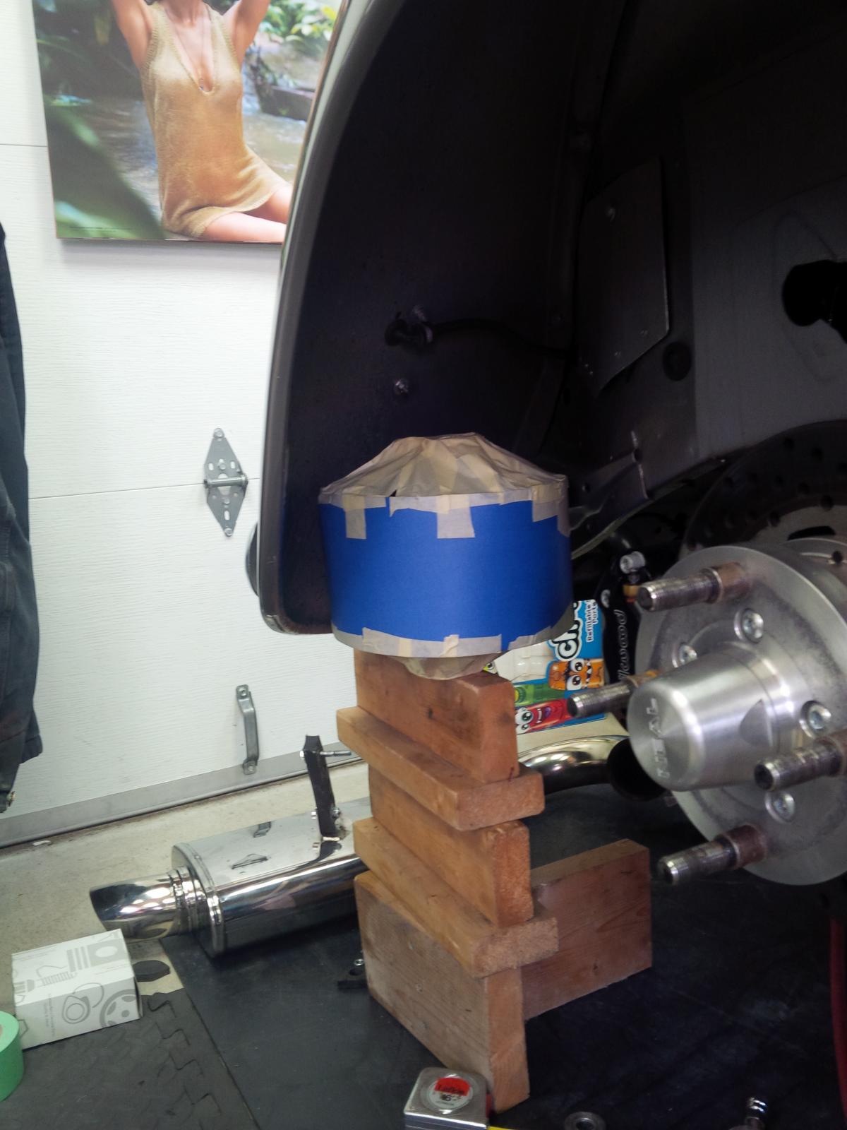

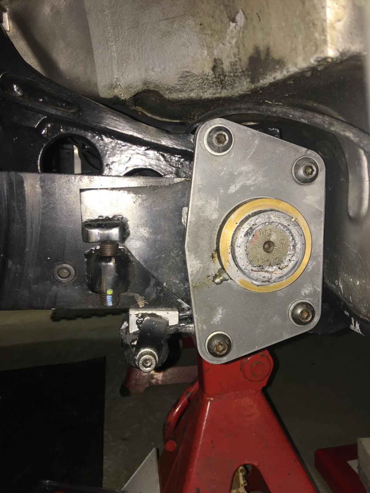

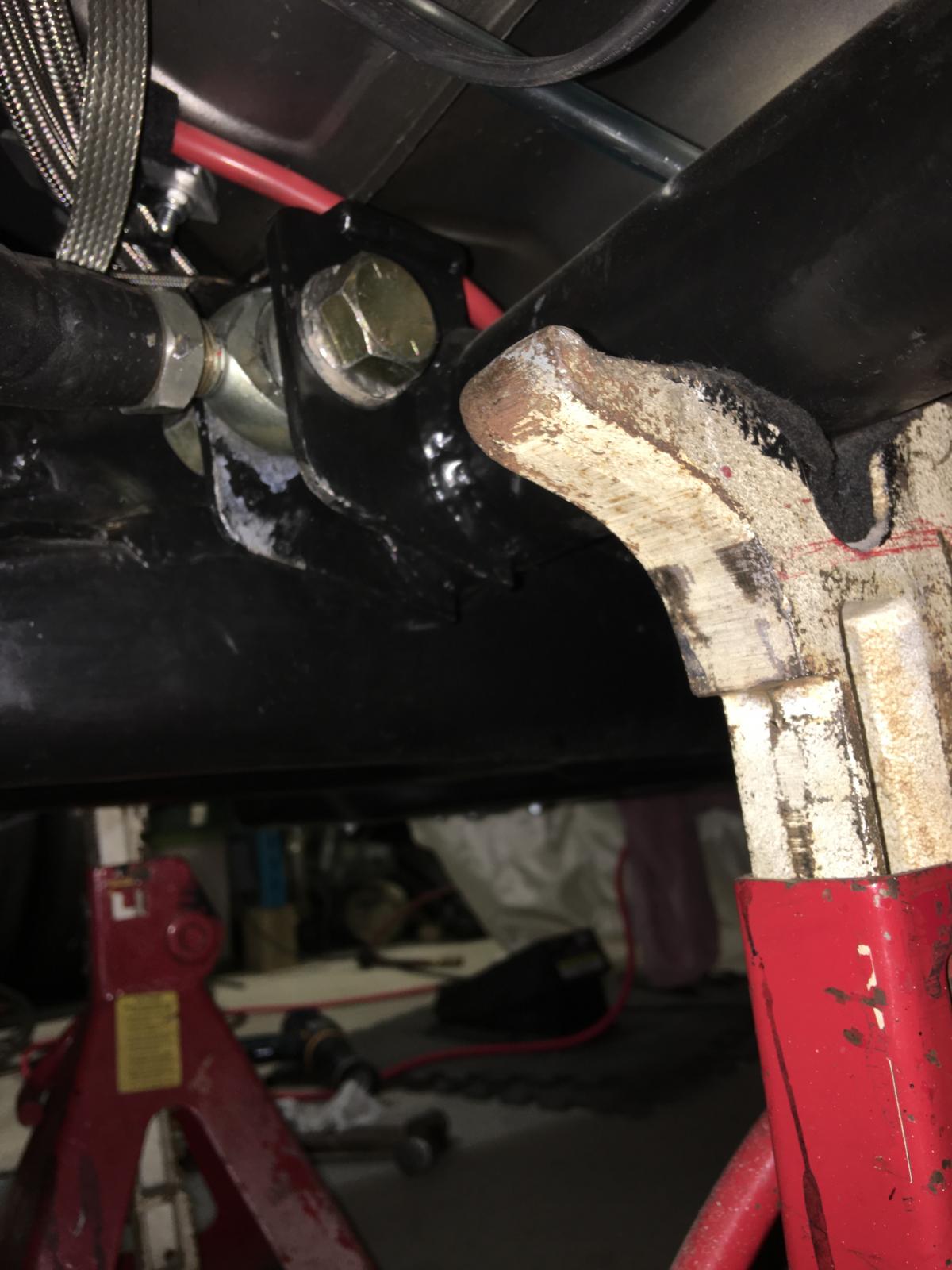

   I use solid spring plate retainers and modified adjustable spring plates ,Solid plate retainers allow for now control arm movement ,excellent . And modified the adjustable spring plates by moving the adjusters forward for better tire clearance .adjustable spring plates are key later on not just for adjusting ride height but also weight distribution.
pics shows suspension down travel limiters, 30mm torsion bar, solid spring plate retainers and modified adjustable spring plates .and a mission raceway mess
WOK back on 4 wheels ,supporting weight and ride height reset and checked , Now TIME to installed my super trick alignment tools, there made from 3/4 square tubing and custom made to fit 15” rims and of course I made sure its 100% square as I tigged it together . It hangs on the top lip of the rim and works on the 3 point system to keep it square .
Also I made a couple of special retainning nuts that thread onto my wheel studs and simply use rope or zap straps to secure the jig securely to the rim .
   I use a lee valley magnetic base angle gauge stick it to the side of my alignment tool and zero it horizontal then move the lee valley tool to the outside position for camber reading .Simple.
There are 2 slots cut in the lower cross tubing which for your info is the width of my rear tires, 26” that allows for the 2 tape measures to slide through . So you can see now . Hang the jigs and square them , connect 2 tape measures take toe and camber readings = less than 5 min ,sweet ! The dam tool works .stupid simple . Its cool to see while you say jack the frt or rear of the car up or down and watch the tape measures move while watching the measurements change , that’s learning what’s going on with your toe readings.
Hey tried the frt next wow under 5 min and have my results there as well , yes you can calculate caster on the frt but worry about that later .
My trick is to use green masking tape on the floor and mark my numbers right there ,yep I will forget otherwise .
   Now I have frt and rear camber and toe readings . what did I find ?
Rear suspension measured showed 1/8 total toe , but my camber on the left rear wheel was way more positive than the right rear .?
Also my frt suspension total toe was 1/8” total , caster I don’t need to worry about as it was already known but my left frt camber was way out .?
 So far nothing really sticking out for my high speed wander but.

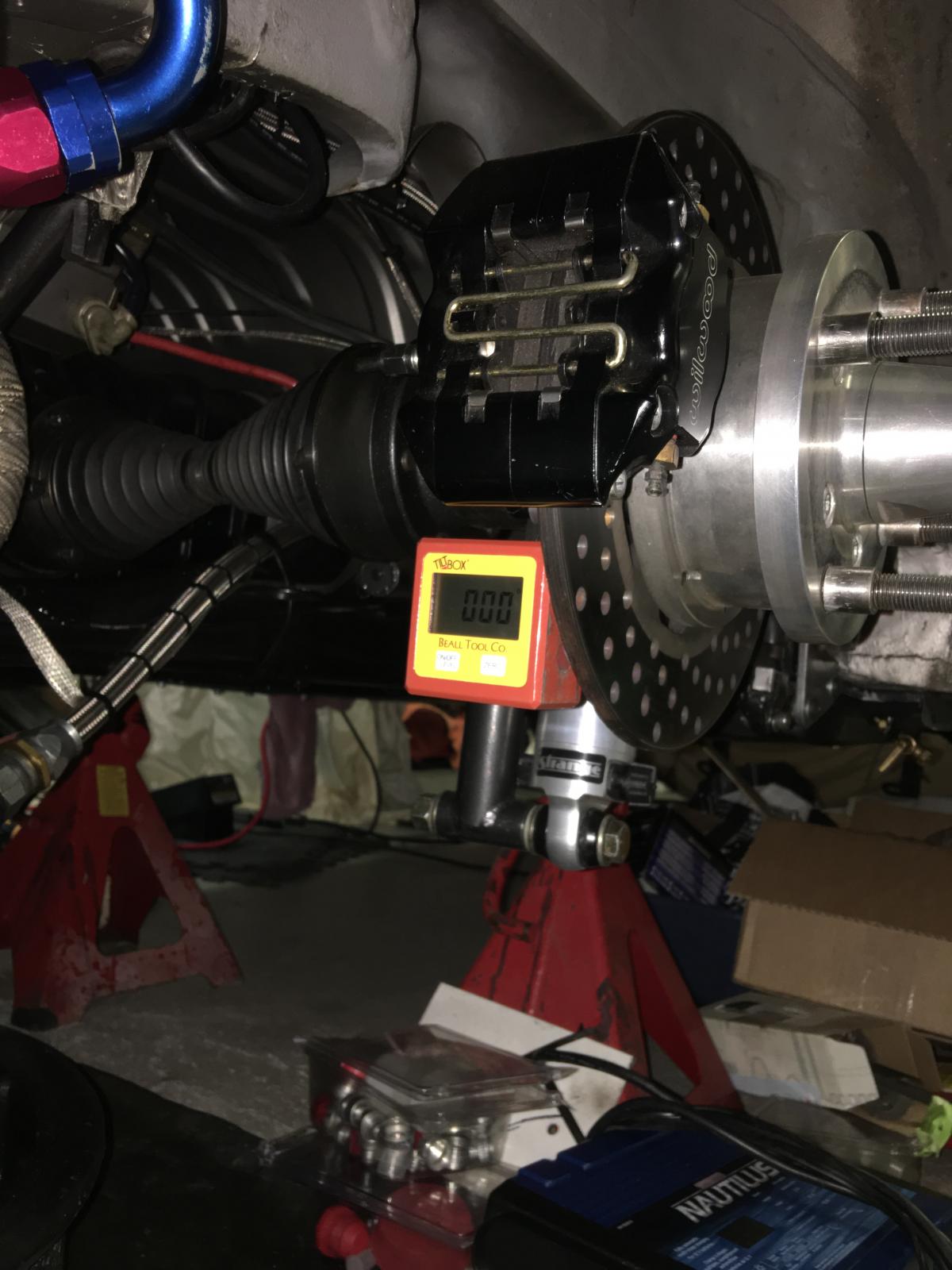

Back up onto the jack stands for a camber inspection . i put the jack under each rear wheel and lifted it to my ride height and installed a bigger wedge under my suspension limiters to keep each rear wheel while up in the air at ride height and
simply used the lee valley angle gauge on the inside of the brake disc to double check camber measurements I previously took with my alignment tool ,
Now my suspension is a one of and it has the ability to simply adjust camber and toe-in quite simply.
By either  turning my inner heim joint or sliding it up and down in the grooved slot , by fluke it works out that 1 turn of the heim joint is 1/16” toe adjustment in or out .
   Always work with the worst side and in this case I needed to slide the left heim joint down to give me less positive camber .
I adjusted this in a few ways .pre-checked the camber at full squat , ride height and full lift . It works out the suspension is really unique and
Does not have major camber change through its complete range from full lift to full squat but more important is its a ZERO camber for the most part .with the car fully lifted in the rear it max around +0.7 of a deg and at ride height + 0.07 deg .nothing.
I quickly while the car was in the air reconnected my alignment tools , set suspension to ride height and hey still 1/8” Toe-In
FRT left wheel , rim off and inspected , NO adjustment for camber left ,now im not sure if the spindle took damage at some point ,yes cheap Chinese drop spindles or they are just crap , I think they are crap .but I do have a set of the onset upper ball joint
Camber adjusters , may just give that a go and see what happens before a buy another set of spindles
     Back on the GROUND and time to recheck frt and rear alignment again, Frt no change but rear camber NOW excellent and toe still 1/8” ,well this is not really any reason for wander but yes it maybe part of it and for sure every correction HELPS !!
NOW HOW do you split the TOE -IN evenly between sides , hey I can have 1/8” toe in but that might mean left wheel has 0 toe in and right wheel has 1/8” toe in ,still 1/8 total toe but not even , that can cause a pull or push .
SO time to think outa the box .I hung a plumb bob from my frt beam centre grub screw and marked the floor , did the same at the rear by fitting a plug into the centre hole in the centre of the pan and marked the floor .then stretched a thing string between the 2 points .
Bang instant centre of car ,So back on with the alignment tools and just measured from the front of each bar to the string ,
Found this pick , you can easily see the frt centre beam grub screw and the factory pan centering hole at the rear .
VERY interesting have to keep it a secrets until im at the shop using the hunter aligner ,now will see if im any good .

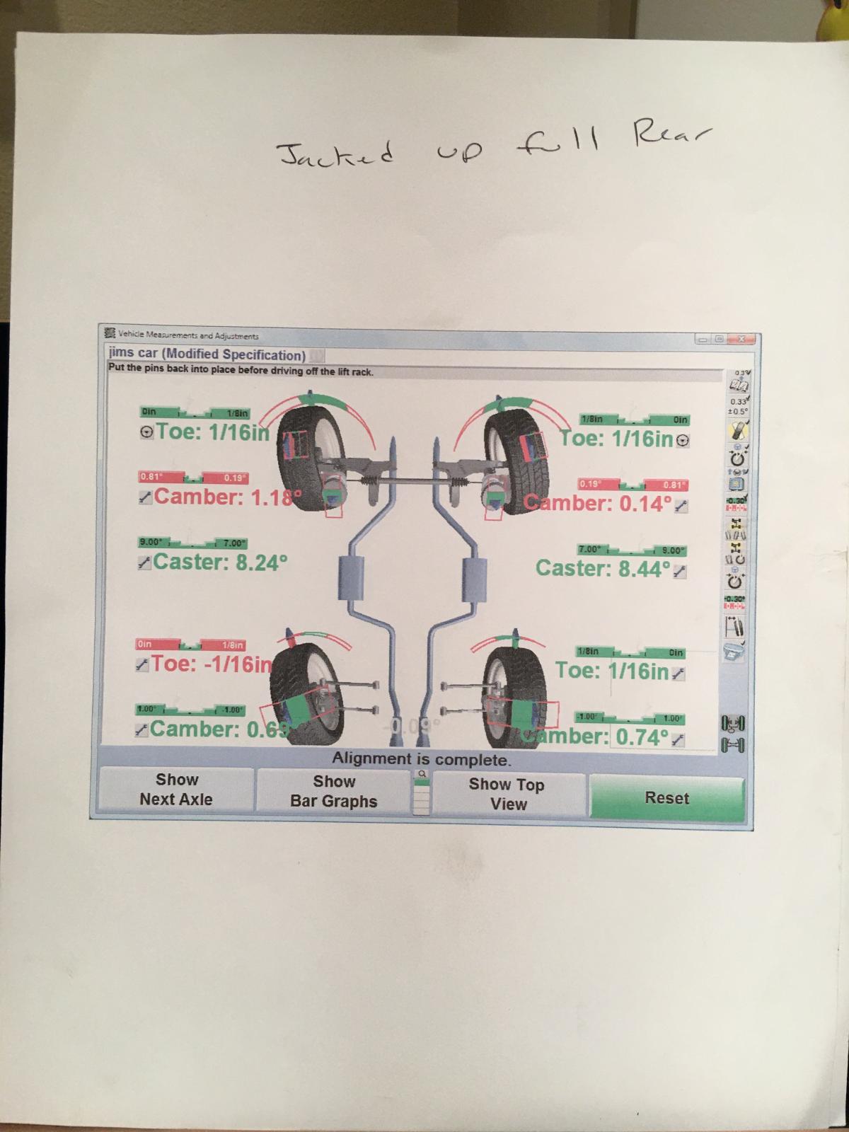

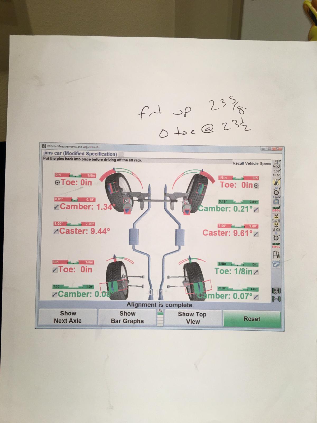

  Drove the WOK to the shop ,car felt good and always fun and put it up onto the Hunter alignment rack , the specs I have are NOT stk VW but slightly modified for my vehicle .but numbers are numbers .
So drum roll , now I can see how close my home alignment was , WELL to say the least im dam good !!!!
Lets look as how she sits
 Total toe frt and rear 1/8” , frt caster is always 9+ deg positive and will never change and rear camber just as I set it a hair positive camber at 0.08 deg positive camber
The front TOE-IN was bang on at 1/16” per side but you can see my REAR toe in was slightly off , yes total TOE was 1/8” but not even per side ,
  So having these readings now allows me to go home and simply extend the left rear heim joint 1 turn out to give 1/16” toe in and wind the right rear heim joint in 1 turn decreasing the TOE to 1/16”
For the same total of 1/8” total but now even , Get it .
   well is the WOK fixed , nope im never happy , this is just the car sitting level not moving or under load . I know what needs to be done .but lets look at a few shot I took while on the rack doing some testing .
Focus is only at front here , look closely at the TOE-IN and caster .
     Just as I said caster has increased as suspension raises — EXCELLENT but what happened to my TOE-IN — well its gone !!
You can see I have taken some measurements for at home later , those represent from the bottom of the fender lip to the front wheel contact point dead centre .
So again this is stationary with no load !! But does show while accelerating and the rear drops a bit and the frt lifts what happens . Hit a bump add some more road force of 140 mph and its most likely
Driving the frt wheels to a dangerous TOE-OUT ,
   Well we know the frt TOE needs adjustment and the rear TOE needed help at ride height but what happens to the rear when I slow shift and the back of the car lifts up ,
Or more important at the end of the track on decele . So frt back down and time to jack rear of car up till it hits the limiter stops.
You can see the rear camber increases to 0.70 positive camber , hey not bad less than 1 deg positive ,but look at the toe .
Both the left and right sides lost 1/16” toe in , not bad at all very small change in toe , camber is excellent and we know we still need a TOE-IN adjustment
    So what did I do , The rear TOE Adjustment I need to do at home as its allot of work but the frt was easy , readjusted the frt TOE-IN to 1/8” per side and almost changing to 3/16” per side , and now even with the car lifted in the frt The car stayed at Min 1/16” TOE-IN , SWEET .
The rear now was easy , since I new the right side already had 1/8” toe in and at full lift it only went to 1/16” toe in its just a matter of adjusting the left rear heim joint out 2 turns to readjust the left rear toe to positive 1/8” TOE-IN .now I don’t have to worry here as the rear suspension squats it gains negative camber and TOE-IN
  At the shop you can see my newly set frt TOE-IN and with a bit of trickery drove the left rear fwd for testing purposes , I like the numbers now .
   I hope you can see what’s happened and why I was getting instability and wander , its more than just a flat level setting ,you need to put the chassis through its ranges and see what numbers change .
IS it stable , hey im going 140mph plus with 1 hand on the wheel , so ill say ya im happy ,job done. Well almost time for the scales.
Basic specs for me at ride height , frt toe between 1/4-3/8” Toe-in, frt camber will be 0-0.5 deg positive , rear camber at ride height a hair over 0 deg and toe at 1/4” toe in

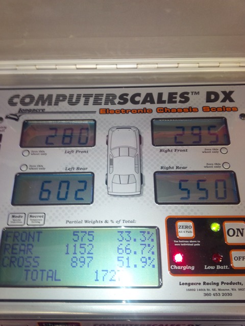

as far as where you want the weight, I am not as sure on that as some things that you need to consider (You may already know!)....
Make sure that when you weigh it the scales are all level to each other. There is a couple of methods to do this, but if they are not on the same plane, the car may inadvertently shift its weight to the lower scale(s). Also, make sure the car is race ready on its weight.... fuel, tire pressures, you (with all safety gear), etc....
By the way, I just weighed my race bug last week and with me in it, it is right at 1750lbs total. (I don't recall individual weights, because I was not concerned with that at this point.)
Good luck and hopefully someone else can chime in with more useful info!
Tom Simon
others may disagree, but I found a 4 scale check and adjustment to be key in car set up. Namely, getting fore and aft weights in the ball park, then getting the cross weights about right.

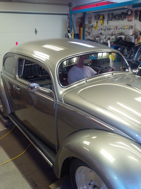

always like to follow up .
car on the scales ,with me in it, helmet on lap and suite under seat. 3 gallons fuel .
car without driver, weight 1727 lbs
with driver 1911 lbs
only thing to add is my safecraft fire suppression system . i was very surprised to see the
left frt lighter than the right frt ,especially with me on that side .numbers look good
and happy to see a 35/65 split

Well, with a little judicous finagling, you should be able to scale it a little better than that. it may help if you can mount the snuff kit close to the battery tray area..Also do a search here on Tony Klink's PRO/GAS car session with the 4 corner..

The drivers side torsion bar has more preload than the passenger side. The drivers side MAY have too much OR the passenger side MAY have too little. Measure the rear camber and ride height to determine which side needs adjusting.
Nick Wharton
you beat me to it. I was thinking the same thing. Check ride height loaded, unloaded, before and after
 jim martin
i see what you are saying .by adjusting the right rear torsion firmer it will basically push/apply more weight to the right rear and in doing so will force more pressure to the left frt
Jabber Jaws
Exactly, but you may find by investigating camber and ride height that LOWERING the left rear is the way to go. If it is swing axle camber will be your main factor. You want both wheels to have the same camber loaded. When you think you are done raise the front about 10 inches and see what happens in the back with weights and camber, this will give you an idea where to "shift weight" in the car and if your rear torsions are close to equal strength.
Tom Simon
numbers look good and happy to see a 35/65 split
If I were doing the set up, I would try to get closer than that. I would almost ignore weight without driver and gear. It's interesting, but has little bearing on how the car will drive down track. Make sure caster and camber are set, tire pressures are set with a good gauge. Only then will your scales work correctly.
If I had them, I'd tighten the passenger (right) rear springplate adjuster screw, to add more pre-load to the right rear. If I had no adjustable spring plates, I'd take the springplate off and carefully re-index both inner and outer splines to yield a little more pre-load on the right rear. As was mentioned, increasing right-rear pre-load will always increase load on the left front, at the same time. It's very similar to shimming up the short leg of a table sitting on an uneven surface. Two legs are carrying all the weight, the other two 'short legs' are wobbling. You only shim one of the two legs, yet when finished, both legs are now carrying weight.
The goal is to make the left front and rear, and the right front and rear percentages equal, regardless of left side and right side weight (which you can't do anything about at this point, short of adding lead bars, which I can't recommend for these purposes).
Example: look at your total left side weight, and total right side weight with driver. Right side total weight, right front 342 + right rear 559 = 901lbs. Left side total weight, left front 329 + left rear 640 = 1011lbs. Unless you move the driver toward the tunnel 6", the left and right weight distribution will remain the same, driver's side is 100lbs heavier. For corner weighting purposes, let's assume you can't/won't change that fact.
Typically the left of a VW's driver's side of the car will have a higher combined front and rear weight total, so your driver's side being heavier than the passenger side is typical.
What you can do, to make the car go straight and handle great, is to get your front and rear percentages closer.
Example: as the car sits, your front/rear percentages are 35/65, which is fine. What is off, and can be fixed, is the right rear currently carries only 62% of the right side's total weight, and the left rear carries 67% of the left side's total weight. Make sense?
To fix this on your car, increase right rear preload to where the scale reads about 585lbs, the left rear should read about 656lbs. These are approximate, because the front and rear percentages usually change slightly as you increase or decrease pre-load. This is a little bit 'trial and error' so be patient, keep notes, use a calculator, and keep in mind that the goal is to have the 'corner's' carrying the right percentages of weight.

 jim martin
thanks , i completely understand and appreciate everyones input .Tom your calculations examples are excellent .
alignment is finished and rear is custom IRS with very little camber change through range of motion and in the area its sitting there would be almost Nil if i raise it or lower it 3/4 ".spring plates are adjustable left and right and all 4 corners are qa1 dual adjustable shocks .i did not recheck pressure in the tires and i now see how that can effect things .this was my first shot on the scales and will be playing with it again soon .vehicle is apart as the tranny needed a quick fix .also will level all the scales on the floor and make sure there all at the same height . also will let the shocks hang as suggested .
i would say my only adjustments at this point in which i have to play with are .removal of the steel engine deck lid , muffler , and positioning of my 5 lb safecraft bottle ,frt beam centre adjusters and of course left and right rear torsion bar adjustments .
